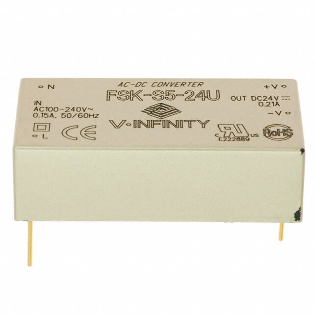

    CONVERTER AC-DC 24V 0.21A 5W
FSK-S5-24U 数据手册
rev. page page date date 1 of 4 10/2007 PART NUMBER: FSK-S5 series DESCRIPTION: AC-DC converter features ·approved to UL60950, CSA C22.2 NO.60950, CB(IEC 60950), CE(EN60950) • universal input 85~264 Vac/ 110~340 VDC • encapsulated, compact case • high efficiency • surface mounting technology • 100kHz fixed frequency • fixed output voltage • thermal shutdown • output short circuit protection • low output ripple and noise • isolated output • 2 year warranty model number FSK-S5-3R3U FSK-S5-5U FSK-S5-12U FSK-S5-15U FSK-S5-24U AC AC AC AC AC input voltage 85-264V / DC 110-340V 85-264V / DC 110-340V 85-264V / DC 110-340V 85-264V / DC 110-340V 85-264V / DC 110-340V output voltage 3.3V @ 1.25A 5V @ 1.0A 12V @ 0.42A 15V @ 0.33A 24V @ 0.21A power max. 4.125 W 5.0 W 5.0 W 5.0 W 5.0 W ripple & noise max. 80 mVp-p 80 mVp-p 120 mVp-p 150 mVp-p 200 mVp-p efficiency (%) 71 75 77 77 77 INPUT parameter input frequency input voltage input current inrush current leakage current conditions/description output power derated from 85-90 VAC AC input of 110 VAC AC input of 220 VAC measured at 110 VAC at full load, cold start measured at 220 VAC at full load, cold start measured at 110 VAC measured at 220 VAC min 47 85 110 nom (50~60) max 440 264 340 150 80 20 40 0.5 0.75 units Hz VAC VDC mA mA A A mA mA OUTPUT parameter conditions/description voltage tolerance ripple and noise line regulation load regulation dynamic load regulation temperature drift rise time hold-up time min -2% -1% -1% -1% -3% -1% 10 nom max +2% +1% +1% +1% +3% +1% 100 units mS mS 20050 SW 112th Ave. Tualatin, Oregon 97062 phone 503.612.2300 fax 503.612.2382 rev. page date 2 of 4 10/2007 PART NUMBER: FSK-S5 series DESCRIPTION: AC-DC converter PROTECTION CIRCUIT parameter output over current over temperature o ver voltage conditions/description works at over 105% of the rating and recovers automatically. 150 ºC clamp, 130~150% GENERAL parameter operating temp. storage temp. operating humid. storage humid. isolation voltage (HI-POT) vibration impact MTBF RoHS safety EMC 1 warranty conditions/description min -20 nom max 70 units ºC -40 80 ºC non-condensing 20% 90% RH non-condensing 20% 90% RH applied for 1 minute, 10mA primary to secondary, 500 Vdc @ 100 M Ω 3000 VAC at 10G 3 minute period 10 55 Hz 50G for 11mS, once on each X, Y, Z axis 4.5 x 10 5 hours yes approved to UL60950-1(E222889), CSA C22.2 NO.60950, CB(IEC 60950-1), CE(EN60950) 5W, 10W single output: approved; EN61204-3 class B, EN 6100-3-3 (through TUV) standard warranty length 2 years note: 1. to meet the standard of EN61204-3 class B, use the external noise filter between L and N (refer to manual) DERATING CURVE 20050 SW 112th Ave. Tualatin, Oregon 97062 phone 503.612.2300 fax 503.612.2382 rev. page date 3 of 4 10/2007 PART NUMBER: FSK-S5 series DESCRIPTION: AC-DC converter EMI The figure below is a suggested diagram in order to reduce electromagnetic interference (EMI) on the FSK-S5 series. N VOUT C2 222Y2 C1 224X2 SM PS L1 = 10~30mH Common Mode Line Filter C1 = 220nF X2 Capacitor C2, C3 = 2200pF Y2 Capacitor C4 = 2200pF Y1 Capacitor GND L IN P U T L1 L /F C3 222Y2 F .G . C4 222Y1 OUTPUT 20050 SW 112th Ave. Tualatin, Oregon 97062 phone 503.612.2300 fax 503.612.2382 REV. A DESCRIPTION NEW DRAWING DATE 9/13/2007 50.8 2.000 R 0.3 [0.012] (8 PLCS) 25.40 1.000 15.24 0.600 45.72 1.800 5.08 0.200 5 (PLCS) 2 20.32 0.800 IN OUT 4 10.16 0.400 1 5 TOLERANCE: ±0.3mm UNLESS OTHERWISE SPECIFIED RoHS PIN ASSIGNMENTS Single Output Pin Number 1 AC (N) 1. 2. 3. 4. Notes: All dimensions are in mm [inches] Weight: 40g or less Case material : PBT, UL94V-0 Construction: Encapsulated soft pot 2 3 4 5 AC (L) NO pin -V out +V out 20050 SW 112th Ave. Tualatin, OR 97062 Phone: 503-612-2300 800-275-4899 Fax: 503-612-2383 Website: www.cui.com TITLE: AC-DC Converter FSK-S5 APPROVED BY: UNITS: REV: A PART NO. MM [INCHES] SCALE: PC FILE NAME: FSK-S5 COPYRIGHT 2007 BY CUI INC. DRAWN BY: JMS 1:1
