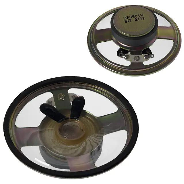

Additional Resources: Product Page | 3D Model date 08/05/2022 page 1 of 3 MODEL: GF0771M | DESCRIPTION: SPEAKER FEATURES • 77 mm • round frame • 1.0 W •8Ω • ferrite magnet • PET cone SPECIFICATIONS parameter conditions/description min impedance at 0.8 kHz, 1.0 V 6.8 resonant frequency (Fo) at 1.0 V 224 input power frequency response typ max units 1.0 2.0 W 8 9.2 Ω 280 336 Hz Fo sound pressure level at 1.0 W, 50 cm, avg at 0.6, 0.8, 1.0, 1.2 kHz buzz, rattle, etc. must be normal at sine wave dimensions Ø77 x 24 magnet ferrite cone material PET terminal solder eyelets 87 90 11,000 Hz 93 dB 2.82 weight 64.0 operating temperature -25 hand soldering for maximum 3 seconds RoHS yes V mm 360 cuidevices.com 380 g 60 °C 400 °C Additional Resources: Product Page | 3D Model CUI DEVICES | MODEL: GF0771M | DESCRIPTION: SPEAKER date 08/05/2022 | page 2 of 3 REV. A MECHANICAL DRAWING units: mm tolerance: ±0.8 mm DESCRIPTION NEW DRAWING DESCRIPTION NEW DRAWING REV. A DATE 8/8/2006 DATE 8/8/2006 71.00 32.00 71.00 32.00 24.00 0.3 13.00 0.3 13.00 0.3 24.00 0.3 3.00 3.00 TOLERANCE: ±0.5mm UNLESS OTHERWISE TOLERANCE: SPECIFIED ±0.5mm UNLESS OTHERWISE SPECIFIED 77.00 77.00 TITLE: 20050 SW 112th Ave. Tualatin, OR 97062 20050 SW 112th Ave. Phone: 503-643-4899 Tualatin, OR 97062 800-275-4899 Phone: 503-643-4899 Fax: 503-372-1266 800-275-4899 Website: www.cui.com Fax: 503-372-1266 Website: www.cui.com Round frame mylar cone - ferrite magnet PC FILE NAME: PC FILE NAME: GF0771M COPYRIGHT 2006 BY CUI INC. COPYRIGHT 2006 BY CUI INC. FREQUENCY RESPONSE CURVE parameter conditions/description potentiometer range 50 dB rectifier RMS lower limit frequency 20 Hz wr. speed 100 mm/sec zero level 70 dB REV: A REV: A MM [INCHES] PART NO. UNITS: GF0771MAPPROVED BY: SCALE: DRAWN BY: MM [INCHES] ZRJ 1:1 SCALE: APPROVED BY: DRAWN BY: ZRJ 1:1 PART NO. GF0771M RoHS RoHS cuidevices.com TITLE: Round frame mylar cone - ferrite magnet UNITS: GF0771M Additional Resources: Product Page | 3D Model CUI DEVICES | MODEL: GF0771M | DESCRIPTION: SPEAKER date 08/05/2022 | page 3 of 3 REVISION HISTORY rev. description date 1.0 initial release 09/27/2006 1.01 brand update 01/30/2020 logo, datasheet style update 08/05/2022 1.02 The revision history provided is for informational purposes only and is believed to be accurate. CUI Devices offers a one (1) year limited warranty. Complete warranty information is listed on our website. CUI Devices reserves the right to make changes to the product at any time without notice. Information provided by CUI Devices is believed to be accurate and reliable. However, no responsibility is assumed by CUI Devices for its use, nor for any infringements of patents or other rights of third parties which may result from its use. CUI Devices products are not authorized or warranted for use as critical components in equipment that requires an extremely high level of reliability. A critical component is any component of a life support device or system whose failure to perform can be reasonably expected to cause the failure of the life support device or system, or to affect its safety or effectiveness. cuidevices.com
