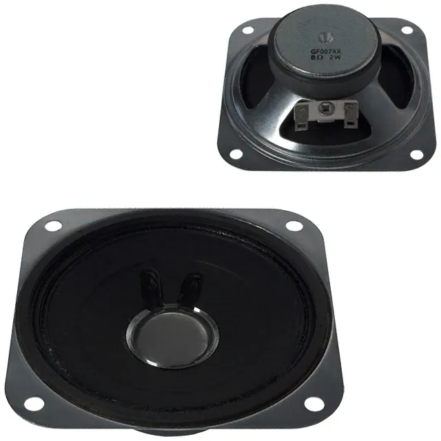

    8 Ohm Magnetic Speaker 2W 290Hz ~ 18kHz Top Round, Square Frame 99dB
GF0876 数据手册
Additional Resources: Product Page | 3D Model date 08/05/2022 page 1 of 3 MODEL: GF0876 | DESCRIPTION: SPEAKER FEATURES • 87 mm • square frame • 2.0 W •8Ω • ferrite magnet • paper cone SPECIFICATIONS parameter conditions/description min impedance at 0.8 kHz, 1.0 V 6.8 resonant frequency (Fo) at 1.0 V 256 sound pressure level at 1.0 W, 50 cm, avg at 1.0, 1.4, 1.7, 2.0 kHz 96 buzz, rattle, etc. must be normal at sine wave dimensions 87 x 87 x 32.5 magnet ferrite cone material paper terminal solder eyelets input power frequency response typ max units 2.0 3.0 W 8 9.2 Ω 320 384 Hz Fo 99 17,000 Hz 102 dB 4.0 V mm weight 140 g operating temperature -25 70 °C storage temperature -40 80 °C 440 °C hand soldering for maximum 5 seconds RoHS yes 400 cuidevices.com 420 Additional Resources: Product Page | 3D Model CUI DEVICES | MODEL: GF0876 | DESCRIPTION: SPEAKER date 08/05/2022 | page 2 of 3 MECHANICAL DRAWING units: mm tolerance: ±0.8 mm 80.00 45.00 32.50 3.80 100.00 87.00 (TYP) 5.00 (4 PLCS) + - FREQUENCY RESPONSE CURVE cuidevices.com Additional Resources: Product Page | 3D Model CUI DEVICES | MODEL: GF0876 | DESCRIPTION: SPEAKER date 08/05/2022 | page 3 of 3 REVISION HISTORY rev. description date 1.0 initial release 09/18/2006 1.01 applied new spec template, added operating & storage temperatures 05/16/2013 1.02 brand update 03/18/2020 1.03 modified cone design, modified resonant frequency & frequency response 01/01/2021 1.04 modified cone design 06/07/2021 logo, datasheet style update 08/05/2022 1.05 The revision history provided is for informational purposes only and is believed to be accurate. CUI Devices offers a one (1) year limited warranty. Complete warranty information is listed on our website. CUI Devices reserves the right to make changes to the product at any time without notice. Information provided by CUI Devices is believed to be accurate and reliable. However, no responsibility is assumed by CUI Devices for its use, nor for any infringements of patents or other rights of third parties which may result from its use. CUI Devices products are not authorized or warranted for use as critical components in equipment that requires an extremely high level of reliability. A critical component is any component of a life support device or system whose failure to perform can be reasonably expected to cause the failure of the life support device or system, or to affect its safety or effectiveness. cuidevices.com
