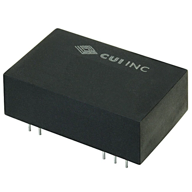

PQB3-D48-S15-D 数据手册
Additional Resources: Product Page | 3D Model | PCB Footprint date 07/15/2021 page 1 of 6 SERIES: PQB3-D │ DESCRIPTION: DC-DC CONVERTER FEATURES • • • • • • • • • 3 W isolated output smaller package single/dual regulated output 1,500 Vdc isolation short circuit protection temperature range (-40~105°C) high efficiency at light load efficiency up to 86% EN 62368-1 MODEL input voltage output voltage output current output power ripple and noise2 efficiency typ (Vdc) range (Vdc) (Vdc) min (mA) max (mA) max (W) max (mVp-p) typ (%) PQB3-D5-S5-D 5 4.5~9 5 30 600 3 80 74 PQB3-D5-S12-D 5 4.5~9 12 12 250 3 80 77 PQB3-D5-S15-D 5 4.5~9 15 10 200 3 80 77 PQB3-D5-D5-D 5 4.5~9 ±5 ±15 ±300 3 80 76 PQB3-D5-D12-D 5 4.5~9 ±12 ±6 ±125 3 80 78 PQB3-D5-D15-D 5 4.5~9 ±15 ±5 ±100 3 80 78 PQB3-D12-S3-D 12 9~18 3.3 46 909 3 80 74 PQB3-D12-S5-D 12 9~18 5 30 600 3 80 81 PQB3-D12-S12-D 12 9~18 12 12 250 3 80 83 PQB3-D12-S15-D 12 9~18 15 10 200 3 80 82 PQB3-D12-S24-D 12 9~18 24 6 125 3 80 83 PQB3-D12-D5-D 12 9~18 ±5 ±15 ±300 3 80 81 PQB3-D12-D9-D 12 9~18 ±9 ±8 ±166 3 80 84 PQB3-D12-D12-D 12 9~18 ±12 ±6 ±125 3 80 84 PQB3-D12-D15-D 12 9~18 ±15 ±5 ±100 3 80 85 PQB3-D24-S3-D 24 18~36 3.3 46 909 3 80 78 PQB3-D24-S5-D 24 18~36 5 30 600 3 80 81 PQB3-D24-S12-D 24 18~36 12 12 250 3 80 86 PQB3-D24-S15-D 24 18~36 15 10 200 3 80 86 PQB3-D24-S24-D 24 18~36 24 6 125 3 80 85 PQB3-D24-D5-D 24 18~36 ±5 ±15 ±300 3 80 82 PQB3-D24-D12-D 24 18~36 ±12 ±6 ±125 3 80 84 PQB3-D24-D15-D 24 18~36 ±15 ±5 ±100 3 80 84 PQB3-D48-S3-D 48 36~75 3.3 46 909 3 80 76 PQB3-D48-S5-D 48 36~75 5 30 600 3 80 82 PQB3-D48-S12-D 48 36~75 12 12 250 3 80 86 PQB3-D48-S15-D 48 36~75 15 10 200 3 80 86 1 Notes: 1. UL approved 2. Ripple and noise are measured at 20 MHz BW by “parallel cable” method with 1 μF ceramic and 10 μF electrolytic capacitors on the output. cui.com Additional Resources: Product Page | 3D Model | PCB Footprint CUI Inc │ SERIES: PQB3-D │ DESCRIPTION: DC-DC CONVERTER MODEL (CONTINUED) input voltage output voltage typ (Vdc) range (Vdc) PQB3-D48-D5-D 48 PQB3-D48-D12-D 48 PQB3-D48-D15-D 48 Notes: date 07/15/2021 │ page 2 of 6 output current output power ripple and noise2 efficiency (Vdc) min (mA) max (mA) max (W) typ (mVp-p) typ (%) 36~75 ±5 ±15 ±300 3 80 82 36~75 ±12 ±6 ±125 3 80 84 36~75 ±15 ±5 ±100 3 80 85 1. UL approved 2. Ripple and noise are measured at 20 MHz BW by “parallel cable” method with 1 μF ceramic and 10 μF electrolytic capacitors on the output. PART NUMBER KEY PQB3 - DXX - XXX - D Base Number Input Voltage Output S = single D = dual Packaging Style DIP Output Voltage INPUT parameter conditions/description min typ max units operating input voltage 5 Vdc input models 12 Vdc input models 24 Vdc input models 48 Vdc input models 4.5 9 18 36 5 12 24 48 9 18 36 75 Vdc Vdc Vdc Vdc start-up voltage 5 Vdc input models 12 Vdc input models 24 Vdc input models 48 Vdc input models 4.5 9 18 36 Vdc Vdc Vdc Vdc surge voltage for maximum of 1 second 5 Vdc input models 12 Vdc input models 24 Vdc input models 48 Vdc input models 12 25 50 100 Vdc Vdc Vdc Vdc filter pi filter typ max units -0.7 -0.7 -0.7 -0.7 OUTPUT parameter conditions/description min line regulation full load, input voltage from low to high ±0.2 ±0.5 % load regulation 5% to 100% load ±0.2 ±0.5 % voltage accuracy no-load voltage accuracy ±1 ±3 % ±1.5 ±5 % ±1 voltage balance dual output, balanced loads ±0.5 switching frequency 100% load, nominal input voltage, PFM mode 200 transient recovery time 25% load step change 0.5 2 ms transient response deviation 25% load step change ±2 ±5 % temperature coeffecient 100% load ±0.02 ±0.03 %/°C max units 1 s 3 Notes: % kHz 3. For dual output models, unbalanced loads should not exceed ±5%. If ±5% is exceeded, it may not meet all specifications. PROTECTIONS parameter conditions/description min short circuit protection 4 Notes: 4. The supply voltage must be discontinued at the end of the short circuit duration cui.com typ Additional Resources: Product Page | 3D Model | PCB Footprint CUI Inc │ SERIES: PQB3-D │ DESCRIPTION: DC-DC CONVERTER date 07/15/2021 │ page 3 of 6 SAFETY AND COMPLIANCE parameter conditions/description isolation voltage input to output for 1 minute at 1 mA max. 1,500 Vdc isolation resistance input to output at 500 Vdc 1,000 MΩ safety approvals1 certified to 62368-1: EN certified to 60950-1: UL conducted emissions CISPR22/EN55022, class A; class B (external circuit required, see Figure 1-b) radiated emissions CISPR22/EN55022, class A; class B (external circuit required, see Figure 1-b) ESD IEC/EN61000-4-2, class B, contact ± 4kV/air ± 8kV radiated immunity IEC/EN61000-4-3, class A, 10V/m EFT/burst IEC/EN61000-4-4, class B, ± 2kV (external circuit required, see Figure 1-a) surge IEC/EN61000-4-5, class B, ± 2kV (external circuit required, see Figure 1-a) conducted immunity IEC/EN61000-4-6, class A, 3 Vr.m.s voltage dips & interruptions IEC/EN61000-4-29, class B, 0%-70% MTBF as per MIL-HDBK-217F @ 25°C RoHS Notes: min typ max 1,000,000 units hours 2011/65/EU 1. See specific model noted on page 1 ENVIRONMENTAL parameter conditions/description min max units operating temperature see derating curve -40 105 °C -55 125 °C 95 % storage temperature storage humidity non-condensing temperature rise at full load, Ta=25°C typ 25 °C SOLDERABILITY parameter conditions/description max units hand soldering 1.5 mm from case for 10 seconds min typ 300 °C wave soldering see wave soldering profile 260 °C max units MECHANICAL parameter conditions/description min dimensions 31.60 x 20.30 x 10.20 (1.244 x 0.799 x 0.402 inch) case material plastic (UL94-V0) weight typ mm 14 MECHANICAL DRAWING units: mm[inch] tolerance: ±0.50[±0.020] pin section tolerance: ±0.10[±0.004] PIN CONNECTIONS PIN Single Output Dual Output 2, 3 GND GND 9 NC 0V 10,15 NC NC 11 NC -Vo 14 +Vo +Vo 16 0V 0V 22, 23 Vin Vin Front View Bottom View PCB Layout Top View NC: No Connection cui.com g Additional Resources: Product Page | 3D Model | PCB Footprint CUI Inc │ SERIES: PQB3-D │ DESCRIPTION: DC-DC CONVERTER date 07/15/2021 │ page 4 of 6 DERATING CURVES EMC RECOMMENDED CIRCUIT Figure 1 Recommended external circuit components Vin (Vdc) 5 FUSE Table 1 12 24 48 choose according to practical input current MOV -- S14K25 S14K35 S14K60 C0 1000μF/16V 1000μF/25V 330μF/50V 330μF/100V C1 4.7μF/50V 4.7μF/50V 4.7μF/50V 4.7μF/100V LDM1 12μH 12μH 12μH 12μH C2 4.7μF/50V 4.7μF/50V 4.7μF/50V 4.7μF/100V C3 10μF 10μF 10μF 10μF CY1 1nF/2kV 1nF/2kV 1nF/2kV 1nF/2kV cui.com Additional Resources: Product Page | 3D Model | PCB Footprint CUI Inc │ SERIES: PQB3-D │ DESCRIPTION: DC-DC CONVERTER date 07/15/2021 │ page 5 of 6 APPLICATION NOTES 1. Output load requirement To ensure this module can operate efficiently and reliably, the minimum output load may not be less than 5% of the full load during operation. If the actual output power is low, connect a resistor at the output end in parallel to increase the load. 2. Recommended circuit This series has been tested according to the following recommended testing circuit before leaving the factory. This series should be tested under load (see Figure 2 & Table 2). If you want to further decrease the input/output ripple, you can increase the capacitance accordingly or choose capacitors with low ESR. However, the capacitance of the output filter capacitor must be appropriate. If the capacitance is too high, a startup problem might arise. For every channel of the output, to ensure safe and reliable operation, the maximum capacitance must be less than the maximum capacitive load (see Table 3). Figure 2 Table 2 Table 3 Vin (Vdc) Cin (µF) Cout (µF) 5 100 10 12 100 10 24 10~47 10 48 10~47 10 Single Vout (Vdc) Max. Capacitive Load (μF) Dual Vout (Vdc) Max. Capacitive Load1 (μF) 3.3 4700 -- -- 5 4700 5 2200 12 2700 9 2000 15 2200 12 1800 24 1800 15 1000 Note: 1. For each output. 3. Input Current When it is used in an unregulated condition, make sure that the input fluctuations and ripple voltage do not exceed the module standard. Refer to Figure 3 and Table 4 for the startup current of this dc-dc module. Figure 3 Note: Table 4 Vin (Vdc) Ip (mA) 5 1400 12 620 24 310 48 150 1. Minimum load shouldn't be less than 5%, otherwise ripple may increase dramatically. Operation under minimum load will not damage the converter, however, they may not meet all specifications listed. 2. Maximum capacitive load is tested at input voltage range and full load. 3. All specifications are measured at Ta=25°C, humidity
