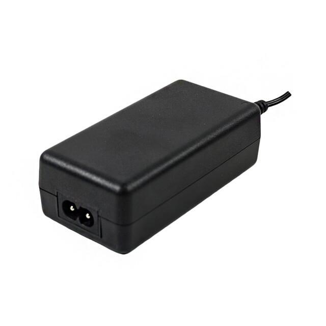

SDM36-18-UDC-P6 数据手册
Additional Resources: Product Page | 3D Model date 05/23/2022 page 1 of 6 SERIES: SDM36-UD │ DESCRIPTION: AC-DC POWER SUPPLY FEATURES • • • • • • • • • up to 36 W continuous power meets DoE Level VI efficiency universal input voltage range compact size no load power consumption < 0.10 W over voltage and short circuit protections UL/cUL, TUV (60601-1), and PSE safety approvals LED indicator custom designs available MODEL output voltage output current output power ripple and noise1 (Vdc) max (A) max (W) max (mVp-p) 5 5 25 80 VI 7.5 4 30 80 VI 9 4 36 90 VI SDM36-5-UD SDM36-7.5-UD SDM36-9-UD efficiency level SDM36-12-UD 12 3 36 120 VI SDM36-15-UD 15 2.4 36 150 VI SDM36-18-UD 18 2 36 180 VI SDM36-24-UD 24 1.5 36 240 VI Notes: 1. At full load, nominal input, 20 MHz bandwidth oscilloscope, output terminated with 0.1 μF multilayer ceramic and 10 μF low ESR electrolytic capacitors. PART NUMBER KEY SDM36 - XX - UDX - XXX - CXX Base Number Output Voltage AC Inlet Type: IEC320/C8 Input Cable: “Blank” = No Cable C = North America input cable 2 = Europe input cable cui.com Reserved for Custom Configurations DC Plug Type: XXX = See output plug options on page 5 for more details Additional Resources: Product Page | 3D Model CUI Inc │ SERIES: SDM36-UD │ DESCRIPTION: AC-DC POWER SUPPLY date 05/23/2022 │ page 2 of 6 INPUT parameter max units voltage conditions/description min 90 typ 264 Vac frequency 47 63 Hz 1 A current inrush current at 230 Vac, full load, 25°C, cold start leakage current no load power consumption at 230 Vac 70 A 0.1 mA 0.10 W max units OUTPUT parameter conditions/description regulation 5 Vdc model all other models min typ ±6 ±5 % % PROTECTIONS parameter conditions/description min over voltage protection over current protection short circuit protection output shut down, auto recovery typ max units output shut down 200 % output shut down, auto recovery 200 % max units SAFETY & COMPLIANCE parameter conditions/description min isolation voltage input to output at 10 mA for 1 minute isolation resistance input to output at 500 Vdc safety approvals Medical: UL/cUL, TUV (60601-1) ITE: PSE UKCA EMI/EMC FCC Part 15B Class B, CE MTBF as per Telcordia SR-332, 25°C RoHS 2011/65/EU typ 4,000 Vac 10 MΩ 300,000 hours ENVIRONMENTAL parameter conditions/description min operating temperature storage temperature typ max units 0 40 °C -20 80 °C operating humidity non-condensing 20 80 % storage humidity non-condensing 10 90 % cui.com Additional Resources: Product Page | 3D Model CUI Inc │ SERIES: SDM36-UD │ DESCRIPTION: AC-DC POWER SUPPLY date 05/23/2022 │ page 3 of 6 MECHANICAL parameter conditions/description dimensions 99 x 50 x 33 inlet plug IEC320/C8 weight without ac cord min typ max units mm 210 MECHANICAL DRAWING units: mm tolerance:±1.0 mm DC CORD units: mm Table 1 MODEL NO. CABLE CORD LENGTH SDM36-5-UD UL2468, 16 AWG 1,500 mm ±30 SDM36-7.5-UD UL2468, 18 AWG 1,500 mm ±30 SDM36-9-UD UL2468, 18 AWG 1,500 mm ±30 SDM36-12-UD UL2468, 18 AWG 1,500 mm ±30 SDM36-15-UD UL2468, 18 AWG 1,500 mm ±30 SDM36-18-UD UL2468, 20 AWG 1,500 mm ±30 SDM36-24-UD UL2468, 20 AWG 1,500 mm ±30 cui.com g Additional Resources: Product Page CUI Inc │ SERIES: SDM36-UD │ DESCRIPTION: AC-DC POWER SUPPLY | 3D Model date 05/23/2022 │ page 4 of 6 AC CORDS units: mm NORTH AMERICA EUROPE cui.com Additional Resources: Product Page | 3D Model CUI Inc │ SERIES: SDM36-UD │ DESCRIPTION: AC-DC POWER SUPPLY date 05/23/2022 │ page 5 of 6 DC PLUG TYPE PART NUMBER KEY XXX Plug Polarity: P = Center Positive Plug Code: X = Choose a code from the options below Plug Angle: “blank” = Straight R = Right Angle N = Center Negative Plug Polarity Code Dimensions (mm) Plug Angle Center Pos. Center Neg. Option Type A B C Straight Right ● ● 5 Standard 5.5 2.1 9.5 ● ● ● ● 6 Standard 5.5 2.5 9.5 ● ● ● ● 7 Standard 3.5 1.35 9.5 ● ● ● ● 8 Standard 3.8 1.35 9.5 ● ● ● ● 9 Standard 3.8 1.05 9.5 ● ● ● ● 10 Locking2 5.5 2.1 9.5 ● N/A ● ● 11 Locking2 5.5 2.5 9.5 ● N/A ● ● 12 EIAJ-1 2.35 0.7 9.5 ● ● ● ● 13 EIAJ-2 4.0 1.7 9.5 ● ● ● ● 14 EIAJ-3 4.75 1.7 9.5 ● ● N/A N/A ST N/A N/A N/A N/A MUB ● N/A Stripped & Tinned USB Micro USB Type B Note: 1. Contact CUI for additional plug options 2. Maximum insertion depth is 10mm Locking A B B C Right Angle (R) C Straight B C A C Straight Right Angle (R) Stripped & Tinned USB 5.4±0.4 2.5±0.3 A B C EIAJ A A B Standard P5(-) cui.com P1(+) Additional Resources: Product Page | 3D Model CUI Inc │ SERIES: SDM36-UD │ DESCRIPTION: AC-DC POWER SUPPLY date 05/23/2022 │ page 6 of 6 REVISION HISTORY rev. description date 1.0 initial release 01/29/2018 1.01 updated datasheet 06/14/2019 1.02 company logo update 07/23/2020 1.03 UKCA added to safety 05/20/2021 dc plugs updated 05/23/2022 1.04 The revision history provided is for informational purposes only and is believed to be accurate. Headquarters 20050 SW 112th Ave. Tualatin, OR 97062 800.275.4899 Fax 503.612.2383 cui.com techsupport@cui.com This device complies with part 15 of the FCC Rules. Operation is subject to the following two conditions: (1) This device may not cause harmful interference, and (2) this device must accept any interference received, including interference that may cause undesired operation. CUI offers a one (1) year limited warranty. Complete warranty information is listed on our website. CUI reserves the right to make changes to the product at any time without notice. Information provided by CUI is believed to be accurate and reliable. However, no responsibility is assumed by CUI for its use, nor for any infringements of patents or other rights of third parties which may result from its use. CUI products are not authorized or warranted for use as critical components in equipment that requires an extremely high level of reliability. A critical component is any component of a life support device or system whose failure to perform can be reasonably expected to cause the failure of the life support device or system, or to affect its safety or effectiveness.
SDM36-18-UDC-P6
物料型号:SDM36-UD系列,包含多个型号,如SDM36-5-UD、SDM36-7.5-UD等,每个型号具有不同的输出电压和电流。
器件简介:这是一款AC-DC电源模块,具有高达36W的连续功率输出,满足DoE Level VI能效标准,具有全球通用的输入电压范围,紧凑的尺寸,空载功耗小于0.10W,并具备过压和短路保护。
引脚分配:文档中未提供详细的引脚分配信息。
参数特性:包括输入电压范围90至264Vac,频率47至63Hz,最大输入电流1A,空载功耗0.10W,以及不同型号的输出电压和电流。
功能详解:具备过压保护、过流保护和短路保护,输出关闭并自动恢复。
应用信息:适用于需要高能效和紧凑尺寸的AC-DC电源转换场合。
封装信息:尺寸为99x50x33mm,重量约210g(不含交流电源线),AC输入插座类型为IEC320/C8。
