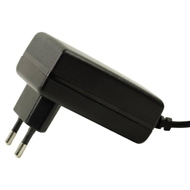

    AC/DC WALL MOUNT ADAPTER 18V 30W
SWM30-18-EV-P6 数据手册
Additional Resources: Product Page | 3D Model date 08/25/2020 page 1 of 5 SERIES: SWM30-E │ DESCRIPTION: AC-DC POWER SUPPLY FEATURES • • • • • • • • up to 30 W power EN 60601-1 4th edition compact design universal input (90~264 Vac) single regulated output from 5~48 Vdc over voltage and short circuit protections DOE Level VI / CoC Tier 2 efficiency 2 MOPP compliant MODEL SWM30-5-EV SWM30-9-EV output voltage output current output power ripple and noise1 efficiency level2 (Vdc) max (A) max (W) max (mVp-p) 5 4.0 20 100 VI 9 3.0 27 180 VI SWM30-12-EV 12 3.0 36 250 VI SWM30-15-EV 15 2.0 30 250 VI SWM30-18-EV 18 1.66 30 350 VI SWM30-24-EV 24 1.50 36 350 VI SWM30-36-EV 36 0.83 30 480 VI SWM30-48-EV 48 0.62 30 480 VI Notes: 1. At full load, 100 ~ 240 Vac input, 20 MHz bandwidth oscilloscope, output terminated with a low ESR 47 μF electrolytic and 0.1 μF multilayer capacitor. 2. CoC Tier 2 compliant. PART NUMBER KEY SWM30 - XX - E V - XXX - CXX Reserved for Custom Configurations Base Number Output Voltage AC Input Type: Europe cui.com Orientation: V = vertical DC Plug Type: XXX = See output plug options on page 4 for more details Additional Resources: Product Page | 3D Model CUI Inc │ SERIES: SWM30-E │ DESCRIPTION: AC-DC POWER SUPPLY date 08/25/2020 │ page 2 of 5 INPUT parameter conditions/description min voltage typ 90 frequency 47 max units 264 Vac 63 Hz current at 115 Vac, full load at 230 Vac, full load 0.6 0.3 A A inrush current at 115 Vac, full load, cold start at 230 Vac, full load, cold start 30 60 A A leakage current at 240 Vac, 50 Hz 0.1 mA no load power consumption at 115/230 Vac, 60/50 Hz 0.075 W max units OUTPUT parameter conditions/description min line regulation typ ±1 load regulation % ±5 start-up time at 220 Vac, to 90% of rated output voltage rise time at nominal input voltage, full load, from 10% to 90% of output voltage hold-up time at nominal input voltage, full load 8.3 parameter conditions/description min over voltage protection output shutdown, auto recovery over current protection output shutdown, auto recovery short circuit protection output shut down, auto recovery % 3 s 50 ms ms PROTECTIONS typ max units 200 % max units SAFETY & COMPLIANCE parameter conditions/description isolation voltage input to output min isolation resistance input to output at 500 Vdc for 3 seconds safety approvals medical TUV EN 60601-1 EMI/EMC CE MTBF as per MIL-HDBK-217F RoHS 2011/65/EU typ 4,000 Vac 50 MΩ 100,000 hours ENVIRONMENTAL parameter conditions/description min operating temperature storage temperature typ max units 0 40 °C -20 85 °C operating humidity non-condensing 10 90 % storage humidity non-condensing 5 90 % altitude 5,000 cui.com m Additional Resources: Product Page | 3D Model CUI Inc │ SERIES: SWM30-E │ DESCRIPTION: AC-DC POWER SUPPLY date 08/25/2020 │ page 3 of 5 MECHANICAL parameter conditions/description dimensions 76 x 43 x 48 inlet plug Europe min 200 black MECHANICAL DRAWING units: mm tolerance: ±1 mm 48±1 76±1 43±1 DC CORD units: mm max units mm weight color typ cord length f Table 1 MODEL NO. CABLE CORD LENGTH SWM30-5-EV UL1185, 16 AWG 1,200 mm ±30 SWM30-9-EV UL1185, 16 AWG 1,200 mm ±30 SWM30-12-EV UL1185, 16 AWG 1,200 mm ±30 SWM30-15-EV UL1185, 16 AWG 1,200 mm ±30 SWM30-18-EV UL1185, 18 AWG 1,200 mm ±30 SWM30-24-EV UL1185, 18 AWG 1,200 mm ±30 SWM30-36-EV UL1185, 18 AWG 1,200 mm ±30 SWM30-48-EV UL1185, 18 AWG 1,200 mm ±30 cui.com g Additional Resources: Product Page | 3D Model CUI Inc │ SERIES: SWM30-E │ DESCRIPTION: AC-DC POWER SUPPLY date 08/25/2020 │ page 4 of 5 DC PLUG TYPE PART NUMBER KEY XXX Plug Polarity: P = Center Positive Plug Code: X = Choose a code from the options below Plug Angle: “blank” = Straight R = Right Angle N = Center Negative Plug Polarity Code Dimensions (mm) Plug Angle Center Pos. Center Neg. Option Type A B C Straight Right ● ● 5 Standard 5.5 2.1 9.5 ● ● ● ● 6 Standard 5.5 2.5 9.5 ● ● ● ● 7 Standard 3.5 1.35 9.5 ● ● ● ● 8 Standard 3.8 1.35 9.5 ● ● ● ● 9 Standard 3.8 1.05 9.5 ● ● ● ● 12 EIAJ-1 2.35 0.7 9.5 ● ● ● ● 13 EIAJ-2 4.0 1.7 9.5 ● ● ● ● 14 EIAJ-3 4.75 1.7 9.5 ● ● N/A ST N/A N/A N/A Stripped & Tinned 1. Contact CUI for additional plug options EIAJ Straight C A B B C Right Angle (R) Straight Stripped & Tinned 5±1 10±3 cui.com C A C A A B Standard B Note: Right Angle (R) Additional Resources: Product Page | 3D Model CUI Inc │ SERIES: SWM30-E │ DESCRIPTION: AC-DC POWER SUPPLY date 08/25/2020 │ page 5 of 5 REVISION HISTORY rev. description date 1.0 initial release 06/27/2017 1.01 company logo updated 08/25/2020 The revision history provided is for informational purposes only and is believed to be accurate. Headquarters 20050 SW 112th Ave. Tualatin, OR 97062 800.275.4899 Fax 503.612.2383 cui.com techsupport@cui.com This device complies with part 15 of the FCC Rules. Operation is subject to the following two conditions: (1) This device may not cause harmful interference, and (2) this device must accept any interference received, including interference that may cause undesired operation. CUI offers a one (1) year limited warranty. Complete warranty information is listed on our website. CUI reserves the right to make changes to the product at any time without notice. Information provided by CUI is believed to be accurate and reliable. However, no responsibility is assumed by CUI for its use, nor for any infringements of patents or other rights of third parties which may result from its use. CUI products are not authorized or warranted for use as critical components in equipment that requires an extremely high level of reliability. A critical component is any component of a life support device or system whose failure to perform can be reasonably expected to cause the failure of the life support device or system, or to affect its safety or effectiveness.
