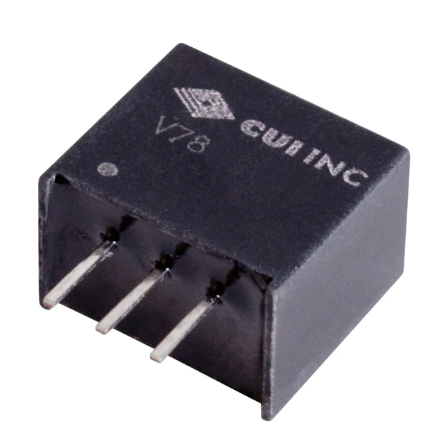

    CONVERTER DC/DC REG 6.5V 500MA
V7806-500 数据手册
rev. rev. page date 1 of 6 06/2008 PART NUMBER: V78XX-500 series DESCRIPTION: DC switching regulator, non-isolated description The V78XX series of switching regulators are designed to replace 78XX linear regulators, with the objective of drop-in replacement without the need for a heatsink, because the V78XX series features high efficiency under all line conditions. Built-in short-circuit and over-temperature protections ensure very rugged operations. Additionally, low ripple and noise performance make the parts useful in a wide range of applications. features · efficiency up to 96% ·no need for heatsinks ·wide input range ·short circuit protection ·thermal shutdown ·low ripple and noise ·pin compatible to LM78XX series ·non-isolated model number V7803-500 V7805-500 V7806-500 V7809-500 V7812-500 V7815-500 input voltage range 4.75~28 Vdc 6.5~32 Vdc 8~32 Vdc 11~32 Vdc 15~32 Vdc 18~32 Vdc output voltage 3.3 Vdc 5 Vdc 6.5 Vdc 9 Vdc 12 Vdc 15 Vdc output current 500 mA 500 mA 500 mA 500 mA 500 mA 500 mA efficiency Vin_min Vin_max 90% 80% 93% 84% 94% 87% 95% 91% 95% 92% 96% 93% *see Application Notes section (page 5) for positive to negative conversion options. OUTPUT SPECIFICATIONS item output voltage accuracy line regulation load regulation output ripple short circuit protection short circuit input power output current limit switching frequency dynamic load stability quiescent current thermal shutdown temperature coefficient max load capacitance conditions min. at 100% load Vin = min. to max. at full load 10% to 100% full load 20 MHz bandwidth, output w/ 10μF cap continuous, auto recovery upon removal of short load impedance is ≤ 0 .1 Ω subject to over-temp shutdown fixed switching frequency topology 280 100%10% load Vin_min to Vin_max at no load internal IC junction -40°C ~ 85°C ambient typ. ±2 ±0.2 ±0.4 20 0.3 330 5 150 max. ±3 ±0.4 ±0.6 35 0.8 2000 450 ±100 7 0.02 1000 unit % % % mVp-p W mA KHz mV mA °C %/°C μF GENERAL SPECIFICATIONS item operating temperature range operating case temperature storage temperature range cooling solderability storage humidity range case material case thermal impedance MTBF package weight conditions see derating curve min. -40 -40 -55 typ. max. 85 100 125 300 95 70 at 25°C per MIL-HDBK-217F 2,000,000 2.0 unit °C °C °C °C % °C/W hours grams free air convection 1.5 mm from case for 10 seconds relative humidity, non-condensing plastic (UL94-V0) 10 20050 SW 112th Ave. Tualatin, Oregon 97062 phone 503.612.2300 fax 503.612.2382 phone fax rev. page date 2 of 6 06/2008 PART NUMBER: V78XX-500 series DESCRIPTION: DC switching regulator, non-isolated MECHANICAL DRAWINGS Recommended PCB Layout Pattern 11.50 0.453 7.65 0.301 1.00 +0.15/-0 [0.040 +0.006/-0] 2.54 [0.100] 1 2 3 10.20 0.402 0.50 0.020 (TYP) 4.00 (3 PLCS) 2.54 [0.100] Top View 0.50 0.020 (3 PLCS) 1 2 3 PIN 1 3.21 0.126 2 3 ASSIGNMENTS +Vin GND +Vout 5.08 0.200 0.30 0.012 (3 PLCS) 2.10 0.083 (3 PLCS) 2.54 0.100 (2 plcs) units: mm(inches) pin tolerances: ±0.10(±0.004) general tolerances: ±0.25(±0.01) THERMAL DERATING CURVE Temperature Derating Graph Operating Temp.( C ) 20050 SW 112th Ave. Tualatin, Oregon 97062 phone 503.612.2300 fax 503.612.2382 phone fax rev. page date 3 of 6 06/2008 PART NUMBER: V78XX-500 series DESCRIPTION: DC switching regulator, non-isolated TYPICAL APPLICATION CIRCUIT Vin 1 V78XX-500 2 3 Vout C1 10 μ F/50V GND C2 100μ F/25V INPUT CAPACITOR (C1): A low ESR capacitor is recommended to keep the noise at the converter to a minimum. Ceramic capacitors are preferred but tantalum or low ESR electrolytic capacitors may also suffice. Place C1 as close as possible to pins 1 & 2. OUTPUT CAPACITOR (C2): A 100μF/25V electrolytic capacitor is recommended. TEST CIRCUIT FOR EFFICIENCY & RIPPLE GRAPHS (PAGE4) Current Meter Current Meter Electronic Load + DC Power Source Voltage Meter Cin +Vin +Vout DC/DC Converter GND 0V 30cm, 18AWG A Cout B Voltage Meter Twisted 20MHz Oscilloscope A C01 + +A C02 B A 1. Cin = 10μF / 50V for 500mA and 22μF / 50V for 1A, Cout = 100μF / 16V. 2. C01 = 10μF / 50V Electrolytic, C02 = 0.1μF / 50V Ceramic. 3. All points labeled A refer to one junction. 4. All points labeled B refer to one junction. 5. Use a short ground loop for probing. Do not use a wired ground clip. B B - 20050 SW 112th Ave. Tualatin, Oregon 97062 phone 503.612.2300 fax 503.612.2382 phone fax rev. page date 4 of 6 06/2008 PART NUMBER: V78XX-500 series DESCRIPTION: DC switching regulator, non-isolated EFFICIENCY AND RIPPLE Efficiency 100 95 90 Output Ripple 50 40 Ripple (mVpp) Efficiency (%) 85 80 75 70 65 60 55 50 10 20 30 32 V7803-500 V7805-500 V7806-500 V7809-500 V7812-500 V7815-500 30 20 10 0 10 20 30 32 V7803-500 V7805-500 V7806-500 V7809-500 V7812-500 V7815-500 Vin(V) Vin(V) Efficiency vs. Vin (Full Load) Ripple vs. Vin ( Full Load) 100 95 90 50 40 Ripple (mVpp) Efficiency (%) 85 80 75 70 65 60 100 200 300 400 500 Output Current(mA) Efficiency vs. Load (Vin=Vin_min) 600 V7803-500 V7805-500 V7806-500 V7809-500 V7812-500 V7815-500 30 20 10 0 100 200 300 400 500 600 Output Current (mA) Ripple vs. Load (Vin=Vin_min) V7803-500 V7805-500 V7806-500 V7809-500 V7812-500 V7815-500 100 90 80 V7803-500 V7805-500 V7806-500 V7809-500 V7812-500 V7815-500 50 40 Ripple (mVpp) V7803-500 V7805-500 V7806-500 V7809-500 V7812-500 V7815-500 Efficiency (%) 70 60 50 40 30 20 100 200 300 400 500 Output Current (mA) Efficiency vs. Load (Vin=Vin_max) 600 30 20 10 0 100 200 300 400 500 600 Output Current (mA) Ripple vs. Load (Vin=24V) 20050 SW 112th Ave. Tualatin, Oregon 97062 phone 503.612.2300 fax 503.612.2382 phone fax rev. page date 5 of 6 06/2008 PART NUMBER: V78XX-500 series DESCRIPTION: DC switching regulator, non-isolated APPLICATION NOTES: Positive to Negative conversion option application The V78XX-500 series converters can also be used to convert a positive voltage into a negative voltage with only two extra capacitors needed. model number V7803-500 V7805-500 V7806-500 V7809-500 V7812-500 V7815-500 input voltage range 4.75~25 Vdc 6~27 Vdc 6~25 Vdc 7~23 Vdc 7~20 Vdc 7~17 Vdc output voltage -3.3 Vdc -5 Vdc -6.5 Vdc -9 Vdc -12 Vdc -15 Vdc output current 400 mA 400 mA 300 mA 200 mA 200 mA 200 mA efficiency Vin_min Vin_max 73% 78% 76% 83% 83% 85% 87% 86% 85% 87% 84% 89% OUTPUT SPECIFICATIONS item output voltage accuracy line regulation load regulation output ripple short circuit protection short circuit input power switching frequency dynamic load stability quiescent current thermal shutdown temperature coefficient max load capacitance conditions min. at 100% load Vin = min. to max. at full load 10% to 100% full load 20 MHz bandwidth, output w/ 10μF cap continuous, auto recovery upon removal of short fixed switching frequency topology 100%10% load Vin_min to Vin_max at no load internal IC junction -40°C ~ 85°C ambient 280 typ. ±2 ±0.2 ±0.4 20 0.5 330 7 150 max. ±3 ±0.4 ±0.6 35 1.2 450 ±100 10 0.02 1000 unit % % % mVp-p W KHz mV mA °C %/°C μF TYPICAL CHARACTERISTICS 20050 SW 112th Ave. Tualatin, Oregon 97062 phone 503.612.2300 fax 503.612.2382 phone fax rev. page date 6 of 6 06/2008 PART NUMBER: V78XX-500 series DESCRIPTION: DC switching regulator, non-isolated TYPICAL APPLICATION CIRCUITS 1. Negative output 2. Positive and Negative outputs EXTERNAL CAPACITOR TABLE 20050 SW 112th Ave. Tualatin, Oregon 97062 phone 503.612.2300 fax 503.612.2382 phone fax
