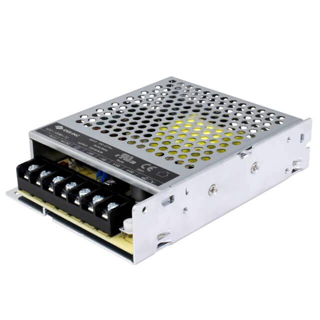

VGS-100W-24 数据手册
Additional Resources: Product Page | 3D Model date 06/04/2021 page 1 of 5 SERIES: VGS-100W │ DESCRIPTION: INTERNAL AC-DC POWER SUPPLY FEATURES • • • • • • wide input range (85 ~ 305 VAC) available with conformal coating or terminal cover options UL/EN/IEC 62368 certified designed to meet IEC/EN 61558 and IEC/EN 60335 system requirements short-circuit, over-current, over-voltage protections CISPR/EN55032 Class B radiated/conducted emissions MODEL output voltage output current output power ripple and noise1 efficiency² (Vdc) max (A) max (W) typ (mVp-p) typ (%) 5 18.0 90 100 85.5 VGS-100W-12 12 8.5 102 120 87.0 VGS-100W-15 15 7.0 105 120 87.0 VGS-100W-24 24 4.5 108 150 89.5 VGS-100W-36 36 2.8 100 200 89.5 VGS-100W-48 48 2.3 110 200 90.5 VGS-100W-5 Notes: 1. Ripple & noiswe are measured at 20 MHz BW with 47 µF aluminum electrolytic capacitor and 0.1 µF ceramic capacitor on the output. 2. Measured at 230 Vac. PART NUMBER KEY VGS-100W-XX-X Base Number Output Voltage cui.com A - with terminal cover B - with conformal coating Additional Resources: Product Page | 3D Model CUI Inc │ SERIES: VGS-100W │ DESCRIPTION: AC-DC POWER SUPPLY date 06/04/2021 │ page 2 of 5 INPUT parameter conditions/description min max units voltage ac input dc input 85 120 305 431 Vac Vdc 47 63 Hz 3 1.5 A A frequency current typ at 115 Vac at 230 Vac inrush current at 115 Vac, cold start at 230 Vac, cold start 35 65 leakage current at 277 Vac no load power consumption at 230 Vac, 5 Vdc, 12 Vdc, 15 Vdc, 24 Vdc output at 230 Vac, 36 Vdc, 48 Vdc output A A 0.75 mA 0.3 0.5 W W max units 10,000 6,800 3,300 2,200 1,000 470 μF μF μF μF μF μF OUTPUT parameter conditions/description capacitive load 5 Vdc output 12 Vdc output 15 Vdc output 24 Vdc output 36 Vdc output 48 Vdc output line regulation rated load ±0.5 % load regulation 0% ~ 100%, 5 Vdc output 0% ~ 100%, other outputs ±1 ±0.5 % % 10 55 ms ms 65 kHz ±0.03 %/°C ±10 % ±2 ±1 % % hold-up time min at 115 Vac at 230 Vac switching frequency temperature coefficient adjustability built in trim pot initial set point accuracy 5 Vdc output other outputs typ PROTECTIONS parameter conditions/description min over voltage protection 5 Vdc output, clamp, auto recovery 12 Vdc output, clamp, auto recovery 15 Vdc output, clamp, auto recovery 24 Vdc output, clamp, auto recovery 36 Vdc output, clamp, auto recovery 48 Vdc output, clamp, auto recovery over current protection auto recovery short circuit protection continuous, hiccup, auto recovery typ 110 max units 7.5 19.2 24 38.4 57.6 60 Vdc Vdc Vdc Vdc Vdc Vdc 160 % max units SAFETY & COMPLIANCE parameter conditions/description min isolation voltage input to ground, 1 min.
