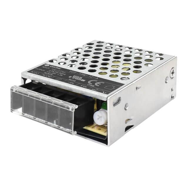

Additional Resources: Product Page | 3D Model date 07/06/2022 page 1 of 6 SERIES: VGS-15W │ DESCRIPTION: AC-DC POWER SUPPLY FEATURES • • • • • • • wide input range (85 ~ 305 Vac) available with conformal coating or terminal cover options UL/EN/IEC 62368 certified designed to meet IEC/EN 61558 system requirements short-circuit, over-current, over-voltage protections input over voltage category III design CISPR/EN55032 Class B radiated/conducted emissions RoHS MODEL output voltage output current output power ripple and noise� efficiency2 max (W) max (mVp-p) typ (%) typ (Vdc) range (Vdc) max (A) VGS-15W-3 3.3 2.85~3.6 3.0 9.9 80 73 VGS-15W-5 5 4.5~5.5 3.0 15.0 80 78 VGS-15W-12 12 10.2~13.8 1.3 15.6 120 82 VGS-15W-15 15 13.5~18.0 1.0 15.0 120 82 VGS-15W-24 24 21.6~28.8 0.625 15.0 150 83 VGS-15W-48 48 42.0~54.0 0.32 15.36 150 83 Notes: 1. Ripple & noise are measured at 20 MHz BW with 47 uF electrolytic and 0.1 uf ceramic capacitors on the output. 2. Measured at 230 Vac. PART NUMBER KEY VGS-15W - XX - X Base Number Output Voltage cui.com A - with terminal cover B - with conformal coating Additional Resources: Product Page | 3D Model CUI Inc │ SERIES: VGS-15W │ DESCRIPTION: AC-DC POWER SUPPLY date 07/06/2022 │ page 2 of 6 INPUT parameter conditions/description min max units voltage range ac input dc input 85 100 305 430 Vac Vdc 47 63 Hz 0.35 0.25 A A frequency range current at 115 Vac at 230 Vac inrush current at 115 Vac at 230 Vac leakage current at 277 Vac no load power consumption at 230 Vac 5 V, 12 V & 24 V models all other models typ 30 50 A A 0.5 mA 0.35 0.5 W W max units 3,000 2,400 1,800 1,200 600 300 μF μF μF μF μF μF OUTPUT parameter conditions/description capacitive load 3.3 V models 5 V models 12 V models 15 V models 24 V models 48 V models initial set point acuracy 3.3 V models, full load 5 V models, full load all other models, full load line regulation load regulation min ±3 ±2 ±1 % % % 3.3 & 5 V models, rated load all other models, rated load ±1.0 ±0.5 % % 3.3 & 5 V models, 0~100% load all other models, 0~100% load ±1.0 ±0.5 % % 65 kHz 7 48 ms ms switching frequency hold-up time typ at 115 Vac at 230 Vac PROTECTIONS parameter conditions/description min over current protection auto recovery 110 over voltage protection 3.3 & 5 V models, hiccup or clamp 12 V models, hiccup or clamp 15 V models, hiccup or clamp 24 V models, hiccup or clamp 48 V models, hiccup or clamp short circuit protection continuous, auto recovery, hiccup typ max units 200 % 6.75 16.2 21.8 33.6 60.0 Vdc Vdc Vdc Vdc Vdc max units SAFETY & COMPLIANCE parameter conditions/description min isolation voltage input to output, 1 min,
