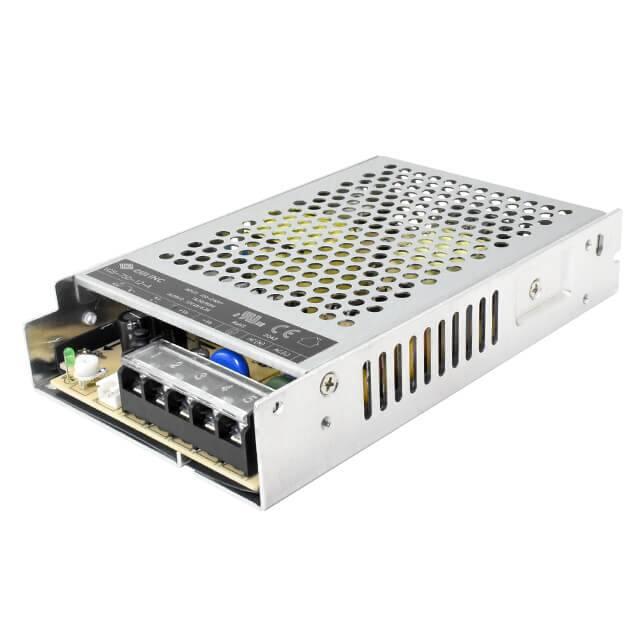

VGS-75D-24-A 数据手册
Additional Resources: Product Page date 02/06/2023 page 1 of 6 SERIES: VGS-75D Ϳ DESCRIPTION: INTERNAL AC-DC POWER SUPPLY FEATURES ED available with conformal coating or terminal cover options active Power Factor Correction (PFC) certified to IEC/EN/UL 62368 designed to meet IEC/EN 61558, IEC/EN 60335, and GB4943 output over voltage, over current, over temperature, short circuit protection CISPR/EN55032 Class B radiated/conducted emissions input over voltage category III for fixed installations 300 VAC surge resilience (5 seconds) MODEL output voltage rangeӼ (Vdc) 5 VGS-75D-12 12 VGS-75D-15 15 VGS-75D-24 24 VGS-75D-48 48 output power ripple and noise2 HϒFLHQF\3 max (A) max (W) max (mVp-p) W\S (%) 4.75 ~ 5.5 15.0 75.0 120 82 11.4 ~ 13.2 6.3 75.6 120 85 14.3 ~ 16.5 5.0 75.0 120 86 22.8 ~ 26.4 3.2 76.8 120 87 45.6 ~ 52.8 1.6 76.8 200 89 N VGS-75D-54 output current TI (Vdc) 1. Output adjustable via built-in trimpot. The actual adjustment range may extend beyond the values listed and care should be taken to ensure the output voltage and output power do not exceed stated limits. 2. Ripple & noise are measured at 20 MHz BW with 47 µF aluminum electrolytic capacitor and 0.1 µF ceramic capacitor on the output. 3. Measured at 230 Vac. 4. Discontinued model - with terminal cover option O Notes: N U • • • • • • • • VGS-75D - XX - X Base Number Output Voltage D IS C PART NUMBER KEY cui.com A - with terminal cover B - with conformal coating Additional Resources: Product Page CUI Inc Ϳ SERIES: VGS-75D Ϳ DESCRIPTION: AC-DC POWER SUPPLY date 02/06/2023 Ϳ page 2 of 6 INPUT parameter conditions/description min max units voltage ac input dc input 85 120 264 370 Vac Vdc 47 63 Hz current at 115 Vac at 230 Vac inrush current at 115 Vac, cold start at 230 Vac, cold start leakage current at 240 Vac power factor at 115 Vac at 230 Vac ED frequency 1.0 0.6 20 35 capacitive load 5 Vdc output 12 Vdc output 15 Vdc output 24 Vdc output 48 Vdc output initial set point accuracy at full load U conditions/description min N parameter TI line regulation load regulation 5 Vdc output 0%~100% load other outputs 0%~100% load hold-up time at 230 Vac conditions/description O parameter min 5 Vdc output model, output shut down, latched 12 Vdc output model, output shut down, latched 15 Vdc output model, output shut down, latched 24 Vdc output model, output shut down, latched 48 Vdc output model, output shut down, latched mA W\S max units 10,000 6,000 5,000 1,500 680 Nj) Nj) Nj) Nj) Nj) ±2 % ±0.5 % ±1 ±0.5 % % ms ±0.03 %/°C W\S max units 7.0 20.0 25.0 32.4 60.0 Vdc Vdc Vdc Vdc Vdc 85 °C °C 105 C auto-recovery short circuit protection constant current, continuous, auto-recovery IS over temperature protectionӼ over temperature protection activation over temperature protection deactivation 1. Over temperature protection thresholds under full load conditions. D Note: 2 16 N PROTECTIONS over current protection A A module on (0 ~ 0.8 Vdc) PRGXOHRϑ a9GF UHPRWHRQRϑ &75/ over voltage protection A A 0.98 0.93 OUTPUT WHPSHUDWXUHFRHϒFLHQW W\S cui.com 50 % Additional Resources: Product Page CUI Inc Ϳ SERIES: VGS-75D Ϳ DESCRIPTION: AC-DC POWER SUPPLY date 02/06/2023 Ϳ page 3 of 6 SAFETY & COMPLIANCE parameter conditions/description isolation voltage input to ground, 1 min,
