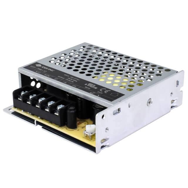

Additional Resources: Product Page | 3D Model date 06/10/2022 page 1 of 5 SERIES: VGS-75W │ DESCRIPTION: INTERNAL AC-DC POWER SUPPLY FEATURES • • • • • • wide input range (85 ~ 305 VAC) available with conformal coating or terminal cover options UL/EN/IEC 62368 certified designed to meet IEC/EN 61558 and IEC/EN 60335 system requirements short-circuit, over-current, over-voltage protections CISPR/EN55032 Class B radiated/conducted emissions MODEL output voltage output current output power ripple and noise1 efficiency2 (Vdc) max (A) max (W) typ (mVp-p) typ (%) 5 14.0 70 100 85 VGS-75W-12 12 6.0 72 120 87 VGS-75W-15 15 5.0 75 120 87 VGS-75W-24 24 3.2 76 150 89 VGS-75W-36 36 2.1 75 200 89 VGS-75W-48 48 1.6 76 200 90.5 VGS-75W-5 Notes: 1. Ripple & noise are measured at 20 MHz BW with 47 µF aluminum electrolytic capacitor and 0.1 µF ceramic capacitor on the output. 2. Measured at 230 Vac PART NUMBER KEY VGS-75W - XX - X Base Number Output Voltage cui.com A = with terminal cover B = with conformal coating Additional Resources: Product Page | 3D Model CUI Inc │ SERIES: VGS-75W │ DESCRIPTION: AC-DC POWER SUPPLY date 06/10/2022 │ page 2 of 5 INPUT parameter conditions/description min max units voltage ac input dc input 85 120 305 430 Vac Vdc 47 63 Hz 2 1 A A frequency current typ at 115 Vac at 230 Vac inrush current at 115 Vac, full load, cold start at 230 Vac, full load, cold start leakage current at 277 Vac 40 75 no load power consumption A A 0.75 mA 0.5 W max units 10,000 6,000 5,000 1,500 1,000 680 μF μF μF μF μF μF OUTPUT parameter conditions/description capacitive load 5 Vdc output 12 Vdc output 15 Vdc output 24 Vdc output 36 Vdc output 48 Vdc output line regulation rated load ±0.5 % load regulation 0% ~ 100%, 5 Vdc output 0% ~ 100%, 12, 15, 24, 36, 48 Vdc output ±1 ±0.5 % hold-up time min at 115 Vac at 230 Vac 8 55 switching frequency temperature coefficient at 230 Vac, 0°C to 50°C adjustability built in trim pot initial set point accuracy 5 Vdc output other outputs typ ms ms 65 kHz ±0.03 %/°C ±10 % ±2 ±1 % % PROTECTIONS parameter conditions/description over voltage protection 5 Vdc output, clamp, auto recovery 12 Vdc output, hiccup, auto recovery 15 Vdc output, hiccup, auto recovery 24 Vdc output, hiccup, auto recovery 36 Vdc output, clamp, auto recovery 48 Vdc output, clamp, auto recovery min over current protection at 230 Vac, rated load, auto recovery short circuit protection hiccup, continuous, auto recovery typ 110 max units 6.3 16.2 21.75 33.6 50.0 60.0 Vdc Vdc Vdc Vdc Vdc Vdc 200 % max units SAFETY & COMPLIANCE parameter conditions/description isolation voltage input to ground, 1 min.
