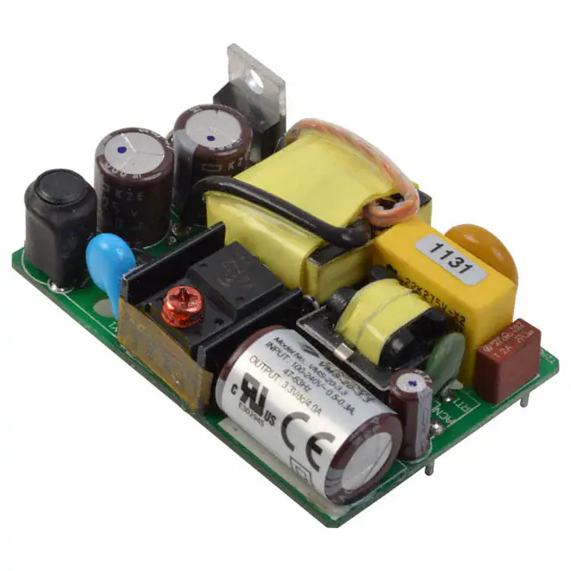

SERIES: VMS-20 │ DESCRIPTION: AC-DC POWER SUPPLY
FEATURES
• • • • • • • • up to 21.6 W continuous power compact size universal input (90 ~ 264 Vac) single output from 3.3 to 24 V no load power < 0.3W over voltage and short circuit protections full medical safety approvals efficiency up to 85%
RoHS
MODEL
VMS-20-3.3 VMS-20-5 VMS-20-9 VMS-20-12 VMS-20-15 VMS-20-24
Notes:
output voltage
(Vdc)
output current
max (A)
output power
max (W)
ripple and noise1
max (mVp-p)
efficiency
typ (%)
3.3 5 9 12 15 24
4.0 4.0 2.3 1.7 1.4 0.9
13.2 20.0 20.7 20.4 21.0 21.6
50 50 90 100 100 100
75 80 81 83 84 85
1. Measured at 20MHz, with 0.1uF ceramic and 10uF electrolytic capacitors
