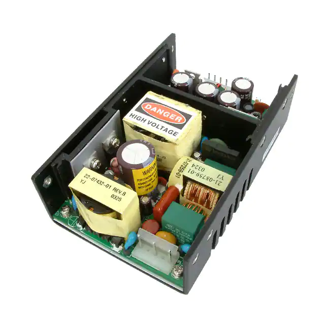

Additional Resources: Product Page | 3D Model date 04/27/2021 page 1 of 4 SERIES: VSUU-150 │ DESCRIPTION: AC-DC POWER SUPPLY FEATURES • • • • • • • • • • • wide input voltage range: 90~264 V ac, 47~63 Hz internal EMI filter single output input connector mates with Molex housing 09-50-3051 and Molex 2478 series crimp terminal output connector mates with Molex housing 09-50-3061 (or 09-50-3081) and Molex 2478 series crimp terminal output voltage available from 9 to 48 V dc input surge current and over load protection over voltage protection (crowbar design) size: 3 x 5 x 1.09 inches class I insulation 2 year warranty RoHS MODEL output voltage output current output power ripple and noise efficiency (Vdc) max (A) max (W) max (mVp-p) typ (%) 9 16 144 90 80 VSUU-150-12 12 12.5 150 120 80 VSUU-150-15 15 10 150 150 80 VSUU-150-18 18 8.33 150 180 80 VSUU-150-24 24 6.25 150 240 80 VSUU-150-30 30 5 150 300 80 VSUU-150-36 36 4.17 150 360 80 VSUU-150-48 48 3.13 150 480 80 VSUU-150-9 PART NUMBER KEY VSBU-150 - XX - X Base Number Output Voltage cui.com Power Fail Detect “Blank” = No P = Yes Additional Resources: Product Page | 3D Model CUI Inc │ SERIES: VSUU-150 │ DESCRIPTION: AC-DC POWER SUPPLY date 04/27/2021 │ page 2 of 4 INPUT parameter conditions/description min voltage typ 90 frequency 47 max units 264 Vac 63 Hz 2.0 0.8 A A 16 56 20 63 A A current at 115 Vac, full load at 230 Vac, full load inrush current at 115 Vac, 25°C, full load, cold start at 230 Vac, 25°C, full load, cold start power factor correction full load at 90 ~ 240 Vac 0.95 0.97 1.0 parameter conditions/description min typ max units line regulation full load 0.5 1 % load regulation at 230 Vac temperature coefficient all output transient response full load to half load at 100 Vac start-up full load at 100 Vac 0.3 hold-up full load at 110 Vac 16 OUTPUT 3 -0.04 1 5 % 0.04 %/°C 4 ms 2 s ms PROTECTIONS parameter max units over voltage protection conditions/description min 112 typ 132 % over current protection 110 150 % max units SAFETY & COMPLIANCE parameter conditions/description min typ isolation voltage primary to secondary primary to earth ground 4,242 2,121 Vdc Vdc isolation resistance test voltage of 500 Vdc 50 MΩ safety approvals UL/cUL, CISPR-22 class B, FCC part 15 class B, CB EMI/EMC CISPR 22 class B, FCC part-15 class B leakage current full load at 240 Vac RoHS compliant yes 0.4 MTBF 0.75 100,000 mA hrs ENVIRONMENTAL parameter conditions/description min operating temperature storage temperature max units 0 typ 70 °C -40 85 °C operating humidity 5 95 % storage humidity 5 95 % cui.com Additional Resources: Product Page | 3D Model CUI Inc │ SERIES: VSUU-150 │ DESCRIPTION: AC-DC POWER SUPPLY date 04/27/2021 │ page 3 of 4 DERATING CURVES output power vs. ambient temperature Load (%) 100 80 60 50 40 20 0 10 20 30 40 50 60 70 Ambient Temperature (°C) MECHANICAL DRAWING CN2 1 V1 2 V1 3 V1 4 V1 5 V1 6 V1 7 com 8 com 9 com 10 com 11 com 12 com 13 n/c *pin 13 for optional power fail detect cui.com Additional Resources: Product Page | 3D Model CUI Inc │ SERIES: VSUU-150 │ DESCRIPTION: AC-DC POWER SUPPLY date 04/27/2021 │ page 4 of 4 REVISION HISTORY rev. description date 1.0 initial release 11/19/2010 1.01 new template applied 07/13/2011 1.02 V-Infinity branding removed 08/22/2012 1.03 updated derating curve 02/12/2013 1.04 company logo updated 10/02/2020 1.05 updated safety marks & safety approvals 04/27/2021 The revision history provided is for informational purposes only and is believed to be accurate. Headquarters 20050 SW 112th Ave. Tualatin, OR 97062 800.275.4899 Fax 503.612.2383 cui.com techsupport@cui.com CUI offers a two (2) year limited warranty. Complete warranty information is listed on our website. CUI reserves the right to make changes to the product at any time without notice. Information provided by CUI is believed to be accurate and reliable. However, no responsibility is assumed by CUI for its use, nor for any infringements of patents or other rights of third parties which may result from its use. CUI products are not authorized or warranted for use as critical components in equipment that requires an extremely high level of reliability. A critical component is any component of a life support device or system whose failure to perform can be reasonably expected to cause the failure of the life support device or system, or to affect its safety or effectiveness.
