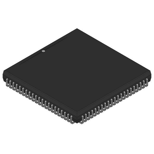

CY7C024/0241 CY7C025/0251 4K x 16/18 and 8K x 16/18 Dual-Port Static RAM with SEM, INT, BUSY Features • True Dual-Ported memory cells which allow simultaneous reads of the same memory location • 4K x 16 organization (CY7C024) • 4K x 18 organization (CY7C0241) • 8K x 16 organization (CY7C025) • 8K x 18 organization (CY7C0251) • 0.65-micron CMOS for optimum speed/power • High-speed access: 15 ns • Low operating power: ICC = 150 mA (typ.) • Fully asynchronous operation • Automatic power-down • Expandable data bus to 32/36 bits or more using Master/Slave chip select when using more than one device • On-chip arbitration logic • Semaphores included to permit software handshaking between ports • INT flag for port-to-port communication • Separate upper-byte and lower-byte control • Pin select for Master or Slave • Available in 84-pin Lead (Pb)-free PLCC, 84-pin PLCC, 100-pin Lead (Pb)-free TQFP, and 100-pin TQFP Functional Description The CY7C024/0241 and CY7C025/0251 are low-power CMOS 4K x 16/18 and 8K x 16/18 dual-port static RAMs. Various arbitration schemes are included on the CY7C024/ 0241 and CY7C025/0251 to handle situations when multiple processors access the same piece of data. Two ports are provided, permitting independent, asynchronous access for reads and writes to any location in memory. The CY7C024/ 0241 and CY7C025/0251 can be utilized as standalone 16-/18-bit dual-port static RAMs or multiple devices can be combined in order to function as a 32-/36-bit or wider master/ slave dual-port static RAM. An M/S pin is provided for implementing 32-/36-bit or wider memory applications without the need for separate master and slave devices or additional discrete logic. Application areas include interprocessor/multiprocessor designs, communications status buffering, and dual-port video/graphics memory. Each port has independent control pins: Chip Enable (CE), Read or Write Enable (R/W), and Output Enable (OE). Two flags are provided on each port (BUSY and INT). BUSY signals that the port is trying to access the same location currently being accessed by the other port. The Interrupt Flag (INT) permits communication between ports or systems by means of a mail box. The semaphores are used to pass a flag, or token, from one port to the other to indicate that a shared resource is in use. The semaphore logic is comprised of eight shared latches. Only one side can control the latch (semaphore) at any time. Control of a semaphore indicates that a shared resource is in use. An automatic power-down feature is controlled independently on each port by a chip select (CE) pin. The CY7C024/0241 and CY7C025/0251 are available in 84-pin Lead (Pb)-free PLCCs, 84-pin PLCCs (CY7C024 and CY7C025 only), 100-pin Lead (Pb)-free Thin Quad Plastic Flatplack (TQFP) and 100-pin Thin Quad Plastic Flatpack. Cypress Semiconductor Corporation Document #: 38-06035 Rev. *C • 3901 North First Street • San Jose, CA 95134 • 408-943-2600 Revised November 11, 2004 CY7C024/0241 CY7C025/0251 Logic Block Diagram L L R/W R UBR L LBR CE R OE R OE L [3] I/O 8L – I/O 15L I/O 0L – I/O 7L [2] [1] I/O CONTROL I/O CONTROL I/O8R – I/O15R[3] I/O 0R– I/O 7R [2] [1] BUSYR A12R (CY7C025/0251) BUSYL (CY7C025/0251) A12L A11L A0L ADDRESS DECODER MEMORY ARRAY ADDRESS DECODER A11R A 0R CE L OE L UB L LB L R/W L SEM L INT L INTERRUPT SEMAPHORE ARBITRATION CE R OE R UB R LB R R/W R SEM R M/S INTR Pin Configurations 84-Pin PLCC Top View SEM L CEL UB L GND I/O 1L I/O 0L OE L V CC LB L NC [4] A11L R/WL I/O 7L I/O 6L I/O 5L I/O 4L I/O 3L I/O 2L A 10L A A 8L A7L A6L A5L A4L A3L A2L A1L A0L INTL BUSYL GND M/S BUSYR INTR A0R A1R A2R A3R A4R A5R A6R 9L I/O8L I/O9L I/O10L I/O11L I/O12L I/O13L GND I/O14L I/O15L VCC GND I/O0R I/O1R I/O2R VCC I/O3R I/O4R I/O5R I/O6R I/O7R I/O8R 11 10 9 8 7 6 5 4 3 2 1 84 83 82 81 80 79 78 77 76 75 74 12 73 13 72 14 71 15 70 16 69 17 68 18 67 19 66 20 CY7C024/5 65 21 64 22 63 23 62 24 61 25 60 26 59 27 58 28 57 29 56 30 55 31 54 32 33 34 35 36 37 38 39 40 41 42 43 44 45 46 47 48 49 50 51 52 53 SEM R CER UB R LB R NC [5] A11R GND I/O15R I/O 9R OE R R/WR I/O13R I/O 14R I/O 10R I/O 11R I/O 12R GND A10R A 9R A 8R A 7R Notes: 1. BUSY is an output in master mode and an input in slave mode. 2. I/O0 –I/O8 on the CY7C0241/0251. 3. I/O9 –I/O17 on the CY7C0241/0251. 4. A12L on the CY7C025/0251. 5. A12R on the CY7C025/0251. Document #: 38-06035 Rev. *C Page 2 of 21 CY7C024/0241 CY7C025/0251 Pin Configurations (continued) OEL VCC R/WL SEML CEL UBL LBL NC [4] A11L A10L 100-Pin TQFP Top View I/O4L I/O3L I/O2L GND I/O9L I/O8L I/O7L I/O6L I/O5L I/O1L I/O0L A9L A8L 100 99 98 97 96 95 94 93 92 91 90 89 88 87 86 85 84 83 82 81 80 79 78 77 76 NC NC NC NC I/O10L I/O11L I/O12L I/O13L GND I/O14L I/O15L VCC GND I/O0R I/O1R I/O2R VCC I/O3R I/O4R I/O5R I/O6R NC NC NC NC 1 2 3 4 5 6 7 8 9 10 11 12 13 14 15 16 17 18 19 20 21 22 23 24 25 75 74 73 72 71 70 69 68 67 66 65 64 63 62 61 60 59 58 57 56 55 54 53 52 51 NC NC NC NC A5L A4L A3L A2L A1L A0L INTL BUSYL GND M/S BUSYR INTR A0R A1R A2R A3R A4R NC NC NC NC CY7C024/5 26 27 28 29 30 31 32 33 34 35 36 37 38 39 40 41 42 43 44 45 46 47 48 49 50 GND I/O15R ŒR I/O7R I/O8R I/O9R I/O10R I/O11R I/O12R R/WR GND SEMR CER UBR LBR NC[5] A11R A10R A9R A8R I/O13R I/O14R I/O10L I/O9L I/O7L I/O6L I/O5L UBL LBL NC [4] A11L A10L OEL VCC R/WL SEML CEL 100-Pin TQFP Top View I/O4L I/O3L I/O2L GND I/O1L I/O0L A9L A8L 100 99 98 97 96 95 94 93 92 91 90 89 88 87 86 85 84 83 82 81 80 79 78 77 76 NC NC I/O8L I/O17L I/O11L I/O12L I/O13L I/O14L GND I/O15L I/O16L VCC GND I/O0R I/O1R I/O2R VCC I/O3R I/O4R I/O5R I/O6R I/O8R I/O17R NC NC 1 2 3 4 5 6 7 8 9 10 11 12 13 14 15 16 17 18 19 20 21 22 23 24 25 75 74 73 72 71 70 69 68 67 66 65 64 63 62 61 60 59 58 57 56 55 54 53 52 51 NC NC NC NC A5L A4L A3L A2L A1L A0L INTL BUSYL GND M/S BUSYR INTR A0R A1R A2R A3R A4R NC NC NC NC CY7C0241/0251 26 27 28 29 30 31 32 33 34 35 36 37 38 39 40 41 42 43 44 45 46 47 48 49 50 I/O10R I/O11R I/O12R I/O13R I/O14R I/O15R GND I/O16R OER R/WR GND SEMR CER UBR LBR I/O7R I/O9R NC A11R A10R A9R A8R Document #: 38-06035 Rev. *C A7R A6R A5R [ A7L A6L A7R A6R A5R A7L A6L Page 3 of 21 CY7C024/0241 CY7C025/0251 Pin Definitions Left Port CEL R/WL OEL A0L–A11/12L I/O0L–I/O15/17L SEML UBL LBL INTL BUSYL M/S VCC GND CER R/WR OER A0R–A11/12R I/O0R–I/O15/17R SEMR UBR LBR INTR BUSYR Right Port Chip Enable Read/Write Enable Output Enable Address Data Bus Input/Output Semaphore Enable Upper Byte Select Lower Byte Select Interrupt Flag Busy Flag Master or Slave Select Power Ground Description Selection Guide 7C024/0241–15 7C025/0251–15 Maximum Access Time (ns) Typical Operating Current (mA) Typical Standby Current for ISB1 (mA) 15 190 50 7C024/0241–25 7C025/0251–25 25 170 40 Read Operation When reading the device, the user must assert both the OE and CE pins. Data will be available tACE after CE or tDOE after OE is asserted. If the user of the CY7C024/0241 or CY7C025/0251 wishes to access a semaphore flag, then the SEM pin must be asserted instead of the CE pin, and OE must also be asserted. Interrupts The upper two memory locations may be used for message passing. The highest memory location (FFF for the CY7C024/0241, 1FFF for the CY7C025/0251) is the mailbox for the right port and the second-highest memory location (FFE for the CY7C024/0241, 1FFE for the CY7C025/0251) is the mailbox for the left port. When one port writes to the other port’s mailbox, an interrupt is generated to the owner. The interrupt is reset when the owner reads the contents of the mailbox. The message is user defined. Each port can read the other port’s mailbox without resetting the interrupt. The active state of the BUSY signal (to a port) prevents the port from setting the interrupt to the winning port. Also, an active BUSY to a port prevents that port from reading its own mailbox and thus resetting the interrupt to it. If your application does not require message passing, do not connect the interrupt pin to the processor’s interrupt request input pin. The operation of the interrupts and their interaction with Busy are summarized in Table 2. 7C024/0241–35 7C025/0251–35 35 160 30 7C024/0241–55 7C025/0251–55 55 150 20 Architecture The CY7C024/0241 and CY7C025/0251 consist of an array of 4K words of 16/18 bits each and 8K words of 16/18 bits each of dual-port RAM cells, I/O and address lines, and control signals (CE, OE, R/W). These control pins permit independent access for reads or writes to any location in memory. To handle simultaneous writes/reads to the same location, a BUSY pin is provided on each port. Two interrupt (INT) pins can be utilized for port-to-port communication. Two semaphore (SEM) control pins are used for allocating shared resources. With the M/S pin, the CY7C024/0241 and CY7C025/0251 can function as a master (BUSY pins are outputs) or as a slave (BUSY pins are inputs). The CY7C024/0241 and CY7C025/0251 have an automatic power-down feature controlled by CE. Each port is provided with its own output enable control (OE), which allows data to be read from the device. Functional Description Write Operation Data must be set up for a duration of tSD before the rising edge of R/W in order to guarantee a valid write. A write operation is controlled by either the R/W pin (see Write Cycle No. 1 waveform) or the CE pin (see Write Cycle No. 2 waveform). Required inputs for non-contention operations are summarized in Table 1. If a location is being written to by one port and the opposite port attempts to read that location, a port-to-port flowthrough delay must occur before the data is read on the output; otherwise the data read is not deterministic. Data will be valid on the port tDDD after the data is presented on the other port. Document #: 38-06035 Rev. *C Page 4 of 21 CY7C024/0241 CY7C025/0251 Busy The CY7C024/0241 and CY7C025/0251 provide on-chip arbitration to resolve simultaneous memory location access (contention). If both ports’ CEs are asserted and an address match occurs within tPS of each other, the busy logic will determine which port has access. If tPS is violated, one port will definitely gain permission to the location, but which one is not predictable. BUSY will be asserted tBLA after an address match or tBLC after CE is taken LOW. Master/Slave A M/S pin is provided in order to expand the word width by configuring the device as either a master or a slave. The BUSY output of the master is connected to the BUSY input of the slave. This will allow the device to interface to a master device with no external components. Writing to slave devices must be delayed until after the BUSY input has settled (tBLC or tBLA). Otherwise, the slave chip may begin a write cycle during a contention situation.When tied HIGH, the M/S pin allows the device to be used as a master and, therefore, the BUSY line is an output. BUSY can then be used to send the arbitration outcome to a slave. Semaphore Operation The CY7C024/0241 and CY7C025/0251 provide eight semaphore latches, which are separate from the dual-port memory locations. Semaphores are used to reserve resources that are shared between the two ports.The state of the semaphore indicates that a resource is in use. For example, if the left port wants to request a given resource, it sets a latch by writing a zero to a semaphore location. The left port then verifies its success in setting the latch by reading it. After writing to the semaphore, SEM or OE must be deasserted for tSOP before attempting to read the semaphore. The semaphore value will be available tSWRD + tDOE after the rising Table 1. Non-Contending Read/Write Inputs CE H X L L L L L L X H X H X L L X X R/W X X L L L H H H X H H OE X X X X X L L L H L L X X X X UB X H L H L L H L X X H X H L X LB X H H L L H L L X X H X H X L SEM H H H H H H H H X L L L L L L I/O0–I/O7 High Z High Z High Z Data In Data In High Z Data Out Data Out High Z Data Out Data Out Data In Data In Outputs [2] edge of the semaphore write. If the left port was successful (reads a zero), it assumes control of the shared resource, otherwise (reads a one) it assumes the right port has control and continues to poll the semaphore. When the right side has relinquished control of the semaphore (by writing a one), the left side will succeed in gaining control of the semaphore. If the left side no longer requires the semaphore, a one is written to cancel its request. Semaphores are accessed by asserting SEM LOW. The SEM pin functions as a chip select for the semaphore latches (CE must remain HIGH during SEM LOW). A0–2 represents the semaphore address. OE and R/W are used in the same manner as a normal memory access. When writing or reading a semaphore, the other address pins have no effect. When writing to the semaphore, only I/O0 is used. If a zero is written to the left port of an available semaphore, a one will appear at the same semaphore address on the right port. That semaphore can now only be modified by the side showing zero (the left port in this case). If the left port now relinquishes control by writing a one to the semaphore, the semaphore will be set to one for both sides. However, if the right port had requested the semaphore (written a zero) while the left port had control, the right port would immediately own the semaphore as soon as the left port released it. Table 3 shows sample semaphore operations. When reading a semaphore, all sixteen/eighteen data lines output the semaphore value. The read value is latched in an output register to prevent the semaphore from changing state during a write from the other port. If both ports attempt to access the semaphore within tSPS of each other, the semaphore will definitely be obtained by one side or the other, but there is no guarantee which side will control the semaphore. I/O8–I/O15[3] High Z High Z Data In High Z Data In Data Out High Z Data Out High Z Data Out Data Out Data In Data In Operation Deselected: Power-Down Deselected: Power-Down Write to Upper Byte Only Write to Lower Byte Only Write to Both Bytes Read Upper Byte Only Read Lower Byte Only Read Both Bytes Outputs Disabled Read Data in Semaphore Flag Read Data in Semaphore Flag Write DIN0 into Semaphore Flag Write DIN0 into Semaphore Flag Not Allowed Not Allowed Page 5 of 21 Document #: 38-06035 Rev. *C CY7C024/0241 CY7C025/0251 Table 2. Interrupt Operation Example (Assumes BUSYL=BUSYR=HIGH)[6] Left Port Function Set Right INTR Flag Reset Right INTR Flag Set Left INTL Flag Reset Left INTL Flag Table 3. Semaphore Operation Example Function No action Left port writes 0 to semaphore Right port writes 0 to semaphore Left port writes 1 to semaphore Left port writes 0 to semaphore Right port writes 1 to semaphore Left port writes 1 to semaphore Right port writes 0 to semaphore Right port writes 1 to semaphore Left port writes 0 to semaphore Left port writes 1 to semaphore I/O0–I/O15/17 Left 1 0 0 1 1 0 1 1 1 0 1 I/O0–I/O15/17 Right 1 1 1 0 0 1 1 0 1 1 1 Semaphore-free Left Port has semaphore token No change. Right side has no write access to semaphore. Right port obtains semaphore token No change. Left port has no write access to semaphore Left port obtains semaphore token Semaphore-free Right port has semaphore token Semaphore-free Left port has semaphore token Semaphore-free Status R/WL L X X X CEL L X X L OEL X X X L A0L–11L (1)FFF X X (1)FFE INTL X X L[7] H [8] Right Port R/WR X X L X CER X L L X OER X L X X A0R–11R X (1)FFF (1)FFE X INTR L[8] H[7] X X Notes: 6. A0L–12L and A0R–12R, 1FFF/1FFE for the CY7C025. 7. If BUSYR=L, then no change. 8. If BUSYL=L, then no change. Document #: 38-06035 Rev. *C Page 6 of 21 CY7C024/0241 CY7C025/0251 Maximum Ratings [9] (Above which the useful life may be impaired. For user guidelines, not tested.) Storage Temperature ................................. –65°C to +150°C Ambient Temperature with Power Applied............................................. –55°C to +125°C Supply Voltage to Ground Potential ............... –0.3V to +7.0V DC Voltage Applied to Outputs in High-Z State ............................................... –0.5V to +7.0V DC Input Voltage[10]........................................–0.5V to +7.0V Output Current into Outputs (LOW)............................. 20 mA Static Discharge Voltage.......................................... > 2001V (per MIL-STD-883, Method 3015) Latch-up Current.................................................... > 200 mA Operating Range Range Commercial Industrial Ambient Temperature 0°C to +70°C –40°C to +85°C VCC 5V ± 10% 5V ± 10% Electrical Characteristics Over the Operating Range 7C024/0241–15 7C025/0251–15 Parameter VOH VOL VIH VIL IIX IOZ ICC ISB1 ISB2 ISB3 ISB4 Description Output HIGH Voltage Output LOW Voltage Input HIGH Voltage Input LOW Voltage Input Leakage Current GND ≤ VI ≤ VCC Output Leakage Current Output Disabled, GND ≤ VO ≤ VCC Operating Current VCC = Max., IOUT = 0 mA, Outputs Disabled Com’l Ind Com’l Ind Com’l Ind Com’l Ind Com’l Ind Test Conditions VCC = Min., IOH = –4.0 mA VCC = Min., IOL = 4.0 mA 2.2 –0.7 –10 –10 190 200 50 50 120 120 3 3 110 110 0.8 +10 +10 300 320 70 70 180 180 15 15 160 160 100 100 3 3 90 90 Min. Typ. 2.4 0.4 2.2 –0.7 –10 –10 170 170 40 0.8 +10 +10 250 290 60 75 150 170 15 15 130 150 mA mA mA mA 7C024/0241–25 7C025/0251–25 Max. Unit V 0.4 V V V µA µA mA 2.4 Max. Min. Typ. Standby Current CEL and CER ≥ VIH, (Both Ports TTL Levels) f = fMAX[11] Standby Current (One Port TTL Level) Standby Current (Both Ports CMOS Levels) Standby Current (Both Ports CMOS Levels) CEL or CER ≥ VIH, f = fMAX[11] Both Ports CE and CER ≥ VCC – 0.2V, VIN ≥ VCC – 0.2V or VIN ≤ 0.2V, f = 0[11] One Port CEL or CER ≥ VCC – 0.2V, VIN ≥ VCC – 0.2V or VIN ≤ 0.2V, Active Port Outputs, f = fMAX[11] Electrical Characteristics Over the Operating Range 7C024/0241–35 7C025/0251–35 Parameter VOH VOL VIH VIL IIX IOZ Description Output HIGH Voltage Output LOW Voltage Input HIGH Voltage Input LOW Voltage Input Leakage Current GND ≤ VI ≤ VCC Output Leakage Current Output Disabled, GND ≤ VO ≤ VCC Test Conditions VCC = Min., IOH = –4.0 mA VCC = Min., IOL = 4.0 mA 2.2 –0.7 –10 –10 0.8 +10 +10 Min. Typ. 2.4 0.4 2.2 –0.7 –10 –10 0.8 +10 +10 7C024/0241–55 7C025/0251–55 2.4 0.4 V V V V µA µA Max. Min. Typ. Max. Unit Notes: 9. The voltage on any input or sI/O pin cannot exceed the power pin during power-up 10. Pulse width < 20 ns. 11. fMAX = 1/tRC = All inputs cycling at f = 1/tRC (except output enable). f = 0 means no address or control lines change. This applies only to inputs at CMOS level standby ISB3. Document #: 38-06035 Rev. *C Page 7 of 21 CY7C024/0241 CY7C025/0251 Electrical Characteristics Over the Operating Range (continued) 7C024/0241–35 7C025/0251–35 Parameter ICC ISB1 ISB2 ISB3 Description Operating Current Standby Current (Both Ports TTL Levels) Standby Current (One Port TTL Level) Standby Current (Both Ports CMOS Levels) Standby Current (Both Ports CMOS Levels) Test Conditions VCC = Max., IOUT = 0 mA, Outputs Disabled CEL and CER ≥ VIH, f = fMAX[11] CEL or CER ≥ VIH, f = fMAX[11] Both Ports CE and CER ≥ VCC – 0.2V, VIN ≥ VCC – 0.2V or VIN ≤ 0.2V, f = 0[11] One Port CEL or CER ≥ VCC – 0.2V, VIN ≥ VCC – 0.2V or VIN ≤ 0.2V, Active Port Outputs, f = fMAX[11] Com’l Ind Com’l Ind Com’l Ind Com’l Ind Com’l Ind Min. Typ. 160 160 30 30 85 85 3 3 80 80 230 260 50 65 135 150 15 15 120 135 7C024/0241–55 7C025/0251–55 150 150 20 20 75 75 3 3 70 70 230 260 50 65 135 150 15 15 120 135 mA mA mA mA mA Max. Min. Typ. Max. Unit ISB4 Capacitance[12] Parameter CIN COUT Description Input Capacitance Output Capacitance Test Conditions TA = 25×C, f = 1 MHz, VCC = 5.0V Max. 10 10 Unit pF pF AC Test Loads and Waveforms 5V R1 = 893Ω OUTPUT C = 30 pF R2 = 347Ω RTH = 250Ω OUTPUT C = 5 pF VTH = 1.4V R2 = 347Ω 5V OUTPUT C = 30pF R1 = 893Ω (a) Normal Load (Load 1) (b) Thévenin Equivalent (Load 1) ALL INPUT PULSES (c) Three-State Delay (Load 3) OUTPUT C = 30 pF 3.0V GND 10% ≤ 3 ns 90% 90% 10% ≤ 3 ns Load (Load 2) Note: 12. Tested initially and after any design or process changes that may affect these parameters. Document #: 38-06035 Rev. *C Page 8 of 21 CY7C024/0241 CY7C025/0251 Switching Characteristics Over the Operating Range [13] 7C024/0241–15 7C025/0251–15 Parameter Read Cycle tRC tAA tOHA tACE[14] tDOE tLZOE[15, 16, 17] tHZOE[15, 16, 17] tLZCE[15, 16, 17] tHZCE[15, 16, 17] tPU[17] tPD[17] tABE[14] Write Cycle tWC tSCE[14] tAW tHA tSA[14] tPWE tSD tHD tHZWE[16, 17] tLZWE[16, 17] tWDD[18] tDDD[18] Write Cycle Time CE LOW to Write End Address Set-Up to Write End Address Hold From Write End Address Set-up to Write Start Write Pulse Width Data Set-Up to Write End Data Hold From Write End R/W LOW to High Z R/W HIGH to Low Z Write Pulse to Data Delay Write Data Valid to Read Data Valid 0 30 25 15 12 12 0 0 12 10 0 10 0 50 35 25 20 20 0 0 20 15 0 15 0 60 35 35 30 30 0 0 25 15 0 20 0 70 45 55 35 35 0 0 35 20 0 25 ns ns ns ns ns ns ns ns ns ns ns ns Read Cycle Time Address to Data Valid Output Hold From Address Change CE LOW to Data Valid OE LOW to Data Valid OE Low to Low Z OE HIGH to High Z CE LOW to Low Z CE HIGH to High Z CE LOW to Power-Up CE HIGH to Power-Down Byte Enable Access Time 0 15 15 3 10 0 25 25 3 10 3 15 0 25 35 3 15 10 3 15 3 20 0 55 55 15 15 3 25 13 3 20 3 25 25 25 3 35 20 3 25 35 35 3 55 25 55 55 ns ns ns ns ns ns ns ns ns ns ns ns Description Min. Max. 7C024/0241–25 7C025/0251–25 Min. Max. 7C024/0241–35 7C025/0251–35 Min. Max. 7C024/0241–55 7C025/0251–55 Min. Max. Unit Notes: 13. Test conditions assume signal transition time of 3 ns or less, timing reference levels of 1.5V, input pulse levels of 0 to 3.0V, and output loading of the specified IOI/IOH and 30-pF load capacitance. 14. To access RAM, CE=L, UB=L, SEM=H. To access semaphore, CE=H and SEM=L. Either condition must be valid for the entire tSCE time. 15. At any given temperature and voltage condition for any given device, tHZCE is less than tLZCE and tHZOE is less than tLZOE. 16. Test conditions used are Load 3. 17. This parameter is guaranteed but not tested. 18. For information on port-to-port delay through RAM cells from writing port to reading port, refer to Read Timing with Busy waveform. Document #: 38-06035 Rev. *C Page 9 of 21 CY7C024/0241 CY7C025/0251 Switching Characteristics Over the Operating Range (continued)[13] 7C024/0241–15 7C025/0251–15 Parameter Busy Timing tBLA tBHA tBLC tBHC tPS tWB tWH tBDD[20] tINS tINR tSOP tSWRD tSPS tSAA [19] 7C024/0241–25 7C025/0251–25 Min. Max. 20 20 20 20 5 0 20 7C024/0241–35 7C025/0251–35 Min. Max. 20 20 20 20 5 0 30 7C024/0241–55 7C025/0251–55 Min. Max. 45 40 40 35 5 0 40 Unit ns ns ns ns ns ns ns Note 20 30 30 20 15 15 ns ns ns ns ns ns 55 ns Description BUSY LOW from Address Match BUSY HIGH from Address Mismatch BUSY LOW from CE LOW BUSY HIGH from CE HIGH Port Set-up for Priority R/W HIGH after BUSY (Slave) R/W HIGH after BUSY HIGH (Slave) BUSY HIGH to Data Valid [19] Min. Max. 15 15 15 15 5 0 13 Note 20 15 15 10 5 5 15 Note 20 20 20 12 10 10 25 15 10 10 Note 20 25 25 Interrupt Timing INT Set Time INT Reset Time SEM Flag Update Pulse (OE or SEM) SEM Flag Write to Read Time SEM Flag Contention Window SEM Address Access Time Semaphore Timing 35 Data Retention Mode The CY7C024/0241 is designed with battery backup in mind. Data retention voltage and supply current are guaranteed over temperature. The following rules insure data retention: 1. Chip enable (CE) must be held HIGH during data retention, within VCC to VCC – 0.2V. 2. CE must be kept between VCC – 0.2V and 70% of VCC during the power-up and power-down transitions. 3. The RAM can begin operation >tRC after VCC reaches the minimum operating voltage (4.5V). Timing Data Retention Mode VCC 4.5V VCC > 2.0V 4.5V tRC V IH CE VCC to VCC – 0.2V Parameter ICCDR1 Test Conditions[21] @ VCCDR = 2V Max. 1.5 Unit mA Notes: 19. Test conditions used are Load 2. 20. tBDD is a calculated parameter and is the greater of tWDD– tPWE (actual) or tDDD– tSD (actual). 21. CE = VCC, Vin = GND to VCC, TA = 25°C. This parameter is guaranteed but not tested. Document #: 38-06035 Rev. *C Page 10 of 21 CY7C024/0241 CY7C025/0251 Switching Waveforms Read Cycle No. 1 (Either Port Address Access)[22, 23, 24] tRC ADDRESS tOHA DATA OUT tAA DATA VALID tOHA PREVIOUS DATA VALID Read Cycle No. 2 (Either Port CE/OE Access)[22, 25, 26] CE and LB or UB OE tLZOE DATA OUT tLZCE tPU ICC CURRENT ISB tPD DATA VALID tACE tDOE tHZCE tHZOE Read Cycle No. 3 (Either Port)[22, 24, 25, 25, 26] tRC ADDRESS tAA UB or LB tHZCE tLZCE tABE CE tACE tLZCE DATA OUT tHZCE tOHA Notes: 22. R/W is HIGH for read cycles 23. Device is continuously selected CE = VIL and UB or LB = VIL. This waveform cannot be used for semaphore reads. 24. OE = VIL. 25. Address valid prior to or coincident with CE transition LOW. 26. To access RAM, CE = VIL, UB or LB = VIL, SEM = VIH. To access semaphore, CE = VIH, SEM = VIL. Document #: 38-06035 Rev. *C Page 11 of 21 CY7C024/0241 CY7C025/0251 Switching Waveforms (continued) Write Cycle No. 1: R/W Controlled Timing[27, 28, 29, 30] tWC ADDRESS tHZOE [33] OE tAW CE [31,32] tSA R/W tHZWE[33] DATA OUT tPWE[30] tHA tLZWE NOTE 34 tSD tHD NOTE 34 DATA IN Write Cycle No. 2: CE Controlled Timing[27, 28, 29, 35] tWC ADDRESS tAW CE [31,32] tSA R/W tSCE tHA tSD DATA IN tHD Notes: 27. R/W must be HIGH during all address transitions. 28. A write occurs during the overlap (tSCE or tPWE) of a LOW CE or SEM and a LOW UB or LB. 29. tHA is measured from the earlier of CE or R/W or (SEM or R/W) going HIGH at the end of write cycle. 30. If OE is LOW during a R/W-controlled write cycle, the write pulse width must be the larger of tPWE or (tHZWE + tSD) to allow the I/O drivers to turn off and data to be placed on the bus for the required tSD. If OE is HIGH during an R/W-controlled write cycle, this requirement does not apply and the write pulse can be as short as the specified tPWE. 31. To access RAM, CE = VIL, SEM = VIH. 32. To access upper byte, CE = VIL, UB = VIL, SEM = VIH. To access lower byte, CE = VIL, LB = VIL, SEM = VIH. 33. Transition is measured ±500 mV from steady state with a 5-pF load (including scope and jig). This parameter is sampled and not 100% tested. 34. During this period, the I/O pins are in the output state, and input signals must not be applied. 35. If the CE or SEM LOW transition occurs simultaneously with or after the R/W LOW transition, the outputs remain in the high-impedance state. Document #: 38-06035 Rev. *C Page 12 of 21 CY7C024/0241 CY7C025/0251 Switching Waveforms (continued) Semaphore Read After Write Timing, Either Side[36] tAA A 0–A 2 VALID ADRESS tAW SEM tSCE tSD I/O 0 tSA R/W tSWRD OE WRITE CYCLE tSOP READ CYCLE tDOE DATAIN VALID tPWE tHD DATAOUT VALID tHA tSOP VALID ADRESS tACE tOHA Timing Diagram of Semaphore Contention[37, 38, 39] A0L –A2L MATCH R/WL SEM L tSPS A 0R –A 2R MATCH R/WR SEM R Notes: 36. CE = HIGH for the duration of the above timing (both write and read cycle). 37. I/O0R = I/O0L = LOW (request semaphore); CER = CEL = HIGH. 38. Semaphores are reset (available to both ports) at cycle start. 39. If tSPS is violated, the semaphore will definitely be obtained by one side or the other, but which side will get the semaphore is unpredictable. Document #: 38-06035 Rev. *C Page 13 of 21 CY7C024/0241 CY7C025/0251 Switching Waveforms (continued) Timing Diagram of Read with BUSY (M/S=HIGH)[40] tWC ADDRESSR R/WR MATCH tPWE tSD DATA INR tPS ADDRESSL MATCH tBLA BUSYL tDDD DATA OUTL tWDD VALID VALID tHD tBHA tBDD Write Timing with Busy Input (M/S=LOW) R/W tWB tPWE BUSY tWH Note: 40. CEL = CER = LOW. Document #: 38-06035 Rev. *C Page 14 of 21 CY7C024/0241 CY7C025/0251 Switching Waveforms (continued) Busy Timing Diagram No.1 (CE Arbitration)[41] CELValid First: ADDRESS L,R CEL tPS ADDRESS MATCH CER tBLC BUSYR tBHC CER Valid First: ADDRESS L,R CER tPS ADDRESS MATCH CE L tBLC BUSY L tBHC Busy Timing Diagram No.2 (Address Arbitration)[41] Left Address Valid First tRC or tWC ADDRESS L ADDRESS MATCH tPS ADDRESSR tBLA BUSY R tBHA ADDRESS MISMATCH Right Address Valid First: tRC or tWC ADDRESSR ADDRESS MATCH tPS ADDRESSL tBLA BUSY L tBHA ADDRESS MISMATCH Note: 41. If tPS is violated, the busy signal will be asserted on one side or the other, but there is no guarantee to which side BUSY will be asserted. Document #: 38-06035 Rev. *C Page 15 of 21 CY7C024/0241 CY7C025/0251 Switching Waveforms (continued) Interrupt Timing Diagrams Left Side Sets INTR : ADDRESSL CE L R/W L INT R tINS [43] tWC WRITE FFF (1FFF CY7C025) tHA[42] Right Side Clears INT R : ADDRESSR CE R tINR [43] R/WR OE R INTR tRC READ FFF (1FFF CY7C025) Right Side Sets INT L: tWC ADDRESSR CE R R/W R INT L tINS[43] WRITE FFE (1FFE CY7C025) tHA[42] Left Side Clears INT L: ADDRESSR CE L tINR[43] R/W L OE L INT L Notes: 42. tHA depends on which enable pin (CEL or R/WL) is deasserted first. 43. tINS or tINR depends on which enable pin (CEL or R/WL) is asserted last. tRC READ FFE (1FFE CY7C025) Document #: 38-06035 Rev. *C Page 16 of 21 CY7C024/0241 CY7C025/0251 Ordering Information (4K x16 Dual-Port SRAM) Speed (ns) 15 Ordering Code CY7C024–15AC CY7C024-15AXC CY7C024–15JC CY7C024-15JXC 25 CY7C024–25AC CY7C024-25AXC CY7C024–25JC CY7C024-25JXC CY7C024–25AI CY7C024-25AXI CY7C024–25JI CY7C024-25JXI 35 CY7C024–35AC CY7C024-35AXC CY7C024–35JC CY7C024-35JXC CY7C024–35AI CY7C024-35AXI CY7C024–35JI CY7C024-35JXI 55 CY7C024–55AC CY7C024-55AXC CY7C024–55JC CY7C024-55JXC CY7C024–55AI CY7C024-55AXI CY7C024–55JI CY7C024-55JXI Package Name A100 A100 J83 J83 A100 A100 J83 J83 A100 A100 J83 J83 A100 A100 J83 J83 A100 A100 J83 J83 A100 A100 J83 J83 A100 A100 J83 J83 Package Type 100-Pin Thin Quad Flat Pack 100-Pin Lead Free Thin Quad Flat Pack 84-Lead Plastic Leaded Chip Carrier 84-Lead Lead Free Plastic Leaded Chip Carrier 100-Pin Thin Quad Flat Pack 100-Pin Lead Free Thin Quad Flat Pack 84-Lead Plastic Leaded Chip Carrier 84-Lead Lead Free Plastic Leaded Chip Carrier 100-Pin Thin Quad Flat Pack 100-Pin Lead Free Thin Quad Flat Pack 84-Lead Plastic Leaded Chip Carrier 84-Lead Lead Free Plastic Leaded Chip Carrier 100-Pin Thin Quad Flat Pack 100-Pin Lead Free Thin Quad Flat Pack 84-Lead Plastic Leaded Chip Carrier 84-Lead Lead Free Plastic Leaded Chip Carrier 100-Pin Thin Quad Flat Pack 100-Pin Lead Free Thin Quad Flat Pack 84-Lead Plastic Leaded Chip Carrier 84-Lead Lead Free Plastic Leaded Chip Carrier 100-Pin Thin Quad Flat Pack 100-Pin Lead Free Thin Quad Flat Pack 84-Lead Plastic Leaded Chip Carrier 84-Lead Lead Free Plastic Leaded Chip Carrier 100-Pin Thin Quad Flat Pack 100-Pin Lead Free Thin Quad Flat Pack 84-Lead Plastic Leaded Chip Carrier 84-Lead Lead Free Plastic Leaded Chip Carrier Industrial Commercial Industrial Commercial Industrial Commercial Operating Range Commercial Ordering Information (8K x 16 Dual-Port SRAM) Speed (ns) 15 Ordering Code CY7C025–15AC CY7C025-15AXC CY7C025–15JC CY7C025-15JXC CY7C025–15AI CY7C025-15AXI Package Name A100 A100 J83 J83 A100 A100 Package Type 100-Pin Thin Quad Flat Pack 100-Pin Lead Free Thin Quad Flat Pack 84-Lead Plastic Leaded Chip Carrier 84-Lead Lead Free Plastic Leaded Chip Carrier 100-Pin Thin Quad Flat Pack 100-Pin Lead Free Thin Quad Flat Pack Industrial Operating Range Commercial Document #: 38-06035 Rev. *C Page 17 of 21 CY7C024/0241 CY7C025/0251 Ordering Information (8K x 16 Dual-Port SRAM) (continued) Speed (ns) 25 Ordering Code CY7C025–25AC CY7C025-25AXC CY7C025–25JC CY7C025-25JXC CY7C025–25AI CY7C025-25AXI CY7C025–25JI CY7C025-25JXI 35 CY7C025–35AC CY7C025-35AXC CY7C025–35JC CY7C025-35JXC CY7C025–35AI CY7C025-35AXI CY7C025–35JI CY7C025-35JXI 55 CY7C025–55AC CY7C025-55AXC CY7C025–55JC CY7C025-55JXC CY7C025–55AI CY7C025-55AXI CY7C025–55JI CY7C025-55JXI Package Name A100 A100 J83 J83 A100 A100 J83 J83 A100 A100 J83 J83 A100 A100 J83 J83 A100 A100 J83 J83 A100 A100 J83 J83 Package Type 100-Pin Thin Quad Flat Pack 100-Pin Lead Free Thin Quad Flat Pack 84-Lead Plastic Leaded Chip Carrier 84-Lead Lead Free Plastic Leaded Chip Carrier 100-Pin Thin Quad Flat Pack 100-Pin Lead Free Thin Quad Flat Pack 84-Lead Plastic Leaded Chip Carrier 84-Lead Lead Free Plastic Leaded Chip Carrier 100-Pin Thin Quad Flat Pack 100-Pin Lead Free Thin Quad Flat Pack 84-Lead Plastic Leaded Chip Carrier 84-Lead Lead Free Plastic Leaded Chip Carrier 100-Pin Thin Quad Flat Pack 100-Pin Lead Free Thin Quad Flat Pack 84-Lead Plastic Leaded Chip Carrier 84-Lead Lead Free Plastic Leaded Chip Carrier 100-Pin Thin Quad Flat Pack 100-Pin Lead Free Thin Quad Flat Pack 84-Lead Plastic Leaded Chip Carrier 84-Lead Lead Free Plastic Leaded Chip Carrier 100-Pin Thin Quad Flat Pack 100-Pin Lead Free Thin Quad Flat Pack 84-Lead Plastic Leaded Chip Carrier 84-Lead Lead Free Plastic Leaded Chip Carrier Industrial Commercial Industrial Commercial Industrial Operating Range Commercial Ordering Information (4K x 18 Dual-Port SRAM) Speed (ns) 15 Ordering Code CY7C0241–15AC CY7C0241-15AXC CY7C0241–15AI CY7C0241-15AXI 25 CY7C0241–25AC CY7C0241-25AXC CY7C0241–25AI CY7C0241-25AXI 35 CY7C0241–35AC CY7C0241-35AXC CY7C0241–35AI CY7C0241-35AXI 55 CY7C0241–55AC CY7C0241-55AXC CY7C0241–55AI CY7C0241-55AXI Document #: 38-06035 Rev. *C Package Name A100 A100 A100 A100 A100 A100 A100 A100 A100 A100 A100 A100 A100 A100 A100 A100 Package Type 100-Pin Thin Quad Flat Pack 100-Pin Lead Free Thin Quad Flat Pack 100-Pin Thin Quad Flat Pack 100-Pin Lead Free Thin Quad Flat Pack 100-Pin Thin Quad Flat Pack 100-Pin Lead Free Thin Quad Flat Pack 100-Pin Thin Quad Flat Pack 100-Pin Lead Free Thin Quad Flat Pack 100-Pin Thin Quad Flat Pack 100-Pin Lead Free Thin Quad Flat Pack 100-Pin Thin Quad Flat Pack 100-Pin Lead Free Thin Quad Flat Pack 100-Pin Thin Quad Flat Pack 100-Pin Lead Free Thin Quad Flat Pack 100-Pin Thin Quad Flat Pack 100-Pin Lead Free Thin Quad Flat Pack Page 18 of 21 Industrial Commercial Industrial Commercial Industrial Commercial Industrial Operating Range Commercial CY7C024/0241 CY7C025/0251 8K x 18 Dual-Port SRAM Speed (ns) 15 25 Ordering Code CY7C0251–15AC CY7C0251–15AXC CY7C0251–25AC CY7C0251-25AXC CY7C0251–25AI CY7C0251–25AXI 35 CY7C0251–35AC CY7C0251–35AXC CY7C0251–35AI CY7C0251–35AXI 55 CY7C0251–55AC CY7C0251–55AXC CY7C0251–55AI CY7C0251–55AXI Package Name A100 A100 A100 A100 A100 A100 A100 A100 A100 A100 A100 A100 A100 A100 Package Type 100-Pin Thin Quad Flat Pack 100-Pin Lead Free Thin Quad Flat Pack 100-Pin Thin Quad Flat Pack 100-Pin Lead Free Thin Quad Flat Pack 100-Pin Thin Quad Flat Pack 100-Pin Lead Free Thin Quad Flat Pack 100-Pin Thin Quad Flat Pack 100-Pin Lead Free Thin Quad Flat Pack 100-Pin Thin Quad Flat Pack 100-Pin Lead Free Thin Quad Flat Pack 100-Pin Thin Quad Flat Pack 100-Pin Lead Free Thin Quad Flat Pack 100-Pin Thin Quad Flat Pack 100-Pin Lead Free Thin Quad Flat Pack Industrial Commercial Industrial Commercial Industrial Commercial Operating Range Commercial Document #: 38-06035 Rev. *C Page 19 of 21 CY7C024/0241 CY7C025/0251 Package Diagrams 100-Pin Lead (Pb)-Free Thin Plastic Quad Flat Pack (TQFP) A100 51-85048-*B 84-Lead Lead Free Plastic Leaded Chip Carrier J83 51-85006-*A All product and company names mentioned in this document are trademarks of their respective holders. Document #: 38-06035 Rev. *C Page 20 of 21 © Cypress Semiconductor Corporation, 2004. The information contained herein is subject to change without notice. Cypress Semiconductor Corporation assumes no responsibility for the use of any circuitry other than circuitry embodied in a Cypress product. Nor does it convey or imply any license under patent or other rights. Cypress products are not warranted nor intended to be used for medical, life support, life saving, critical control or safety applications, unless pursuant to an express written agreement with Cypress. Furthermore, Cypress does not authorize its products for use as critical components in life-support systems where a malfunction or failure may reasonably be expected to result in significant injury to the user. The inclusion of Cypress products in life-support systems application implies that the manufacturer assumes all risk of such use and in doing so indemnifies Cypress against all charges. CY7C024/0241 CY7C025/0251 Document History Page Document Title: CY7C024/0241, CY7C025/0251 4K x 16/18 and 8K x 16/18 Dual-Port Static RAM with Sem, Int, Busy Document Number: 38-06035 REV. ** *A *B *C ECN NO. Issue Date 110177 122286 236754 279132 09/29/01 12/27/02 See ECN See ECN Orig. of Change SZV RBI YDT RUY Description of Change Change from Spec number: 38-00255 to 38-06035 Power-up requirements added to Maximum Ratings Information Removed cross information from features section Added Lead (Pb)-Free packaging information Document #: 38-06035 Rev. *C Page 21 of 21
