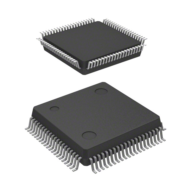

    IC FLASH 32MBIT PARALLEL 80PQFP
S29CD032J0MQFM013 数据手册
S29CD032J S29CD016J S29CL032J S29CL016J 32/16 Mbit, 2.6/3.3 V, Dual Boot, Simultaneous Read/Write, Burst Flash General Description The Cypress S29CD-J and S29CL-J devices are Floating Gate products fabricated in 110-nm process technology. These burstmode Flash devices are capable of performing simultaneous read and write operations with zero latency on two separate banks, using separate data and address pins. These products can operate up to 75 MHz (32 Mb) or 66 MHz (16 Mb), and use a single VCC of 2.5V to 2.75V (S29CD-J) or 3.0V to 3.6V (S29CL-J) that make them ideal for today’s demanding automotive applications. Distinctive Characteristics  Single 2.6V (S29CD-J) or 3.3V (S29CL-J) for read/program/ erase  110 nm Floating Gate Technology  Simultaneous Read/Write operation with zero latency  x32 Data Bus  Dual Boot Sector Configuration (top and bottom)  Flexible Sector Architecture – CD016J and CL016J: Eight 2k Double word, Thirty 16k Double word, and Eight 2k Double Word sectors – CD032J and CL032J: Eight 2k Double word, Sixty-two 16k Double Word, and Eight 2k Double Word sectors  VersatileI/O™ control (1.65V to 3.6V)  Programmable Burst Interface – Linear for 2, 4, and 8 double word burst with wrap around  Secured Silicon Sector that can be either factory or customer locked  20 year data retention (typical)  Cycling Endurance: 1 million write cycles per sector (typical)  Command set compatible with JEDEC (JC42.4) standard Cypress Semiconductor Corporation Document Number: 002-00948 Rev. *C •  Supports Common Flash Interface (CFI)  Extended Temperature range  Persistent and Password methods of Advanced Sector Protection  Unlock Bypass program command to reduce programming time  ACC input pin to reduce factory programming time  Data Polling bits indicate program and erase operation completion  Hardware (WP#) protection of two outermost sectors in the large bank  Ready/Busy (RY/BY#) output indicates data available to system  Suspend and Resume commands for Program and Erase Operation  Offered Packages – 80-pin PQFP – 80-ball Fortified BGA (13 x 11 mm and 11 x 9mm versions) – Pb-free package option available – Known Good Die 198 Champion Court • San Jose, CA 95134-1709 • 408-943-2600 Revised November 08, 2017 S29CD032J S29CD016J S29CL032J S29CL016J Performance Characteristics Read Access Times Speed Option (MHz) 75 (32 Mb only) 66 56 40 Max Asynch. Access Time, ns (tACC) 54 54 54 54 Max Synch. Burst Access, ns (tBACC) 8 8 8 8 Min Initial Clock Delay (clock cycles) 5 5 5 4 Max CE# Access Time, ns (tCE) 54 54 54 54 Max OE# Access time, ns (tOE) 20 20 20 20 Current Consumption (Max values) Continuous Burst Read @ 75 MHz 90 mA Program 50 mA Erase 50 mA Standby Mode 60 µA Typical Program and Erase Times Double Word Programming 18 µs Sector Erase 1.0 s Notice for the 32Mb S29CD-J and S29CL-J devices only: Refer to the application note “Recommended Mode of Operation for Cypress® 110 nm S29CD032J/S29CL032J Flash Memory” publication number S29CD-CL032J_Recommend_AN for programming best practices. Document Number: 002-00948 Rev. *C Page 2 of 74 S29CD032J S29CD016J S29CL032J S29CL016J Contents 1. 1.1 Ordering Information ................................................... 4 Valid Combinations ........................................................ 5 9.2 Secured Silicon Sector Entry and Exit Commands...................................................... 45 2. Input/Output Descriptions and Logic Symbols ...................................................... 6 10. Electronic Marking...................................................... 46 3. Block Diagram.............................................................. 7 4. Block Diagram of Simultaneous Read/Write Circuit........................................................ 8 5. 5.1 5.2 Physical Dimensions/Connection Diagrams............. 9 80-Pin PQFP Connection Diagram ................................ 9 PQR080–80-Lead Plastic Quad Flat Package Physical Dimensions..................................... 10 80-Ball Fortified BGA Connection Diagram ................. 11 Special Package Handling Instructions........................ 11 LAA080–80-ball Fortified Ball Grid Array (13 x 11 mm) Physical Dimensions.............................. 12 LAD080–80-ball Fortified Ball Grid Array (11 x 9 mm) Physical Dimensions................................ 13 11. 11.1 11.2 11.3 11.4 Power Conservation Modes....................................... 46 Standby Mode............................................................... 46 Automatic Sleep Mode.................................................. 46 Hardware RESET# Input Operation.............................. 46 Output Disable (OE#).................................................... 46 5.3 5.4 5.5 5.6 6. 6.1 Product Overview ...................................................... 14 Memory Map ................................................................ 14 7. 7.1 7.2 7.3 7.4 19 19 20 21 7.5 7.6 7.7 7.8 7.9 Device Operations ..................................................... Device Operation Table ............................................... Asynchronous Read..................................................... Hardware Reset (RESET#).......................................... Synchronous (Burst) Read Mode and Configuration Register .......................................... Autoselect .................................................................... VersatileI/O (VIO) Control............................................. Program/Erase Operations .......................................... Write Operation Status................................................. Reset Command .......................................................... 8. 8.1 8.2 8.3 8.4 8.5 8.6 Advanced Sector Protection/Unprotection ............. Advanced Sector Protection Overview ........................ Persistent Protection Bits............................................. Persistent Protection Bit Lock Bit................................. Dynamic Protection Bits............................................... Password Protection Method ....................................... Hardware Data Protection Methods............................. 37 38 39 41 41 42 43 9. 9.1 Secured Silicon Sector Flash Memory Region ....... 44 Secured Silicon Sector Protection Bit .......................... 45 Document Number: 002-00948 Rev. *C 21 26 27 27 32 36 12. Electrical Specifications............................................. 47 12.1 Absolute Maximum Ratings .......................................... 47 13. Operating Ranges ....................................................... 48 14. DC Characteristics...................................................... 49 14.1 Zero Power Flash.......................................................... 50 15. Test Conditions ........................................................... 51 16. Test Specifications ..................................................... 51 16.1 Switching Waveforms ................................................... 51 17. 17.1 17.2 17.3 17.4 17.5 17.6 17.7 AC Characteristics...................................................... 52 VCC and VIO Power-up.................................................. 52 Asynchronous Operations............................................. 52 Synchronous Operations .............................................. 54 Hardware Reset (RESET#)........................................... 56 Write Protect (WP#) ...................................................... 57 Erase/Program Operations ........................................... 57 Alternate CE# Controlled Erase/Program Operations ........................................... 62 17.8 Erase and Programming Performance ......................... 63 17.9 PQFP and Fortified BGA Pin Capacitance ................... 63 18. Appendix 1 .................................................................. 64 18.1 Common Flash Memory Interface (CFI) ....................... 64 19. Appendix 2 .................................................................. 67 19.1 Command Definitions.................................................... 67 20. Revision History.......................................................... 69 Sales, Solutions, and Legal Information .......................... 74 Worldwide Sales and Design Support ........................... 74 Products ........................................................................ 74 PSoC® Solutions .......................................................... 74 Cypress Developer Community ..................................... 74 Technical Support ......................................................... 74 Page 3 of 74 S29CD032J S29CD016J S29CL032J S29CL016J 1. Ordering Information The order number (Valid Combination) is formed by the following: S29CD032J S29CL032J 0 J F A I 0 0 0 Packing Type 0 = Tray, FBGA: 180 per tray, min. 10 trays per box Tray, PQFP: 66 per tray, min. 10 trays per box 2 = 7” Tape and Reel, FBGA: 400 per reel 3 = 13” Tape and Reel, FBGA: 1600 per reel 13” Tape and Reel, PQFP: 500 per reel Boot Sector Option (16th Character) 0 = Top Boot with Simultaneous Operation 1 = Bottom Boot with Simultaneous Operation 2 = Top Boot without Simultaneous Operation 3 = Bottom Boot without Simultaneous Operation Autoselect ID Option (15th Character) 0 = 7E, 08, 01/00 Autoselect ID 1 = 7E, 36, 01/00 Autoselect ID 0 = 7E, 46, 01/00 Autoselect ID 0 = 7E, 09, 01/00 Autoselect ID 0 = 7E, 49, 01/00 Autoselect ID S29CD016J only S29CL016J only S29CD032J only S29CL032J only Temperature Range I = Industrial (–40 °C to +85 °C) M = Extended (–40 °C to +125 °C) Material Set A = Standard F = Pb-free Option Package Type Q = Plastic Quad Flat Package (PQFP) F = Fortified Ball Grid Array, 1.0 mm pitch package, 13  11 mm package B = Fortified Ball Grid Array, 1.0 mm pitch package, 11  9 mm package Clock Frequency (11th Character) J = 40 MHz M = 56 MHz P = 66 MHz R = 75 MHz Initial Burst Access Delay (10th Character) 0 = 5-1-1-1, 6-1-1-1, and above 1 = 4-1-1-1 (40 MHz only) Device Number/Description S29CD032J/S29CD016J (2.5 volt-only), S29CL032J/S29CL016J (3.3 Volt-only) 32 or 16 Mbit (1M or 512k  32-Bit) CMOS Burst Mode, Dual Boot, Simultaneous Read/Write Flash Memory Manufactured on 110 nm floating gate technology Document Number: 002-00948 Rev. *C Page 4 of 74 S29CD032J S29CD016J S29CL032J S29CL016J 1.1 Valid Combinations Valid Combinations lists configurations planned to be supported in volume for this device. Consult your local sales office to confirm availability of specific valid combinations and to check on newly released combinations. S29CD-J/CL-J Valid Combinations Device Number Initial Burst Access Delay Clock Frequency 0, 1 J 0 M, P 0, 1 J 0 M, P 0, 1 J S29CD016J S29CL016J M, P S29CD032J 0 Package Type Material Set Temperature Range Autoselect ID Option Q 0, 3 0, 2, 3 0, 1 Q 0, 2, 3 Q 0, 3 B, F 0, 2, 3 0, 1, 2, 3 Q B, F S29CL032J Q 0, 3 B, F 0, 2, 3 Q 0, 3 B, F 0, 2, 3 A, F I, M 0, 1 (2) 0 2, 3 0, 1 (2) 2, 3 0, 3 0, 2, 3 Q 0, 3 B, F 0, 2, 3 Q 0, 1, 2, 3 B, F Q 0 0, 3 0, 2, 3 B, F M, P 0, 3 B, F R J Packing Type B, F Q 0, 1 Boot Sector Option R B, F 0, 3 0, 2, 3 0, 1 (2) 2, 3 0, 1 (2) 2, 3 0, 3 0, 2, 3 Notes 1. The ordering part number that appears on BGA packages omits the leading “S29”. 2. Contact factory for availability. Document Number: 002-00948 Rev. *C Page 5 of 74 S29CD032J S29CD016J S29CL032J S29CL016J 2. Input/Output Descriptions and Logic Symbols Table identifies the input and output package connections provided on the device. Symbol Type A19-A0 Input DQ31-DQ0 I/O Description Address lines for S29CD-J and S29CL-J (A18-A0 for 16 Mb and A19-A0 for 32 Mb). A9 supports 12V autoselect input. Data input/output CE# Input Chip Enable. This signal is asynchronous relative to CLK for the burst mode. OE# Input Output Enable. This signal is asynchronous relative to CLK for the burst mode. WE# Input Write Enable VCC Supply Device Power Supply. This signal is asynchronous relative to CLK for the burst mode. VIO Supply VersatileI/OTM Input. VSS Supply Ground NC No Connect Not connected internally Ready/Busy output and open drain which require a external pull up resistor. When RY/BY# = VOH, the device is ready to accept read operations and commands. When RY/BY# = VOL, the device is either executing an embedded algorithm or the device is executing a hardware reset operation. RY/BY# Output CLK Input Clock Input that can be tied to the system or microprocessor clock and provides the fundamental timing and internal operating frequency. ADV# Input Load Burst Address input. Indicates that the valid address is present on the address inputs. IND# Output End of burst indicator for finite bursts only. IND is low when the last word in the burst sequence is at the data outputs. WAIT# Output Provides data valid feedback only when the burst length is set to continuous. WP# Input Write Protect Input. At VIL, disables program and erase functions in two outermost sectors of the large bank. ACC Input Acceleration input. At VHH, accelerates erasing and programming. When not used for acceleration, ACC = VSS or VCC. RESET# Input Hardware Reset. Document Number: 002-00948 Rev. *C Page 6 of 74 S29CD032J S29CD016J S29CL032J S29CL016J 3. Block Diagram VCC VSS DQmax–DQ0 Erase Voltage Generator VIO Input/Output Buffers WE# RESET# ACC WP# State Control Command Register PGM Voltage Generator Chip Enable Output Enable CE# Data VCC Detector ADV# CLK Burst State Control IND/ WAIT# Timer Burst Address Counter Address Latch OE# Y-Decoder Y-Gating X-Decoder Cell Matrix Amax-A0 Amax-A0 Note 3.Address bus is A19–A0 for 32 Mb device, A18–A0 for 16 Mb device. Data bus is D31–DQ0. Document Number: 002-00948 Rev. *C Page 7 of 74 S29CD032J S29CD016J S29CL032J S29CL016J 4. Block Diagram of Simultaneous Read/Write Circuit X-Decoder Amax–A0 RESET# WE# CE# ADV# DQmax–DQ0 Upper Bank Amax–A0 Y-Decoder Upper Bank Address Amax–A0 Latches and Control Logic OE# VCC VSS STATE CONTROL & COMMAND REGISTER Status DQmax–DQ0 Control DQmax–DQ0 Document Number: 002-00948 Rev. *C Lower Bank Address Lower Bank DQmax–DQ0 Latches and Control Logic Amax–A0 Y-Decoder Amax–A0 X-Decoder Page 8 of 74 S29CD032J S29CD016J S29CL032J S29CL016J VIO RESET# CLK NC RY/BY# ADV# NC VSS VCC CE# OE# WE# WP# NC 80-Pin PQFP Connection Diagram NC 5.1 Physical Dimensions/Connection Diagrams IND/WAIT# 5. 80 79 78 77 76 75 74 73 72 71 70 69 68 67 66 65 DQ16 DQ17 DQ18 DQ19 VIO VSS DQ20 DQ21 DQ22 DQ23 DQ24 DQ25 DQ26 DQ27 VIO VSS DQ28 DQ29 DQ30 DQ31 NC A0 A1 A2 1 2 3 4 5 6 7 8 9 10 11 12 13 14 15 16 17 18 19 20 21 22 23 24 64 63 62 61 60 59 58 57 56 55 54 53 52 51 50 49 48 47 46 45 44 43 42 41 80-Pin PQFP DQ15 DQ14 DQ13 DQ12 VSS VIO DQ11 DQ10 DQ9 DQ8 DQ7 DQ6 DQ5 DQ4 VSS VIO DQ3 DQ2 DQ1 DQ0 A19 A18 A17 A16 A15 A14 A13 A12 A11 A10 A9 VCC ACC VSS A8 A7 A6 A5 A4 A3 25 26 27 28 29 30 31 32 33 34 35 36 37 38 39 40 Notes 4. On 16 Mb device, pin 44 (A19) is NC. 5. Pin 69 (RY/BY#) is Open Drain and requires an external pull-up resistor. Document Number: 002-00948 Rev. *C Page 9 of 74 S29CD032J S29CD016J S29CL032J S29CL016J 5.2 PQR080–80-Lead Plastic Quad Flat Package Physical Dimensions 6 3 PIN S D D1 0.20 MIN. FLAT SHOULDER D3 PIN R 7˚ TYP. 0˚MIN. 0.30 ± 0.05 R PIN ONE I.D. A GAGE 0.25 PLANE E3 -A- E1 -B- 7˚ TYP. L 3 0˚-7˚ 6 b ccc C 4 aa a M C A B S D S E DETAIL X SEE NOTE 3 b PIN P -D- PIN Q c SEE DETAIL X e BASIC SECTION S-S S A2 A1 S PACKAGE -A-C- SEATING PLANE NOTES: PQR 080 JEDEC SYMBOL A 2 MO-108(B)CB-1 NOTES MIN NOM MAX A -- -- 3.35 A1 0.25 -- -- A2 2.70 2.80 2.90 b 0.30 -- 0.45 1. ALL DIMENSIONS AND TOLERANCES CONFORM TO ANSI Y14.5M-1982. 2. DATUM PLANE -A- IS LOCATED AT THE MOLD PARTING LINE AND IS COINCIDENT WITH THE BOTTOM OF THE LEAD WHERE THE LEAD EXITS THE PLASTIC BODY. 3. DIMENSIONS "D1" AND "E1" DO NOT INCLUD MOLD PROTRUSION. ALLOWABLE PROTRUSION IS 0.25 mm PER SIDE. DIMENSIONS "D1" AND "E1" INCLUDE MOLD MISMATCH AND ARE DETERMINED AT DATUM PLANE -A- SEE NOTE 4 c 0.15 -- 0.23 D 17.00 17.20 17.40 4. DIMENSION "B" DOES NOT INCLUDE DAMBAR PROTRUSION. D1 13.90 14.00 14.10 SEE NOTE 3 5. CONTROLLING DIMENSIONS: MILLIMETER. D3 -- 12.0 -- REFERENCE 6. e -- 0.80 -- BASIC, SEE NOTE 7 DIMENSIONS "D" AND "E" ARE MEASURED FROM BOTH INNERMOST AND OUTERMOST POINTS. E 23.00 23.20 23.40 7. E1 19.90 20.00 20.10 SEE NOTE 3 DEVIATION FROM LEAD-TIP TRUE POSITION SHALL BE WITHIN ±0.0076 mm FOR PITCH > 0.5 mm AND WITHIN ±0.04 FOR PITCH < 0.5 mm. E3 -- 18.40 -- REFERENCE 8. aaa --- 0.20 --- LEAD COPLANARITY SHALL BE WITHIN: (REFER TO 06-500) 1 - 0.10 mm FOR DEVICES WITH LEAD PITCH OF 0.65 - 0.80 mm 2 - 0.076 mm FOR DEVICES WITH LEAD PITCH OF 0.50 mm. COPLANARITY IS MEASURED PER SPECIFICATION 06-500. 9. HALF SPAN (CENTER OF PACKAGE TO LEAD TIP) SHALL BE WITHIN ±0.0085". ccc L 0.10 0.73 0.88 P 24 Q 40 R 64 S 80 1.03 3213\38.4C Document Number: 002-00948 Rev. *C Page 10 of 74 S29CD032J S29CD016J S29CL032J S29CL016J 5.3 80-Ball Fortified BGA Connection Diagram A8 B8 C8 D8 E8 F8 G8 H8 J8 K8 A2 A1 A0 DQ29 VIO VSS VIO DQ20 DQ16 NC A7 B7 C7 D7 E7 F7 G7 H7 J7 K7 A3 A4 NC DQ30 DQ26 DQ24 DQ23 DQ18 IND/WAIT# NC A6 B6 C6 D6 E6 F6 G6 H6 J6 K6 A6 A5 A7 DQ31 DQ28 DQ25 DQ21 DQ19 OE# WE# A5 B5 C5 D5 E5 F5 G5 H5 J5 K5 VSS A8 NC NC DQ27 RY/BY# DQ22 DQ17 CE# VCC A4 B4 C4 D4 E4 F4 G4 H4 J4 K4 ACC A9 A10 NC DQ1 DQ5 DQ9 WP# NC VSS A3 B3 C3 D3 E3 F3 G3 H3 J3 K3 VCC A12 A11 A19 DQ2 DQ6 DQ10 DQ11 ADV# CLK A2 B2 C2 D2 E2 F2 G2 H2 J2 K2 A14 A13 A18 DQ0 DQ4 DQ7 DQ8 DQ12 DQ14 RESET# A1 B1 C1 D1 E1 F1 G1 H1 J1 K1 A15 A16 A17 DQ3 VIO VSS VIO DQ13 DQ15 VIO Notes 6. On 16 Mb device, ball D3 (A19) is NC. 7. Ball F5 (RY/BY#) is Open Drain and requires an external pull-up resistor. 5.4 Special Package Handling Instructions Special handling is required for Flash Memory products in molded packages (BGA). The package and/or data integrity may be compromised if the package body is exposed to temperatures above 150°C for prolonged periods of time. Document Number: 002-00948 Rev. *C Page 11 of 74 S29CD032J S29CD016J S29CL032J S29CL016J 5.5 LAA080–80-ball Fortified Ball Grid Array (13 x 11 mm) Physical Dimensions D 0.20 C 2X D1 A eD K J H G F E D C B A 8 7 7 SE 6 eE 5 E1 E 4 .50 3 φ0 2 1.00±0.5 1 A1 CORNER ID. (INK OR LASER) B 1.00±0.5 6 0.20 C 2X TOP VIEW A1 CORNER NXφb SD A1 CORNER 7 φ0.25 M C A B φ0.10 M C BOTTOM VIEW 0.25 C A A2 SEATING PLANE A1 C 0.15 C SIDE VIEW PACKAGE NOTES: LAA 080 JEDEC N/A SYMBOL MIN NOM MAX A -- -- 1.40 A1 0.40 -- -- A2 0.60 2. ALL DIMENSIONS ARE IN MILLIMETERS. 3. BALL POSITION DESIGNATION PER JESD 95-1, SPP-010 (EXCEPT AS NOTED). -- -- 4. e REPRESENTS THE SOLDER BALL GRID PITCH. STANDOFF 5. SYMBOL "MD" IS THE BALL ROW MATRIX SIZE IN THE "D" DIRECTION. SYMBOL "ME" IS THE BALL COLUMN MATRIX SIZE IN THE "E" DIRECTION. N IS THE TOTAL NUMBER OF SOLDER BALLS. 6 DIMENSION "b" IS MEASURED AT THE MAXIMUM BALL DIAMETER IN A PLANE PARALLEL TO DATUM C. 7 SD AND SE ARE MEASURED WITH RESPECT TO DATUMS A AND B AND DEFINE THE POSITION OF THE CENTER SOLDER BALL IN THE OUTER ROW. WHEN THERE IS AN ODD NUMBER OF SOLDER BALLS IN THE OUTER ROW PARALLEL TO THE D OR E DIMENSION, RESPECTIVELY, SD OR SE = 0.000. WHEN THERE IS AN EVEN NUMBER OF SOLDER BALLS IN THE OUTER ROW , SD OR SE = e/2 BODY THICKNESS 13.00 BSC. BODY SIZE E 11.00 BSC. BODY SIZE D1 9.00 BSC. MATRIX FOOTPRINT E1 7.00 BSC. MATRIX FOOTPRINT MD 10 MATRIX SIZE D DIRECTION ME 8 MATRIX SIZE E DIRECTION N 80 0.50 DIMENSIONING AND TOLERANCING METHODS PER ASME Y14.5M-1994. PROFILE HEIGHT D φb 1. NOTE 13.00 x 11.00 mm PACKAGE 0.60 BALL COUNT 0.70 BALL DIAMETER eD 1.00 BSC. BALL PITCH - D DIRECTION 8. N/A eE 1.00 BSC. BALL PITCH - E DIRECTION 9. SD/SE 0.50 BSC SOLDER BALL PLACEMENT "+" INDICATES THE THEORETICAL CENTER OF DEPOPULATED BALLS. 3214\38.12C Document Number: 002-00948 Rev. *C Page 12 of 74 S29CD032J S29CD016J S29CL032J S29CL016J 5.6 LAD080–80-ball Fortified Ball Grid Array (11 x 9 mm) Physical Dimensions NOTES: PACKAGE 1. DIMENSIONING AND TOLERANCING METHODS PER ASME Y14.5M-1994. LAD 080 JEDEC N/A DXE 2. ALL DIMENSIONS ARE IN MILLIMETERS. 11.00 mm x 9.00 mm PACKAGE 3. BALL POSITION DESIGNATION PER JEP95, SECTION 4.3, SPP-010. SYMBOL MIN NOM MAX NOTE A --- --- 1.40 PROFILE A1 0.35 0.45 0.55 BALL HEIGHT D 11.00 BSC BODY SIZE E 9.00 BSC BODY SIZE D1 9.00 BSC MATRIX FOOTPRINT E1 7.00 BSC MD 10 MATRIX FOOTPRINT 8 MATRIX SIZE E DIRECTION N 80 BALL COUNT b 0.55 0.65 1.00 BSC 0.75 N IS THE NUMBER OF POPULATED SOLDER BALL POSITIONS FOR MATRIX SIZE MD X ME. 6 DIMENSION "b" IS MEASURED AT THE MAXIMUM BALL DIAMETER IN A PLANE PARALLEL TO DATUM C. 7 SD AND SE ARE MEASURED WITH RESPECT TO DATUMS A AND B AND DEFINE THE POSITION OF THE CENTER SOLDER BALL IN THE OUTER ROW. WHEN THERE IS AN ODD NUMBER OF SOLDER BALLS IN THE OUTER ROW SD OR SE = 0.000. BALL PITCH eD 1.00 BSC BALL PITCH 0.50 BSC SOLDER BALL PLACEMENT N/A SYMBOL "ME" IS THE BALL MATRIX SIZE IN THE "E" DIRECTION. BALL DIAMETER SD / SE DEPOPULATED SOLDER BALLS e REPRESENTS THE SOLDER BALL GRID PITCH. 5. SYMBOL "MD" IS THE BALL MATRIX SIZE IN THE "D" DIRECTION. MATRIX SIZE D DIRECTION ME eE 4. WHEN THERE IS AN EVEN NUMBER OF SOLDER BALLS IN THE OUTER ROW, SD OR SE = e/2 8. “+” INDICATES THE THEORETICAL CENTER OF DEPOPULATED BALLS. 9 A1 CORNER TO BE IDENTIFIED BY CHAMFER, LASER OR INK MARK, METALLIZED MARK INDENTATION OR OTHER MEANS. g1064 \ f16-038.12 \ 01.31.12 Document Number: 002-00948 Rev. *C Page 13 of 74 S29CD032J S29CD016J S29CL032J S29CL016J 6. Product Overview The S29CD-J and S29CL-J families consist of 32 Mb and 16 Mb, 2.6 volt-only (CD-J) or 3.3 volt-only (CL-J), simultaneous read/ write, dual boot burst mode Flash devices optimized for today's automotive designs. These devices are organized in 1,048,576 double words (32 Mb) or 524,288 double words (16 Mb) and are capable of linear burst read (2, 4, or 8 double words) with wraparound. (Note that 1 double word = 32 bits.) These products also offer single word programming with program/erase suspend and resume functionality. Additional features include:  Advanced Sector Protection methods for protecting sectors as required.  256 bytes of Secured Silicon area for storing customer or factory secured information. The Secured Silicon Sector is One-Time Programmable.  Electronic marking. 6.1 Memory Map The S29CD-J and S29CL-J devices consist of two banks organized as shown in Table 1, Table 2, Table 3 and Table 4. Table 1. S29CD016J/CL016J (Top Boot) Sector and Memory Address Map Sector Group x32 Address Range (A18:A0) Sector Size (KDwords) Sector Sector Group x32 Address Range (A18:A0) Sector Size (KDwords) SA0 (Note 8) SG0 00000h–007FFh 2 SA15 20000h–23FFFh 16 SA1 SG1 00800h–00FFFh 2 SA16 24000h–27FFFh 16 SA2 SG2 01000h–017FFh 2 SA17 28000h–2BFFFh 16 SA3 SG3 01800h–01FFFh 2 SA18 2C000h–2FFFFh 16 SG10 SA4 SG4 02000h–027FFh 2 SA19 30000h–33FFFh 16 SA5 SG5 02800h–02FFFh 2 SA20 34000h–37FFFh 16 SA6 SG6 03000h–037FFh 2 SA21 38000h–3BFFFh 16 SA7 SG7 03800h–03FFFh 2 SA22 3C000h–3FFFFh 16 04000h–07FFFh 16 SA23 40000h–43FFFh 16 SG8 08000h–0BFFFh 16 SA24 44000h–47FFFh 16 SA10 0C000h–0FFFFh 16 SA25 48000h–4BFFFh 16 SA11 10000h–13FFFh 16 SA26 4C000h–4FFFFh 16 SA8 SA9 SA12 SA13 SA14 SG9 SG11 SG12 14000h–17FFFh 16 SA27 50000h–53FFFh 16 18000h–1BFFFh 16 SA28 54000h–57FFFh 16 1C000h–1FFFFh 16 58000h–5BFFFh 16 5C000h–5FFFFh 16 Bank 1 (Note 9) Bank 0 (Note 9) Sector SA29 SG13 SA30 SA31 60000h–63FFFh 16 SA32 64000h–67FFFh 16 SA33 SG14 SA34 SA35 16 16 70000h–73FFFh 16 SG15 74000h–77FFFh 16 78000h–7BFFFh 16 SA38 SG16 7C000h–7C7FFh 2 SA39 SG17 7C800h–7CFFFh 2 SA40 SG18 7D000h–7D7FFh 2 SA41 SG19 7D800h–7DFFFh 2 SA42 SG20 7E000h–7E7FFh 2 SA43 SG21 7E800h–7EFFFh 2 SA44 (Note 10) SG22 7F000h–7F7FFh 2 SA45 (Note 10) SG23 7F800h–7FFFFh 2 SA36 SA37 Document Number: 002-00948 Rev. *C 68000h–6BFFFh 6C000h–6FFFFh Page 14 of 74 S29CD032J S29CD016J S29CL032J S29CL016J Notes 8. Secured Silicon Sector overlays this sector when enabled. 9. The bank address is determined by A18 and A17. BA = 00 for Bank 0 and BA = 01, 10, or 11 for Bank 1. 10. This sector has the additional WP# pin sector protection feature. Table 2. S29CD016J/CL016J (Bottom Boot) Sector and Memory Address Map Sector Sector Group Sector Size (KDwords) Sector Sector Group x32 Address Range (A18:A0) Sector Size (KDwords) SA0 (Note 11) SG0 00000h–007FFh 2 SA31 60000h–63FFFh 16 SA1 (Note 11) SG1 00800h–00FFFh 2 SA32 64000h–67FFFh 16 SA2 SG2 01000h–017FFh 2 SA33 68000h–6BFFFh 16 SA3 SG3 01800h–01FFFh 2 SA34 6C000h–6FFFFh 16 SG4 02000h–027FFh 2 SA35 SG5 02800h–02FFFh 2 SA36 SA6 SG6 03000h–037FFh 2 SA7 SG7 03800h–03FFFh 2 04000h–07FFFh 16 SG8 08000h–0BFFFh 16 SA10 0C000h–0FFFFh SA11 10000h–13FFFh SA9 SA12 Bank 1 (Note 12) SA4 SA5 SA8 Bank 0 (Note 12) x32 Address Range (A18:A0) SG14 70000h–73FFFh 16 SG15 74000h–77FFFh 16 78000h–7BFFFh 16 SG16 7C000h–7C7FFh 2 SA37 SA38 SA39 SG17 7C800h–7CFFFh 2 SA40 SG18 7D000h–7D7FFh 2 16 SA41 SG19 7D800h–7DFFFh 2 16 SA42 SG20 7E000h–7E7FFh 2 14000h–17FFFh 16 SA43 SG21 7E800h–7EFFFh 2 18000h–1BFFFh 16 SA44 SG22 7F000h–7F7FFh 2 SA14 1C000h–1FFFFh 16 SA45 (Note 13) SG23 7F800h–7FFFFh 2 SA15 20000h–23FFFh 16 SA13 SA16 SA17 SG9 SG10 24000h–27FFFh 16 28000h–2BFFFh 16 SA18 2C000h–2FFFFh 16 SA19 30000h–33FFFh 16 SA20 SA21 SG11 34000h–37FFFh 16 38000h–3BFFFh 16 SA22 3C000h–3FFFFh 16 SA23 40000h–43FFFh 16 SA24 SA25 SG12 44000h–47FFFh 16 48000h–4BFFFh 16 SA26 4C000h–4FFFFh 16 SA27 50000h–53FFFh 16 SA28 SA29 SA30 SG13 54000h–57FFFh 16 58000h–5BFFFh 16 5C000h–5FFFFh 16 Notes 11. This sector has the additional WP# pin sector protection feature. 12. The bank address is determined by A18 and A17. BA = 00, 01, or 10 for Bank 0 and BA = 11 for Bank 1. 13. Secured Silicon Sector overlays this sector when enabled. Document Number: 002-00948 Rev. *C Page 15 of 74 S29CD032J S29CD016J S29CL032J S29CL016J Table 3. S29CD032J/CL032J (Top Boot) Sector and Memory Address Map Sector Sector Group x32 Address Range (A19:A0) Sector Size (KDwords) Sector Bank 0 (Note 15) Sector Group x32 Address Range (A19:A0) Sector Size (KDwords) Bank 1 continued (Note 15) SA0 (Note 14) SG0 00000h–007FFh 2 SA39 SA1 SG1 00800h–00FFFh 2 SA40 SG16 80000h–83FFFh 16 84000h–87FFFh 16 SA2 SG2 01000h–017FFh 2 SA41 88000h–8BFFFh 16 SA3 SG3 01800h–01FFFh 2 SA42 8C000h–8FFFFh 16 SA4 SG4 02000h–027FFh 2 SA43 90000h–93FFFh 16 SA5 SG5 02800h–02FFFh 2 SA44 94000h–97FFFh 16 SA6 SG6 03000h–037FFh 2 SA45 SA7 SG7 03800h–03FFFh 2 SA46 04000h–07FFFh 16 SA47 A0000h–A3FFFh 16 SG8 08000h–0BFFFh 16 SA48 A4000h–A7FFFh 16 SA10 0C000h–0FFFFh 16 SA49 A8000h–ABFFFh 16 SA11 10000h–13FFFh 16 SA50 AC000h–AFFFFh 16 SA8 SA9 SA12 SG17 SG18 98000h–9BFFFh 16 9C000h–9FFFFh 16 14000h–17FFFh 16 SA51 B0000h–B3FFFh 16 18000h–1BFFFh 16 SA52 B4000h–B7FFFh 16 SA14 1C000h–1FFFFh 16 SA53 B8000h–BBFFFh 16 SA15 20000h–23FFFh 16 SA54 BC000h–BFFFFh 16 SA13 SA16 SG9 SG19 24000h–27FFFh 16 SA55 C0000h–C3FFFh 16 28000h–2BFFFh 16 SA56 C4000h–C7FFFh 16 SA18 2C000h–2FFFFh 16 SA57 C8000h–CBFFFh 16 SA19 30000h–33FFFh 16 SA58 CC000h–CFFFFh 16 SA17 SA20 SA21 SG10 SG11 SA22 SG20 34000h–37FFFh 16 SA59 D0000h–D3FFFh 16 38000h–3BFFFh 16 SA60 D4000h–D7FFFh 16 3C000h–3FFFFh 16 SA61 D8000h–DBFFFh 16 DC000h–DFFFFh 16 Bank 1 (Note 15) SG21 SA62 SA23 40000h–43FFFh 16 SA63 E0000h–E3FFFh 16 SA24 44000h–47FFFh 16 SA64 E4000h–E7FFFh 16 48000h–4BFFFh 16 SA65 4C000h–4FFFFh 16 SA66 SA25 SG12 SA26 SA27 50000h–53FFFh 16 SA67 SA28 54000h–57FFFh 16 SA68 58000h–5BFFFh 16 SA69 5C000h–5FFFFh 16 SA29 SG13 SA30 SG22 E8000h–EBFFFh 16 EC000h–EFFFFh 16 F0000h–F3FFFh 16 SG23 F4000h–F7FFFh 16 F8000h–FBFFFh 16 SA70 SG24 FC000h–FC7FFh 2 SA31 60000h–63FFFh 16 SA71 SG25 FC800h–FCFFFh 2 SA32 64000h–67FFFh 16 SA72 SG26 FD000h–FD7FFh 2 68000h–6BFFFh 16 SA73 SG27 FD800h–FDFFFh 2 6C000h–6FFFFh 16 SA74 SG28 FE000h–FE7FFh 2 SA33 SA34 SG14 Document Number: 002-00948 Rev. *C Page 16 of 74 S29CD032J S29CD016J S29CL032J S29CL016J Table 3. S29CD032J/CL032J (Top Boot) Sector and Memory Address Map (Continued) Sector Sector Group x32 Address Range (A19:A0) Sector Size (KDwords) Sector Sector Group Bank 0 (Note 15) x32 Address Range (A19:A0) Sector Size (KDwords) Bank 1 continued (Note 15) SA35 70000h–73FFFh 16 SA75 SG29 FE800h–FEFFFh 2 SA36 74000h–77FFFh 16 SA76 (Note 16) SG30 FF000h–FF7FFh 2 SA37 78000h–7BFFFh 16 SA77 (Note 16) SG31 FF800h–FFFFFh 2 SA38 7C000h–7FFFFh 16 SG15 Notes 14. Secured Silicon Sector overlays this sector when enabled. 15. The bank address is determined by A19 and A18. BA = 00 for Bank 0 and BA = 01, 10, or 11 for Bank 1. 16. This sector has the additional WP# pin sector protection feature. Document Number: 002-00948 Rev. *C Page 17 of 74 S29CD032J S29CD016J S29CL032J S29CL016J Table 4. S29CD032J/CL032J (Bottom Boot) Sector and Memory Address Map Sector 00000h–007FFh 2 SA39 80000h–83FFFh 16 SG1 00800h–00FFFh 2 SA40 84000h–87FFFh 16 SA2 SG2 01000h–017FFh 2 SA41 88000h–8BFFFh 16 SA3 SG3 01800h–01FFFh 2 SA42 8C000h–8FFFFh 16 SA4 SG4 02000h–027FFh 2 SA43 90000h–93FFFh 16 SA5 SG5 02800h–02FFFh 2 SA44 94000h–97FFFh 16 SA6 SG6 03000h–037FFh 2 SA45 98000h–9BFFFh 16 SA7 SG7 16 Sector Group SA0 (Note 19) SG0 SA1 (Note 19) x32 Address Range (A19:A0) Bank 0 (Note 18) Sector Group x32 Address Range (A19:A0) Sector Size (KDwords) Sector Size (KDwords) Sector Bank 0 continued (Note 18) SG16 SG17 03800h–03FFFh 2 SA46 9C000h–9FFFFh 04000h–07FFFh 16 SA47 A0000h–A3FFFh 16 08000h–0BFFFh 16 SA48 A4000h–A7FFFh 16 0C000h–0FFFFh 16 SA49 A8000h–ABFFFh 16 SA11 10000h–13FFFh 16 SA50 AC000h–AFFFFh 16 SA12 14000h–17FFFh 16 SA51 B0000h–B3FFFh 16 18000h–1BFFFh 16 SA52 B4000h–B7FFFh 16 1C000h–1FFFFh 16 SA53 B8000h–BBFFFh 16 SA15 20000h–23FFFh 16 SA54 BC000h–BFFFFh 16 SA16 24000h–27FFFh 16 SA8 SA9 SG8 SA10 SA13 SG9 SA14 SA17 SG10 SG18 SG19 Bank 1 (Note 18) 28000h–2BFFFh 16 SA55 C0000h–C3FFFh 16 SA18 2C000h–2FFFFh 16 SA56 C4000h–C7FFFh 16 SA19 30000h–33FFFh 16 SA57 C8000h–CBFFFh 16 SA20 34000h–37FFFh 16 SA58 CC000h–CFFFFh 16 38000h–3BFFFh 16 SA59 D0000h–D3FFFh 16 3C000h–3FFFFh 16 SA60 D4000h–D7FFFh 16 D8000h–DBFFFh 16 SA21 SG11 SA22 SG20 SG21 SA23 40000h–43FFFh 16 SA61 SA24 44000h–47FFFh 16 SA62 DC000h–DFFFFh 16 48000h–4BFFFh 16 SA63 E0000h–E3FFFh 16 4C000h–4FFFFh 16 SA64 E4000h–E7FFFh 16 E8000h–EBFFFh 16 SA25 SG12 SA26 SG22 SA27 50000h–53FFFh 16 SA65 SA28 54000h–57FFFh 16 SA66 EC000h–EFFFFh 16 58000h–5BFFFh 16 SA67 F0000h–F3FFFh 16 5C000h–5FFFFh 16 SA68 SG23 F4000h–F7FFFh 16 SA31 60000h–63FFFh 16 SA69 F8000h–FBFFFh 16 SA32 64000h–67FFFh 16 SA70 SG24 FC000h–FC7FFh 2 68000h–6BFFFh 16 SA71 SG25 FC800h–FCFFFh 2 6C000h–6FFFFh 16 SA72 SG26 FD000h–FD7FFh 2 SA35 70000h–73FFFh 16 SA73 SG27 FD800h–FDFFFh 2 SA36 74000h–77FFFh 16 SA74 SG28 FE000h–FE7FFh 2 78000h–7BFFFh 16 SA75 SG29 FE800h–FEFFFh 2 7C000h–7FFFFh 16 SA76 SG30 FF000h–FF7FFh 2 SA77 (Note 17) SG31 FF800h–FFFFFh 2 SA29 SG13 SA30 SA33 SG14 SA34 SA37 SA38 SG15 Notes 17. This sector has the additional WP# pin sector protection feature. 18. The bank address is determined by A19 and A18. BA = 00, 01, or 10 for Bank 0 and BA = 11 for Bank 1. 19. The Secured Silicon Sector overlays this sector when enabled. Document Number: 002-00948 Rev. *C Page 18 of 74 S29CD032J S29CD016J S29CL032J S29CL016J 7. Device Operations This section describes the read, program, erase, simultaneous read/write operations, and reset features of the Flash devices. Operations are initiated by writing specific commands or a sequence with specific address and data patterns into the command register (see Table 5). The command register itself does not occupy any addressable memory location; rather, it is composed of latches that store the commands, along with the address and data information needed to execute the command. The contents of the register serve as input to the internal state machine; the state machine outputs dictate the function of the device. Writing incorrect address and data values or writing them in an improper sequence may place the device in an unknown state, in which case the system must write the reset command in order to return the device to the reading array data mode. 7.1 Device Operation Table The device must be set up appropriately for each operation. Table 5 describes the required state of each control pin for any particular operation. Table 5. Device Bus Operation CE# OE# WE# RESET# CLK ADV# Addresses Data (DQ0–DQ31) Read L L H H X X AIN DOUT Asynchronous Write L H L H X X AIN DIN Synchronous Write L H L H AIN DIN Standby (CE#) H X X H H X X High-Z Output Disable L H H H X X High-Z High-Z Reset X X X L X X X High-Z X Sector Address, A9 = VID, A7 – A0 = 02h Operation L L H H Load Starting Burst Address L X H H Advance Burst to next address with appropriate Data presented on the Data bus L L H H Terminate Current Burst Read Cycle H X H H Terminate Current Burst Read Cycle with RESET# X X H L Terminate Current Burst Read Cycle; Start New Burst Read Cycle L H H H PPB Protection Status (Note 2) X 00000001h, (protected) A6 = H 00000000h (unprotect) A6 = L Burst Read Operations X AIN X H X Burst Data Out X X High-Z X X High-Z AIN X Legend L = Logic Low = VIL, H = Logic High = VIH, X = Don’t care. Notes 20. WP# controls the two outermost sectors of the top boot block or the two outermost sectors of the bottom boot block. 21. DQ0 reflects the sector PPB (or sector group PPB) and DQ1 reflects the DYB. Document Number: 002-00948 Rev. *C Page 19 of 74 S29CD032J S29CD016J S29CL032J S29CL016J 7.2 Asynchronous Read All memories require access time to output array data. In an asynchronous read operation, data is read from one memory location at a time. Addresses are presented to the device in random order, and the propagation delay through the device causes the data on its outputs to arrive asynchronously with the address on its inputs. The internal state machine is set for asynchronously reading array data upon device power-up, or after a hardware reset. This ensures that no spurious alteration of the memory content occurs during the power transition. No command is necessary in this mode to obtain array data. Standard microprocessor read cycles that assert valid addresses on the device address inputs produce valid data on the device data outputs. The device remains enabled for read access until the command register contents are altered. The device has two control functions which must be satisfied in order to obtain data at the outputs. CE# is the power control and should be used for device selection (CE# must be set to VIL to read data). OE# is the output control and should be used to gate data to the output pins if the device is selected (OE# must be set to VIL in order to read data). WE# should remain at VIH (when reading data). Address access time (tACC) is equal to the delay from stable addresses to valid output data. The chip enable access time (tCE) is the delay from the stable addresses and stable CE# to valid data at the output pins. The output enable access time (tOE) is the delay from the falling edge of OE# to valid data at the output pins (assuming the addresses have been stable for at least a period of tACCtOE and CE# has been asserted for at least tCE-tOE time). Figure 1 shows the timing diagram of an asynchronous read operation. Figure 1. Asynchronous Read Operation CE# CLK ADV# Addresses Address 0 Data Address 1 Address 2 D0 D1 Address 3 D2 D3 D3 OE# WE# IND/WAIT# VIH Float Float VOH Note 22.Operation is shown for the 32-bit data bus. For the 16-bit data bus, A-1 is required. Refer to Asynchronous Operations on page 52 for timing specifications and to Figure 19 Conventional Read Operations Timings on page 53 for another timing diagram. ICC1 in the DC Characteristics table represents the active current specification for reading array data. Document Number: 002-00948 Rev. *C Page 20 of 74 S29CD032J S29CD016J S29CL032J S29CL016J 7.3 Hardware Reset (RESET#) The RESET# pin is an active low signal that is used to reset the device under any circumstances. A logic “0” on this input forces the device out of any mode that is currently executing back to the reset state. RESET# may be tied to the system reset circuitry. A system reset would thus also reset the device. To avoid a potential bus contention during a system reset, the device is isolated from the DQ data bus by tristating the data outputs for the duration of the RESET pulse. All data outputs are “don’t care” during the reset operation. If RESET# is asserted during a program or erase operation, the RY/BY# output remains low until the reset operation is internally complete. The RY/BY# pin can be used to determine when the reset operation is complete. Since the device offers simultaneous read/write operation, the host system may read a bank after a period of tREADY2, if the bank was in the read/reset mode at the time RESET# was asserted. If one of the banks was in the middle of either a program or erase operation when RESET# was asserted, the user must wait a period of tREADY before accessing that bank. Asserting RESET# during a program or erase operation leaves erroneous data stored in the address locations being operated on at the time of device reset. These locations need updating after the reset operation is complete. See Hardware Reset (RESET#) on page 56 for timing specifications. Asserting RESET# active during VCC and VIO power-up is required to guarantee proper device initialization until VCC and VIO have reached their steady state voltages. See VCC and VIO Power-up on page 52. 7.4 Synchronous (Burst) Read Mode and Configuration Register When a series of adjacent addresses need to be read from the device, the synchronous (or burst read) mode can be used to significantly reduce the overall time needed for the device to output array data. After an initial access time required for the data from the first address location, subsequent data is output synchronized to a clock input provided by the system. The device offers a linear method of burst read operation which is discussed in 2-, 4-, 8- Double Word Linear Burst Operation on page 22. Since the device defaults to asynchronous read mode after power-up or a hardware reset, the configuration register must be set in order to enable the burst read mode. Other Configuration Register settings include the number of wait states to insert before the initial word (tIACC) of each burst access and when RDY indicates that data is ready to be read. Prior to entering the burst mode, the system first determines the configuration register settings (and read the current register settings if desired via the Read Configuration Register command sequence), then write the configuration register command sequence. See Configuration Register on page 24, and Table 34 on page 67 for further details. Once the configuration register is written to enable burst mode operation, all subsequent reads from the array are returned using the burst mode protocols. Figure 2. Synchronous/Asynchronous State Diagram Power-up/ Hardware Reset Asynchronous Read Mode Only Set Burst Mode Configuration Register Command for Synchronous Mode (D15 = 0) Set Burst Mode Configuration Register Command for Asynchronous Mode (D15 = 1) Synchronous Read Mode Only Document Number: 002-00948 Rev. *C Page 21 of 74 S29CD032J S29CD016J S29CL032J S29CL016J The device outputs the initial word subject to the following operational conditions:  tIACC specification: The time from the rising edge of the first clock cycle after addresses are latched to valid data on the device outputs.  Configuration register setting CR13-CR10: The total number of clock cycles (wait states) that occur before valid data appears on the device outputs. The effect is that tIACC is lengthened. Like the main memory access, the Secured Silicon Sector memory is accessed with the same burst or asynchronous timing as defined in the Configuration Register. However, the user must recognize burst operations past the 256 byte Secured Silicon boundary returns invalid data. Burst read operations occur only to the main flash memory arrays. The Configuration Register and protection bits are treated as single cycle reads, even when burst mode is enabled. Read operations to these locations results in the data remaining valid while OE# is at VIL, regardless of the number of CLK cycles applied to the device. 7.4.1 2-, 4-, 8- Double Word Linear Burst Operation In a linear burst read operation, a fixed number of words (2, 4, or 8 double words) are read from consecutive addresses that are determined by the group within which the starting address falls. Note that 1 double word = 32 bits. See Table 6 for all valid burst output sequences. The IND/WAIT# signal, or End of Burst Indicator signal, transitions active (VIL) during the last transfer of data in a linear burst read before a wrap around. This transition indicates that the system should initiate another ADV# to start the next burst access. If the system continues to clock the device, the next access wraps around to the starting address of the previous burst access. The IND/ WAIT# signal is floating when not active. Table 6. 32-Bit Linear and Burst Data Order Data Transfer Sequence Output Data Sequence (Initial Access Address) Two Linear Data Transfers 0-1 (A0 = 0) 1-0 (A0 = 1) Four Linear Data Transfers 0-1-2-3 (A1-A0 = 00) 1-2-3-0 (A1-A0 = 01) 2-3-0-1 (A1-A0 = 10) 3-0-1-2 (A1-A0 = 11) Eight Linear Data Transfers 0-1-2-3-4-5-6-7 (A2-A0 = 000) 1-2-3-4-5-6-7-0 (A2-A0 = 001) 2-3-4-5-6-7-0-1 (A2-A0 = 010) 3-4-5-6-7-0-1-2 (A2-A0 = 011) 4-5-6-7-0-1-2-3 (A2-A0 = 100) 5-6-7-0-1-2-3-4 (A2-A0 = 101) 6-7-0-1-2-3-4-5 (A2-A0 = 110) 7-0-1-2-3-4-5-6 (A2-A0 = 111) Notes 23. The default configuration in the Control Register for Bit 6 is “1,” indicating that the device delivers data on the rising edge of the CLK signal. 24. The device is capable of holding data for one CLK cycle. 25. If RESET# is asserted low during a burst access, the burst access is immediately terminated and the device defaults back to asynchronous read mode. When this happens, the DQ data bus signal floats and the Configuration Register contents are reset to their default conditions. 26. CE# must meet the required burst read setup times for burst cycle initiation. If CE# is taken to VIH at any time during the burst linear or burst cycle, the device immediately exits the burst sequence and floats the DQ bus signal. 27. Restarting a burst cycle is accomplished by taking CE# and ADV# to VIL. 28. A burst access is initiated and the address is latched on the first rising CLK edge when ADV# is active or upon a rising ADV# edge, whichever occurs first. If the ADV# signal is taken to VIL prior to the end of a linear burst sequence, the previous address is discarded and subsequent burst transfers are invalid. A new burst is initiated when ADV# transitions back to VIH before a clock edge. 29. The OE# (Output Enable) pin is used to enable the linear burst data on the DQ data bus pin. De-asserting the OE# pin to VIH during a burst operation floats the data bus, but the device continues to operate internally as if the burst sequence continues until the linear burst is complete. The OE# pin does not halt the burst sequence, The DQ bus remains in the float state until OE# is taken to VIL. 30. Halting the burst sequence is accomplished by either taking CE# to VIH or re-issuing a new ADV# pulse. Document Number: 002-00948 Rev. *C Page 22 of 74 S29CD032J S29CD016J S29CL032J S29CL016J The IND/WAIT# signal is controlled by the OE# signal. If OE# is at VIH, the IND/WAIT# signal floats and is not driven. If OE# is at VIL, the IND/ WAIT# signal is driven at VIH until it transitions to VIL, indicating the end of the burst sequence. Table 7 lists the valid combinations of the Configuration Register bits that impact the IND/WAIT# timing. See Figure 3 for the IND/WAIT# timing diagram. Table 7. Valid Configuration Register Bit Definition for IND/WAIT# CR9 (DOC) CR8 (WC) CR6 (CC) 0 0 1 IND/WAIT# = VIL for 1-CLK cycle, Active on last transfer, Driven on rising CLK edge Definition 0 1 1 IND/WAIT# = VIL for 1-CLK cycle, Active on second to last transfer, Driven on rising CLK edge Figure 3. End of Burst Indicator (IND/WAIT#) Timing for Linear 4 Double Word Burst Operation VIH CE# VIL CLK 3 Clock Delay ADV# Addresses Address 1 Latched Address 1 Address 2 Data Invalid D1 D2 D3 D0 OE# IND/WAIT# Note 31.Operation is shown for the 32-bit data bus. Figure shown with 3-CLK initial access delay configuration, linear address, 4-doubleword burst, output on rising CLK edge, data hold for 1-CLK, IND/WAIT# asserted on the last transfer before wrap-around. 7.4.2 Initial Burst Access Delay Initial Burst Access Delay is defined as the number of clock cycles that must elapse from the first valid clock edge after ADV# assertion (or the rising edge of ADV#) until the first valid CLK edge when the data is valid. Burst access is initiated and the address is latched on the first rising CLK edge when ADV# is active or upon a rising ADV# edge, whichever comes first. The Initial Burst Access Delay is determined in the Configuration Register (CR13-CR10). Refer to Table 9 for the initial access delay configurations under CR13-CR10. See Figure 4 for the Initial Burst Delay Control timing diagram. Note that the Initial Access Delay for a burst access has no effect on asynchronous read operations. Table 8. Burst Initial Access Delay CR13 CR12 CR11 CR10 Initial Burst Access (CLK cycles) 0 0 0 1 3 0 0 1 0 4 0 0 1 1 5 0 1 0 0 6 0 1 0 1 7 0 1 1 0 8 0 1 1 1 9 Document Number: 002-00948 Rev. *C Page 23 of 74 S29CD032J S29CD016J S29CL032J S29CL016J Figure 4. Initial Burst Delay Control 1st CLK 2nd CLK 3rd CLK 4th CLK 5th CLK CLK ADV# Addresses Address 1 Latched Valid Address DQ31-DQ03 DQ31-DQ04 DQ31-DQ05 Three CLK Delay D0 D1 D2 D3 D4 D0 D1 D2 D3 D0 D1 D2 Four CLK Delay Five CLK Delay Notes 32. Burst access starts with a rising CLK edge and when ADV# is active. 33. Configurations register 6 is always set to 1 (CR6 = 1). Burst starts and data outputs on the rising CLK edge. 34. CR [13-10] = 1 or three clock cycles. 35. CR [13-10] = 2 or four clock cycles. 36. CR [13-10] = 3 or five clock cycles. 7.4.3 Configuration Register The configuration register sets various operational parameters associated with burst mode. Upon power-up or hardware reset, the device defaults to the asynchronous read mode and the configuration register settings are in their default state. (See Table 10 for the default Configuration Register settings.) The host system determines the proper settings for the entire configuration register, and then execute the Set Configuration Register command sequence before attempting burst operations. The configuration register is not reset after deasserting CE#. The Configuration Register does not occupy any addressable memory location, but rather, is accessed by the Configuration Register commands. The Configuration Register is readable at any time, however, writing the Configuration Register is restricted to times when the Embedded Algorithm™ is not active. If the user attempts to write the Configuration Register while the Embedded Algorithm is active, the write operation is ignored and the contents of the Configuration Register remain unchanged. The Configuration Register is a 16 bit data field which is accessed by DQ15–DQ0. During a read operation, DQ31–DQ16 returns all zeroes. Also, the Configuration Register reads operate the same as the Autoselect command reads. When the command is issued, the bank address is latched along with the command. Read operations to the bank that was specified during the Configuration Register read command return Configuration Register contents. Read operations to the other bank return flash memory data. Either bank address is permitted when writing the Configuration Register read command. The configuration register can be read with a four-cycle command sequence. See Command Definitions on page 67 for sequence details. Document Number: 002-00948 Rev. *C Page 24 of 74 S29CD032J S29CD016J S29CL032J S29CL016J Table 9 describes the Configuration Register settings. Table 9. Configuration Register Configuration Register CR15 = Read Mode (RM) 0 = Synchronous Burst Reads Enabled 1 = Asynchronous Reads Enabled (Default) CR14 = Reserved for Future Enhancements These bits are reserved for future use. Set these bits to 0. CR13–CR10 = Initial Burst Access Delay Configuration (IAD3-IAD0) 0000 = 2 CLK cycle initial burst access delay 0100 = 6 CLK cycle initial burst access delay 0001 = 3 CLK cycle initial burst access delay 0101 = 7 CLK cycle initial burst access delay 0010 = 4 CLK cycle initial burst access delay 0110 = 8 CLK cycle initial burst access delay 0011 = 5 CLK cycle initial burst access delay 0111 = 9 CLK cycle initial burst access delay—Default CR9 = Data Output Configuration (DOC) 0 = Hold Data for 1-CLK cycle—Default 1 = Reserved CR8 = IND/WAIT# Configuration (WC) 0 = IND/WAIT# Asserted During Delay—Default 1 = IND/WAIT# Asserted One Data Cycle Before Delay CR7 = Burst Sequence (BS) 0 = Reserved 1 = Linear Burst Order—Default CR6 = Clock Configuration (CC) 0 = Reserved 1 = Burst Starts and Data Output on Rising Clock Edge—Default CR5–CR3 = Reserved For Future Enhancements (R) These bits are reserved for future use. Set these bits to 0. CR2–CR0 = Burst Length (BL2–BL0) 000 = Reserved, burst accesses disabled (asynchronous reads only) 001 = 64 bit (8-byte) Burst Data Transfer - x32 Linear 010 = 128 bit (16-byte) Burst Data Transfer - x32 Linear 011 = 256 bit (32-byte) Burst Data Transfer - x32 Linear (device default) 100 = Reserved, burst accesses disabled (asynchronous reads only) 101 = Reserved, burst accesses disabled (asynchronous reads only) 110 = Reserved, burst accesses disabled (asynchronous reads only) Table 10. Configuration Register After Device Reset CR15 CR14 CR13 CR12 CR11 CR10 CR9 CR8 RM Reserve IAD3 IAD2 IAD1 IAD0 DOC Reserve 1 0 0 1 1 1 0 0 CR7 CR6 CR5 CR4 CR3 CR2 CR1 CR0 BS CC Reserve Reserve Reserve BL2 BL1 BL0 1 1 0 0 0 1 0 0 Document Number: 002-00948 Rev. *C Page 25 of 74 S29CD032J S29CD016J S29CL032J S29CL016J 7.5 Autoselect The autoselect mode provides manufacturer and device identification, and sector protection verification, through identifier codes output on DQ7–DQ0. This mode is primarily intended for programming equipment to automatically match a device to be programmed with its corresponding programming algorithm. However, the autoselect codes can also be accessed in-system through the command register. When using programming equipment, the autoselect mode requires VID on address pin A9. Ad-dress pins A6, A1, and A0 must be as shown in Table 11. In addition, when verifying sector protection, the sector address must appear on the appropriate highest order address bits. Table 11 shows the remaining address bits that are don’t care. When all necessary bits have been set as required, the programming equipment may then read the corresponding identifier code on DQ7–DQ0. To access the autoselect codes in-system, the host system can issue the autoselect command via the command. This method does not require VID. See Command Definitions on page 67 for details on using the autoselect mode. Autoselect mode can be used in either synchronous (Burst) mode or asynchronous (Non Burst) mode. The system must write the reset command to exit the autoselect mode and return to reading the array data. See Table 11 for command sequence details. Table 11. S29CD-J and S29CL-J Flash Family Autoselect Codes (High Voltage Method) CE# OE# Manufacturer ID: Cypress L L H X Read Cycle 1 L L H X Autoselect Device Code Description WE# A19 to A11 A10 A9 A8 A7 A6 A5 to A4 A3 X VID X X L X X VID X L L X A2 A1 A0 DQ7 to DQ0 X X L L 0001h L L L H 007Eh 08h or 36h for CD016J Read Cycle 2 L L H X X VID X L L L H H H L 46h for CL016J 09h for CD032J 49h for CL032J 0000h Read Cycle 3 PPB Protection Status L L H X X VID X L L L H H H H L L H SA X VID X L L L L L H L Top Boot Option 0001h Bottom Boot Option 0000h (unprotected) 0001h (protected) Legend L = Logic Low = VIL, H = Logic High = VIH, SA = Sector Address, X = Don’t care. Note 37.The autoselect codes can also be accessed in-system via command sequences. See Table 35. Document Number: 002-00948 Rev. *C Page 26 of 74 S29CD032J S29CD016J S29CL032J S29CL016J 7.6 VersatileI/O (VIO) Control The VersatileI/O (VIO) control allows the host system to set the voltage levels that the device generates at its data outputs and the voltages tolerated at its data inputs to the same voltage level that is asserted on the VIO pin. The output voltage generated on the device is determined based on the VIO level. For the 2.6 V (CD-J), a VIO of 1.65 V–3.6 V (CD032J has a VIO of 1.65 V to 2.75 V) allows the device to interface with I/Os lower than 2.5 V. For a 3.3 V VCC (CL-J), a VIO of 1.65 V–3.60 V allows the device to interface with I/Os lower than 3.0 V. 7.7 Program/Erase Operations These devices are capable of several modes of programming and or erase operations which are described in detail in the following sections. However, prior to any programming and or erase operation, devices must be set up appropriately as outlined in the configuration register (see Table 9 on page 25). During a synchronous write operation, to write a command or command sequence (including programming data to the device and erasing sectors of memory), the system must drive ADV# and CE# to VIL, and OE# to V IH when providing an address to the device, and drive WE# and CE# to V IL , and OE# to VIH when writing commands or programming data. 7.7.1 Programming Programming is a four-bus-cycle operation. The program command sequence is initiated by writing two unlock write cycles, followed by the program setup command. The program address and data are written next, which in turn initiate the Embedded Program algorithm. The system is not required to provide further controls or timings. The device automatically generates the program pulses and verifies the programmed cell margin. Command Definitions on page 67 shows the address and data requirements for the program command sequence. Note the following:  When the Embedded Program algorithm is complete, the device returns to the read mode and address are no longer latched. An address change is required to begin reading valid array data.  The system can determine the status of the program operation by using DQ7, DQ6 or RY/BY#. Refer to Write Operation Status on page 32 for information on these status bits.  A “0” cannot be programmed back to a “1.” Attempting to do so may halt the operation and set DQ5 to 1, or cause the Data# Polling algorithm to indicate the operation was successful. A succeeding read shows that the data is still “0.” Only erase operations can convert a “0” to a “1.”  Any commands written to the device during the Embedded Program Algorithm are ignored except the Program Suspend command.  A hardware reset immediately terminates the program operation; the program command sequence should be re-initiated once the device has returned to the read mode, to ensure data integrity.  For the 32Mb S29CD-J and S29CL-J devices only: Refer to the application note “Recommended Mode of Operation for Cypress® 110 nm S29CD032J/S29CL032J Flash Memory” publication number S29CD-CL032J_Recommend_AN for programming best practices. Document Number: 002-00948 Rev. *C Page 27 of 74 S29CD032J S29CD016J S29CL032J S29CL016J Figure 5. Program Operation START Write Program Command Sequence Data Poll from System Embedded Program algorithm in progress Verify Data? No Yes Increment Address No Last Address? Yes Programming Completed Note 38.See Table 30 and Table 35 for program command sequence. 7.7.2 Sector Erase The sector erase function erases one or more sectors in the memory array. (See Table 34. Memory Array Command Definitions (x32 Mode) on page 67 and Figure 6 Erase Operation on page 29.) The device does not require the system to preprogram prior to erase. The Embedded Erase algorithm automatically programs and verifies the entire memory for an all-zero data pattern prior to electrical erase. After a successful sector erase, all locations within the erased sector contain FFFFh. The system is not required to provide any controls or timings during these operations. After the command sequence is written, a sector erase time-out of no less than 80 µs occurs. During the time-out period, additional sector addresses and sector erase commands may be written. Loading the sector erase buffer may be done in any sequence, and the number of sectors may be from one sector to all sectors. The time between these additional cycles must be less than 80 µs. Any sector erase address and command following the exceeded time-out (80 µs) may or may not be accepted. A time-out of 80 µs from the rising edge of the last WE# (or CE#) initiates the execution of the Sector Erase command(s). If another falling edge of the WE# (or CE#) occurs within the 80 µs time-out window, the timer is reset. Any command other than Erase Suspend during the time-out period will be interpreted as an additional sector to erase. The device does not decode the data bus, but latches the address. (See S29CD016J Sector Erase Time-Out Functionality Application Note for further information.). The system can monitor DQ3 to determine if the sector erase timer has timed out (See DQ3: Sector Erase Timer on page 35.) The time-out begins from the rising edge of the final WE# pulse in the command sequence. When the Embedded Erase algorithm is complete, the bank returns to reading array data; addresses are no longer latched. The system can determine the status of the erase operation by reading DQ7 or DQ6/DQ2 in the erasing bank. Refer to Write Operation Status on page 32 for information on these status bits. Once the sector erase operation has begun, only the Erase Suspend command is valid. All other commands are ignored. However, note that a hardware reset immediately terminates the erase operation. If that occurs, the sector erase command sequence should be re-initiated once that bank has returned to reading array data, in order to ensure data integrity. Figure 6 on page 29 illustrates the algorithm for the erase operation. Refer to Program/Erase Operations on page 27 for parameters and timing diagrams. Document Number: 002-00948 Rev. *C Page 28 of 74 S29CD032J S29CD016J S29CL032J S29CL016J 7.7.3 Chip Erase Chip erase is a six-bus cycle operation as indicated by Command Definitions on page 67. The Chip Erase command is used to erase the entire flash memory contents of the chip by issuing a single command. However, chip erase does not erase protected sectors. This command invokes the Embedded Erase algorithm, which does not require the system to preprogram prior to erase. The Embedded Erase algorithm automatically preprograms and verifies the entire memory for an all-zero data pattern prior to electrical erase. After a successful chip erase, all locations of the chip contain FFFFh. The system is not required to provide any controls or timings during these operations. Command Definitions on page 67 in the appendix shows the address and data requirements for the chip erase command sequence. When the Embedded Erase algorithm is complete, that bank returns to the read mode and addresses are no longer latched. The system can determine the status of the erase operation by using DQ7, DQ6 or the RY/BY#. Refer to Write Operation Status on page 32 for information on these status bits. Any commands written during the chip erase operation are ignored. However, note that a hardware reset immediately terminates the erase operation. If that occurs, the chip erase command sequence should be reinitiated once that bank has returned to reading array data, to ensure data integrity. Figure 6. Erase Operation START Write Erase Command Sequence Data Poll from System Embedded Erase algorithm in progress No Data = FFh? Yes Erasure Completed Notes 39. See Command Definitions on page 67 for erase command sequence. 40. See DQ3: Sector Erase Timer on page 35 for more information. Document Number: 002-00948 Rev. *C Page 29 of 74 S29CD032J S29CD016J S29CL032J S29CL016J 7.7.4 Erase Suspend / Erase Resume Commands The Erase Suspend command allows the system to interrupt a sector erase operation and then read data from, or program data to, any sector not selected for erasure. When the Erase Suspend command is written during the sector erase time-out, the device immediately terminates the time-out period and suspends the erase operation. The bank address is required when writing this command. This command is valid only during the sector erase operation, including the minimum 80-µs time-out period during the sector erase command sequence. The Erase Suspend command is ignored if written during the chip erase operation. When the Erase Suspend command is written after the 80-µs time-out period has expired and during the sector erase operation, the device takes 20 µs maximum to suspend the erase operation. After the erase operation has been suspended, the bank enters the erase-suspend-read mode. The system can read data from or program data to any sector that is not selected for erasure. (The device “erase suspends” all sectors selected for erasure.) Note that when the device is in the Erase Suspend mode, the Reset command is not required for read operations and is ignored. Further nesting of erase operation is not permitted. Reading at any address within erase suspended sectors produces status information on DQ7-DQ0. The system can use DQ6 and DQ2 together, to determine if a sector is actively erasing or is erasesuspended. Refer to Table 12 on page 33 for information on these status bits. A read operation from the erase-suspended bank returns polling data during the first 8 µs after the erase suspend command is issued; read operations thereafter return array data. Read operations from the other bank return array data with no latency. After an erase-suspended program operation is complete, the bank returns to the erase-suspend read mode. The system can determine the status of the program operation using the DQ7, DQ6, and/or RY/BY# status bits, just as in the standard program operation. To resume the sector erase operation, the system must write the Erase Resume command. The bank address of the erasesuspended bank is required when writing this command. Further writes of the Resume command are ignored. Another Erase Suspend command can be written after the chip has resumed erasing. The following are the allowable operations when Erase Suspend is issued under certain conditions: For the Busy Sectors, the host system may  Read status  Write the Erase Resume command For the Non Busy Sectors, the system may  Read data  Program data or write the Suspend/Resume Erase command 7.7.5 Program Suspend/Program Resume Commands The Program Suspend command allows the system to interrupt an embedded programming operation so that data can read from any non-suspended sector. When the Program Suspend command is written during a programming process, the device halts the programming operation and updates the status bits. After the programming operation has been suspended, the system can read array data from any non-suspended sector. If a read is needed from the Secured Silicon Sector area, then user must use the proper command sequences to enter and exit this region. The Sector Erase and Program Resume Command is ignored if the Secured Silicon sector is enabled. After the Program Resume command is written, the device reverts to programming. The system can determine the status of the program operation using the DQ7, DQ6, and/or RY/BY# status bits, just as in the standard program operation. See Write Operation Status on page 32 for more information. The system must write the Program Resume command in order to exit the Program Suspend mode, and continue the programming operation. Further writes of the Program Resume command are ignored. Another Program Suspend command can be written after the device has resumed programming. The following are the allowable operations when Program Suspend is issued under certain conditions:  For the Busy Sectors, the host system may write the Program Resume command  For the Non Busy Sectors, the system may read data Document Number: 002-00948 Rev. *C Page 30 of 74 S29CD032J S29CD016J S29CL032J S29CL016J 7.7.6 Accelerated Program Operations Accelerated programming is enabled through the ACC function. This method is faster than the standard program command sequences. The device offers accelerated program operations through the ACC pin. When the system asserts VHH (12V) on the ACC pin, the device automatically enters the Unlock Bypass mode. The system may then write the two-cycle Unlock Bypass program command sequence to do accelerated programming. The device uses the higher voltage on the ACC pin to accelerate the operation. Any sector that is being protected with the WP# pin is still protected during accelerated program. Removing VHH from the ACC input, upon completion of the embedded program operation, returns the device to normal operation. Notes  In this mode, the write protection function is bypassed unless the PPB Lock Bit = 1.  The ACC pin must not be at VHH for operations other than accelerated programming or device damage may result.  The ACC pin must not be left floating or unconnected; inconsistent behavior of the device may result.  The Accelerated Program command is not permitted if the Secured Silicon sector is enabled. 7.7.7 Unlock Bypass The device features an Unlock Bypass mode to facilitate faster programming, erasing (Chip Erase), as well as CFI commands. Once the device enters the Unlock Bypass mode, only two write cycles are required to program or erase data, instead of the normal four cycles for program or 6 cycles for erase. This results in faster total programming/erasing time. Command Definitions on page 67 shows the requirements for the unlock bypass command sequences. During the unlock bypass mode only the Read, Unlock Bypass Program and Unlock Bypass Reset commands are valid. To exit the unlock bypass mode, the system must issue the two-cycle unlock bypass reset command sequence, which returns the device to read mode. Notes 1. The Unlock Bypass Command is ignored if the Secured Silicon sector is enabled. 2. Unlike the standard program or erase commands, there is no Unlock Bypass Program/Erase Suspend or Program/Erase Resume command. 7.7.8 Simultaneous Read/Write The simultaneous read/write feature allows the host system to read data from one bank of memory while programming or erasing in another bank of memory. The Simultaneous Read/Write feature can be used to perform the following:  Programming in one bank, while reading in the other bank  Erasing in one bank, while reading in the other bank  Programming a PPB, while reading data from the large bank or status from the small bank  Erasing a PPB, while reading data from the large bank or status from the small bank  Any of the above situations while in the Secured Silicon Sector Mode The Simultaneous R/W feature can not be performed during the following modes:  CFI Mode  Password Program operation  Password Verify operation As an alternative to using the Simultaneous Read/Write feature, the user may also suspend an erase or program operation to read in another location within the same bank (except for the sector being erased). Restrictions The Simultaneous Read/Write function is tested by executing an embedded operation in the small (busy) bank while performing other operations in the big (non-busy) bank. However, the opposite case is neither tested nor valid. That is, it is not tested by executing an embedded operation in the big (busy) bank while performing other operations in the small (non-busy) bank. Document Number: 002-00948 Rev. *C Page 31 of 74 S29CD032J S29CD016J S29CL032J S29CL016J 7.8 Write Operation Status The device provides several bits to determine the status of a program or erase operation. The following subsections describe the function of DQ7, DQ6, DQ2, DQ5, DQ3, and RY/BY#. 7.8.1 DQ7: Data# Polling The Data# Polling bit, DQ7, indicates to the host system whether an Embedded Program or Erase algorithm is in progress or completed, or whether a bank is in Erase Suspend. Data# Polling is valid after the rising edge of the final WE# pulse in the command sequence. Note that Data# Polling returns invalid data for the address being programmed or erased. During the Embedded Program algorithm, the device outputs on DQ7 the complement of the datum programmed to DQ7. This DQ7 status also applies to programming during Erase Suspend. When the Embedded Program algorithm is complete, the device outputs the datum programmed to DQ7. The system must provide the program address to read valid status information on DQ7. If a program address falls within a protected sector, Data# polling on DQ7 is active for approximately 1 µs, then that bank returns to the read mode without programming the sector. If an erase address falls within a protected sector, Toggle BIT (DQ6) is active for 150 s, then the device returns to the read mode without erasing the sector. Please note that Data# polling (DQ7) may give misleading status when an attempt is made to program or erase a protected sector. During the Embedded Erase Algorithm, Data# polling produces a “0” on DQ7. When the Embedded Erase algorithm is complete Data# Polling produces a “1” on DQ7. The system must provide an address within any of the sectors selected for erasure to read valid status information on DQ7. In asynchronous mode, just prior to the completion of an Embedded Program or Erase operation, DQ7 may change asynchronously with DQ6-DQ0 while Output Enable (OE#) is asserted low. That is, the device may change from providing status information to valid data on DQ7. Depending on when the system samples the DQ7 output, it may read the status or valid data. Even if the device has completed the program or erase operation and DQ7 has valid data, the data outputs on DQ6-DQ0 may be still invalid. Valid data on DQ7-D00 appears on successive read cycles. See the following for more information: Table 13. Write Operation Status on page 36 shows the outputs for Data# Polling on DQ7. Figure 7 Data# Polling Algorithm on page 32 shows the Data# Polling timing diagram. Figure 7. Data# Polling Algorithm START Read DQ7–DQ0 Addr = VA DQ7 = Data? Yes No No DQ5 = 1? Yes Read DQ7–DQ0 Addr = VA DQ7 = Data? Yes No FAIL PASS Notes 41. VA = Valid address for programming. During a sector erase operation, a valid address is an address within any sector selected for erasure. During chip erase, a valid address is any non-protected sector address. 42. DQ7 should be rechecked even if DQ5 = 1 because DQ7 may change simultaneously with DQ5. Document Number: 002-00948 Rev. *C Page 32 of 74 S29CD032J S29CD016J S29CL032J S29CL016J 7.8.2 DQ6: Toggle Bit I Toggle Bit I on DQ6 indicates whether an Embedded Program or Erase algorithm is in progress or complete, or whether the device has entered the Erase Suspend mode. Toggle Bit I may be read at any address in the same bank, and is valid after the rising edge of the final WE# pulse in the command sequence (prior to the program or erase operation), and during the sector erase time-out. During an Embedded Program or Erase algorithm operation, two immediate consecutive read cycles to any address cause DQ6 to toggle. When the operation is complete, DQ6 stops toggling. For asynchronous mode, either OE# or CE# can be used to control the read cycles. For synchronous mode, the rising edge of ADV# is used or the rising edge of clock while ADV# is Low. After an erase command sequence is written, if all sectors selected for erasing are protected, DQ6 toggles for approximately 100 µs, then returns to reading array data. If not all selected sectors are protected, the Embedded Erase algorithm erases the unprotected sectors, and ignores the selected sectors that are protected. The system can use DQ6 and DQ2 together to determine whether a sector is actively erasing or is erase-suspended. When the device is actively erasing (that is, the Embedded Erase algorithm is in progress), DQ6 toggles. When the device enters the Erase Suspend mode, DQ6 stops toggling. However, the system must also use DQ2 to determine which sectors are erasing or erasesuspended. Alternatively, the system can use DQ7 (see the subsection on DQ7: Data# Polling). If a program address falls within a protected sector, DQ6 toggles for approximately 1 µs after the program command sequence is written, then returns to reading array data. DQ6 also toggles during the erase-suspend-program mode, and stops toggling once the Embedded Program Algorithm is complete. See Figure 29 Toggle Bit Timings (During Embedded Algorithms) on page 60 for additional information. 7.8.3 DQ2: Toggle Bit II The “Toggle Bit II” on DQ2, when used with DQ6, indicates whether a particular sector is actively erasing (that is, the Embedded Erase algorithm is in progress), or whether that sector is erase-suspended. Toggle Bit II is valid after the rising edge of the final WE# pulse in the command sequence. DQ2 toggles when the system performs two consecutive reads at addresses within those sectors that have been selected for erasure. But DQ2 cannot distinguish whether the sector is actively erasing or is erase-suspended. DQ6, by comparison, indicates whether the device is actively erasing, or is in Erase Suspend, but cannot distinguish which sectors are selected for erasure. Thus, both status bits are required for sector and mode information. Refer to Table 12 to compare outputs for DQ2 and DQ6. See DQ6: Toggle Bit I on page 33 for additional information. 7.8.4 Reading Toggle Bits DQ6/DQ2 Whenever the system initially begins reading toggle bit status, it must perform two consecutive reads of DQ7-DQ0 in a row in order to determine whether a toggle bit is toggling. Typically, the system notes and stores the value of the toggle bit after the first read. After the second read, the system compares the new value of the toggle bit with the first. If the toggle bit is not toggling, the device completes the program or erases operation. The system can read array data on DQ7-DQ0 on the following read cycle. However, if after the initial two read cycles, the system determines that the toggle bit is still toggling, the system also notes whether the value of DQ5 is high (see the section on DQ5). If it is, the system then determines again whether the toggle bit is toggling, since the toggle bit may have stopped toggling just as DQ5 went high. If the toggle bit is no longer toggling, the device has successfully completed the program or erases operation. If it is still toggling, the device had not completed the operation successfully, and the system writes the reset command to return to reading array data. The remaining scenario is that the system initially determines that the toggle bit is toggling and DQ5 has not gone high. The system may continue to monitor the toggle bit and DQ5 through successive read cycles, determining the status as described in the previous paragraph. Alternatively, the system may choose to perform other system tasks. In this case, the system must start at the beginning of the algorithm when it returns to determine the status of the operation. Refer to Figure 8 for more on the Toggle Bit Algorithm. Table 12. DQ6 and DQ2 Indications If device is and the system reads then DQ6 and DQ2 programming, actively erasing, at any address, toggles, does not toggle. at an address within a sector selected for erasure, toggles, also toggles. at an address within sectors not selected for erasure, toggles, does not toggle. Document Number: 002-00948 Rev. *C Page 33 of 74 S29CD032J S29CD016J S29CL032J S29CL016J Table 12. DQ6 and DQ2 Indications If device is erase suspended, and the system reads then DQ6 and DQ2 at an address within sectors selected for erasure, does not toggle, toggles. at an address within sectors not selected for erasure, returns array data, returns array data. The system can read from any sector not selected for erasure. at any address, toggles, is not applicable. programming in erase suspend, Figure 8. Toggle Bit Algorithm START Read Byte (DQ0-DQ7) Address = VA (Note 43) Read Byte (DQ0-DQ7) Address = VA DQ6 = Toggle? No Yes No DQ5 = 1? Yes Read Byte Twice (DQ0-DQ7) Adrdess = VA (Notes 43, DQ6 = Toggle? No Yes FAIL PASS Notes 43. Read toggle bit with two immediately consecutive reads to determine whether or not it is toggling. 44. Recheck toggle bit because it may stop toggling as DQ5 changes to 1. Document Number: 002-00948 Rev. *C Page 34 of 74 S29CD032J S29CD016J S29CL032J S29CL016J 7.8.5 DQ5: Exceeded Timing Limits DQ5 indicates whether the program or erase time has exceeded a specified internal pulse count limit. Under these conditions DQ5 produces a 1. This is a failure condition that indicates the program or erase cycle was not successfully completed. The DQ5 failure condition may appear if the system tries to program a 1 to a location that is previously programmed to 0. Only an erase operation can change a 0 back to a 1. Under this condition, the device halts the operation, and when the operation has exceeded the timing limits, DQ5 produces a 1. Under both these conditions, the system issues the reset command to return the device to reading array data. 7.8.6 DQ3: Sector Erase Timer After writing a sector erase command sequence, the system may read DQ3 to determine whether or not erasure has begun. (The sector erase timer does not apply to the chip erase command.) If additional sectors are selected for erasure, the entire time-out also applies after each additional sector erase command. When the time-out period is complete, DQ3 switches from a “0” to a “1.” If the time between additional sector erase commands from the system can be assumed to be less than 50 µs, the system need not monitor DQ3. See Sector Erase on page 28 for more details. After the sector erase command is written, the system reads the status of DQ7 (Data# Polling) or DQ6 (Toggle Bit I) to ensure that the device has accepted the command sequence, then reads DQ3. If DQ3 is “1,” the Embedded Erase algorithm has begun; all further commands (except Erase Suspend) are ignored until the erase operation is complete. If DQ3 is “0,” the device accepts additional sector erase commands. To ensure the command has been accepted, the system software check the status of DQ3 prior to and following each sub-sequent sector erase command. If DQ3 is high on the second status check, the last command might not have been accepted. Table 13 shows the status of DQ3 relative to the other status bits. 7.8.7 RY/BY#: Ready/Busy# The device provides a RY/BY# open drain output pin as a way to indicate to the host system that the Embedded Algorithms are either in progress or have been completed. If the output of RY/BY# is low, the device is busy with either a program, erase, or reset operation. If the output is floating, the device is ready to accept any read/write or erase operation. When the RY/BY# pin is low, the device will not accept any additional program or erase commands with the exception of the Erase suspend command. If the device has entered Erase Suspend mode, the RY/BY# output is floating. For programming, the RY/BY# is valid (RY/BY# = 0) after the rising edge of the fourth WE# pulse in the four write pulse sequence. For chip erase, the RY/BY# is valid after the rising edge of the sixth WE# pulse in the six write pulse sequence. For sector erase, the RY/BY# is also valid after the rising edge of the sixth WE# pulse. If RESET# is asserted during a program or erase operation, the RY/BY# pin remains a 0 (busy) until the internal reset operation is complete, which requires a time of tREADY (during Embedded Algorithms). The system can thus monitor RY/BY# to determine whether the reset operation is complete. If RESET# is asserted when a program or erase operation is not executing (RY/BY# pin is floating), the reset operation is completed in a time of tREADY (not during Embedded Algorithms). The system can read data tRH after the RESET# pin returns to VIH. Since the RY/BY# pin is an open-drain output, several RY/BY# pins can be tied together in parallel with a pull-up resistor to VCC. An external pull-up resistor is required to take RY/BY# to a VIH level since the output is an open drain. Table 13 shows the outputs for RY/BY#, DQ7, DQ6, DQ5, DQ3 and DQ2. Figure 19, Figure 23, Figure 25, and Figure 26 show RY/ BY# for read, reset, program, and erase operations, respectively. Document Number: 002-00948 Rev. *C Page 35 of 74 S29CD032J S29CD016J S29CL032J S29CL016J Table 13. Write Operation Status DQ7 (Note 46) DQ6 DQ5 (Note 45) DQ3 DQ2 (Note 46) RY/BY# DQ7# Toggle 0 N/A No toggle 0 Embedded Erase Algorithm 0 Toggle 0 1 Toggle 0 Reading within Erase Suspended Sector 1 No toggle 0 N/A Toggle 1 Data Data Data Data Data 1 DQ7# Toggle 0 N/A N/A 0 Operation Standard Mode Erase Suspend Mode Embedded Program Algorithm Reading within Non-Erase Suspended Sector Erase-Suspend-Program Notes 45. DQ5 switches to 1 when an Embedded Program or Embedded Erase operation has exceeded the maximum timing limits. See DQ5: Exceeded Timing Limits on page 35 for more information. 46. DQ7 and DQ2 require a valid address when reading status information. See DQ7: Data# Polling on page 32 and DQ2: Toggle Bit II on page 33 for further details. 7.9 Reset Command Writing the reset command resets the device to the read or erase-suspend-read mode. Address bits are don’t cares for this command. The reset command may be written between the cycles in an erase command sequence before erasing begins. This resets the device to the read mode. However, once erasure begins, the device ignores the reset commands until the operation is complete. The reset command may be written between the cycles in a program command sequence before programming begins. This resets the device to the read mode. If the program command sequence is written while the device is in the Erase Suspend mode, writing the reset command returns the device to the erase-suspend-read mode. However, once programming begins, the device ignores the reset commands until the operation is complete. The reset command may be written between the cycles in an autoselect command sequence. Once in the autoselect mode, the reset command must be written to exit the autoselect mode and return to the read mode. If DQ5 goes high during a program or erase operation, writing the reset command returns the device to the read mode or erasesuspend-read-mode if the device was in Erase Suspend. When the reset command is written, before the embedded operation starts, the device requires tRR before it returns to the read or erase-suspend-read mode. Table 14. Reset Command Timing Parameter tRR Description Reset Command to Read Mode or Erase-Suspend-Read Mode Document Number: 002-00948 Rev. *C Max. Unit 250 ns Page 36 of 74 S29CD032J S29CD016J S29CL032J S29CL016J 8. Advanced Sector Protection/Unprotection The Advanced Sector Protection/Unprotection feature disables or enables programming or erase operations in any or all sectors and can be implemented through software and/or hardware methods, which are independent of each other. This section describes the various methods of protecting data stored in the memory array. An overview of these methods in shown in Figure 9. Figure 9. Advanced Sector Protection/Unprotection Hardware Methods WP# = VIL (Two outermost sectors locked in large bank) Software Methods Password Method Persistent Method 64-bit Password (One Time Protect) 1,2,3 PPB Lock Bit 0 = PPBs Unlocked 1 = PPBs Locked 1. Bit is volatile, and defaults to “0” on reset. 2. Programming to “1” locks all PPBs to their current state. 3. Once programmed to “1”, requires hardware reset to unlock. Memory Array Persistent Protection Bit (PPB)5,6 Sector Group 0 PPB 0 DYB 0 Sector Group 1 PPB 1 DYB 1 Sector Group 2 PPB 2 DYB 2 Sector Group N-2 PPB N-2 DYB N-2 Sector Group N-1 PPB N-1 DYB N-1 PPB N DYB N 4 Sector Group N 4. N = 23 for S29CD016J/CL016J, 31 for S29CD032J/CL032J. Document Number: 002-00948 Rev. *C 5. PPBs programmed individually, but cleared collectively. 6. 0 = Sector Group Unprotected; 1 = Sector Group Protected Dynamic Protection Bit (DYB)7,8,9 7. Protect effective only if PPB Lock Bit is unlocked and corresponding PPB is “0” (unprotected). 8. Volatile Bits. 9. 0 = Sector Group Unprotected; 1 = Sector Group Protected Page 37 of 74 S29CD032J S29CD016J S29CL032J S29CL016J 8.1 Advanced Sector Protection Overview As shipped from the factory, all devices default to the persistent mode when power is applied, and all sector groups are unprotected. The device programmer or host system must then choose which sector group protection method to use. Programming (setting to “0”) any one of the following two one-time programmable, non-volatile bits locks the device permanently in that mode:  Persistent Protection Mode Lock Bit  Password Protection Mode Lock Bit After selecting a sector group protection method, each sector group can operate in any of the following three states: 1. Persistently Locked. A sector group is protected and cannot be changed. 2. Dynamically locked. The selected sector groups are protected and can be altered via software commands. 3. Unlocked. The sector groups are unprotected and can be erased and/or programmed. These states are controlled by the bit types described in sections Persistent Protection Bits on page 39 to Hardware Data Protection Methods on page 43. Notes 1. If the password mode is chosen, the password must be programmed before setting the corresponding lock register bit. The user must be sure that the password is correct when the Password Mode Locking Bit is set, as there is no means to verify the password afterwards. 2. If both lock bits are selected to be programmed (to zeros) at the same time, the operation aborts. 3. Once the Password Mode Lock Bit is programmed, the Persistent Mode Lock Bit is permanently disabled, and no changes to the protection scheme are allowed. Similarly, if the Persistent Mode Lock Bit is programmed, the Password Mode is permanently disabled. 4. It is important that the mode is explicitly selected when the device is first programmed, rather than relying on the default mode alone. This is so that it is impossible for a system program or virus to later set the Password Mode Locking Bit, which would cause an unexpected shift from the default Persistent Sector Protection Mode into the Password Protection Mode. 5. If the user attempts to program or erase a protected sector, the device ignores the command and returns to read mode. A program command to a protected sector enables status polling for approximately 1 µs before the device returns to read mode without modifying the contents of the protected sector. An erase command to a protected sector enables status polling for approximately 50 µs, after which the device returns to read mode without having erased the protected sector. 6. For the command sequence required for programming the lock register bits, refer to Command Definitions on page 67. Document Number: 002-00948 Rev. *C Page 38 of 74 S29CD032J S29CD016J S29CL032J S29CL016J 8.2 Persistent Protection Bits The Persistent Protection Bits are unique and nonvolatile. A single Persistent Protection Bit is assigned to a maximum for four sectors (see the sector address tables for specific sector protection groupings). All eight-Kbyte boot-block sectors have individual sector Persistent Protection Bits (PPBs) for greater flexibility. Notes 1. Each PPB is individually programmed and all are erased in parallel. There are no means for individually erasing a specific PPB and no specific sector address is required for this operation. 2. If a PPB requires erasure, all of the sector PPBs must first be programmed prior to PPB erasing. It is the responsibility of the user to perform the preprogramming operation. Otherwise, an already erased sector PPB has the potential of being over-erased. There is no hardware mechanism to prevent sector PPB over-erasure. 3. If the PPB Lock Bit is set, the PPB Program or erase command does not execute and times-out without programming or erasing the PPB. 8.2.1 Programming PPB The PPB Program Command is used to program, or set, a given PPB. The first three cycles in the PPB Program Command are standard unlock cycles. The fourth cycle in the PPB Program Command executes the pulse which programs the specified PPB. The user must wait either 100 µs or until DQ6 stops toggling before executing the fifth cycle, which is the read verify portion of the PPB Program Command. The sixth cycle outputs the status of the PPB Program operation. In the event that the program PPB operation was not successful, the user can loop directly to the fourth cycle of the PPB Program Command to perform the program pulse and read verification again. After four unsuccessful loops through the program pulse and read verification cycles the PPB programming operation should be considered a failure. Figure 10. PPB Program Operation Write 0xAA to 0x555 Write 0x55 to 0x2AA Write 0x60 to 0x555 Write 0x68 to SG+WP Either poll DQ6 in the small bank and wait for it to stop toggling OR wait 100 μs Note: Reads from the small bank at this point return the status of the operation, not read array data. Write 0x48 to SG+WP Read from SG+WP NO NO 5th attempt? YES Error Document Number: 002-00948 Rev. *C DQ0 = 1? YES Done Page 39 of 74 S29CD032J S29CD016J S29CL032J S29CL016J 8.2.2 Erasing PPB The All PPB Erase command is used to erase all the PPBs in bulk. There are no means for individually erasing a specific PPB. The first three cycles of the PPB Erase command are standard unlock cycles. The fourth cycle executes the erase pulse to all the PPBs. The user must wait either 20 ms or until DQ6 stops toggling before executing the fifth cycle, which is the read verify portion of the PPB Erase Command. The sixth cycle outputs the status of the PPB Erase operation. In the event that the erase PPB operation was not successful, the user can loop directly to the fourth cycle of the All PPB Erase Command to perform the erase pulse and read verification again. After four unsuccessful loops through the erase pulse and read verification cycles, the PPB erasing operation should be considered a failure. Note  All PPB must be preprogrammed prior to issuing the All PPB Erase Command. Figure 11. PPB Erase Operation Write 0xAA to 0x555 Write 0x55 to 0x2AA Write 0x60 to 0x555 Write 0x60 to WP Either poll DQ6 in the small bank and wait for it to stop toggling OR wait 20 ms Note: Reads from the small bank at this point return the status of the operation, not read array data. Write 0x40 to WP Read from WP NO NO 5th attempt? YES Error Document Number: 002-00948 Rev. *C DQ0 = 0? YES Done Page 40 of 74 S29CD032J S29CD016J S29CL032J S29CL016J 8.3 Persistent Protection Bit Lock Bit The Persistent Protection Bit Lock Bit is a global volatile bit for all sectors. When set to “1”, it locks all PPBs; when set to “0”, it allows the PPBs to be changed. There is only one PPB Lock Bit per device. Notes 1. No software command sequence unlocks this bit unless the device is in the password protection mode; only a hardware reset or a power-up clears this bit. 2. The PPB Lock Bit must be set only after all PPBs are configured to the desired settings. 8.4 Dynamic Protection Bits A Dynamic Protection Bit (DYB) is volatile and unique for each sector group and can be individually modified. DYBs only control the protection scheme for unprotected sector groups that have their PPBs set to “0”. By issuing the DYB Set or Clear command sequences, the DYBS are set or cleared, thus placing each sector group in the protected or unprotected state respectively. This feature allows software to easily protect sector groups against inadvertent changes, yet does not prevent the easy removal of protection when changes are needed. Notes 1. The DYBs can be set or cleared as often as needed with the DYB Write Command. 2. When the parts are first shipped, the PPBs are cleared, the DYBs are cleared, and PPB Lock is defaulted to power up in the cleared state – meaning the PPBs are changeable. The DYB are also always cleared after a power-up or reset. 3. It is possible to have sector groups that are persistently locked with sector groups that are left in the dynamic state. 4. The DYB Set or Clear commands for the dynamic sector groups signify the protected or unprotected state of the sector groups respectively. However, if there is a need to change the status of the persistently locked sector groups, a few more steps are required. First, the PPB Lock Bit must be cleared by either putting the device through a power-cycle, or hardware reset. The PPBs can then be changed to reflect the desired settings. Setting the PPB Lock Bit once again locks the PPBs, and the device operates normally again. Table 15. Sector Protection Schemes DYB PPB PPB Lock 0 0 0 Unprotected—PPB and DYB are changeable 0 0 1 Unprotected—PPB not changeable, DYB is changeable 0 1 0 1 0 0 1 1 0 0 1 1 1 0 1 1 1 1 Document Number: 002-00948 Rev. *C Sector State Protected—PPB and DYB are changeable Protected—PPB not changeable, DYB is changeable Page 41 of 74 S29CD032J S29CD016J S29CL032J S29CL016J 8.5 Password Protection Method The Password Protection Method allows an even higher level of security than the Persistent Sector Protection Mode by requiring a 64-bit password for unlocking the device PPB Lock Bit. In addition to this password requirement, after power-up and reset, the PPB Lock Bit is set “1” in order to maintain the password mode of operation. Successful execution of the Password Unlock command by entering the entire password clears the PPB Lock Bit, allowing for sector PPBs modifications. Notes 1. There is no special addressing order required for programming the password. Once the password is written and verified, the Password Mode Locking Bit must be set in order to prevent access. 2. The Password Program Command is only capable of programming “0”s. Programming a “1” after a cell is programmed as a “0” results in a time-out with the cell as a “0”. (This is an OTP area). 3. The password is all “1”s when shipped from the factory. 4. When the password is undergoing programming, Simultaneous Read/Write operation is disabled. Read operations to any memory location returns the programming status. Once programming is complete, the user must issue a Read/Reset command to return the device to normal operation. 5. All 64-bit password combinations are valid as a password. 6. There is no means to read, program or erase the password is after it is set. 7. The Password Mode Lock Bit, once set, prevents reading the 64-bit password on the data bus and further password programming. 8. The Password Mode Lock Bit is not erasable. 9. The exact password must be entered in order for the unlocking function to occur. 10. There is a built-in 2-µs delay for each password check. This delay is intended to stop any efforts to run a program that tries all possible combinations in order to crack the password. Document Number: 002-00948 Rev. *C Page 42 of 74 S29CD032J S29CD016J S29CL032J S29CL016J 8.6 Hardware Data Protection Methods The device offers several methods of data protection by which intended or accidental erasure of any sectors can be prevented via hardware means. The following subsections describe these methods. 8.6.1 WP# Method The Write Protect feature provides a hardware method of protecting the two outermost sectors of the large bank. If the system asserts VIL on the WP# pin, the device disables program and erase functions in the two “outermost” boot sectors (8Kbyte sectors) in the large bank. If the system asserts VIH on the WP# pin, the device reverts to whether the boot sectors were last set to be protected or unprotected. That is, sector protection or unprotection for these sectors depends on whether they were last protected or unprotected. Note that the WP# pin must not be left floating or unconnected as inconsistent behavior of the device may result. The WP# pin must be held stable during a command sequence execution 8.6.2 Low VCC Write Inhibit When VCC is less than VLKO, the device does not accept any write cycles. This protects data during VCC power-up and power-down. The command register and all internal program/erase circuits are disabled, and the device resets to reading array data. Subsequent writes are ignored until VCC is greater than VLKO. The system must provide the proper signals to the control inputs to prevent unintentional writes when VCC is greater than VLKO. 8.6.3 Write Pulse “Glitch Protection” Noise pulses of less than 5 ns (typical) on OE#, CE# or WE# do not initiate a write cycle. 8.6.4 Power-Up Write Inhibit If WE# = CE# = RESET# = VIL and OE# = VIH during power-up, the device does not accept commands on the rising edge of WE#. The internal state machine is automatically reset to the read mode on power-up. 8.6.5 VCC and VIO Power-up And Power-down Sequencing The device imposes no restrictions on VCC and VIO power-up or power-down sequencing. Asserting RESET# to VIL is required during the entire VCC and VIO power sequence until the respective supplies reach the operating voltages. Once VCC and VIO attain the operating voltages, deassertion of RESET# to VIH is permitted. Refer to timing in VCC and VIO Power-up on page 52. 8.6.6 Logical Inhibit Write cycles are inhibited by holding any one of OE# = VIL, CE# = VIH, or WE# = VIH. To initiate a write cycle, CE# and WE# must be a logical zero (VIL) while OE# is a logical one (VIH). Document Number: 002-00948 Rev. *C Page 43 of 74 S29CD032J S29CD016J S29CL032J S29CL016J 9. Secured Silicon Sector Flash Memory Region The Secured Silicon Sector provides an extra Flash memory region that enables permanent part identification through an Electronic Serial Number (ESN). The Secured Silicon Sector is a 256-byte flash memory area that is either programmable at the customer, or by Cypress at the request of the customer. See Table 16 for the Secured Silicon Sector address ranges. All Secured Silicon reads outside of the 256-byte address range return invalid data. Table 16. Secured Silicon Sector Addresses Ordering Option Sector Size (Bytes) Address Range Top Boot 256 00000h-0003Fh (16 Mb and 32 Mb) Bottom Boot 256 FFFC0h–FFFFFh (32 Mb) 7FFC0h–7FFFFh (16 Mb) The device allows Simultaneous Read/Write operation while the Secured Silicon Sector is enabled. However, several restrictions are associated with Simultaneous Read/Write operation and device operation when the Secured Silicon Sector is enabled: 1. The Secured Silicon Sector is not available for reading while the Password Unlock, any PPB program/erase operation, or Password programming are in progress. Reading to any location in the small bank will return the status of these operations until these operations have completed execution. 2. Programming the DYB associated with the overlaid boot-block sector results in the DYB NOT being updated. This occurs only when the Secured Silicon sector is not enabled. 3. Reading the DYB associated with the overlaid boot-block sector when the PPB Lock/DYB Verify command is issued, causes the read command to return invalid data. This function occurs only when the Secured Silicon Sector is not enabled. 4. All commands are available for execution when the Secured Silicon Sector is enabled, except the following: a. Any Unlock Bypass command b. CFI c. Accelerated Program d. Program and Sector Erase Suspend e. Program and Sector Erase Resume Issuing the above commands while the Secured Silicon Sector is enabled results in the command being ignored. 5. It is valid to execute the Sector Erase command on any sector other than the Secured Silicon Sector when the Secured Silicon Sector is enabled. However, it is not possible to erase the Secured Silicon Sector using the Sector Erase Command, as it is a one-time programmable (OTP) area that can not be erased. 6. Executing the Chip Erase command is permitted when the Secured Silicon Sector is enabled. The Chip Erase command erases all sectors in the memory array, except for sector 0 in top-boot block configuration, or sector 45 in bottom-boot block configuration. The Secured Silicon Sector is a one-time programmable memory area that cannot be erased. 7. Executing the Secured Silicon Sector Entry command during program or erase suspend mode is allowed. The Sector Erase/Program Resume command is disabled when the Secured Silicon sector is enabled; the user cannot resume programming of the memory array until the Exit Secured Silicon Sector command is written. 8. Address range 00040h–007FFh for the top bootblock, and FF00h–FFF7Fh return invalid data when addressed with the Secured Silicon sector enabled. 9. The Secured Silicon Sector Entry command is allowed when the device is in either program or erase suspend modes. If the Secured Silicon sector is enabled, the program or erase suspend command is ignored. This prevents resuming either programming or erasure on the Secured Silicon sector if the overlayed sector was undergoing programming or erasure. The host system must ensure that the device resume any suspended program or erase operation after exiting the Secured Silicon sector. Document Number: 002-00948 Rev. *C Page 44 of 74 S29CD032J S29CD016J S29CL032J S29CL016J 9.1 Secured Silicon Sector Protection Bit The Secured Silicon Sector can be shipped unprotected, allowing customers to utilize that sector in any manner they choose. Please note the following:  The Secured Silicon Sector can be read any number of times, but can be programmed and locked only once. The Secured Silicon Sector Protection Bit must be used with caution as once locked, there is no procedure available for unlocking the Secured Silicon Sector area and none of the bits in the Secured Silicon Sector memory space can be modified in any way.  Once the Secured Silicon Sector is locked and verified, the system must write the Exit Secured Silicon Sector Region command sequence to return the device to the memory array. 9.2 Secured Silicon Sector Entry and Exit Commands The system can access the Secured Silicon Sector region by issuing the three-cycle Enter Secured Silicon Sector command sequence. The device continues to access the Secured Silicon Sector region until the system issues the four-cycle Exit Secured Silicon Sector command sequence. See the Table 34. Memory Array Command Definitions (x32 Mode) on page 67 and Table 35. Sector Protection Command Definitions (x32 Mode) on page 68 for address and data requirements for both command sequences. The Secured Silicon Sector Entry Command allows the following commands to be executed  Read Secured Silicon areas  Program Secured Silicon Sector (only once) After the system has written the Enter Secured Silicon Sector command sequence, it can read the Secured Silicon Sector by using the addresses listed in Table 16 on page 44. This mode of operation continues until the system issues the Exit Secured Silicon Sector command sequence, or until power is removed from the device. Document Number: 002-00948 Rev. *C Page 45 of 74 S29CD032J S29CD016J S29CL032J S29CL016J 10. Electronic Marking Electronic marking has been programmed into the device, prior to shipment from Cypress, to ensure traceability of individual products. The electronic marking is stored and locked within a one-time programmable region. Detailed information on Electronic Marking will be provided in a data sheet supplement. 11. Power Conservation Modes 11.1 Standby Mode When the system is not reading or writing to the device, it can place the device in standby mode. In this mode, current consumption is greatly reduced, and outputs are placed in a high impedance state, independent of OE# input. The device enters CMOS standby mode when the CE# and RESET# inputs are both held at VCC ± 10%. The device requires standard access time (tCE) for read access before it is ready to read data. If the device is deselected during erasure or programming, the device draws active current until the operation is completed. ICC5 in Table 19 on page 49 represents the standby current specification. Caution Entering standby mode via the RESET# pin also resets the device to read mode and floats the data I/O pins. Furthermore, entering ICC7 during a program or erase operation leaves erroneous data in the address locations being operated on at the time of the RESET# pulse. These locations require updating after the device resumes standard operations. See Hardware RESET# Input Operation on page 46 for further discussion of the RESET# pin and its functions. 11.2 Automatic Sleep Mode The automatic sleep mode minimizes Flash device energy consumption. The automatic sleep mode is independent of the CE#, WE# and OE# control signals. While in sleep mode, output data is latched and always available to the system. While in asynchronous mode, the device automatically enables this mode when addresses remain stable for tACC + 60 ns. Standard address access timings provide new data when addresses are changed. While in synchronous mode, the device automatically enables this mode when either the first active CLK level is greater than tACC or the CLK runs slower than 5 MHz. A new burst operation is required to provide new data. ICC8 in DC Characteristic, CMOS Compatible on page 49 represents the automatic sleep mode current specification. 11.3 Hardware RESET# Input Operation The RESET# input provides a hardware method of resetting the device to reading array data. When RESET# is driven low, the device immediately terminates any operation in progress, tristates all outputs, resets the configuration register, and ignores all read/ write commands for the duration of the RESET# pulse. The device also resets the internal state machine to reading array data. Any operation that was interrupted should be reinitiated once the device is ready to accept another command sequence, in order to ensure data integrity. When RESET# is held at VSS ±0.2 V, the device draws CMOS standby current (ICC4). If RESET# is held at VIL but not within VSS ±0.2 V, the standby current is greater. RESET# may be tied to the system reset circuitry, thus a system reset would also reset the Flash memory, enabling the system to read the boot-up firmware from the Flash memory. If RESET# is asserted during a program or erase operation, the RY/BY# pin remains low until the reset operation is internally complete. This action requires between 1 µs and 7 µs for either Chip Erase or Sector Erase. The RY/BY# pin can be used to determine whether the reset operation is complete. Otherwise, allow for the maximum reset time of 11 µs. If RESET# is asserted when a program or erase operation is not executing (RY/BY# = 1), the reset operation completes within 500 ns. The Simultaneous Read/Write feature of this device allows the user to read a bank after 500 ns if the bank is in the read/reset mode at the time RESET# is asserted. If one of the banks is in the middle of either a program or erase operation when RESET# is asserted, the user must wait 11 µs before accessing that bank. Asserting RESET# active during VCC and VIO power up is required to guarantee proper device initialization until VCC and VIO have reached steady state voltages. 11.4 Output Disable (OE#) When the OE# input is at VIH, output from the device is disabled. The outputs are placed in the high impedance state. Document Number: 002-00948 Rev. *C Page 46 of 74 S29CD032J S29CD016J S29CL032J S29CL016J 12. Electrical Specifications 12.1 Absolute Maximum Ratings Table 17. Absolute Maximum Ratings Parameter Rating Storage Temperature, Plastic Packages –65 °C to +150 °C Ambient Temperature with Power Applied –65 °C to +145 °C VCC, VIO (Note 47) for 2.6 V devices (S29CD-J) –0.5V to +3.6V VCC, VIO (Note 47) for 3.3 V devices (S29CL-J) –0.5V to +3.6V ACC, A9, and RESET# (Note 48) –0.5V to +13.0V (with the exception of CLK) Address, Data, Control Signals (Note 47) –0.5V to +3.6V (CL016J) –0.5V to +2.75V (CD016J) –0.5V to +3.6V (CL032J) All other pins (Note 47) –0.5V to +2.75V (CD032J) Output Short Circuit Current (Note 49) 200 mA Notes 47. Minimum DC voltage on input or I/O pins is –0.5 V. During voltage transitions, input at I/O pins may overshoot VSS to –2.0V for periods of up to 20 ns. See Figure 13. Maximum DC voltage on output and I/O pins is 3.6V. During voltage transitions output pins may overshoot to VCC + 2.0V for periods up to 20 ns. See Figure 13. 48. Minimum DC input voltage on pins ACC, A9, and RESET# is -0.5V. During voltage transitions, A9 and RESET# may overshoot VSS to –2.0V for periods of up to 20 ns. See Figure 12. Maximum DC input voltage on pin A9 is +13.0V which may overshoot to 14.0V for periods up to 20 ns. 49. No more than one output may be shorted to ground at a time. Duration of the short circuit should not be greater than one second. 50. Stresses above those listed under Absolute Maximum Ratings may cause permanent damage to the device. This is a stress rating only; functional operation of the device at these or any other conditions above those indicated in the operational sections of this data sheet is not implied. Exposure of the device to absolute maximum rating conditions for extended periods may affect device reliability. Figure 12. Maximum Negative Overshoot Waveform 20 ns 20 ns +0.8 V –0.5 V –2 V 20 ns Figure 13. Maximum Positive Overshoot Waveform 20 ns V CC +2.0 V V CC +0.5 V 2.0 V 20 ns Document Number: 002-00948 Rev. *C 20 ns Page 47 of 74 S29CD032J S29CD016J S29CL032J S29CL016J 13. Operating Ranges Table 18. Operating Ranges Parameter Ambient Temperature (TA) VCC Supply Voltages VIO Supply Voltages Range Industrial Devices –40°C to +85°C Extended Devices –40°C to +125°C VCC for 2.6V regulated voltage range (S29CD-J devices) 2.50V to 2.75V VCC for 3.3V regulated voltage range (S29CL-J devices) 3.00V to 3.60V VIO (S29CD-J devices) 1.65V to 2.75V VIO (S29CL-J devices) 1.65V to 3.6V Note 51.Operating ranges define those limits between which the functionality of the device is guaranteed. Document Number: 002-00948 Rev. *C Page 48 of 74 S29CD032J S29CD016J S29CL032J S29CL016J 14. DC Characteristics Table 19. DC Characteristic, CMOS Compatible Parameter Description ILI ILIWP Test Conditions Min Typ Max Unit Input Load Current VIN = VSS to VIO, VIO = VIO max 1.0 µA WP# Input Load Current VIN = VSS to VIO, VIO = VIO max –25 µA ILIT A9, ACC Input Load Current VCC = VCCmax; A9 = 12.5V ILO Output Leakage Current VOUT = VSS to VCC, VCC = VCC max ICCB VCC Active Burst Read Current (52) CE# = VIL, OE# = VIL, 8 Double Word ICC1 VCC Active Asynchronous Read Current (52) CE# = VIL, OE# = VIL ICC3 VCC Active Program Current (53, 54, 55) CE# = VIL, OE# = VIH, ACC = VIH ICC4 VCC Active Erase Current (53, 54, 55) CE# = VIL, OE# = VIH, ACC = VIH ICC5 VCC Standby Current (CMOS) VCC= VCC max, CE# = VCC  0.3V ICC6 VCC Active Current (Read While Write) (54) CE# = VIL, OE# = VIL 35 µA 1.0 µA S29CD-J 45 55 mA S29CL-J 65 90 mA 10 mA 40 50 mA 20 50 mA 60 µA 90 mA 1 MHz 30 ICC7 VCC Reset Current RESET# = VIL 60 µA ICC8 Automatic Sleep Mode Current VIH = VCC 0.3 V, VIL = VSS 0.3V 60 µA IACC VACC Acceleration Current ACC = VHH 20 mA 0.3 x VIO V VIL Input Low Voltage –0.5 VIH Input High Voltage 0.7 x VIO VCC V –0.2 0.3 x VIO V VILCLK CLK Input Low Voltage VIHCLK CLK Input High Voltage (CD-J) 0.7 x VCC 2.75 V VIHCLK CLK Input High Voltage (CL-J) 0.7 x VCC 3.6 V 11.5 12.5 V 0.45 V VID Voltage for Autoselect VCC = 2.5V VOL Output Low Voltage IOL = 4.0 mA, VCC = VCC min RY/BY#, Output Low Current VOL = 0.4V VHH Accelerated (ACC pin) High Voltage VOH Output High Voltage VLKO Low VCC Lock-Out Voltage (54) IOLRB 8 mA IOH = –2.0 mA, VCC = VCC min 0.85 x VCC V IOH = –100 µA, VCC = VCC min VIO –0.1 1.6 V 2.0 V Notes 52. The ICC current listed includes both the DC operating current and the frequency dependent component. 53. ICC active while Embedded Erase or Embedded Program is in progress. 54. Not 100% tested. 55. Maximum ICC specifications are tested with VCC = VCCmax. Document Number: 002-00948 Rev. *C Page 49 of 74 S29CD032J S29CD016J S29CL032J S29CL016J 14.1 Zero Power Flash Figure 14. ICC1 Current vs. Time (Showing Active and Automatic Sleep Currents) Supply Current in mA 4 3 2 1 0 0 500 1000 1500 2000 2500 3000 3500 4000 Time in ns Note 56.Addresses are switching at 1 MHz. Figure 15. Typical ICC1 vs. Frequency 5 2.7 V Supply Current in mA 4 3 2 1 0 1 2 3 4 5 Frequency in MHz Document Number: 002-00948 Rev. *C Page 50 of 74 S29CD032J S29CD016J S29CL032J S29CL016J 15. Test Conditions Figure 16. Test Setup Device Under Test CL 16. Test Specifications Table 20. Test Specifications Test Condition All Options Unit 1 TTL gate Output Load 30 pF 5 ns 0.0V – VIO V Input timing measurement reference levels VIO/2 V Output timing measurement reference levels VIO/2 V Output Load Capacitance, CL (including jig capacitance) Input Rise and Fall Times Input Pulse Levels Table 21. Key to Switching Waveforms Waveform Inputs Outputs Steady Changing from H to L Changing from L to H 16.1 Don’t Care, Any Change Permitted Changing, State Unknown Does Not Apply Center Line is High Impedance State (High-Z) Switching Waveforms Figure 17. Input Waveforms and Measurement Levels VIO Input VIO/2 V Measurement Level VIO/2 V Output VSS Document Number: 002-00948 Rev. *C Page 51 of 74 S29CD032J S29CD016J S29CL032J S29CL016J 17. AC Characteristics 17.1 VCC and VIO Power-up Table 22. VCC and VIO Power-up Parameter Description Test Setup Speed Unit tVCS VCC Setup Time Min 50 µs tVIOS VIO Setup Time Min 50 µs tRSTH RESET# Low Hold Time Min 50 µs Figure 18. VCC and VIO Power-up Diagram tVCS VCC tVIOS VIOP tRSTH RESET# 17.2 Asynchronous Operations Table 23. Asynchronous Read Operations Parameter Speed Options Description 75 MHz 66 MHz 56 MHz 40 MHz 0R 0P 0M 0J/1J Unit Min 54 ns CE# = VIL OE# = VIL Max 54 ns OE# = VIL Max 54 ns Output Enable to Output Delay Max 20 ns Chip Enable to Output High-Z (Note 57) Max 10 ns Min 2 ns Max 10 ns Read Min 0 ns JEDEC Std. tAVAV tRC tAVQV tACC Address to Output Delay tELQV tCE Chip Enable to Output Delay tGLQV tOE tEHQZ tDF tGHQZ tAXQX tDF Test Setup Read Cycle Time (Note 1) Output Enable to Output High-Z (Note 57) tOEH Output Enable Hold Time (Note 57) Toggle and Data# Polling Min 10 ns tOH Output Hold Time From Addresses, CE# or OE#, Whichever Occurs First (Note 57) Min 2 ns Notes 57. Not 100% tested. 58. See Figure 16 and Table 20 for test specifications. 59. TOE during Read Array. Document Number: 002-00948 Rev. *C Page 52 of 74 S29CD032J S29CD016J S29CL032J S29CL016J Figure 19. Conventional Read Operations Timings tRC Addresses Stable Addresses tACC CE# tDF tOE OE# tOEH WE# tCE tOH High Z High Z Output Valid Outputs RESET# RY/BY# 0V Figure 20. Asynchronous Command Write Timing CLK ADV# CE# tCS tCH tWC Stable Address Addresses Data Valid Data tAS tAH tDS WE# tDH tWEH OE# tOEP IND/WAIT# Notes 60. All commands have the same number of cycles in both asynchronous and synchronous modes, including the READ/RESET command. Only a single array access occurs after the F0h command is entered. All subsequent accesses are burst mode when the burst mode option is enabled in the Configuration Register. 61. Refer to Table 26 for write timing parameters. Document Number: 002-00948 Rev. *C Page 53 of 74 S29CD032J S29CD016J S29CL032J S29CL016J 17.3 Synchronous Operations Table 24. Burst Mode for 32 Mb and 16 Mb Parameter JEDEC Speed Options Description Std. tBACC Max Burst Access Time Valid Clock to Output Delay 75 MHz, 0R 66 MHz, 0P 8 8 56 MHz, 0M 40 MHz, 0J/1J 8 8 Unit ns tADVCS ADV# Setup Time to Rising Edge of CLK Min 6 ns tADVCH ADV# Hold Time from Rising Edge of CLK Min 1.5 ns Min 7.5 8.5 9.5 10.5 ns 16 Mb Min 2 2 3 3 ns 32 Mb Min 0 0 0 0 ns tADVP ADV# Pulse Width tBDH Valid Data Hold from CLK (Note 63) tINDS CLK to Valid IND/WAIT# (Note 63) Max tINDH IND/WAIT# Hold from CLK (Note 63) Min tIACC CLK to Valid Data Out, Initial Burst Access Max 48 54 54 54 ns Min 13.3 15.15 17.85 25 ns tCLK CLK Period tCR 8 2 ns 2 3 Max 60 CLK Rise Time (Note 63) Max 3 3 ns ns tCF CLK Fall Time (Note 63) Max tCLKH CLK High Time (Note 64) Min 6.65 6.8 3 8.0 11.25 ns ns tCLKL CLK Low Time (Note 64) Min 6.65 6.8 8.0 11.25 ns tOE Output Enable to Output Valid Max tDF tOEZ Output Enable to Output High-Z (Note 63) tEHQZ tCEZ 20 ns Min 2 2 3 3 Max 7.5 10 15 17 Chip Enable to Output High-Z (Note 63) Max 7.5 10 15 17 ns tCES CE# Setup Time to Clock Min 4 4 5 6 ns tAAVS ADV# Falling Edge to Address Valid (Note 62) Max tAAVH Address Hold Time from Rising Edge of ADV# Min tRSTZ 7.5 ns 6.5 ns 1 CLK cycle RESET# Low to Output High-Z (Note 63) Max tWADVH1 ADV# Falling Edge to WE# Falling Edge Min 10 0 15 17 ns ns tWADVH2 ADV# Rising Edge to WE# Rising Edge Min 10 ns tWADVS WE# Rising Edge Setup to ADV# Falling Edge Min 11.75 ns Notes 62. Using the max tAAVS and min tADVCS specs together will result in incorrect data output. 63. Not 100% tested 64. Recommended 50% Duty Cycle Document Number: 002-00948 Rev. *C Page 54 of 74 S29CD032J S29CD016J S29CL032J S29CL016J Figure 21. Burst Mode Read (x32 Mode) tCES tCEZ CE# CLK tADVCS ADV# tAAVH Addresses Aa tBDH tBACC Data Da tIACC tAAVS Da+1 Da+2 Da + 3 Da + 7 tOE tOEZ OE# IND# tINDS tINDH Figure 22. Synchronous Command Write/Read Timing CE# tCES CLK tADVCS tADVP ADV# Valid Address Addresses tAS Valid Address Valid Address tADVCH Data WE# tEHQZ Data In Data Out tWADVH2 tWADVH1 OE# tWC tDS tWP tDF tOE tDH 10 ns IND/WAIT# tWADVS Note 65.All commands have the same number of cycles in both asynchronous and synchronous modes, including the READ/RESET command. Only a single array access occurs after the F0h command is entered. All subsequent accesses are burst mode when the burst mode option is enabled in the Configuration Register. Document Number: 002-00948 Rev. *C Page 55 of 74 S29CD032J S29CD016J S29CL032J S29CL016J 17.4 Hardware Reset (RESET#) Table 25. Hardware Reset (RESET#) Parameter JEDEC Description Std. Test Setup All Speed Options Unit tREADY RESET# Pin Low (During embedded Algorithms) to Read or Write (See Note) Max 11 µs tREADY2 RESET# Pin Low (Not during embedded Algorithms) to Read or Write (See Note) Min 500 ns tRP RESET# Pulse Width Min 500 ns tRH RESET# High time Before Read (See Note) Min 50 ns RESET# Low to Standby Mode Min 20 µs RY/BY # Recovery Time Min 0 ns RESET # Active for Bank NOT Executing Algorithm Min 500 ns tRPD tRB tREADY3 Note 66. Not 100% tested. Figure 23. RESET# Timings RY/BY# CE#, OE# tRH RESET# tRP tREADY2 Reset Timing to Bank NOT Executing Embedded Algorithm Reset Timing to Bank Executing Embedded Algorithm tREADY RY/BY# tRB CE#, OE# RESET# tRP Document Number: 002-00948 Rev. *C Page 56 of 74 S29CD032J S29CD016J S29CL032J S29CL016J 17.5 Write Protect (WP#) Figure 24. WP# Timing Program/Erase Command Data tDS tDH tWP WE# tWPWS Valid WP# WP# tBUSY tWPRH RY/BY# 17.6 Erase/Program Operations Table 26. Erase/Program Operations Parameter JEDEC Std. All Speed Options Description Unit tAVAX tWC Write Cycle Time (Note 67) Min 60 ns tAVWL tAS Address Setup Time Min 0 ns tWLAX tAH Address Hold Time from WE# Falling Edge Min 11.75 ns tDVWH tDS Data Setup to WE# Rising Edge Min 18 ns tWHDX tDH Data Hold from WE# Rising Edge Min 2 ns tWEH Read Recovery Time Before Write (OE# High to WE# Low, WE# Hold Time) (Note 67) Min 0 ns tOEP OE# Pulse Width (Note 67) Min 16 ns tCS CE# Setup Time Min 0 ns tGHWL tELWL tWHEH tCH CE# Hold Time Min 0 ns tWLWH tWP WE# Width Min 25 ns tWHWL tWPH Write Pulse Width High Min 30 ns tWHWH1 tWHWH1 Programming Operation (Note 68), Double-Word Typ 9 µs tWHWH2 tWHWH2 Sector Erase Operation (Note 68) Typ 0.5 sec. VCC Setup Time (Note 67) Min 50 µs Recovery Time from RY/BY# (Note 67) Min 0 ns tBUSY RY/BY# Delay After WE# Rising Edge (Note 67) Max 90 ns tWPWS WP# Setup to WE# Rising Edge with Command (Note 67) Min 20 ns tWPRH WP# Hold after RY/BY# Rising Edge (Note 67) Max 2 ns tVCS tRB Notes 67. Not 100% tested. 68. See Command Definitions on page 67 for more information. 69. Program Erase Parameters are the same, regardless of Synchronous or Asynchronous mode. Document Number: 002-00948 Rev. *C Page 57 of 74 S29CD032J S29CD016J S29CL032J S29CL016J Figure 25. Program Operation Timings Program Command Sequence (last two cycles) tAS tWC 555h Addresses Read Status Data (last two cycles) PA CE# PA PA tCH OE# tAH tWHWH1 tWP WE# tWPH tCS tDS tDH tDH PD A0h Data Status DOUT tBUSY tRB RY/BY# VCC tVCS Note 70.PA = program address, PD = program data, DOUT is the true data at the program address. Figure 26. Chip/Sector Erase Operation Timings Erase Command Sequence (last two cycles) tAS tWC 2AAh Addresses Read Status Data VA SA VA 555h for chip erase CE# tCH OE# tAH tWP WE# tWPH tCS tDS tWHWH2 tDH tDH Data In Progress 30h Complete 10 for Chip Erase tBUSY tRB RY/BY# tVCS VCC Note 71.SA = sector address (for Sector Erase), VA = Valid Address for reading status data (see Write Operation Status on page 32). Document Number: 002-00948 Rev. *C Page 58 of 74 S29CD032J S29CD016J S29CL032J S29CL016J Figure 27. Back-to-back Cycle Timings Addresses tWC tWC tRC Valid PA Valid RA tWC Valid PA Valid PA tAH tCPH tACC tCE CE# tCP tOE OE# tOEH tGHWL tWP tWPH WE# tDF tWPH tDS tOH tDH Valid Out Valid In Data Valid In Valid In tSR/W WE# Controlled Write Cycle Read Cycle CE# Controlled Write Cycles Figure 28. Data# Polling Timings (During Embedded Algorithms) ‘ tWC tRC Addresses VA VA VA tACC tCE CE# tCH tOE OE# tOEH tDF WE# tOH High Z DQ7 Complement Complement Data Status Data Status Data True Valid Data High Z True Valid Data tBUSY RY/BY# Note 72.VA = Valid address. Illustration shows first status cycle after command sequence, last status read cycle, and array data read cycle. Document Number: 002-00948 Rev. *C Page 59 of 74 S29CD032J S29CD016J S29CL032J S29CL016J Figure 29. Toggle Bit Timings (During Embedded Algorithms) tRC Addresses VA VA VA VA tACC tCE CE# tCH tOE OE# tOEH tDF WE# tOH High Z DQ6/DQ2 tBUSY Valid Status Valid Status (first read) (second read) Valid Status Valid Data (stops toggling) RY/BY# Note 73.VA = Valid address; not required for DQ6. Illustration shows first two status cycle after command sequence, last status read cycle, and array data read cycle. Figure 30. DQ2 vs. DQ6 for Erase/Erase Suspend Operations WE# Enter Embedded Erasing Erase Suspend Erase Enter Erase Suspend Program Erase Suspend Read Erase Suspend Program Erase Resume Erase Suspend Read Erase Erase Complete DQ6 DQ2 Note 74.The system may use CE# or OE# to toggle DQ2 and DQ6. DQ2 toggles only when read at an address within an erase-suspended sector. Figure 31. Synchronous Data Polling Timing/Toggle Bit Timings CE# CLK ADV# Addresses VA VA OE# tOE tOE Data Status Data Status Data RDY Notes 75. The timings are similar to synchronous read timings and asynchronous data polling Timings/Toggle bit Timing. 76. VA = Valid Address. Two read cycles are required to determine status. When the Embedded Algorithm operation is complete, the toggle bits will stop toggling. 77. RDY is active with data (A18 = 0 in the Configuration Register). When A18 = 1 in the Configuration Register, RDY is active one clock cycle before data. 78. Data polling requires burst access time delay. Document Number: 002-00948 Rev. *C Page 60 of 74 S29CD032J S29CD016J S29CL032J S29CL016J Figure 32. Sector Protect/Unprotect Timing Diagram VIH RESET# SA, A6, A1, A0 Valid* Valid* Sector Protect/Unprotect Data 60h 1 µs Valid* Verify 60h/68h** 40h/48h*** Status Sector Protect: 150 µs Sector Unprotect: 15 ms CE# WE# OE# Notes 79.* Valid address for sector protect: A[7:0] = 3Ah. Valid address for sector unprotect: A[7:0] = 3Ah. ** Command for sector protect is 68h. Command for sector unprotect is 60h. *** Command for sector protect verify is 48h. Command for sector unprotect verify is 40h. Document Number: 002-00948 Rev. *C Page 61 of 74 S29CD032J S29CD016J S29CL032J S29CL016J 17.7 Alternate CE# Controlled Erase/Program Operations Table 27. Alternate CE# Controlled Erase/Program Operations Parameter Description JEDEC Std. tAVAV tWC Write Cycle Time (Note 80) Min All Speed Options Unit 65 ns tAVEL tAS Address Setup Time Min 0 ns tELAX tAH Address Hold Time Min 45 ns tDVEH tDS Data Setup Time tEHDX tDH tGHEL tGHEL Data Hold Time Min 35 ns 16 Mb Min 2 ns 32 Mb Min 5 ns Min 0 ns Read Recovery Time Before Write (OE# High to WE# Low) tWLEL tWS WE# Setup Time Min 0 ns tEHWH tWH WE# Hold Time Min 0 ns tWP WE# Width Min 25 ns tCP CE# Pulse Width Min 20 ns CE# Pulse Width High Min 30 ns Typ 9 µs tELEH tEHEL tCPH tWHWH1 tWHWH1 Programming Operation (Note 81) tWHWH2 tWHWH2 Sector Erase Operation (Note 81) Typ 0.5 sec WE# Rising Edge Setup to CLK Rising Edge Min 5 ns tWCKS Double-Word Notes 80. Not 100% tested. 81. See Command Definitions on page 67 for more information. Figure 33. Alternate CE# Controlled Write Operation Timings 555 for program 2AA for erase PA for program SA for sector erase 555 for chip erase Data# Polling PA Addresses tWC tAS tAH tWH tWP WE# tWPH tGHEL OE# tWHWH1 or 2 tCP CE# tWS tCPH tBUSY tDS tDH DQ7# Data tRH A0 for program 55 for erase DOUT PD for program 30 for sector erase 10 for chip erase RESET# RY/BY# Notes 82. PA = program address, PD = program data, DQ7# = complement of the data written to the device, DOUT = data written to the device. 83. Figure indicates the last two bus cycles of the command sequence. Document Number: 002-00948 Rev. *C Page 62 of 74 S29CD032J S29CD016J S29CL032J S29CL016J 17.8 Erase and Programming Performance Table 28. Erase and Programming Performance Parameter Typ (Note 84) Max (Note 85) Unit 0.5 5 s 16 Mb = 23 32 Mb = 46 16 Mb = 230 32 Mb = 460 s Double Word Program Time 8 130 µs Accelerated Double Word Program Time 8 130 µs Accelerated Chip Program Time 16 Mb = 5 32 Mb = 10 16 Mb = 50 32 Mb = 100 s Chip Program Time, x32 (Note 86) 16 Mb = 12 32 Mb = 24 16 Mb = 120 32 Mb = 240 s Sector Erase Time Chip Erase Time Comments Excludes 00h programming prior to erasure (Note 87) Excludes system level overhead (Note 88) Notes 84. Typical program and erase times assume the following conditions: 25°C, 2.5V VCC, 100K cycles. Additionally, programming typicals assume checkerboard pattern. 85. Under worst case conditions of 145°C, VCC = 2.5V, 1M cycles. 86. The typical chip programming time is considerably less than the maximum chip programming time listed. 87. In the pre-programming step of the Embedded Erase algorithm, all bytes are programmed to 00h before erasure. 88. System-level overhead is the time required to execute the two- or four-bus-cycle sequence for the program command. See Table 34 and Table 35 for further information on command definitions. 89. PPBs have a program/erase cycle endurance of 100 cycles. 90. Guaranteed cycles per sector is 100K minimum. 17.9 PQFP and Fortified BGA Pin Capacitance Table 29. PQFP and Fortified BGA Pin Capacitance Parameter Symbol Parameter Description Test Setup Typ Max Unit CIN Input Capacitance VIN = 0 6 7.5 pF COUT Output Capacitance VOUT = 0 8.5 12 pF CIN2 Control Pin Capacitance VIN = 0 7.5 9 pF Notes 91. Sampled, not 100% tested. 92. Test conditions TA = 25°C, f = 1.0 MHz. Document Number: 002-00948 Rev. *C Page 63 of 74 S29CD032J S29CD016J S29CL032J S29CL016J 18. Appendix 1 18.1 Common Flash Memory Interface (CFI) The Common Flash Interface (CFI) specification outlines device and host system software interrogation handshake, which allows specific vendor-specified software algorithms to be used for entire families of devices. Software support can then be deviceindependent, JEDEC ID-independent, and forward- and backward-compatible for the specified flash device families. Flash vendors can standardize existing interfaces for long-term compatibility. This device enters the CFI Query mode when the system writes the CFI Query command, 98h, to address 55h in word mode (or address AAh in byte mode), any time the device is ready to read array data. The system can read CFI information at the addresses given in Table 30-Table 32. In order to terminate reading CFI data, the system must write the reset command. The system can also write the CFI query command when the device is in the autoselect mode. The device enters the CFI query mode, and the system can read CFI data at the addresses given in Table 30-Table 32. The system must write the reset command to return the device to the autoselect mode. For further information, please refer to the CFI Specification and CFI Publication 100. Contact a Cypress representative for copies of these documents. Table 30. CFI Query Identification String Addresses Data Description 10h 11h 12h 0051h 0052h 0059h Query Unique ASCII string QRY 13h 14h 0002h 0000h Primary OEM Command Set 15h 16h 0040h 0000h Address for Primary Extended Table 17h 18h 0000h 0000h Alternate OEM Command Set (00h = none exists) 19h 1Ah 0000h 0000h Address for Alternate OEM Extended Table (00h = none exists) Table 31. CFI System Interface String Addresses 1Bh 1Ch Data (see description) (see description) Description VCC Min. (write/erase) DQ7–DQ4: volts, DQ3–DQ0: 100 millivolt 0025h = S29CD-J devices 0030h = S29CL-J devices VCC Max. (write/erase) DQ7–DQ4: volts, DQ3–DQ0: 100 millivolt 0027h = S29CD-J devices 0036h = S29CL-J devices 1Dh 0000h VPP Min. voltage (00h = no VPP pin present) 1Eh 0000h VPP Max. voltage (00h = no VPP pin present) 1Fh 0004h Typical timeout per single word/doubleword program 2N µs 20h 0000h Typical timeout for Min. size buffer program 2N µs (00h = not supported) 21h 0009h Typical timeout per individual block erase 2N ms 22h 0000h Typical timeout for full chip erase 2N ms (00h = not supported) 23h 0005h Max. timeout for word/doubleword program 2N times typical 24h 0000h Max. timeout for buffer write 2N times typical 25h 0007h Max. timeout per individual block erase 2N times typical 26h 0000h Max. timeout for full chip erase 2N times typical (00h = not supported) Document Number: 002-00948 Rev. *C Page 64 of 74 S29CD032J S29CD016J S29CL032J S29CL016J Table 32. Device Geometry Definition Addresses Data Description N 27h (see description) Device Size = 2 byte 0015h = 16 Mb device 0016h = 32 Mb device 28h 29h 0003h 0000h Flash Device Interface description (for complete description, please refer to CFI publication 100) 0000 = x8-only asynchronous interface 0001 = x16-only asynchronous interface 0002 = supports x8 and x16 via BYTE# with asynchronous interface 0003 = x 32-only asynchronous interface 0005 = supports x16 and x32 via WORD# with asynchronous interface 2Ah 2Bh 0000h 0000h Max. number of byte in multi-byte program = 2N (00h = not supported) 2Ch 0003h Number of Erase Block Regions within device 2Dh 2Eh 2Fh 30h 0007h 0000h 0020h 0000h Erase Block Region 1 Information (refer to the CFI specification or CFI publication 100) 31h 32h 33h 34h (See description) 0000h 0000h 0001h Erase Block Region 2 Information (refer to the CFI specification or CFI publication 100) Address 31h data: 001Dh = 16 Mb device 003Dh = 32 Mb device 35h 36h 37h 38h 0007h 0000h 0020h 0000h Erase Block Region 3 Information (refer to the CFI specification or CFI publication 100) 39h 3Ah 3Bh 3Ch 0000h 0000h 0000h 0000h Erase Block Region 4 Information (refer to the CFI specification or CFI publication 100) Table 33. CFI Primary Vendor-Specific Extended Query Addresses Data 40h 41h 42h 0050h 0052h 0049h Query-unique ASCII string PRI 43h 0031h Major version number, ASCII (reflects modifications to the silicon) 44h 0033h Minor version number, ASCII (reflects modifications to the CFI table) 45h 000Ch Address Sensitive Unlock (DQ1, DQ0) 00 = Required, 01 = Not Required Silicon Revision Number (DQ5–DQ2) 0000 = CS49 0001 = CS59 0010 = CS99 0011 = CS69 0100 = CS119 46h 0002h Erase Suspend (1 byte) 00 = Not Supported 01 = To Read Only 02 = To Read and Write 47h 0001h Sector Protect (1 byte) 00 = Not Supported, X = Number of sectors in per group 48h 0000h Temporary Sector Unprotect 00h = Not Supported, 01h = Supported Document Number: 002-00948 Rev. *C Description Page 65 of 74 S29CD032J S29CD016J S29CL032J S29CL016J Table 33. CFI Primary Vendor-Specific Extended Query (Continued) Addresses Data Description 49h 0006h Sector Protect/Unprotect scheme (1 byte) 01 =29F040 mode, 02 = 29F016 mode 03 = 29F400 mode, 04 = 29LV800 mode 05 = 29BDS640 mode (Software Command Locking) 06 = BDD160 mode (New Sector Protect) 07 = 29LV800 + PDL128 (New Sector Protect) mode 4Ah 0037h Simultaneous Read/Write (1 byte) 00h = Not Supported, X = Number of sectors in all banks except Bank 1 4Bh 0001h Burst Mode Type 00h = Not Supported, 01h = Supported 4Ch 0000h Page Mode Type 00h = Not Supported, 01h = 4 Word Page, 02h = 8 Word Page 4Dh 00B5h ACC (Acceleration) Supply Minimum 00h = Not Supported (DQ7-DQ4: volt in hex, DQ3-DQ0: 100 mV in BCD) 4Eh 00C5h ACC (Acceleration) Supply Maximum 00h = Not Supported, (DQ7-DQ4: volt in hex, DQ3-DQ0: 100 mV in BCD) 4Fh 0001h Top/Bottom Boot Sector Flag (1 byte) 00h = Uniform device, no WP# control, 01h = 8 x 8 Kb sectors at top and bottom with WP# control 02h = Bottom boot device 03h = Top boot device 04h = Uniform, Bottom WP# Protect 05h = Uniform, Top WP# Protect If the number of erase block regions = 1, then ignore this field 50h 0001h Program Suspend 00 = Not Supported 01 = Supported 51h 0000h Write Buffer Size 2(N+1) word(s) 57h 0002h Bank Organization (1 byte) 00 = If data at 4Ah is zero XX = Number of banks 58h 0017h Bank 1 Region Information (1 byte) XX = Number of Sectors in Bank 1 59h 0037h Bank 2 Region Information (1 byte) XX = Number of Sectors in Bank 2 5Ah 0000h Bank 3 Region Information (1 byte) XX = Number of Sectors in Bank 3 5Bh 0000h Bank 4 Region Information (1 byte) XX = Number of Sectors in Bank 4 Document Number: 002-00948 Rev. *C Page 66 of 74 S29CD032J S29CD016J S29CL032J S29CL016J 19. Appendix 2 19.1 Command Definitions Command (Notes) Read (97) Reset (98) Autoselect (99) Cycles Table 34. Memory Array Command Definitions (x32 Mode) Bus Cycles (Notes 93–96) First Second Addr Data 1 RA RD Third Fourth Fifth Addr Data Addr Data Addr Data 90 BA+X00 01 1 XXX F0 Manufacturer ID 4 555 AA 2AA 55 555 Device ID (100) Sixth Addr Data Addr Data BA+X0E 09 BA+X0F 00/01 6 555 AA 2AA 55 555 90 BA+X01 7E Program 4 555 AA 2AA 55 555 A0 PA PD Chip Erase 6 555 AA 2AA 55 555 80 555 AA 2AA 55 555 10 Sector Erase 6 555 AA 2AA 55 555 80 555 AA 2AA 55 SA 30 Program/Erase Suspend (101) 1 BA B0 Program/Erase Resume (102) 1 BA 30 CFI Query (103, 104) 1 55 98 Accelerated Program (105) 2 XX A0 PA PD Configuration Register Verify (104) 3 555 AA 2AA 55 BA+555 C6 BA+XX RD Configuration Register Write (106) 4 555 AA 2AA 55 555 D0 XX WD Unlock Bypass Entry (107) 3 555 AA 2AA 55 555 20 Unlock Bypass Program (107) 2 XX A0 PA PD XX 10 XX 00 Unlock Bypass Erase (107) 2 XX 80 Unlock Bypass CFI (103, 107) 1 XX 98 Unlock Bypass Reset (107) 2 XX 90 Legend BA = Bank Address. The set of addresses that comprise a bank. The system may write any address within a bank to identify that bank for a command. PA = Program Address (Amax–A0). Addresses latch on the falling edge of the WE# or CE# pulse, whichever happens later. PD = Program Data (DQmax–DQ0) written to location PA. Data latches on the rising edge of WE# or CE# pulse, whichever happens first. RA = Read Address (Amax–A0). RD = Read Data. Data DQmax–DQ0 at address location RA. SA = Sector Address. The set of addresses that comprise a sector. The system may write any address within a sector to identify that sector for a command. WD = Write Data. See “Configuration Register” definition for specific write data. Data latched on rising edge of WE#. X = Don’t care Notes 93. See Table 5 for description of bus operations. 94. All values are in hexadecimal. 95. Shaded cells in table denote read cycles. All other cycles are write operations. 100.The device ID must be read across the fourth, fifth, and sixth cycles. 00h in the sixth cycle indicates ordering option 00, 01h indicates ordering option 01. 101.The system may read and program in non-erasing sectors when in the Program/Erase Suspend mode. The Program/Erase Suspend command is valid only during a sector erase operation, and requires the bank address. 96. During unlock cycles, (lower address bits are 555 or 2AAh as shown in table) 102.The Program/Erase Resume command is valid only during the Erase address bits higher than A11 (except where BA is required) and data bits Suspend mode, and requires the bank address. higher than DQ7 are don’t cares. 103.Command is valid when device is ready to read array data. 97. No unlock or command cycles required when bank is reading array data. 104.Asynchronous read operations. 98. The Reset command is required to return to the read mode (or to the erasesuspend-read mode if previously in Erase Suspend) when a bank is in the autoselect mode, or if DQ5 goes high (while the bank is providing status information). 106.Command is ignored during any Embedded Program, Embedded Erase, or Suspend operation. 99. The fourth cycle of the autoselect command sequence is a read cycle. The system must provide the bank address to obtain the manufacturer ID or device ID information. See Autoselect on page 26 for more information. 107.The Unlock Bypass Entry command is required prior to any Unlock Bypass operation. The Unlock Bypass Reset command is required to return to the read mode. Document Number: 002-00948 Rev. *C 105.ACC must be at VID during the entire operation of this command. Page 67 of 74 S29CD032J S29CD016J S29CL032J S29CL016J Command (Notes) Reset Cycles Table 35. Sector Protection Command Definitions (x32 Mode) 1 Bus Cycles (Notes 108–111) First Second Addr Data XXX F0 Addr Third Data Addr Fourth Data Fifth Addr Data Secured Silicon Sector Entry 3 555 AA 2AA 55 555 88 Secured Silicon Sector Exit 4 555 AA 2AA 55 555 90 XX 00 Secured Silicon Protection Bit Program (112, 113) 6 555 AA 2AA 55 555 60 OW 68 Secured Silicon Protection Bit Status 6 555 AA 2AA 55 555 60 OW RD(0) Sixth Addr Data Addr Data OW 48 OW RD(0) Password Program (112, 114, 115) 4 555 AA 2AA 55 555 38 PWA[0-1] PWD[0-1] Password Verify 4 555 AA 2AA 55 555 C8 PWA[0-1] PWD[0-1] Password Unlock (114, 115) 5 555 AA 2AA 55 555 28 PWA[0-1] PWD[0-1] PPB Program (112, 113) 6 555 AA 2AA 55 555 60 SG+WP 68 SG+WP 48 SG+WP RD(0) WP 40 WP RD(0) PL 48 PL RD(0) SL 48 SL RD(0) All PPB Erase (112, 116, 117) 6 555 AA 2AA 55 555 60 WP 60 PPB Status (118, 119) 4 555 AA 2AA 55 BA+555 90 SA+X02 00/01 PPB Lock Bit Set 3 555 AA 2AA 55 555 78 PPB Lock Bit Status 4 555 AA 2AA 55 BA+555 58 SA RD(1) X1 DYB Write (114) 4 555 AA 2AA 55 555 48 SA DYB Erase (114) 4 555 AA 2AA 55 555 48 SA X0 DYB Status (119) 4 555 AA 2AA 55 BA+555 58 SA RD(0) PPMLB Program (112, 113) 6 555 AA 2AA 55 555 60 PL 68 RD(0) PPMLB Status (112) 6 555 AA 2AA 55 555 60 PL SPMLB Program (112, 113) 6 555 AA 2AA 55 555 60 SL 68 SPMLB Status (112) 6 555 AA 2AA 55 555 60 SL RD(0) Legend DYB = Dynamic Protection Bit OW = Address (A5–A0) is (011X10). PPB = Persistent Protection Bit PWA = Password Address. A0 selects between the low and high 32-bit portions of the 64-bit Password PWD = Password Data. Must be written over two cycles. PL = Password Protection Mode Lock Address (A5–A0) is (001X10) RD(0) = Read Data DQ0 protection indicator bit. If protected, DQ0= 1, if unprotected, DQ0 = 0. RD(1) = Read Data DQ1 protection indicator bit. If protected, DQ1 = 1, if unprotected, DQ1 = 0. SA = Sector Address. The set of addresses that comprise a sector. The system may write any address within a sector to identify that sector for a command. SG = Sector Group Address BA = Bank Address. The set of addresses that comprise a bank. The system may write any address within a bank to identify that bank for a command. SL = Persistent Protection Mode Lock Address (A5–A0) is (010X10) WP = PPB Address (A5–A0) is (111010) X = Don’t care PPMLB = Password Protection Mode Locking Bit SPMLB = Persistent Protection Mode Locking Bit Notes 108.See Table 5 for description of bus operations. 109.All values are in hexadecimal. 110.Shaded cells in table denote read cycles. All other cycles are write operations. 115.The entire four bus-cycle sequence must be entered for each portion of the password. 116.The fourth cycle erases all PPBs. The fifth and sixth cycles are used to validate whether the bits have been fully erased. If DQ0 (in the sixth cycle) reads 1, the erase command must be issued and verified again. 111.During unlock cycles, (lower address bits are 555 or 2AAh as shown in table) 117.Before issuing the erase command, all PPBs should be programmed in order to address bits higher than A11 (except where BA is required) and data bits prevent over-erasure of PPBs. higher than DQ7 are don’t cares. 118.In the fourth cycle, 00h indicates PPB set; 01h indicates PPB not set. 112.The reset command returns the device to reading the array. 113.The fourth cycle programs the addressed locking bit. The fifth and sixth cycles are used to validate whether the bit has been fully programmed. If DQ0 (in the sixth cycle) reads 0, the program command must be issued and verified again. 119.The status of additional PPBs and DYBs may be read (following the fourth cycle) without reissuing the entire command sequence. 114.Data is latched on the rising edge of WE#. Document Number: 002-00948 Rev. *C Page 68 of 74 S29CD032J S29CD016J S29CL032J S29CL016J 20. Revision History Document Title: S29CD032J, S29CD016J, S29CL032J, S29CL016J, 32/16 Mbit, 2.6/3.3 V, Dual Boot, Simultaneous Read/ Write, Burst Flash Document Number: 002-00948 Rev. ECN No. Orig. of Change Submission Date 03/01/2005 04/15/2005 ** RYSU 01/20/2006 Document Number: 002-00948 Rev. *C Description of Change Spansion Publication Number: S29CD-J_CL-J_00 A0:Initial release A1:Ordering Information and Valid Combinations tables Updated to include lead Pb-free options. Ordering Information Added “Contact factory” for 75 MHz. Modified Ordering Options for Characters 15 and 16 to reflect autoselect ID and top/bottom boot. Changed “N” for Extended Temperature Range to “M”. Input/Output Descriptions Removed Logic Symbol Diagrams. Additional Resources Added section. Memory Address Map Changed “Bank 2” to “Bank 1”. Simultaneous Read/Write Operation Removed Ordering Options Table (Tables 3 and 4). Advanced Sector Protection/Unprotection Added Advanced Sector Protection/Unprotection figure. Added figures for PPB Erase and Program Algorithm. Electronic Marking Added in Electronic Marking section. Absolute Maximum Ratings Modified VCC Ratings to reflect 2.6 V and 3.6 V devices. Modified VCC Ratings to reflect 16 Mb and 32 Mb devices. AC Characteristics Added Note “tOE during Read Array”. Asynchronous Read Operation Changed values of tAVAV, tAVQV, tELQV, tGLQV in table. Conventional Read Operation Timings Moved tDF line to 90% on the high-Z output in figure. Burst Mode Read for 32 Mb and 16 Mb Added tAAVS and tAAVH timing parameters to table. Changed tCH to tCLKH. Changed tCL to tCLKL. Removed the following timing parameters: • tDS (Data Setup to WE# Rising Edge) • tDH (Data Hold from WE# Rising Edge) • tAS (Address Setup to Falling Edge of WE#) • tAH (Address Hold from Falling Edge of WE#) • tCS (CE# Setup Time) • tCH (CE# Hold Time) • tACS (Address Setup Time to CLK) • tACH (Address Hold Time from ADV# Rising Edge of CLK while ADV# is Low) Burst Mode Read (x32 Mode) Added the following timing parameters: • tAAVS • tDVCH • tINDS • tINDH Page 69 of 74 S29CD032J S29CD016J S29CL032J S29CL016J Document Title: S29CD032J, S29CD016J, S29CL032J, S29CL016J, 32/16 Mbit, 2.6/3.3 V, Dual Boot, Simultaneous Read/ Write, Burst Flash Document Number: 002-00948 Rev. ** ECN No. - Orig. of Change Submission Date Description of Change 01/20/2006 Asynchronous Command Write Timing In figure, changed tOEH to tWEH; changed tWPH to tOEP. Synchronous Command Write/Read Timing Removed tWADVH and tWCKS from figure. WP# Timing In figure, changed tCH to tBUSY Erase/Program Operations In table, added Note 3: Program/Erase parameters are the same regardless of synchronous or asynchronous mode. Added tOEP (OE# High Pulse) Alternative CE# Controlled Erase/Program Operations Removed tOES from table. Added tWADVS and tWCKS Appendix 2: Command Definitions Removed “or when device is in autoselect mode” from Note 14. RYSU 06/12/2006 06/12/2006 Document Number: 002-00948 Rev. *C Global Changed document status to Preliminary. Distinctive Characteristics Changed cycling endurance from typical to guaranteed. Performance Characteristics Updated Max Asynch. Access Time, Max CE# Access Time, and Max OE# Access time in table. Ordering Information Updated additional ordering options in designator breakout table. Updated valid combination tables. Input/Output Descriptions and Logic Symbols Changed RY/BY# description. Physical Dimensions/Connection Diagrams Changed note on connection diagrams. Additional Resources Updated contact information. Hardware Reset (RESET#) Added section. Autoselect Updated third and fourth paragraphs in section. Updated Autoselect Codes table. Erase Suspend / Erase Resume Commands Modified second paragraph. Replaced allowable operations table with bulleted list. Program Suspend / Program Resume Commands Replaced allowable operations table with bulleted list. Reset Command Added section. Secured Silicon Sector Flash Memory Region Modified Secured Silicon Sector Addresses table. Absolute Maximum Ratings Modified VCC and VIO ratings. Modified Note 1. Operating Ranges Modified specification titles and descriptions (no specification value changes). DC Characteristics, CMOS Compatible table Modified ICCB specification. Deleted Note 5. Added Note 3 references to table. Burst Mode Read for 32 Mb and 16 Mb table Modified tADVCS, tCLKH, tCLKL, tAAVS specifications. Added tRSTZ, tWADVH1, and tWADVH2 specifications. Added Notes 2 and 3, and note references to table. Synchronous Command Write/Read Timing figure Added tWADVH1 and tWADVH2 to figure. Deleted tACS and tACH from figure. Hardware Reset (RESET#) Added table to section. Erase/Program Operations table Added note references. Deleted tOEP specification. Erase and Programming Performance Changed Double Word Program Time specification. Common Flash Memory Interface (CFI) CFI System Interface String table: Changed description and data for addresses 1Bh and 1Ch. Device Geometry Definition table: Changed description and data for address 27h. Page 70 of 74 S29CD032J S29CD016J S29CL032J S29CL016J Document Title: S29CD032J, S29CD016J, S29CL032J, S29CL016J, 32/16 Mbit, 2.6/3.3 V, Dual Boot, Simultaneous Read/ Write, Burst Flash Document Number: 002-00948 Rev. ** ECN No. - Orig. of Change Submission Date Description of Change 09/27/2006 Global Data sheet format reorganized. Distinctive Characteristics Changed cycling endurance specification to typical. Performance Characteristics Changed tBACC specifications for 66 MHz, 56 MHz, 40 MHz speed options. Ordering Information Added quantities to packing type descriptions, restructured table for easier reference. S29CD-J and S29CL-J Flash Family Autoselect Codes (High Voltage Method) In table, modified description of read cycle 3 DQ7–DQ0. DQ6 and DQ2 Indications In table, corrected third column heading Section 8.9, Reset Command Added table. Section 13.1, Absolute Maximum Ratings Deleted OE# from section. Table 18.3, Burst Mode Read for 32 Mb and 16 Mb In table, changed tADVCS, tBDH specifications. Modified description for tIACC. Deleted minimum specifications for tAAVH. Burst Mode Read (x32 Mode) In figure, modified period for tIACC in drawing. 03/07/2007 Distinctive Characteristics Corrected number of 16K sectors in 16 Mb devices. Modified read access times table. Ordering Information Changed boot sector option part number designators. Changed valid combinations. Modified 10th character option descriptions. Block Diagram Deleted WORD# input. 2-, 4-, 8- Double Word Linear Burst Operation In 32- Bit Linear and Burst Data Order table, deleted reference to WORD# input. Sector Erase Modified second paragraph; added reference to application note. Advanced Sector Protection/ Unprotection Modified Advanced Sector Protection/Unprotection figure and notes. In some subsections, changed “sector” to “sector group”. DC Characteristics Changed ICCB test conditions and ICC1 maximum specification. Test Specifications Changed CL. Asynchronous Operations Asynchronous Command Write Timing figure: Added note. Asynchronous Read Operations table: Changed tRC, tACC, tCE for 75 MHz device. Synchronous Operations Burst Mode Read for 32 Mb and 16 Mb table: Changed tINDS, tCLKL, tAAVH, and tWADVH1 specifications. Burst Mode Read figure: Modified period lengths for several specifications. Erase/Program Operations Added tWEH and tOEP specifications to table. Latchup Characteristics Deleted section. Common Flash Memory Interface (CFI) CFI System Interface String table: Modified description of address 1Bh. CFI Primary Vendor-Specific Extended Query table: Modified data at address 45h. RYSU Document Number: 002-00948 Rev. *C Page 71 of 74 S29CD032J S29CD016J S29CL032J S29CL016J Document Title: S29CD032J, S29CD016J, S29CL032J, S29CL016J, 32/16 Mbit, 2.6/3.3 V, Dual Boot, Simultaneous Read/ Write, Burst Flash Document Number: 002-00948 Rev. ** ECN No. - Orig. of Change Submission Date Description of Change 03/30/2009 Global Removed “Preliminary” Changed all instances of VCCQ to VIO Distinctive Characteristics Removed “or without” (wrap around) from Programmable Burst Interface bullet Performance Characteristics Added notice to refer to programming best practices application note for 32 Mb devices. Ordering Information Added S29CL032J to valid OPN diagram. Corrected valid combinations table. Input/Output Descriptions and Logic Symbols Subscript CC for VCC, IO for VIO, SS for VSS in table. Changed type for VIO to “Supply” Changed type for VSS to “Supply” Block Diagram Removed DQmax-DQ0 label from inputs to Burst Address Counter and Address Latch. Removed Amax-A0 label from I/O Buffers. Table: S29CD016J/CL016J (Top Boot) Sector and Memory Address Map Changed Note 2 to refer to Bank 0 and 1 instead of Bank 1 and 2. Table: 32-Bit Linear and Burst Data Order Removed “x16” Removed “A0:A-1” from Output Data Sequence column for Four Linear Data Transfers. Removed “A1:A-1” from Output Data Sequence column for Eight Linear Data Transfers. Programming Added notice to refer to programming best practices application note for 32 Mb devices. Table: DC Characteristic, CMOS Compatible Changed Max ICCB for S29CL-J to 90 mA. Table: Burst Mode for 32 Mb and 16 Mb Corrected values for tBDH with separate values for 16Mb and 32Mb. Added tWADVS parameter to table. Figure: Synchronous Command Write/ Read Timing Added timing definition for tWADVS. Table: Erase/Program Operations Appended “from WE# Rising Edge” to tAH description. Changed tAH Min to 11.75 ns. Figure: Program Operation Timings Updated timing diagram to reflect new tAH value. Figure: Chip/Sector Erase Operation Timings Updated timing diagram to reflect new tAH value. 03/30/2009 Table: Alternate CE# Controlled Erase/Program Operations Removed tWADVS parameter. Product Overview Removed “or without”. Table: Device Bus Operation Changed “X” to “H” under CLK column for CE# row. Accelerated Program and Erase Operations Removed all mention of accelerated erase. Unlock Bypass Removed mention of unlock bypass sector erase. Simultaneous Read/Write Added in warning to indicate restrictions on Simultaneous Read/Write conditions. VCC and VIO Power-up And Powerdown Sequencing Added reference to timing section. Standby Mode Changed Vcc ± 0.2V to Vcc ± 10%. Figure: Test Setup Removed Note “Diodes are IN3064 or equivalent”. Table: Alternate CE# Controlled Erase/Program Operations Corrected values for tDH with separate values for 16 Mb and 32 Mb. Table: Memory Array Command Definitions (x32 Mode) Cleaned up Notes. RYSU Document Number: 002-00948 Rev. *C Page 72 of 74 S29CD032J S29CD016J S29CL032J S29CL016J Document Title: S29CD032J, S29CD016J, S29CL032J, S29CL016J, 32/16 Mbit, 2.6/3.3 V, Dual Boot, Simultaneous Read/ Write, Burst Flash Document Number: 002-00948 Rev. ** ECN No. - Orig. of Change RYSU Submission Date Description of Change 10/30/2009 Absolute Maximum Ratings Corrected Address, Data, Control Signals identifiers to correctly distinguish different ratings between CL016L, CL032J, CD016J, and CD032J. DC Characteristics Added line item to distinguish VIHCLK value differences between CL-J and CD-J. Synchronous Operation Corrected Figure “Burst Mode Read (x32 Mode)” to reflect max linear burst length of 8 double words instead of 32. Hardware Reset (RESET#) Corrected Table “Burst Initial Access Delay”: changed tREADY2, tRP, and tREADY3 set up to Min instead of Max. Corrected Figure “RESET# Timings” to add tREADY2 to timing diagram for bank not executing embedded algorithm. 05/25/2011 Physical Dimensions/Connection Diagrams On the 80-ball Fortified BGA Connection Diagram, corrected the K1 pin name from VCCQ to VIO. 03/15/2012 Global Added LAD080 Fortified BGA package option and drawing. Additional Resources Updated relevant application note links. Revision History Corrected heading for May 25, 2011 edits from revision B4 to B5. 10/11/2012 Valid Combinations Updated Valid Combinations table to add clarity and make explicit which offerings require a customer to “contact factory for availability”. Asynchronous Operations In Figure 18.3, “Asynchronous Command Write Timing”, corrected the tWC measurement to be of the Stable Address period, not the Valid Data period. Erase/Program Operations In Table 18.5, “Erase/Program Operations”, corrected JEDEC symbol tAVAV to tAVAX. In Table 18.5, merged redundant rows tGHWL and tWEH. In Figures 18.8 “Program Operation Timings” and 18.9 “Chip/Sector Erase Operation Timings”, corrected tAH measurement to be from the falling edge of WE#. *A 5048814 RYSU 12/16/2015 Updated to Cypress template *B 5741593 AESATMP7 05/18/2017 Updated Cypress Logo and Copyright. *C 5875054 NFB 11/08/2017 Updated template. Removed “Preliminary” document status. Removed Section 6. Additional Resources. Document Number: 002-00948 Rev. *C Page 73 of 74 S29CD032J S29CD016J S29CL032J Sales, Solutions, and Legal Information Worldwide Sales and Design Support Cypress maintains a worldwide network of offices, solution centers, manufacturer’s representatives, and distributors. To find the office closest to you, visit us at Cypress Locations. PSoC® Solutions Products ARM® Cortex® Microcontrollers Automotive cypress.com/arm cypress.com/automotive Clocks & Buffers Interface cypress.com/clocks cypress.com/interface Internet of Things Memory cypress.com/iot cypress.com/memory Microcontrollers cypress.com/mcu PSoC cypress.com/psoc Power Management ICs Cypress Developer Community Forums | WICED IOT Forums | Projects | Video | Blogs | Training | Components Technical Support cypress.com/support cypress.com/pmic Touch Sensing cypress.com/touch USB Controllers Wireless Connectivity PSoC 1 | PSoC 3 | PSoC 4 | PSoC 5LP | PSoC 6 cypress.com/usb cypress.com/wireless © Cypress Semiconductor Corporation, 2005-2017. This document is the property of Cypress Semiconductor Corporation and its subsidiaries, including Spansion LLC ("Cypress"). This document, including any software or firmware included or referenced in this document ("Software"), is owned by Cypress under the intellectual property laws and treaties of the United States and other countries worldwide. Cypress reserves all rights under such laws and treaties and does not, except as specifically stated in this paragraph, grant any license under its patents, copyrights, trademarks, or other intellectual property rights. If the Software is not accompanied by a license agreement and you do not otherwise have a written agreement with Cypress governing the use of the Software, then Cypress hereby grants you a personal, non-exclusive, nontransferable license (without the right to sublicense) (1) under its copyright rights in the Software (a) for Software provided in source code form, to modify and reproduce the Software solely for use with Cypress hardware products, only internally within your organization, and (b) to distribute the Software in binary code form externally to end users (either directly or indirectly through resellers and distributors), solely for use on Cypress hardware product units, and (2) under those claims of Cypress's patents that are infringed by the Software (as provided by Cypress, unmodified) to make, use, distribute, and import the Software solely for use with Cypress hardware products. Any other use, reproduction, modification, translation, or compilation of the Software is prohibited. TO THE EXTENT PERMITTED BY APPLICABLE LAW, CYPRESS MAKES NO WARRANTY OF ANY KIND, EXPRESS OR IMPLIED, WITH REGARD TO THIS DOCUMENT OR ANY SOFTWARE OR ACCOMPANYING HARDWARE, INCLUDING, BUT NOT LIMITED TO, THE IMPLIED WARRANTIES OF MERCHANTABILITY AND FITNESS FOR A PARTICULAR PURPOSE. To the extent permitted by applicable law, Cypress reserves the right to make changes to this document without further notice. Cypress does not assume any liability arising out of the application or use of any product or circuit described in this document. Any information provided in this document, including any sample design information or programming code, is provided only for reference purposes. It is the responsibility of the user of this document to properly design, program, and test the functionality and safety of any application made of this information and any resulting product. Cypress products are not designed, intended, or authorized for use as critical components in systems designed or intended for the operation of weapons, weapons systems, nuclear installations, life-support devices or systems, other medical devices or systems (including resuscitation equipment and surgical implants), pollution control or hazardous substances management, or other uses where the failure of the device or system could cause personal injury, death, or property damage ("Unintended Uses"). A critical component is any component of a device or system whose failure to perform can be reasonably expected to cause the failure of the device or system, or to affect its safety or effectiveness. Cypress is not liable, in whole or in part, and you shall and hereby do release Cypress from any claim, damage, or other liability arising from or related to all Unintended Uses of Cypress products. You shall indemnify and hold Cypress harmless from and against all claims, costs, damages, and other liabilities, including claims for personal injury or death, arising from or related to any Unintended Uses of Cypress products. Cypress, the Cypress logo, Spansion, the Spansion logo, and combinations thereof, WICED, PSoC, CapSense, EZ-USB, F-RAM, and Traveo are trademarks or registered trademarks of Cypress in the United States and other countries. For a more complete list of Cypress trademarks, visit cypress.com. Other names and brands may be claimed as property of their respective owners. Document Number: 002-00948 Rev. *C Revised November 08, 2017 Page 74 of 74
S29CD032J0MQFM013
物料型号: - S29CD032J - S29CD016J - S29CL032J - S29CL016J
器件简介: 赛普拉斯(Cypress)S29CD-J和S29CL-J系列设备是采用110纳米工艺技术制造的浮栅产品。这些突发模式闪存设备能够在两个独立银行上执行同时读写操作,且读写延迟为零,使用独立的数据和地址引脚。这些产品最高可运行在75 MHz(32 Mb)或66 MHz(16 Mb),并使用单一VCC电压,分别为2.5V至2.75V(S29CD-J)或3.0V至3.6V(S29CL-J),非常适合当今要求严格的汽车应用。
引脚分配: 文档中提供了详细的引脚分配图和描述,包括地址线(A19-A0或A18-A0)、数据输入/输出(DQ31-DQ0)、片选(CE#)、输出使能(OE#)、写使能(WE#)、电源(Vcc和VIo)、地(Vss)等。
参数特性: - 工作电压:2.6V(S29CD-J)或3.3V(S29CL-J) - 存储容量:32 Mbit或16 Mbit - 操作频率:最高75 MHz(32 Mb)或66 MHz(16 Mb) - 数据总线宽度:32位 - 双启动扇区配置 - 灵活的扇区架构 - 多样的I/O控制 - 可编程突发接口 - 安全硅扇区,可由工厂或客户锁定 - 数据保持时间长达20年(典型值) - 每扇区写入周期耐力高达100万次(典型值)
功能详解: - 支持同时读写操作,零延迟 - 支持JEDEC标准命令集 - 支持通用闪存接口(CFI) - 扩展温度范围 - 高级扇区保护方法 - 密码方法和持久方法的高级扇区保护 - 减少编程时间的解锁旁路程序命令 - ACC输入引脚,减少工厂编程时间 - 数据轮询位指示程序和擦除操作完成 - 硬件(WP#)保护大银行的两个最外层扇区 - 准备/忙(RY/BY#)输出指示系统数据可用性 - 编程和擦除操作的挂起和恢复命令
应用信息: 这些设备专为汽车设计而优化,适用于需要高可靠性和数据保持时间的应用。
封装信息: - 80引脚PQFP - 80球加固BGA(13 x 11 mm和11 x 9mm版本) - 无铅封装选项 - 已知良好裸片(Known Good Die)
