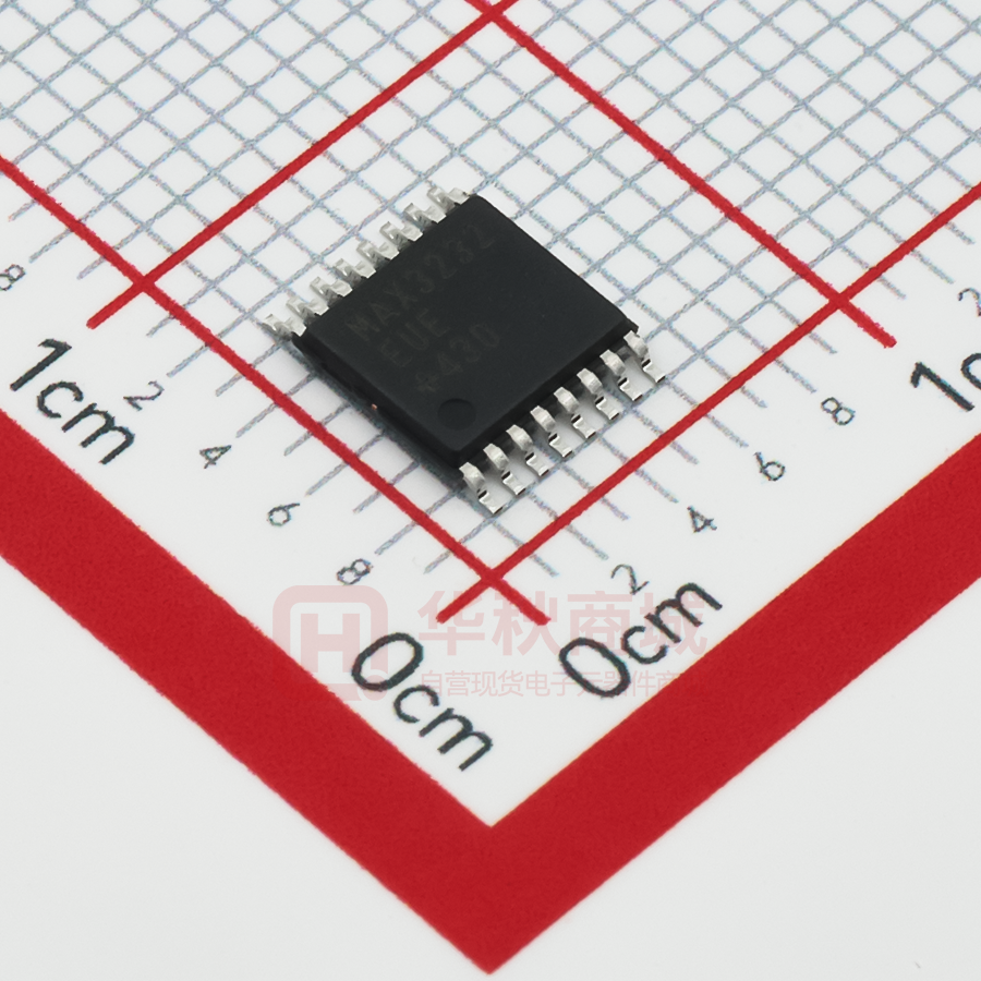

Click here for production status of specific part numbers. MAX3222/MAX3232/ MAX3237/MAX3241* General Description The MAX3222/MAX3232/MAX3237/MAX3241 transceivers have a proprietary low-dropout transmitter output stage enabling true RS-232 performance from a 3.0V to 5.5V supply with a dual charge pump. The devices require only four small 0.1µF external charge-pump capacitors. The MAX3222, MAX3232, and MAX3241 are guaranteed to run at data rates of 120kbps while maintaining RS-232 output levels. The MAX3237 is guaranteed to run at data rates of 250kbps in normal operating mode and 1Mbps in the MegaBaud™ operating mode. The MAX3222/MAX3232 have 2 receivers and 2 drivers. The MAX3222 and MAX3232 are pin, package, and functionally compatible with the industry-standard MAX242 and MAX232, respectively. The MAX3241 has 5 receivers and 3 drivers, while the MAX3237 has 3 receivers and 5 drivers. Receivers R1 (MAX3237/MAX3241) and R2 (MAX3241) have extra outputs in addition to their standard outputs. These extra outputs are always active, allowing external devices to be monitored without forward biasing the protection diodes in circuitry that may have VCC completely removed. The MAX3222, MAX3232, and MAX3241 are available in space-saving TSSOP and SSOP packages with operating temperatures of either -40°C to +85°C or 0°C to 70°C. 3.0V to 5.5V, Low-Power, Up to 1Mbps, True RS-232 Transceivers Benefits and Features ●● Integrated Features Saves Board Space and Simplifies Design • Charge Pump Circuitry Eliminates the Need for a Bipolar ±12V Supply • Wide Single-Supply Operation From +3V to +5.5V Supply • Always-On Extra Outputs Enable Monitoring of External Devices ●● Power Saving Extends Battery Life • 1µA Supply Current in Shutdown Mode While Receiver is Active (MAX3222, MAX3237, MAX3241) Ordering Information MAX3222CUP+ 0°C to +70°C 20 TSSOP U20+2 MAX3222CAP+ 0°C to +70°C 20 SSOP A20+1 MAX3222CWN+ 0°C to +70°C 18 SO W18+1 MAX3222CPN+ 0°C to +70°C 18 Plastic Dip P18+5 +Denotes lead-free package. Pin Configurations TOP VIEW EN 1 18 SHDN C1+ 2 Battery-Powered Equipment Hand-Held Equipment Peripherals Datacom Equipment 17 VCC V+ 3 16 GND C1- 4 15 T1OUT C2+ 5 Ordering Information continued at end of data sheet. Typical Operating Circuits appear at end of data sheet. PKG CODE TEMP RANGE Applications ●● ●● ●● ●● PINPACKAGE PART MAX3222 14 R1IN C2- 6 13 R1OUT V- 7 12 T1IN T2OUT 8 11 T2IN R2IN 9 10 R2OUT DIP/SO Pin Configurations continued at end of data sheet. MegaBaud and UCSP are trademarks of Maxim Integrated Products, Inc. *Covered by U.S. Patent numbers 4,636,930; 4,679,134; 4,777,577; 4,797,899; 4,809,152; 4,897,774; 4,999,761; and other patents pending. 19-0273; Rev 10; 5/19 MAX3222/MAX3232/ MAX3237/MAX3241 3.0V to 5.5V, Low-Power, Up to 1Mbps, True RS-232 Transceivers Absolute Maximum Ratings VCC...........................................................................-0.3V to +6V V+ (Note 1)...............................................................-0.3V to +7V V- (Note 1)................................................................+0.3V to -7V V+ + V- (Note 1)...................................................................+13V Input Voltages T_IN, SHDN, EN..................................................-0.3V to +6V MBAUD.................................................. -0.3V to (VCC + 0.3V) R_IN.................................................................................±25V Output Voltages T_OUT...........................................................................±13.2V R_OUT................................................... -0.3V to (VCC + 0.3V) Short-Circuit Duration T_OUT....................................................................Continuous Continuous Power Dissipation (TA = +70°C) 16-Pin TSSOP (derate 6.7mW/°C above +70°C).........533mW 16-Pin Narrow SO (derate 8.70mW/°C above +70°C).....696mW 16-Pin Wide SO (derate 9.52mW/°C above +70°C)....762mW 16-Pin Plastic DIP (derate 10.53mW/°C above +70°C)...842mW 18-Pin SO (derate 9.52mW/°C above +70°C)..............762mW 18-Pin Plastic DIP (derate 11.11mW/°C above +70°C)....889mW 20-Pin SSOP (derate 7.00mW/°C above +70°C).........559mW 20-Pin TSSOP (derate 8.0mW/°C above +70°C).........640mW 28-Pin TSSOP (derate 8.7mW/°C above +70°C).........696mW 28-Pin SSOP (derate 9.52mW/°C above +70°C).........762mW 28-Pin SO (derate 12.50mW/°C above +70°C)...................1W Operating Temperature Ranges MAX32_ _C_ _....................................................0°C to +70°C MAX32_ _E_ _ ............................................... -40°C to +85°C Storage Temperature Range............................. -65°C to +150°C Lead Temperature (soldering, 10s).................................. +300°C Note 1: V+ and V- can have a maximum magnitude of 7V, but their absolute difference cannot exceed 13V. Stresses beyond those listed under “Absolute Maximum Ratings” may cause permanent damage to the device. These are stress ratings only, and functional operation of the device at these or any other conditions beyond those indicated in the operational sections of the specifications is not implied. Exposure to absolute maximum rating conditions for extended periods may affect device reliability. Electrical Characteristics (VCC = +3.0V to +5.5V, C1–C4 = 0.1μF (Note 2), TA = TMIN to TMAX, unless otherwise noted. Typical values are at TA = +25°C.) PARAMETER CONDITIONS MIN TYP MAX UNITS MAX3222/MAX3232/ MAX3241 0.3 1.0 MAX3237 0.5 2.0 1.0 10 µA 0.8 V DC CHARACTERISTICS VCC Power-Supply Current No load, VCC = 3.3V or 5.0V, TA = +25°C Shutdown Supply Current SHDN = GND, TA = +25°C mA LOGIC INPUTS AND RECEIVER OUTPUTS Input Logic Threshold Low (Note 3) T_IN, EN, SHDN, MBAUD Input Logic Threshold High (Note 3) VCC = 3.3V 2.0 VCC = 5.0V 2.4 Input Leakage Current T_IN, EN, SHDN, MBAUD ±0.01 ±1.0 µA Output Leakage Current Receivers disabled ±0.05 ±10 µA Output Voltage Low IOUT = 1.6mA 0.4 V Output Voltage High IOUT = -1.0mA VCC 0.6 V VCC - 0.1 V RECEIVER INPUTS Input Voltage Range -25 Input Threshold Low TA = +25°C Input Threshold High TA = +25°C www.maximintegrated.com 25 VCC = 3.3V 0.6 1.2 VCC = 5.0V 0.8 1.5 V V VCC = 3.3V 1.5 2.4 VCC = 5.0V 1.8 2.4 V Maxim Integrated │  2 MAX3222/MAX3232/ MAX3237/MAX3241 3.0V to 5.5V, Low-Power, Up to 1Mbps, True RS-232 Transceivers Electrical Characteristics (continued) (VCC = +3.0V to +5.5V, C1–C4 = 0.1μF (Note 2), TA = TMIN to TMAX, unless otherwise noted. Typical values are at TA = +25°C.) PARAMETER CONDITIONS MIN Input Hysteresis Input Resistance TYP MAX 0.3 TA = +25°C 3 5 UNITS V 7 kΩ TRANSMITTER OUTPUTS Output Voltage Swing All transmitter outputs loaded with 3kΩ to ground ±5.0 ±5.4 V Output Resistance VCC = V+ = V- = 0V, VOUT = ±2V 300 10M Ω Output Short-Circuit Current Output Leakage Current ±35 VOUT = ±12V, VCC = 0V or 3V to 5.5V, transmitters disabled ±60 mA ±25 µA MOUSE DRIVEABILITY (MAX3241) Transmitter Output Voltage T1IN = T2IN = GND, T3IN = VCC, T3OUT loaded with 3kΩ to GND, T1OUT and T2OUT loaded with 2.5mA each ±5.0 V Timing Characteristics—MAX3222/MAX3232/MAX3241 (VCC = +3.0V to +5.5V, C1–C4 = 0.1μF (Note 2), TA = TMIN to TMAX, unless otherwise noted. Typical values are at TA = +25°C.) PARAMETER CONDITIONS MIN TYP 120 235 MAX UNITS Maximum Data Rate RL = 3kΩ, CL = 1000pF, one transmitter switching Receiver Propagation Delay R_IN to R_OUT, CL = 150pF Receiver Output Enable Time Normal operation 200 ns Receiver Output Disable Time Normal operation 200 ns Transmitter Skew | tPHL - tPLH | 300 ns Receiver Skew | tPHL - tPLH | 300 ns Transition-Region Slew Rate VCC = 3.3V, RL = 3kΩ to 7kΩ, +3V to -3V or -3V to +3V, TA = +25°C, one transmitter switching www.maximintegrated.com tPHL 0.3 tPLH 0.3 kbps μs CL = 150pF to 1000pF 6 30 CL = 150pF to 2500pF 4 30 V/μs Maxim Integrated │  3 MAX3222/MAX3232/ MAX3237/MAX3241 3.0V to 5.5V, Low-Power, Up to 1Mbps, True RS-232 Transceivers Timing Characteristics—MAX3237 (VCC = +3.0V to +5.5V, C1–C4 = 0.1μF (Note 2), TA = TMIN to TMAX, unless otherwise noted. Typical values are at TA = +25°C.) PARAMETER CONDITIONS Maximum Data Rate MIN RL = 3kΩ, CL = 1000pF, one transmitter switching, MBAUD = GND 250 VCC = 3.0V to 4.5V, RL = 3kΩ, CL = 250pF, one transmitter switching, MBAUD = VCC 1000 VCC = 4.5V to 5.5V, RL = 3kΩ, CL = 1000pF, one transmitter switching, MBAUD = VCC 1000 TYP MAX UNITS kbps tPHL 0.15 tPLH 0.15 µs Receiver Propagation Delay R_IN to R_OUT, CL = 150pF Receiver Output Enable Time Normal operation 200 ns Receiver Output Disable Time Normal operation 200 ns | tPHL - tPLH |, MBAUD = GND 100 ns | tPHL - tPLH |, MBAUD = VCC 25 ns | tPHL - tPLH | 50 ns Transmitter Skew Receiver Skew CL = 150pF to 1000pF VCC = 3.3V, RL = 3Ω to 7kΩ, +3V to -3V or -3V to +3V, TA = +25°C Transition-Region Slew Rate MBAUD = GND 6 30 MBAUD = VCC 24 150 4 30 CL = 150pF to 2500pF, MBAUD = GND V/μs Note 2: MAX3222/MAX3232/MAX3241: C1–C4 = 0.1μF tested at 3.3V ±10%; C1 = 0.047μF, C2–C4 = 0.33μF tested at 5.0V ±10%. MAX3237: C1–C4 = 0.1μF tested at 3.3V ±5%; C1–C4 = 0.22μF tested at 3.3V ±10%; C1 = 0.047μF, C2–C4 = 0.33μF tested at 5.0V ±10%. Note 3: Transmitter input hysteresis is typically 250mV. Typical Operating Characteristics (VCC = +3.3V, 235kbps data rate, 0.1μF capacitors, all transmitters loaded with 3kΩ, TA = +25°C, unless otherwise noted.) MAX3222/MAX3232 SLEW RATE vs. LOAD CAPACITANCE 22 FOR DATA RATES UP TO 235kbps 20 40 35 2 1 0 -1 -2 -3 SUPPLY CURRENT (mA) 18 16 14 -SLEW 12 10 +SLEW 8 6 -4 4 VOUT- -5 0 0 1000 2000 3000 4000 LOAD CAPACITANCE (pF) www.maximintegrated.com 5000 235kbps 30 25 120kbps 20 15 20kbps 10 5 2 -6 MAX3222-03 4 3 MAX3222/MAX3232 SUPPLY CURRENT vs. LOAD CAPACITANCE WHEN TRANSMITTING DATA MAX3222-02 VOUT+ MAX3222-01 6 5 SLEW RATE (V/µs) TRANSMITTER OUTPUT VOLTAGE (V) MAX3222/MAX3232 TRANSMITTER OUTPUT VOLTAGE vs. LOAD CAPACITANCE 0 150 1000 2000 3000 4000 LOAD CAPACITANCE (pF) 5000 0 1000 2000 3000 4000 5000 LOAD CAPACITANCE (pF) Maxim Integrated │  4 MAX3222/MAX3232/ MAX3237/MAX3241 3.0V to 5.5V, Low-Power, Up to 1Mbps, True RS-232 Transceivers Typical Operating Characteristics (continued) (VCC = +3.3V, 235kbps data rate, 0.1μF capacitors, all transmitters loaded with 3kΩ, TA = +25°C, unless otherwise noted.) MAX3241 SLEW RATE vs. LOAD CAPACITANCE 5.0 24 22 1 TRANSMITTER AT 235kbps 2 TRANSMITTERS AT 30kbps 0 -2.5 VOUT- -5.0 0 1000 2000 3000 4000 14 12 +SLEW 10 30 120kbps 25 20 20kbps 15 8 10 6 5 5000 0 1000 0 2000 3000 4000 0 5000 1000 2000 3000 4000 5000 LOAD CAPACITANCE (pF) LOAD CAPACITANCE (pF) LOAD CAPACITANCE (pF) MAX3237 TRANSMITTER OUTPUT VOLTAGE vs. LOAD CAPACITANCE (MBAUD = GND) MAX3237 TRANSMITTER OUTPUT VOLTAGE vs. LOAD CAPACITANCE (MBAUD = VCC) MAX3237 SLEW RATE vs. LOAD CAPACITANCE (MBAUD = GND) 0 -2.5 -5.0 -7.5 2.5 1 TRANSMITTER AT FULL DATA RATE 4 TRANSMITTERS AT 1/16 DATA RATE 3kΩ + CL LOAD, EACH OUTPUT VCC = 3.3V 0 -2.5 1000 2000 3000 4000 5000 4 1Mbps SUPPLY CURRENT (mA) 1 TRANSMITTER AT FULL DATA RATE 4 TRANSMITTERS AT 1/16 DATA RATE 3kΩ + CL LOAD EACH OUTPUT VCC = 3.3V 0 2000 500 1000 1500 LOAD CAPACITANCE (pF) www.maximintegrated.com 70 2000 3000 20kbps 20 1 TRANSMITTER AT FULL DATA RATE 4 TRANSMITTERS AT 1/16 DATA RATE 3kΩ + CL LOADS VCC = 3.3V 0 1000 2000 3000 4000 LOAD CAPACITANCE (pF) AVERAGE; 10 PARTS 30 20 0 5000 MAX 40 30 4000 1 TRANSMITTER AT 512kbps 4 TRANSMITTERS AT 32kbps 3kΩ + CL LOADS VCC = 3.3V MBAUD = VCC 60 50 120kbps 40 1000 MAX3237 SKEW vs. LOAD CAPACITANCE (tPLH - tPHL) 240kbps 10 2000 0 LOAD CAPACITANCE (pF) MAX3222-11 50 30 0 1500 60 MAX3222-10 40 10 1000 MAX3237 SUPPLY CURRENT vs. LOAD CAPACITANCE (MBAUD = GND) -SLEW, 1Mbps +SLEW, 1Mbps -SLEW, 2Mbps +SLEW, 2Mbps 20 500 MAX3237 SLEW RATE vs. LOAD CAPACITANCE (MBAUD = VCC) 50 1 TRANSMITTER AT 240kbps 4 TRANSMITTERS AT 15kbps 3kΩ + CL LOADS VCC = 3.3V 0 0 LOAD CAPACITANCE (pF) 60 MAX3222-09 6 2 LOAD CAPACITANCE (pF) 70 +SLEW 8 -7.5 0 -SLEW 1.5Mbps 2Mbps -5.0 10 1.5Mbps MAX3222-12 1 TRANSMITTER AT 240kbps 4 TRANSMITTERS AT 15kbps 3kΩ + CL LOADS VCC = 3.3V 2Mbps SLEW RATE (V/µs) 2.5 1Mbps 5.0 12 MAX3222-08 5.0 7.5 TRANSMITTER OUTPUT VOLTAGE (V) MAX3222-07 7.5 TRANSMITTER OUTPUT VOLTAGE (V) -SLEW 16 35 4 -7.5 SLEW RATE (V/µs) 18 235kbps 40 SUPPLY CURRENT (mA) SLEW RATE (V/µs) 20 2.5 45 MAX3222-05 VOUT+ MAX3222-04 TRANSMITTER OUTPUT VOLTAGE (V) 7.5 MAX3241 SUPPLY CURRENT vs. LOAD CAPACITANCE WHEN TRANSMITTING DATA MAX3222-06 MAX3241 TRANSMITTER OUTPUT VOLTAGE vs. LOAD CAPACITANCE 10 MIN 0 5000 0 500 1000 1500 2000 2500 LOAD CAPACITANCE (pF) Maxim Integrated │  5 MAX3222/MAX3232/ MAX3237/MAX3241 3.0V to 5.5V, Low-Power, Up to 1Mbps, True RS-232 Transceivers Pin Description PIN MAX3222 MAX3232 MAX3237 MAX3241 NAME FUNCTION DIP/SO SSOP 1 1 — 13 23 EN Receiver Enable. Active low. 2 2 1 28 28 C1+ Positive Terminal of Voltage-Doubler Charge-Pump Capacitor 3 3 2 27 27 V+ +5.5V Generated by the Charge Pump 4 4 3 25 24 C1- Negative Terminal of Voltage-Doubler Charge-Pump Capacitor 5 5 4 1 1 C2+ Positive Terminal of Inverting Charge-Pump Capacitor 6 6 5 3 2 C2- Negative Terminal of Inverting Charge-Pump Capacitor 7 7 6 4 3 V- 8, 15 8, 17 7, 14 5, 6, 7, 10, 12 9, 10, 11 T_OUT 9, 14 9, 16 8, 13 8, 9, 11 4–8 R_IN 10, 13 10, 15 9, 12 18, 20, 21 15–19 R_OUT TTL/CMOS Receiver Outputs 11, 12 12, 13 10, 11 17, 19, 22, 23, 24 12, 13, 14 T_IN TTL/CMOS Transmitter Inputs 16 18 15 2 25 GND Ground 17 19 16 26 26 VCC +3.0V to +5.5V Supply Voltage 18 20 — 14 22 SHDN Shutdown Control. Active low. — 11, 14 — — — N.C. — — — 15 — MBAUD MegaBaud Control Input. Connect to GND for normal operation; connect to VCC for 1Mbps transmission rates. — — — 16 20, 21 R_OUTB Noninverting Complementary Receiver Outputs. Always active. www.maximintegrated.com -5.5V Generated by the Charge Pump RS-232 Transmitter Outputs RS-232 Receiver Inputs No Connection Maxim Integrated │  6 MAX3222/MAX3232/ MAX3237/MAX3241 3.0V to 5.5V, Low-Power, Up to 1Mbps, True RS-232 Transceivers Detailed Description The MAX3222/MAX3237/MAX3241’s output stage is turned off (high impedance) when the device is in shutdown mode. When the power is off, the MAX3222/ MAX3232/MAX3237/MAX3241 permit the outputs to be driven up to ±12V. Dual Charge-Pump Voltage Converter The MAX3222/MAX3232/MAX3237/MAX3241’s internal power supply consists of a regulated dual charge pump that provides output voltages of +5.5V (doubling charge pump) and -5.5V (inverting charge pump), regardless of the input voltage (VCC) over the 3.0V to 5.5V range. The charge pumps operate in a discontinuous mode; if the output voltages are less than 5.5V, the charge pumps are enabled, and if the output voltages exceed 5.5V, the charge pumps are disabled. Each charge pump requires a flying capacitor (C1, C2) and a reservoir capacitor (C3, C4) to generate the V+ and V- supplies. RS-232 Transmitters The transmitters are inverting level translators that convert CMOS-logic levels to 5.0V EIA/TIA-232 levels. The MAX3222/MAX3232/MAX3241 transmitters guarantee a 120kbps data rate with worst-case loads of 3kΩ in parallel with 1000pF, providing compatibility with PC-to-PC communication software (such as LapLink™). Typically, these three devices can operate at data rates of 235kbps. Transmitters can be paralleled to drive multiple receivers or mice. The transmitter inputs do not have pullup resistors. Connect unused inputs to GND or VCC. MAX3237 MegaBaud Operation In normal operating mode (MBAUD = GND), the MAX3237 transmitters guarantee a 250kbps data rate with worstcase loads of 3kΩ in parallel with 1000pF. This provides compatibility with PC-to-PC communication software, such as LapLink. For higher speed serial communications, the MAX3237 features MegaBaud operation. In MegaBaud operating mode (MBAUD = VCC), the MAX3237 transmitters guarantee a 1Mbps data rate with worst-case loads of 3kΩ in parallel with 250pF for 3.0V < VCC < 4.5V. For 5V ±10% operation, the MAX3237 transmitters guarantee a 1Mbps data rate into worst-case loads of 3kΩ in parallel with 1000pF. LapLink is a trademark of Traveling Software, Inc. VCC VCC 0.1µF 0.1µF VCC C1+ C1 C1C2+ C2 C2- C3 MAX3222 MAX3232 MAX3237 MAX3241 C2+ V- C4 C2 C2- T_ OUT 0V 5kΩ GND V+ C3 MAX3222 MAX3232 MAX3237 MAX3241 VC4 T_ OUT R_ IN R_ OUT EN* SHDN* VCC T_ IN R_ IN R_ OUT VCC C1 C1- T_ IN 0V C1+ V+ 3kΩ 2500pF VCC EN* 5kΩ SHDN* GND 7kΩ 150pF *MAX3222/MAX3237/MAX3241 ONLY MINIMUM SLEW-RATE TEST CIRCUIT MAXIMUM SLEW-RATE TEST CIRCUIT Figure 1. Slew-Rate Test Circuits www.maximintegrated.com Maxim Integrated │  7 MAX3222/MAX3232/ MAX3237/MAX3241 3.0V to 5.5V, Low-Power, Up to 1Mbps, True RS-232 Transceivers RS-232 Receivers The receivers convert RS-232 signals to CMOS-logic output levels. The MAX3222/MAX3237/MAX3241 receivers have inverting three-state outputs. In shutdown, the receivers can be active or inactive (Table 1). The complementary outputs on the MAX3237 (R1OUTB) and the MAX3241 (R1OUTB, R2OUTB) are always active, regardless of the state of EN or SHDN. This allows for Ring Indicator applications without forward biasing other devices connected to the receiver outputs. This is ideal for systems where VCC is set to 0V in shutdown to accommodate peripherals, such as UARTs (Figure 2). VCC PREVIOUS RS-232 VCC Rx PROTECTION DIODE 5kΩ UART Tx GND MAX3222/MAX3237/MAX3241 Shutdown Mode SHDN = GND Supply current falls to less than 1μA in shutdown mode (SHDN = low). When shut down, the device’s charge pumps are turned off, V+ is pulled down to VCC, V- is pulled to ground, and the transmitter outputs are disabled (high impedance). The time required to exit shutdown is typically 100μs, as shown in Figure 3. Connect SHDN to VCC if the shutdown mode is not used. SHDN has no effect on R_OUT or R_OUTB. a) OLDER RS-232: POWERED-DOWN UART DRAWS CURRENT FROM ACTIVE RECEIVER OUTPUT IN SHUTDOWN. VCC TO µP LOGIC TRANSITION DETECTOR MAX3222/MAX3237/MAX3241 Enable Control The inverting receiver outputs (R_OUT) are put into a high-impedance state when EN is high. The complementary outputs R1OUTB and R2OUTB are always active, regardless of the state of EN and SHDN (Table 1). EN has no effect on T_OUT. MAX3237 MAX3241 R1OUTB VCC Rx R1OUT PROTECTION DIODE EN = VCC UART T1IN Tx GND R1IN T1OUT SHDN = GND b) NEW MAX3237/MAX3241: EN SHUTS DOWN RECEIVER OUTPUTS (EXCEPT FOR B OUTPUTS), SO NO CURRENT FLOWS TO UART IN SHUTDOWN. B OUTPUTS INDICATE RECEIVER ACTIVITY DURING SHUTDOWN WITH EN HIGH. Figure 2. Detection of RS-232 Activity when the UART and Interface are Shut Down; Comparison of MAX3237/MAX3241 (b) with Previous Transceivers (a). www.maximintegrated.com Applications Information Capacitor Selection 5kΩ The capacitor type used for C1–C4 is not critical for proper operation; polarized or nonpolarized capacitors can be used. The charge pump requires 0.1μF capacitors for 3.3V operation. For other supply voltages, refer to Table 2 for required capacitor values. Do not use values lower than those listed in Table 2. Increasing the capacitor values (e.g., by a factor of 2) reduces ripple on the transmitter outputs and slightly reduces power consumption. C2, C3, and C4 can be increased without changing C1’s value. However, do not increase C1 without also increasing the values of C2, C3, and C4, to maintain the proper ratios (C1 to the other capacitors). When using the minimum required capacitor values, make sure the capacitor value does not degrade excessively with temperature. If in doubt, use capacitors with a higher nominal value. The capacitor’s equivalent series resistance (ESR), which usually rises at low temperatures, influences the amount of ripple on V+ and V-. Maxim Integrated │  8 MAX3222/MAX3232/ MAX3237/MAX3241 3.0V to 5.5V, Low-Power, Up to 1Mbps, True RS-232 Transceivers Table 1. MAX3222/MAX3237/MAX3241 Shutdown and Enable Control Truth Table Power-Supply Decoupling SHDN EN T_OUT R_OUT R_OUTB (MAX3237/ MAX3241) 0 0 High-Z Active Active 0 1 High-Z High-Z Active 1 0 Active Active Active 1 1 Active High-Z Active Table 2. Required Minimum Capacitor Values V CC (V) C1 (µF) C2, C3, C4 (µF) MAX3222/MAX3232/MAX3241 3.0 to 3.6 0.1 0.1 4.5 to 5.5 0.047 0.33 3.0 to 5.5 0.1 0.47 MAX3237 3.0 to 3.6 0.22 0.22 3.15 to 3.6 0.1 0.1 4.5 to 5.5 0.047 0.33 3.0 to 5.5 0.22 1.0 5V/div In most circumstances, a 0.1μF bypass capacitor is adequate. In applications that are sensitive to powersupply noise, decouple VCC to ground with a capacitor of the same value as charge-pump capacitor C1. Connect bypass capacitors as close to the IC as possible. Operation Down to 2.7V Transmitter outputs will meet EIA/TIA-562 levels of ±3.7V with supply voltages as low as 2.7V. Transmitter Outputs when Exiting Shutdown Figure 3 shows two transmitter outputs when exiting shutdown mode. As they become active, the two transmitter outputs are shown going to opposite RS-232 levels (one transmitter input is high, the other is low). Each transmitter is loaded with 3kΩ in parallel with 2500pF. The transmitter outputs display no ringing or undesirable transients as they come out of shutdown. Note that the transmitters are enabled only when the magnitude of V- exceeds approximately 3V. Mouse Driveability The MAX3241 has been specifically designed to power serial mice while operating from low-voltage power supplies. It has been tested with leading mouse brands from manufacturers such as Microsoft and Logitech. The MAX3241 successfully drove all serial mice tested and met their respective current and voltage requirements. Figure 4a shows the transmitter output voltages under increasing load current at 3.0V. Figure 4b shows a typical mouse connection using the MAX3241. T2 2V/div T1 50µs/div VCC = 3.3V C1–C4 = 0.1µF Figure 3. Transmitter Outputs when Exiting Shutdown or Powering Up www.maximintegrated.com Maxim Integrated │  9 3.0V to 5.5V, Low-Power, Up to 1Mbps, True RS-232 Transceivers 6 5 4 3 VOUT+ VCC = 3.0V 2 1 T1 0 -1 T2 MAX3222-04 TRANSMITTER OUTPUT VOLTAGE (V) MAX3222/MAX3232/ MAX3237/MAX3241 VOUT+ -2 -3 VCC VOUT- T3 VOUT- -4 -5 -6 0 1 2 3 4 5 6 7 LOAD CURRENT PER TRANSMITTER (mA) Figure 4a. MAX3241 Transmitter Output Voltage vs. Load Current per Transmitter VCC = 3V to 5.5V 28 C1 C2 C1+ 0.1µF 26 VCC V+ 27 C3 24 C11 C2+ 2 C214 T1IN COMPUTER SERIAL PORT MAX3241 V- 3 C4 T1OUT 9 13 T2IN T2OUT 10 12 T3IN T3OUT 11 +V VCC -V 21 R1OUTB GND 20 R2OUTB 19 R1OUT R1IN 4 18 R2OUT 5kΩ R2IN 5 17 R3OUT 5kΩ R3IN 6 16 R4OUT 5kΩ R4IN 7 R5IN 8 15 R5OUT 23 EN +V 5kΩ MOUSE 5kΩ GND 25 Tx SHDN 22 Figure 4b. Mouse Driver Test Circuit www.maximintegrated.com Maxim Integrated │  10 MAX3222/MAX3232/ MAX3237/MAX3241 3.0V to 5.5V, Low-Power, Up to 1Mbps, True RS-232 Transceivers VCC 0.1µF V+ C3 C1C2+ C2 C2- 5V/div T1OUT 5V/div R1OUT 5V/div VCC C1+ C1 T1IN MAX3222 MAX3232 MAX3237 MAX3241 VC4 5µs/div VCC = 3.3V T_ OUT T_ IN Figure 6. MAX3241 Loopback Test Result at 120kbps R_ IN R_ OUT 0V VCC EN* SHDN* 5kΩ 1000pF T1IN 5V/div T1OUT 5V/div R1OUT 5V/div GND * MAX3222/MAX3241 ONLY Figure 5. Loopback Test Circuit High Data Rates The MAX3222/MAX3232/MAX3241 maintain the RS-232 ±5.0V minimum transmitter output voltage even at high data rates. Figure 5 shows a transmitter loopback test circuit. Figure 6 shows a loopback test result at 120kbps, and Figure 7 shows the same test at 235kbps. For Figure 6, all transmitters were driven simultaneously at 120kbps into RS-232 loads in parallel with 1000pF. For Figure 7, a single transmitter was driven at 235kbps, and all transmitters were loaded with an RS-232 receiver in parallel with 1000pF. The MAX3237 maintains the RS-232 ±5.0V minimum transmitter output voltage at data rates up to 1Mbps. Figure 8 shows a loopback test result at 1Mbps with MBAUD = VCC. For Figure 8, all transmitters were loaded with an RS-232 receiver in parallel with 250pF. 2µs/div VCC = 3.3V Figure 7. MAX3241 Loopback Test Result at 235kbps +5V T_IN 0V +5V T_OUT = R_IN 5kΩ + 250pF 0V -5V +5V R_OUT 150pF 0V 200ns/div VCC = 3.3V Figure 8. MAX3237 Loopback Test Result at 1000kbps (MBAUD = VCC) www.maximintegrated.com Maxim Integrated │  11 MAX3222/MAX3232/ MAX3237/MAX3241 3.0V to 5.5V, Low-Power, Up to 1Mbps, True RS-232 Transceivers Interconnection with 3V and 5V Logic Table 3. Logic-Family Compatibility with Various Supply Voltages The MAX3222/MAX3232/MAX3237/MAX3241 can directly interface with various 5V logic families, including ACT and HCT CMOS. See Table 3 for more information on possible combinations of interconnections. SYSTEM POWERSUPPLY VOLTAGE (V) MAX32_ _ V CC SUPPLY VOLTAGE (V) 3.3 3.3 5 5 5 3.3 COMPATIBILITY Compatible with all CMOS families. Compatible with all TTL and CMOS-logic families Compatible with ACT and HCT CMOS, and with TTL. Incompatible with AC, HC, and CD4000 CMOS. Typical Operating Circuits +3.3V +3.3V 17 0.1µF C1 0.1µF 2 C1+ 4 5 C2 0.1µF 6 C1- V+ MAX3222 C2+ V- 3 0.1µF C4 0.1µF 0.1µF T2OUT 8 TTL/CMOS OUTPUTS 5kΩ 10 R2OUT R2IN 9 V+ C2+ V- GND 16 SHDN 6 C2- C4 0.1µF T1OUT 14 RS-232 OUTPUTS T2OUT 7 R1IN 13 12 R1OUT TTL/CMOS OUTPUTS 5kΩ 9 R2OUT R2IN 8 5kΩ EN C3* 0.1µF MAX3232 10 T2IN RS-232 INPUTS 2 TTL/CMOS INPUTS R1IN 14 13 R1OUT 5 C1- VCC 11 T1IN RS-232 OUTPUTS 11 T2IN 3 4 T1OUT 15 TTL/CMOS INPUTS 1 1 C1+ C3* 0.1µF 7 C2- 12 T1IN 16 0.1µF VCC RS-232 INPUTS 5kΩ 18 GND 15 PIN NUMBERS REFER TO DIP/SO PACKAGES. * C3 CAN BE RETURNED TO EITHER VCC OR GROUND. * C3 CAN BE RETURNED TO EITHER VCC OR GROUND. SEE TABLE 2 FOR CAPACITOR SELECTION www.maximintegrated.com Maxim Integrated │  12 MAX3222/MAX3232/ MAX3237/MAX3241 3.0V to 5.5V, Low-Power, Up to 1Mbps, True RS-232 Transceivers Typical Operating Circuits (continued) 0.1µF +3.3V 26 0.1µF 28 C1+ 3 C2+ 27 0.1µF MAX3237 V- 4 23 T2IN 22 T3IN 19 T4IN T1 T2 T3 0.1µF T4 T1OUT 5 T2OUT 6 T3OUT 7 28 C1+ TTL/CMOS INPUTS RS-232 OUTPUTS VCC V+ 2 C2+ MAX3241 T5 14 T1IN T1OUT 9 13 T2IN T2OUT 10 12 T3IN T3OUT 11 RS-232 OUTPUTS 21 R1OUTB 19 R1OUT R1IN 4 5kΩ R2IN 18 R2OUT 5 R1IN 8 R1 TTL/CMOS OUTPUTS R2IN R2 9 R3IN 11 R3 RS-232 INPUTS 5kΩ 17 R3OUT R3IN 6 16 R4OUT R4IN 7 5kΩ 15 R5OUT MBAUD 13 EN GND SHDN RS-232 INPUTS 5kΩ 5kΩ R5IN 8 15 14 2 * C3 CAN BE RETURNED TO EITHER VCC OR GROUND. www.maximintegrated.com C4 0.1µF T5OUT 12 5kΩ 18 R3OUT 3 T4OUT 10 5kΩ 20 R2OUT V- C2- 16 R1OUTB LOGIC OUTPUTS C3* 0.1µF 20 R2OUTB 17 T5IN 21 R1OUT 27 24 C11 0.1µF C2- 24 T1IN LOGIC INPUTS V+ 25 C11 0.1µF VCC 26 0.1µF 0.1µF 5kΩ 23 EN GND SHDN 22 25 * C3 CAN BE RETURNED TO EITHER VCC OR GROUND. Maxim Integrated │  13 MAX3222/MAX3232/ MAX3237/MAX3241 3.0V to 5.5V, Low-Power, Up to 1Mbps, True RS-232 Transceivers Pin Configurations (continued) TOP VIEW EN 1 20 SHDN C1+ 2 19 VCC C1+ 1 V+ 3 18 GND V+ 2 15 GND C1- 4 17 T1OUT C1- 3 14 T1OUT C2+ 5 16 R1IN C2+ 4 C2- 6 15 R1OUT C2- 5 V- 7 14 N.C. V- 6 11 T1IN T2OUT 8 13 T1IN T2OUT 7 10 T2IN R2IN 9 12 T2IN R2IN 8 R2OUT 10 11 N.C. MAX3222 + 16 VCC MAX3232 13 R1IN 12 R1OUT 9 R2OUT DIP/SO/SSOP/TSSOP SSOP/TSSOP C2+ 1 + 28 C1+ C2+ 1 + 28 C1+ 27 V+ C2- 2 27 V+ C2- 3 26 VCC V- 3 26 VCC V- 4 25 C1- R1IN 4 25 GND 24 T1IN R2IN 5 24 C1- 23 T2IN R3IN 6 22 T3IN R4IN 7 22 SHDN R1IN 8 21 R1OUT R5IN 8 21 R1OUTB R2IN 9 20 R2OUT T1OUT 9 20 R2OUTB 19 T4IN T2OUT 10 19 R1OUT 18 R3OUT T3OUT 11 18 R2OUT 17 T5IN T3IN 12 17 R3OUT 16 R1OUTB T2IN 13 16 R4OUT 15 MBAUD T1IN 14 15 R5OUT GND 2 T1OUT 5 T2OUT 6 MAX3237 T3OUT 7 T4OUT 10 R3IN 11 T5OUT 12 EN 13 SHDN 14 SSOP www.maximintegrated.com MAX3241 23 EN SO/SSOP/TSSOP Maxim Integrated │  14 MAX3222/MAX3232/ MAX3237/MAX3241 3.0V to 5.5V, Low-Power, Up to 1Mbps, True RS-232 Transceivers Ordering Information (continued) PART TEMP RANGE PINPACKAGE PKG CODE PART TEMP RANGE PINPACKAGE PKG CODE MAX3222EUP+ -40°C to +85°C 20 TSSOP U20+2 MAX3232EWE+ -40°C to +85°C 16 Wide SO W16+1 MAX3222EAP+ -40°C to +85°C 20 SSOP A20+1 MAX3232EPE+ -40°C to +85°C 16 Plastic DIP P16+1 MAX3222EWN+ -40°C to +85°C 18 SO W18+1 MAX3237CAI+ 0°C to +70°C 16 SSOP A28+2 MAX3222EPN+ -40°C to +85°C 18 Plastic Dip P18+5 MAX3237EAI+ -40°C to +85°C 28 SSOP A28+1 — MAX3241CUI+ 0°C to +70°C 28 TSSOP U28+2 MAX3222C/D 0°C to +70°C Dice* MAX3232CAE+ 0°C to +70°C 16 SSOP A16+2 MAX3241CAI+ 0°C to +70°C 28 SSOP A28+1 MAX3232CUE+ 0°C to +70°C 16 TSSOP U16+1 MAX3241CWI+ 0°C to +70°C 28 SO W28+6 MAX3232CSE+ 0°C to +70°C 16 Narrow SO S16+1 MAX3241EUI+ -40°C to +85°C 28 TSSOP U28+2 MAX3232CWE+ 0°C to +70°C 16 Wide SO W16+1 MAX3241EAI+ -40°C to +85°C 28 SSOP A28+1 MAX3232CPE+ 0°C to +70°C 16 Plastic DIP P16+1 MAX3241EWI+ -40°C to +85°C 28 SO W28+6 MAX3232EUE+ -40°C to +85°C 16 TSSOP U16+1 MAX3232ESE+ -40°C to +85°C 16 Narrow SO S16+5 *Dice are tested at TA = +25°C, DC parameters only. +Denotes lead-free package. 3V-Powered EIA/TIA-232 and EIA/TIA-562 Transceivers from Maxim PART POWERSUPPLY VOLTAGE (V) NO. OF TRANSMITTERS/ RECEIVERS NO. OF RECEIVERS ACTIVE IN SHUTDOWN GUARANTEED DATA RATE (kbps) EIA/ TIA-232 OR 562 MAX212 3.0 to 3.6 3/5 5 120 232 Drives mice MAX218 1.8 to 4.25 2/2 2 120 232 Operates directly from batteries without a voltage regulator MAX562 2.7 to 5.25 3/5 5 230 562 Wide supply range MAX563 3.0 to 3.6 2/2 2 230 562 0.1μF capacitors MAX3212 2.7 to 3.6 3/5 5 235 232 AutoShutdown, complementary receiver, drives mice, transient detection MAX3222 3.0 to 5.5 2/2 2 120 232 0.1μF capacitors MAX3223 3.0 to 5.5 2/2 2 120 232 0.1μF capacitors, AutoShutdown MAX3232 3.0 to 5.5 2/2 N/A 120 232 0.1μF capacitors MAX3237 3.0 to 5.5 5/3 3 250/1000 232 0.1μF capacitors, 1 complementary receiver, MegaBaud operation MAX3241 3.0 to 5.5 3/5 5 120 232 0.1μF capacitors, 2 complementary receivers, drives mice MAX3243 3.0 to 5.5 3/5 1 120 232 0.1μF capacitors, AutoShutdown, complementary receiver, drives mice www.maximintegrated.com FEATURES Maxim Integrated │  15 MAX3222/MAX3232/ MAX3237/MAX3241 3.0V to 5.5V, Low-Power, Up to 1Mbps, True RS-232 Transceivers Package Information For the latest package outline information and land patterns (footprints), go to www.maximintegrated.com/packages. Note that a “+”, “#”, or “-” in the package code indicates RoHS status only. Package drawings may show a different suffix character, but the drawing pertains to the package regardless of RoHS status. PACKAGE TYPE THERMAL RESISTANCE (SINGLE LAYER BOARD) THERMAL RESISTANCE (MULTI LAYER BOARD) PACKAGE CODE OUTLINE NO. LAND PATTERN NO. θJA (°C/W) θJC (°C/W) θJA (°C/W) θJC (°C/W) U20+2 21-0066 90-0116 91 20 73.8 20 20 SSOP A20+1 21-0056 90-0094 125 33 84 32 18 SO W18+1 21-0042 90-0181 105 22 67 23 18 Plastic Dip P18+5 21-0043 — 90 30 NA NA 20 TSSOP Dice* — — — — — — — U16+1 21-0066 90-0117 106 27 90 27 16 Narrow SO S16+1 21-0041 90-0097 115 32 75 24 16 Wide SO W16+1 21-0042 90-0107 105 22 71 23 16 Plastic DIP P16+1 21-0043 — 95 35 NA NA 16 Narrow SO S16+5 21-0041 90-0097 115 32 73 23 16 SSOP A16+2 21-0056 90-0106 140 34 86 33 16 SSOP A28+2 21-0056 90-0095 105 24 67 25 28 SSOP A28+1 21-0056 90-0095 110 25 67.1 25 28 TSSOP U28+2 21-0066 90-0171 78 13 71.6 13 28 SO W28+6 21-0042 90-0109 80 18 59 18 28 TSSOP U28+2 21-0066 90-0171 78 13 71.6 13 16 TSSOP www.maximintegrated.com Maxim Integrated │  16 MAX3222/MAX3232/ MAX3237/MAX3241 3.0V to 5.5V, Low-Power, Up to 1Mbps, True RS-232 Transceivers Revision History REVISION NUMBER REVISION DATE PAGES CHANGED 7 1/07 General updates 1, 15, 16, 17 8 6/18 Updated Package Information and Ordering Information 1, 15, 16, 17 9 4/19 Added Thermal Resistance data in the Package Information table 16 10 5/19 Updated Package Information table 16 DESCRIPTION For pricing, delivery, and ordering information, please visit Maxim Integrated’s online storefront at https://www.maximintegrated.com/en/storefront/storefront.html. Maxim Integrated cannot assume responsibility for use of any circuitry other than circuitry entirely embodied in a Maxim Integrated product. No circuit patent licenses are implied. Maxim Integrated reserves the right to change the circuitry and specifications without notice at any time. The parametric values (min and max limits) shown in the Electrical Characteristics table are guaranteed. Other parametric values quoted in this data sheet are provided for guidance. Maxim Integrated and the Maxim Integrated logo are trademarks of Maxim Integrated Products, Inc. ©  2019 Maxim Integrated Products, Inc. │  17
MAX3232EUE+
物料型号:MAX3222/MAX3232/MAX3237/MAX3241
器件简介:MAX3222/MAX3232/MAX3237/MAX3241 收发器具有专有的低dropout传输器输出级,能够在 3.0V 至 5.5V 供电下通过双充电泵实现真正的 RS-232 性能。
这些设备只需要四个小的 0.1µF 外部充电泵电容器。
MAX3222、MAX3232 和 MAX3241 保证在数据速率为 120kbps 时保持 RS-232 输出电平。
MAX3237 在正常工作模式下保证数据速率为 250kbps,在 MegaBaud™ 工作模式下保证数据速率为 1Mbps。
引脚分配:MAX3222/MAX3232 有 2 个接收器和 2 个驱动器。
MAX3222 和 MAX3232 在引脚、封装和功能上与行业标准的 MAX242 和 MAX232 兼容。
MAX3241 有 5 个接收器和 3 个驱动器,而 MAX3237 有 3 个接收器和 5 个驱动器。
参数特性:MAX3222/MAX3232/MAX3241 在关闭时的供电电流为 1µA(MAX3222、MAX3237、MAX3241),在接收器处于活动状态时节省电量,延长电池寿命。
MAX3222、MAX3232 和 MAX3241 可在空间节省的 TSSOP 和 SSOP 封装中使用,工作温度范围为 -40°C 至 +85°C 或 0°C 至 70°C。
功能详解:MAX3222/MAX3232/MAX3237/MAX3241 的内部电源由一个受控的双充电泵组成,无论输入电压(VCC)在 3.0V 至 5.5V 范围内,都能提供 +5.5V(倍压充电泵)和 -5.5V(反相充电泵)的输出电压。
充电泵以不连续模式运行;如果输出电压低于 5.5V,充电泵被启用,如果输出电压超过 5.5V,充电泵被禁用。
应用信息:适用于电池供电设备、手持设备、外设和数据通信设备。
封装信息:MAX3222、MAX3232 和 MAX3241 提供 20 引脚 TSSOP 和 SSOP 封装,MAX3237 提供 16 引脚 SSOP 封装。
封装选择取决于应用的具体需求和空间限制。
