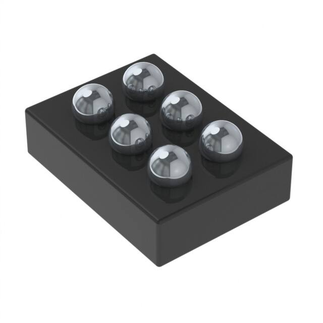

EVALUATION KIT AVAILABLE Click here for production status of specific part numbers. MAX40025A/MAX40025C/ MAX40026 280ps High-Speed Comparator, Ultra-Low Dispersion with LVDS Outputs General Description Benefits and Features The MAX40025 and MAX40026 are single-supply, highspeed comparators with a typical propagation delay of 280ps. The overdrive dispersion is extremely low (typical 25ps), making these comparators ideal for time-of-flight distance measurement applications. ● ● ● ● ● ● ● ● ● The input common mode range of 1.5V to VDD + 0.1V is compatible with the output swings of several widely used high-speed trans-impedance amplifiers, such as the MAX40658. The output stage is LVDS (Low-Voltage Differential Signaling), which helps to minimize power dissipation and interfaces directly with many FPGAs and CPUs. Complementary outputs help in suppression of common-mode noise on each output line. The MAX40025 is offered in a space-saving, tiny, 1.218mm x 0.818mm, 6-bump wafer-level package (WLP), while the MAX40026 is available in a 2mm x 2mm 8-pin TDFN side-wettable package and meets AEC-Q100 automotive qualification requirements. The MAX40025/ MAX40026 operate over -40°C to +125°C temperature range and run from a single supply voltage of 2.7V to 3.6V. Applications ● ● ● ● ● ● ● ● ● ● Distance Sensing in LIDAR, RADAR, and SONAR Time-of-Flight Sensors High-Speed Differential Line Receivers High-Speed Triggering in Oscilloscopes Communications Oscillators Threshold Detectors High-Speed Level-Shifting Test and Measurement Automotive Applications 19-100439; Rev 5; 9/19 Fast Propagation Delay: 280ps, Typ Low Overdrive Dispersion: 25ps (VOD = 10mV to 1V) Supply Voltage 2.7V to 3.6V 39.4mW at 2.7V Supply Power-Efficient LVDS Outputs -40°C to +125°C Temperature Range Automotive AEC-Q100 Qualified (TDFN-8 Version) Internal 1.5mV Hysteresis: MAX40026 Internal 2.5mV Hysteresis: MAX40025A Ordering Information appears at end of data sheet. Functional Diagram VCC IN+ IN- + MAX40025 MAX40026 GND OUT+ LVDS OUT- MAX40025A/MAX40025C/ MAX40026 280ps High-Speed Comparator, Ultra-Low Dispersion with LVDS Outputs Absolute Maximum Ratings VCC to GND........................................................... -0.3V to +3.6V Either IN+ or IN- to GND .............................. -0.3V to VCC + 0.3V Either OUT+ or OUT- to GND ...................... -0.3V to VDD + 0.3V OUT+ to OUT- ....................................................... -0.5V to +0.5V Current Into Any Pin (Continuous) ...................................... 10mA Continuous Power Dissipation (Multilayer Board) (WLP) (TA = +70°C, derate 10.51mW/°C above +70°C)....................... 816mW Continuous Power Dissipation (Multilayer Board) (TDFN) (TA = +70°C, derate 9.8mW/°C above +70°C.) ..........................784mW Operating Temperature Range ...........................-40°C to +125°C Junction Temperature ....................................................... +150°C Storage Temperature Range ..............................-40°C to +150°C Soldering Temperature (reflow) ........................................ +260°C Stresses beyond those listed under “Absolute Maximum Ratings” may cause permanent damage to the device. These are stress ratings only, and functional operation of the device at these or any other conditions beyond those indicated in the operational sections of the specifications is not implied. Exposure to absolute maximum rating conditions for extended periods may affect device reliability. Package Information WLP Package Code W60D1+1 Outline Number 21-100296 Land Pattern Number Refer to Application Note 1891 Thermal Resistance, Four-Layer Board: Junction-to-Ambient (θJA) 95.15°C/W Junction-to-Case Thermal Resistance (θJC) N/A 8-TDFN Package Code T822Y+3 Outline Number 21-100185 Land Pattern Number 90-100070 Thermal Resistance, Single-Layer Board: Junction-to-Ambient (θJA) 130°C/W Junction-to-Case Thermal Resistance (θJC) 8°C/W Thermal Resistance, Four-Layer Board: Junction-to-Ambient (θJA) 102°C/W Junction-to-Case Thermal Resistance (θJC) 8°C/W For the latest package outline information and land patterns (footprints), go to www.maximintegrated.com/packages. Note that a “+”, “#”, or “-” in the package code indicates RoHS status only. Package drawings may show a different suffix character, but the drawing pertains to the package regardless of RoHS status. Package thermal resistances were obtained using the method described in JEDEC specification JESD51-7, using a four-layer board. For detailed information on package thermal considerations, refer to www.maximintegrated.com/ thermal-tutorial. Electrical Characteristics (VCC = 3.3V, VCM = 2.5V, RLOAD = 100Ω, connected from OUT+ to OUT-, TA = -40ºC to +125ºC (Note 1)) PARAMETER SYMBOL Supply Voltage (Note 2) VCC Supply Current ICC www.maximintegrated.com CONDITIONS Guaranteed by PSRR specification MIN TYP 2.7 17 MAX UNITS 3.6 V 23 mA Maxim Integrated | 2 MAX40025A/MAX40025C/ MAX40026 280ps High-Speed Comparator, Ultra-Low Dispersion with LVDS Outputs Electrical Characteristics (continued) (VCC = 3.3V, VCM = 2.5V, RLOAD = 100Ω, connected from OUT+ to OUT-, TA = -40ºC to +125ºC (Note 1)) PARAMETER Power-Up Time Power Supply Rejection Ratio (Note 2) SYMBOL tON PSRR CONDITIONS Measured using supply current >75% of final value 2.7V ≤ VCC ≤ 3.6V 50 1.5 Input Common Mode Range (Note 2) VCM Guaranteed by CMRR specification Input Offset Voltage (Note 2) VOS Over the Input common mode range Common Mode Rejection Ratio (Note 2) CMRR Over the Input common mode range Input Hysteresis VHYS Input Bias Current IB dB µA |VOUT+ - VOUT-| 247 |VOUT+ - VOUT-| -50 Either output polarity -50 Output Common-Mode Transient Either output transition polarity 350 1.23 pF 454 mV +50 mV 1.375 V +50 mV 18 Either output shorted to ground, either polarity Outputs shorted together, either polarity mV 2 Output Common-Mode Voltage Match tOD-disp 80 4 1.125 Overdrive Dispersion mV 0.1 Either output polarity tJITTER 5 µA VOUTDIFF Jitter V 10 Output Differential Voltage tPD VCC + 0.1 1.3 Either input, over entire Input common mode range Propagation Delay dB Over the Input common mode range. Inputs shorted together. CIN ISC 80 1.5 Input Capacitance Output Short-Circuit Current µs MAX40026 VIN+ = VIN- VCMOUT UNITS 20 0.5 52 MAX 2.5 IOS Output Common-Mode Voltage TYP MAX40025A Input Offset Current Output Differential Voltage Match MIN mVp-p 24 -12 mA +12 20mV overdrive 270 100mV overdrive 280 200mV overdrive 280 Measured using square wave with Rise and Fall Time = 150ps, 100mV overdrive 2 10mV to 1V 25 20mV to 100mV 10 ps ps ps Rise Time tR From 25% to 75% output swing 150 ps Fall Time tF From 75% to 25% output swing 165 ps www.maximintegrated.com Maxim Integrated | 3 MAX40025A/MAX40025C/ MAX40026 280ps High-Speed Comparator, Ultra-Low Dispersion with LVDS Outputs Electrical Characteristics (continued) (VCC = 3.3V, VCM = 2.5V, RLOAD = 100Ω, connected from OUT+ to OUT-, TA = -40ºC to +125ºC (Note 1)) PARAMETER SYMBOL Measured using square wave with Rise and Fall Time = 150ps, 100mV overdrive Output Skew Maximum Toggle Rate Minimum Pulse Width CONDITIONS TR VOUT = 550mV, VOD = 100mV MIN TYP Propagation Delay difference between OUT+ and OUT- 10 MAX40025 4 MAX40026 3 both MAX40025/ MAX40026 330 MAX UNITS ps Gbps ps Note 1: Limits are 100% tested at TA = +25°C. Limits over the operating temperature range and relevant supply voltage range are guaranteed by design and characterization. Note 2: Specifications are guaranteed by design and characterization and not production tested. www.maximintegrated.com Maxim Integrated | 4 MAX40025A/MAX40025C/ MAX40026 280ps High-Speed Comparator, Ultra-Low Dispersion with LVDS Outputs Typical Operating Characteristics www.maximintegrated.com Maxim Integrated | 5 MAX40025A/MAX40025C/ MAX40026 280ps High-Speed Comparator, Ultra-Low Dispersion with LVDS Outputs Typical Operating Characteristics (continued) www.maximintegrated.com Maxim Integrated | 6 MAX40025A/MAX40025C/ MAX40026 280ps High-Speed Comparator, Ultra-Low Dispersion with LVDS Outputs Typical Operating Characteristics (continued) Pin Configurations 8 TDFN TOP VIEW 6 VCC 5 IN+ 3 7 GND VCC 2 8 GND OUT+ 1 + OUT- MAX40026 EP 4 IN- 2mm x 2mm WLP TOP VIEW MAX40025A/ MAX40025A/MAX MAX40025C 40025C 2 3 A IN+ VCC OUT+ B IN- GND OUT- + 1 www.maximintegrated.com Maxim Integrated | 7 MAX40025A/MAX40025C/ MAX40026 280ps High-Speed Comparator, Ultra-Low Dispersion with LVDS Outputs Pin Description PIN MAX40026 MAX40025A/ MAX40025C NAME FUNCTION 1 B3 OUT- Inverting LVDS Output. Connect a 100Ω termination resistor between OUTand OUT+. OUT- is at logic-low if VIN+ is at higher voltage compared to VIN-. 2, 3 B2 GND Ground. Signal and power return (for TDFN-8: connect pins 2 and 3 together externally). 4 B1 IN- Inverting Input 5 A1 IN+ Non-Inverting Input 6,7 A2 VCC Positive Supply. For TDFN-8, connect pins 6 and 7 together externally. 8 A3 OUT+ EP — Exposed Paddle www.maximintegrated.com Non-Inverting LVDS Output. Connect a 100Ω termination resistor between OUT+ and OUT-. OUT+ is at logic-high if VIN+ is at higher voltage compared to VIN-. Exposed Pad (TDFN-8 Only). This pad must be connected to ground. Maxim Integrated | 8 MAX40025A/MAX40025C/ MAX40026 280ps High-Speed Comparator, Ultra-Low Dispersion with LVDS Outputs Detailed Description The MAX40025 and MAX40026 are single-supply, high-speed comparators with a typical propagation delay of 280ps. The overdrive dispersion is extremely low (25ps, typ.), making these comparators ideal for time-of-flight distance measurement applications. The input common-mode range of 1.5V to VDD + 0.1V is compatible with the outputs of several widely used high-speed transimpedance amplifiers, such as the MAX40658. The output stage is LVDS (Low-Voltage Differential Signaling), which helps to minimize power dissipation and interfaces directly with many modern FPGAs and CPUs. The MAX40025 and MAX40026 operate from a +2.7V to +3.6V power supply voltage while typically consuming only 17mA quiescent current at 3.3V. The MAX40025 and MAX40026 are available in space-saving 6-WLP and 8-TDFN packages, respectively. LVDS Outputs Each LVDS output has a switched 3.25 mA current source. The outputs are differentially terminated with an external 100Ω resistor, which produces a ±350 mV differential output. The power delivered to the 100Ω load resistor is only 1.1mW while enabling transmission data rates up to a few hundreds of Megabits per second. The output common-mode voltage is maintained at 1.23 V on both outputs, and is independent of power supply voltage. The fully differential LVDS outputs provide high-speed digital signalling with reduced EMI compared to single-ended outputs. System Timing Definitions Table 1. Timing Definitions SYMBOL SPECIFICATION DESCRIPTION VOD Overdrive Voltage Differential voltage applied across inputs during test tPDH Propagation Delay High on OUT+ Propagation delay measured from the time the differential input signal changes polarity (± input VOS) to the 50% point in the output low-to-high transition on OUT+ tPDL Propagation Delay Low on OUT- Propagation delay measured from the time the differential input signal changes polarity (± input VOS) to the 50% point in the output high-to-low transition on OUT- ΔtPDHO Propagation Delay Skew on High Difference in propagation delay on output transition from low to high on OUT+ to propagation delay from high to low on OUT- ΔtPDLO Propagation Delay Skew on Low Difference in propagation delay on output transition from high to low on OUT+ to propagation delay from low to high on OUT- tR Output Rise Time Time taken by either OUT+ or OUT- to rise from 25% of final output voltage to 75% of final output voltage tF Output Fall Time Time taken by either OUT+ or OUT- to fall from 75% of final output voltage to 25% of final output voltage tPDL Propagation Delay Low on OUT- Propagation delay measured from the time the differential input signal changes polarity (± input VOS) to the 50% point in the output high-to-low transition on OUT- tPDH Propagation Delay High on OUT- Propagation delay measured from the time the differential input signal changes polarity (± input VOS) to the 50% point in the output low-to-high transition on OUT- Differential Propagation Delay High Propagation delay measured from the time the differential input signal changes polarity (± input VOS) to the 50% point in the output differential signal across OUT+ to OUT- while switching low to high tPDHD www.maximintegrated.com Maxim Integrated | 9 MAX40025A/MAX40025C/ MAX40026 280ps High-Speed Comparator, Ultra-Low Dispersion with LVDS Outputs Table 1. Timing Definitions (continued) Differential Propagation Delay Low Propagation delay measured from the time the differential input signal changes polarity (± input VOS) to the 50% point in the output differential signal across OUT+ to OUT- while switching high to low VOH Output Voltage High Comparator output high state voltage level VOL Output Voltage Low Comparator output low state voltage level tPDLD VOD DIFFERENTIAL INPUT SIGNAL 0V±VOS ΔtPDHO tR ΔtPDLO tPDH VOUT+ 75% tPDL VOUTtPDL? 25% tF 1.25V tPDH? 1.25V tPDLD 0V tPDHD DIFFERENTIAL OUTPUT SIGNAL Figure 1. System Timing Diagram Propagation Delay The propagation delay is defined as the delay between the differential comparator input voltage changing polarity and the output(s) reaching the mid-point of the high-to-low or low-to-high transition. The low-to-high propagation delay is tPDH on OUT+ and tPDH on OUT-, whereas the high-to-low propagation delay is tPDL on OUT+ and tPDL on OUT-. These high-to-low and low-to-high timing parameters will differ slightly due to mismatches between the two complementary outputs. As a result, this difference in propagation delay is considered to be a skew for a given combination of low-to-high transitions on OUT+ and high-to-low transitions on OUT-. www.maximintegrated.com Maxim Integrated | 10 NON-INVERTING INPUT (mV) MAX40025A/MAX40025C/ MAX40026 280ps High-Speed Comparator, Ultra-Low Dispersion with LVDS Outputs VIN+ VIN- = VREF tPDH VOUT+ ΔtPDHO VOUTtPDL? Figure 2. Propagation Delay Propagation Delay Dispersion Dispersion, or variation of the propagation delay under different conditions, is affected by the amount of overdrive voltage applied to the comparator inputs. As can be seen in the Typical Operating Characteristics, the dispersion is typically under 25ps for 10mV to 1V, a wide range of input overdrive values. VOD = 100mV VOD = 10mV 0V ± VOS DISPERSION 0V Figure 3. Amplitude Overdrive Dispersion Dispersion is also affected by the input slew rate. As the slew rate of the input signal changes, the propagation delay also changes. The dispersion is typically under 15ps from 0.4V/μs to 1V/μs input slew rates. www.maximintegrated.com Maxim Integrated | 11 MAX40025A/MAX40025C/ MAX40026 280ps High-Speed Comparator, Ultra-Low Dispersion with LVDS Outputs 0V ± VOS DISPERSION 0V Figure 4. Slew Rate Dispersion Hysteresis NON-INVERTING INPUT (mV) Adding a small amount hysteresis to a comparator in a noisy environment is useful when input signals are slow-moving and have small noise levels superimposed on them. However, hysteresis must be used carefully when signals are small because it can cause valid signals to be ignored. Figure 5 shows the input signal and output response for a comparator with hysteresis applied. VIN+ VTRIP+ VIN- = VREF VTRIP- OUT VOH VOL VTRIP- 0V VTRIP+ INPUT Figure 5. Hysteresis Transfer Function The MAX40025C is optimized for detecting very small, fast-changing signals and therefore has no internal hysteresis. The MAX40025A has fixed internal 2.5mV hysteresis and the MAX40026 has fixed internal 1.5mV hysteresis, which improves their usefulness for detecting larger differential input signals in the presence of noise. This helps to avoid the external components and potential stability degradation associated with external positive feedback paths. Input Stage Circuitry The MAX40025/MAX40026 include internal protection circuitry that prevents damage to the precision input stage from large differential input voltages. This protection circuitry consists of two groups of two front-to-back diodes between IN+ and IN-, as well as two 50Ω resistors (Figure 6). The diodes limit the differential voltage applied to the comparator’s internal circuitry to no more than 2VF, where VF is the diode’s forward-voltage drop (about 0.7V at +25°C). www.maximintegrated.com Maxim Integrated | 12 MAX40025A/MAX40025C/ MAX40026 280ps High-Speed Comparator, Ultra-Low Dispersion with LVDS Outputs For a large differential input voltage (exceeding 2VF), this protection circuitry increases the input bias current at IN+ (source) and IN- (sink). INPUT CURRENT = (VIN + − VIN − ) − 2 × VF 2 × 50 Input currents with large differential input voltages should not be confused with input bias currents (IB). As long as the differential input voltage is less than 2VF , this input current is less than 2IB. The input circuitry allows the MAX40025/MAX40026’s input common-mode range to extend 100mV beyond the positive power-supply rail. The output remains in the correct logic state if one or both inputs are within the common-mode range. Taking either input outside the common-mode range causes the input to saturate and the propagation delay to increase. IN+ 50Ω TO INTERNAL CIRCUITRY IN50Ω Figure 6. Input Stage Circuitry www.maximintegrated.com Maxim Integrated | 13 MAX40025A/MAX40025C/ MAX40026 280ps High-Speed Comparator, Ultra-Low Dispersion with LVDS Outputs Applications Information Critical Layout Guidelines Some critical Layout guidelines are listed below. ● Use a PC board with a low-impedance ground plane. ● Mount one or more 10nF ceramic capacitors between GND and VCC, as close to the pins as possible. Multiple bypass capacitors help to reduce the effect of trace impedance and capacitor ESR. ● Choose bypass capacitors for minimum inductance and ESR. ● Use a 100Ω termination resistor for the LVDS output, connected directly between OUT+ and OUT-, if practical. If the destination LVDS inputs can't be located adjacent to the outputs, use a 100Ω microstrip between the output pins and the termination resistor, which should be close to the LVDS inputs of the FPGA or other destination component. This will avoid the creation of stub beyond the termination resistor, which will cause reflections. The added length of the differential trace has less degrading affects than added stub length. ● Ensure that there is no parasitic coupling between the inputs and the outputs. Such coupling serves as feedback, and can result in oscillation. ● Minimize any parasitic layout inductance. ● It is recommended to use higher performance substrate materials (for example, Rogers). ● A differential micro-strip is the recommended layout for MAX40025/MAX40026 with terminations done close to the inputs and outputs of the MAX40025 or MAX40026. Care must be taken to avoid unwanted stubs by removing ground below the traces that are not part of the 50Ω termination line leading into input pins. The parasitic capacitance created between traces and ground slow down and even distort the signals by creating reflections on the path. ● Below is an example from the MAX40025EVKIT#, where ground has been etched/removed underneath a stub as shown in the layer below top layer. MAX40025 EVKIT PCB TOP LAYER GND KEEP OUT POLYGON ON GND2, GND3 AND BOTTOM LAYER Figure 7. Layout Guidelines—Ground Keep-Out to Avoid Stubs. Input Slew Rate With slower slew rates, when the input voltage is near the threshold any parasitic feedback paths can cause oscillation. In addition, the comparator’s input noise will cause the output to undergo transitions. Eliminating feedback paths will stop www.maximintegrated.com Maxim Integrated | 14 MAX40025A/MAX40025C/ MAX40026 280ps High-Speed Comparator, Ultra-Low Dispersion with LVDS Outputs oscillation. To avoid noise-induced chattering, the input slew rate should be greater than 1V/μs. Typical Application Circuits Receiver Section of Differential Time-of-Flight Measurement Circuit: In Figure 8, the photodiode, shown at the far right, converts light incident upon it into current that drives the input of the MAX40658 Transimpedance Amplifier (TIA). The MAX40658 then converts photodiode current to voltage, amplifies it, and passes a replica of the incident light to input of the MAX40025 high-speed comparator. By default, the MAX40658 has -27mV differential output offset voltage when there is no input current. This offset can be adjusted using the MAX40658's offset pin. The MAX40025 produces differential output pulses whenever an incident light pulse has intensity sufficient to change the polarity of the comparator input signal. 3.3V VCC LVDS OUTPUT FPGA 100Ω VCC OUT+ MAX40025/ MAX40026 OUT- OUT+ 150Ω OUTLVDS INPUT MAX40658 TIA PHOTO DIODE GND OFFSET GND OUTPUT OFFSET CONTROL VBIAS Figure 8. Differential-Ended Output Receiver Receiver Section of Single-Ended Time-of-Flight Measurement Circuit: Figure 9 has a single-ended output configuration on the transimpedance amplifier, which drives one input of the comparator. This functionality is the same as that of the differential configuration discussed above, except that the threshold voltage can be adjusted by selecting the values of R1 and R2. 3.3V VCC LVDS OUTPUT FPGA 100Ω OUT+ VCC OUT+ MAX40025/ MAX40026 OUTGND 150Ω OUT3.3V R1 R2 MAX40658 TIA IN PHOTO DIODE GND OFFSET OUTPUT OFFSET CONTROL VBIAS Figure 9. Single-Ended Output Receiver www.maximintegrated.com Maxim Integrated | 15 MAX40025A/MAX40025C/ MAX40026 280ps High-Speed Comparator, Ultra-Low Dispersion with LVDS Outputs Ordering Information PART NUMBER TEMPERATURE RANGE PIN-PACKAGE TOP MARK HYSTERESIS MAX40025AAWT+ -40°C to +125°C 6-WLP +AAC 2.5mv MAX40025CAWT+ -40°C to +125°C 6-WLP +AAB No Hysterisis MAX40026ATA/VY+ -40°C to +125°C 8-TDFN +BSS 1.5mV MAX40026ATA+ -40°C to +125°C 8-TDFN +BTF 1.5mV +Denotes a lead(Pb)-free/RoHS-compliant package. T = Tape and reel. www.maximintegrated.com Maxim Integrated | 16 MAX40025A/MAX40025C/ MAX40026 280ps High-Speed Comparator, Ultra-Low Dispersion with LVDS Outputs Revision History REVISION NUMBER REVISION DATE 0 11/18 Initial release 1 12/18 Updated part numbers in title and equation in Detailed Description 2 1/19 Updated Pin Configuration Diagram and Pin Description 3 2/19 Updated data sheet for release of MAX40026 1–18 4 3/19 Updated data sheet for release of MAX40025A 1–18 5 9/19 Updated Ordering Information table DESCRIPTION PAGES CHANGED — 1–17 7 18 For pricing, delivery, and ordering information, please visit Maxim Integrated’s online storefront at https://www.maximintegrated.com/en/storefront/storefront.html. Maxim Integrated cannot assume responsibility for use of any circuitry other than circuitry entirely embodied in a Maxim Integrated product. No circuit patent licenses are implied. Maxim Integrated reserves the right to change the circuitry and specifications without notice at any time. The parametric values (min and max limits) shown in the Electrical Characteristics table are guaranteed. Other parametric values quoted in this data sheet are provided for guidance. Maxim Integrated and the Maxim Integrated logo are trademarks of Maxim Integrated Products, Inc. © 2019 Maxim Integrated Products, Inc.
