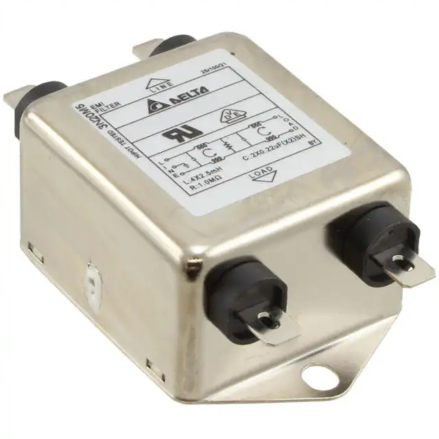

DPSERIES V D E TWO-STAGE PERFORMANCE FILTERS SPECIFICATIONS INTRODUCTIONS 1. Applications for UL 544 & UL 2601 health care equipment. 2. Design as a general purpose filter providing effective EMI suppression. 3. All part numbers are UL recognized, CSA certified and VDE approved. 1.Maximum leakage current each line-to-ground @ 115VAC 60Hz: 2uA @ 250VAC 50Hz: 5uA 2.Hipot rating (one minute) line-to-ground: 2250VDC line-to-line: 1450VDC 3.Operating frequency: 50/60Hz 4.Rated voltage: 115/250VAC COMPONENTS PART NO. Cx (uF) L1 (mH) L2 (mH) R (Ohm) 03DPCG5BM/W5BM 0.47 9.8 9.8 470K 06DPCG5BM/W5BM 7.8 7.8 12DPCG5BM/W5BM 1.0 3.25 3.25 220K 16DPGG5BM/W5BM/S5BM 2.8 2.8 03DPGG5CM/W5CM 0.22 2.5 2.5 1.0M 06DPCG5CM/W5CM 0.22 0.97 0.97 1.0M 12DPCG5CM/W5CM 0.47 0.58 0.58 470K 0.65 0.65 1.0M 16DPCG5CM/W5CM/S5CM 0.33 20DPCG5CM/S5CM/ 1.0 0.60 0.60 220K 30DPGS5CM MINIMUM INSERTION LOSS IN dB SERIES DIMENSIONS CURRENT RATING STYLE 3A CG5CM, CW5CM A DIMENSIONS IN INCHES/mm B C D E CG5CM, CW5CM 12A CG5CM, CW5CM 16A CG5CM, CW5CM, 2.95 75.00 CS5CM 2.81 71.5 3.34 84.8 1.79 45.5 2.02 51.3 2.04 51.8 2.52 64.0 2.05 52.0 2.58 65.6 1.18 30.0 3.94 100.0 3.94 100.0 1.54 39.2 3.94 100.0 ELECTRICAL SCHEMATIC 3A CG5BM/W5BM 6A CG5BM/W5BM 4.06 103.00 4.49 114.0 2.22 56.5 3.76 95.5 1.83 46.4 CG5BM/W5BM 5.63 143.0 5.02 152.9 2.05 52.0 5.30 134.7 1.78 45.3 12A G 3.94 100.0 2.40 61.00 6A F COMMON MODE (L-G) IN 50 OHM SYSTEM PART FREQUENCY-MHz NUMBER .15 .50 1.0 5.0 10 30 03DPCG5BM/W5BM 60 70 65 50 45 25 06DPCG5BM/W5BM 50 60 60 60 60 35 12DPCG5BM/W5BM 25 25 25 25 25 15 16DPGG5BM/W5BM/S5BM 20 35 40 50 40 30 03DPCG5CM/W5CM 25 35 35 35 30 20 06DPCG5CM/W5CM 20 25 25 25 25 20 12DPCG5CM/W5CM 10 15 15 15 15 10 16DPCG5CM/W5CM/S5CM 15 15 15 15 15 12 10 25 15 15 10 8 20DPCG5CM/S5CM/ 10 12 15 15 10 8 30DPGS5CM DIFFERENTIAL MODE (L-L) IN 50 OHM SYSTEM 03DPCG5BM/W5BM 30 45 45 45 45 25 45 50 50 55 55 45 06DPCG5BM/W5BM 45 50 50 50 50 30 12DPCG5BM/W5BM 55 50 50 50 40 16DPGG5BM/W5BM/S5BM 7 10 40 40 40 40 30 03DPCG5CM/W5CM 8 45 40 40 40 35 06DPCG5CM/W5CM 12 35 35 30 30 25 12DPCG5CM/W5CM 16DPCG5CM/W5CM/S5CM 12 40 35 35 35 30 15 40 40 35 30 20 20DPCG5CM/S5CM/ 18 45 50 40 35 25 30DPGS5CM L N L' L I N E Cx Cx R L1 L2 G 3.90 16A CG5BM/W5BM/S5BM 99.0 20A CG5CM, CS5CM 4.06 103.00 30A GS5CM 3.90 99.0 4.31 4.72 109.5 120.0 2.01 51.0 2.62 66.5 4.49 114.0 2.22 56.5 3.74 95.0 1.83 46.4 4.31 4.72 109.5 120.0 2.01 51.0 2.62 66.5 3.39 86.0 2.28 58.0 3.39 86.0 2.28 58.0 7-16 XXDPXX5C L O A D N' INSERTION LOSS (TYPICAL) 03DPCG5CM 03DPCW5CM 06DPCG5CM 06DPCW5CM COMMON MODE DIFF. MODE COMMON MODE DIFF. MODE 0 dB 0 dB 20 dB 20 dB 40 dB 40 dB 60 dB 60 dB 80 dB 80 dB 03DPCG5BM COMM. MODE DIFF. MODE 06DPCG5BM COMM. MODE DIFF. MODE 100 dB 100 dB 10K 100K 1M 1M 100K 10K 10M MECHANICAL CONSTRUCTION 10M B A 5.30 (2X) C 6.30 (2X) E D CG5BM/CG5CM A #8-32 5.30 (2X) C 6.30 (2X) B E D CS5CM 7-17 MECHANICAL CONSTRUCTION C 0.24 6.0 0.17 4.4 E A B D CW5CM, CW5BM ALL WIRE LEADS 4.0" LONG MIN. F 0.29 7.4 D E 0.173 4.4 G A B C GG5BM F D E 0.173 4.4 0.29 7.4 G A B C ALL WIRE LEADS 4.0" LONG MIN. GW5BM F 0.29 7.4 D E 0.173 4.4 A B C G GS5BM/GS5CM 7-18 UNIT: INCH mm
