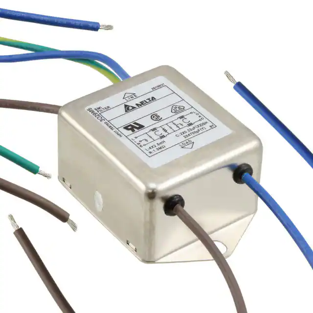

DPSERIES INTRODUCTION SWITCHING TRANSIENT FILTERS SPECIFICATIONS 1.Maximum leakage current each line-to-ground @ 115VAC 60Hz: 0.4mA (4700pF) @ 250VAC 50Hz: 0.8mA (4700pF) @ 115VAC 60Hz: 1.0mA (10000pF) @ 250VAC 50Hz: 2.0mA (10000pF) 2.Hipot rating (one minute) line-to-ground: 2250VDC line-to-line: 1450VDC 3.Operating frequency: 50/60Hz 4.Rated voltage: 115/250VAC V DE Two-stage filters provide high insertion loss for both line-to-line and line-to-ground emissions throughout the frequency range. COMPONENTS PART NO. 03DPCG5S 03DPCW5S 03DPDG3S 03DPDW3S 06DPCG5 06DPCW5 06DPDW3 10DPCG5 C1 (uF) 0.33 C2 (uF) 0.33 6.5 0.47 0.66 0.47 0.47 2.7 0.8 5 4.5 14 2.83 5 L1 (mH) 10 L2 (mH) 10 MINIMUM INSERTION LOSS IN dB COMMON MODE (L-G) IN 50 OHM SYSTEM CURRENT FREQUENCY-MHz RATING .15 .50 1.0 5.0 10 3A(S) 50 70 70 60 55 3A 60 70 70 65 55 6A 58 70 70 70 60 10A 58 70 70 70 70 06DPDW3 60 70 70 65 70 03DPCG5B/W5B 60 70 70 65 70 06DPCG5B/W5B 50 60 60 60 60 12DPCG5B/W5B 45 60 65 65 65 16DPGG5B/W5B/S5B 20 35 40 50 40 DIFFERENTIAL MODE (L-L) IN 50 OHM SYSTEM 3A(S) 35 48 55 55 55 3A 36 55 60 55 55 6A 40 65 65 70 70 10A 45 65 65 70 70 03DPCG5B/W5B 30 45 45 45 45 06DPDW3 40 60 60 60 60 06DPCG5B/W5B 45 50 50 55 55 12DPCG5B/W5B 45 45 50 50 50 16DPGG5B/W5B/S5B 7 55 50 50 50 Maximum leakage current a. 115VAC 60Hz: 0.5mH b. 250VAC 50Hz: 1.0mH PART NO. C1 (uF) C2 (pF) L1 (mH) L2 (mH) R (K) 03DPCG5B/W5B 0.47 9.8 9.8 470 06DPCG5B/W5B 7.8 7.8 4700 12DPCG5B/W5B 1.0 3.25 3.25 220 16DPGG5B/W5B/S5B 2.8 2.8 PART NO. 03DPCG5C 03DPCW5C 06DPCG5C 06DPCW5C 12DPCG5C 12DPCW5C 16DPCG5C 16DPCW5C 16DPCS5C 20DPCG5C 20DPCS5C 30DPGS5C Cx (uF) L1 (mH) L2 (mH) Cy (pF) R (Ohm) 2.5 0.22 0.97 0.47 0.33 0.58 0.65 0.97 0.58 0.65 4700 470K 1.0M 2.5 1.0M 1.0 0.60 0.60 10000 220K 45 45 50 50 25 60 45 50 40 ELECTRICAL SCHEMATIC L L I N E N G C1 L1 C3 C2 R C3 L2 L O A D N' G' L' L L I N E N G C1 R L1 C3 C3 L2 C4 C2 C4 L O A D N' G' L' CURRENT R:2.2M C3:3300pF L L' 06DPDW3 ONLY C3:4700pF C4:2200pF L L I N E N G C1 L1 C2 R C1 C2 L2 L O A D N' L' N G L I N E Cx L1 Cy Cx R L2 Cy L O A D N' XXDPXX5C DPXXB COMMON MODE (L-G) IN 50 OHM SYSTEM STYLE FREQUENCY-MHz RATING .15 .50 1.0 5.0 10 3A CG5C, CW5C 45 60 60 55 45 6A CG5C, CW5C 30 50 60 55 50 12A CG5C, CW5C 15 25 35 55 55 16A CG5C, CW5C, CS5C 20 35 45 60 50 20A CG5C, CS5C 15 40 45 50 50 30A CS5C 10 30 35 55 45 DIFFERENTIAL MODE (L-L) IN 50 OHM SYSTEM 3A CG5C, CW5C 12 45 45 45 45 6A CG5C, CW5C 8 45 45 45 45 12A CG5C, CW5C 12 40 40 35 35 16A CG5C, CW5C, CS5C 12 40 40 45 45 20A CG5C, CS5C 12 45 45 40 35 30A CS5C 18 45 50 40 40 30 45 35 35 35 40 30 45 45 40 50 50 40 6-1 GENERAL PURPOSE TWO-STAGE FILTERS 30 40 40 50 30 60 60 35 45 30 SERIES DIMENSIONS CURRENT RATING 3A 3A 3A 3A 6A 6A 10A 6A CURRENT RATING 3A 6A 12A 16A STYLE DIMENSIONS IN INCHES/mm A B C D 3.75 95.2 2.94 74.7 2.53 64.8 2.04 1.77 51.8 45.0 3.14 1.575 79.5 40.01 2.55 64.8 6.50 165.1 5.27 133.9 6.50 165.1 3.10 78.7 E 3.34 84.8 INSERTION LOSS (TYPICAL) 03DPCG5S 03DPDG3S 03DPDW3S 0 dB COMMON MODE COMMON MODE DIFF. MODE DIFF. MODE CG5S CW5S DG3S DW3S CG5 CW5 CG5 DW3 20 dB 40 dB 0.63 16.0 60 dB 80 dB 100 dB 10K 100K 1M 10M 2.27 57.7 2.04 51.8 2.77 70.4 1.77 45.0 5.63 143.0 6.04 153.4 COMMON MODE DIFF. MODE 0 dB 1.575 40.01 0.63 16.0 20 dB STYLE CG5B, CW5B CG5B, CW5B CG5B, CW5B GG5B, CW5B, CS5B DIMENSIONS IN INCHES/mm A B C D E 2.95 75.0 4.06 103.0 5.63 143.0 3.90 99.0 3.34 40 dB F G 60 dB 84.8 4.49 114.0 6.02 152.9 4.31 109.5 2.05 52.0 2.22 56.5 2.05 52.0 4.72 120.0 2.58 65.6 3.76 95.5 1.54 39.2 1.83 46.4 80 dB 100 dB 10K 100K 1M 10M 5.30 1.78 134.7 45.3 2.01 51.0 2.62 66.5 3.39 86.0 2.28 58.0 03DPCG5B 06DPCG5B 0 dB COMMON MODE COMMON MODE DIFF. MODE DIFF. MODE 20 dB 40 dB CURRENT RATING 3A 6A 12A 16A STYLE CG5C, CW5C DIMENSIONS IN INCHES/mm A B C D E F 3.94 100.0 G 60 dB 80 dB 100 dB 10K 100K 1M 10M 2.40 61.00 2.81 71.5 1.79 45.5 2.02 51.3 CG5C, CW5C CG5C, CW5C CG5C, CW5C, CS5C CG5C, CW5C CS5C 2.95 75.00 3.34 84.8 2.04 51.8 2.52 64.0 1.18 30.0 3.94 100.0 12DPCG5B COMMON MODE COMMON MODE DIFF. MODE DIFF. MODE 3.94 100.0 1.54 39.2 1.83 46.4 2.62 66.5 3.39 86.0 2.28 58.0 3.94 100.0 16DPGG5B 0 dB 20 dB 40 dB 20A 30A 4.06 103.00 3.90 99.0 4.49 114.0 2.22 56.5 3.74 95.0 2.01 51.0 60 dB 4.31 4.72 109.5 120.0 80 dB 100 dB 10K 100K 1M 10M 6-2 GENERAL PURPOSE TWO-STAGE FILTERS 06DPCG5 10DPCG5 COMMON MODE DIFF. MODE MECHANICAL CONSTRUCTION B 0.188 4.8 D E A CG5S/CG5B/CG5C 0.188 C B 4.8 D E A CG5 #6-32x1/4 TAPPED INSERT E 1.575 +0.005 40.01 A DG3S R0.24 R6.0Max. 1.22 +0.005 31.0 SUGGESTED MOUNTING CUTOUT #6-32 E 1.575+ 0.005 40.01 D B G A 0.157 3.98 DW3/DW3S +0.005 0.91-0 23.1 C R0.24 R6.0Max. + 1.22 -0.005 31.0 ALL WIRE LEADS 4.0" LONG MIN. SUGGESTED MOUNTING CUTOUT 0.173 4.4 0.29 7.4 A B C GS5B/GS5C G D E F 6-3 UNIT: INCH mm GENERAL PURPOSE TWO-STAGE FILTERS C D +0.005 0.91-0 23.1 0.157 3.98 B C MECHANICAL CONSTRUCTION 0.173 4.4 D E A B C 0.29 7.4 GG5B 0.173 4.4 G F D E 0.29 7.4 A B C F GW5B ALL WIRE LEADS 4.0" LONG MIN. B A 6.30 (2X) D CG5B/CG5C B A 6.30 (2X) BROWN BROWN E 5.30 (2X) BLUE BLUE F D F MIN. CW5B/CW5S/CW5C E ALL WIRE LEADS 4.0" LONG MIN. A 6.30 (2X) #8-32 5.30 (2X) B D E CS5C C C UNIT: 6-4 INCH mm GENERAL PURPOSE TWO-STAGE FILTERS 5.30 (2X) C G
