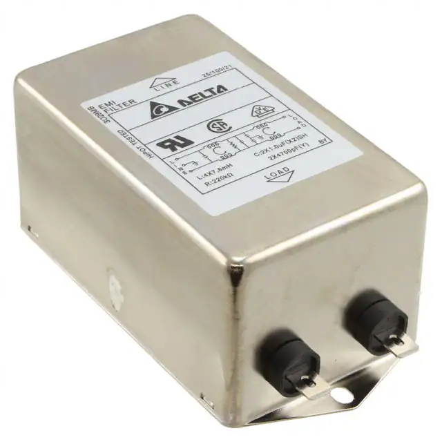

SWITCHING TRANSIENT FILTERS SERIES SPECIFICATIONS INTRODUCTION Two-stage filters provide high insertion loss for both line-to-line and line-to-ground emissions throughout the frequency range. 1.Maximum leakage current each line-to-ground @ 115VAC 60Hz: 0.4mA (4700pF) @ 250VAC 50Hz: 0.8mA (4700pF) @ 115VAC 60Hz: 1.0mA (10000pF) @ 250VAC 50Hz: 2.0mA (10000pF) 2.Hipot rating (one minute) line-to-ground: 2250VDC line-to-line: 1450VDC 3.Operating frequency: 50/60Hz 4.Rated voltage: 115/250VAC COMPONENTS GENERAL PURPOSE TWO-STAGE FILTERS PART NO. 03DPCG5S 03DPCW5S 03DPDG3S 03DPDW3S 06DPCG5 06DPCW5 * 06DPDW3 10DPCG5 C1 (uF) C2 (uF) 0.33 0.33 L1 (mH) L2 (mH) 10 10 6.5 4.5 2.7 2.7 8.0 5 14 14 2.83 5 0.47 0.47 0.66 0.47 MINIMUM INSERTION LOSS IN dB COMMON MODE (L-G) IN 50 OHM SYSTEM CURR EN T FREQUENCY-MHz RATING .15 .50 1.0 5.0 10 30 3A(S) 50 70 70 60 50 40 3A 60 70 70 65 55 40 6A 58 70 65 65 60 50 10A 48 65 60 45 35 20 06DPDW3 55 60 60 60 60 60 03DPCG5B/W5B 60 70 65 50 45 25 06DPCG5B/W5B 50 60 60 60 60 35 12DPCG5B/W5B 45 60 65 65 65 45 16DPGG5B/W5B/S5B 20 35 40 50 40 30 DIFFERENTIAL MODE (L-L) IN 50 OHM SYSTEM 3A(S) 35 48 55 55 55 45 3A 36 55 60 55 55 45 6A 40 65 65 70 70 50 10A 30 40 45 55 60 25 03DPCG5B/W5B 30 45 45 45 45 25 06DPDW3 40 60 60 60 60 60 06DPCG5B/W5B 45 50 50 55 55 45 12DPCG5B/W5B 45 45 50 50 50 50 16DPGG5B/W5B/S5B 7 55 50 50 50 40 * R:470 K PART NO. C1 (uF) C2 (pF) L1(mH) L2(mH) R(K 03DPCG5B/W5B 06DPCG5B/W5B 12DPCG5B/W5B 16DPGG5B/W5B/S5B PART NO. 03DPCG5C 03DPCW5C 06DPCG5C 06DPCW5C 0.47 9.8 7.8 3.25 2.8 4700 1.0 9.8 7.8 3.25 2.8 220 Cx (uF) L1 (mH) L2 (mH) Cy (pF) R ( 12DPCG5C 12DPCW5C 16DPCG5C 16DPCW5C 16DPCS5C 20DPCG5C 20DPCS5C 30DPGS5C ) 2.5 2.5 0.97 0.97 0.47 0.58 0.58 0.33 0.65 0.65 1.0M 1.0 0.60 0.60 220K 0.22 ) 470 1.0M 470K 4700 Maximum leakage current a. 115VAC 60Hz: 0.5mA b. 250VAC 50Hz: 1.0mA 10000 COMMON MODE (L-G) IN 50 OHM SYSTEM FREQUENCY-MHz STYLE RATING .15 .50 1.0 5.0 10 30 ELECTRICAL SCHEMATIC L L' L I N E C1 C2 R C3 L1 L2 C3 L L I N E N' C1 C3 R C2 L1 C4 L2 C3 C4 L O A D N N' G' G G XXDPXX5S XXDPXX5 R:2.2M C3:3300pF L L' L I N E C1 C2 R C3 L1 L2 C3 3A 6A 12A 16A 20A 30A L' L O A D N CURRENT 06DPDW3 ONLY C3:4700pF C4:2200pF L L' L I N E L O A D N N' N G G' G R C1 L O A D C2 C1 L1 L2 C2 3A 6A 12A 16A 20A 30A N' XXDPXXXB XXDPDX3S R:2.2M C3:3300pF L N L' L I N E Cy Cx Cx R L1 L2 Cy L O A D N' G XXDPXX5C 6-1 CG5C, CW5C 45 60 60 55 45 35 CG5C, CW5C 30 50 60 55 50 35 CG5C, CW5C 15 25 35 55 55 35 CG5C, CW5C, CS5C 20 35 45 60 50 35 CG5C, CS5C 15 40 45 50 50 40 GS5C 10 30 35 55 45 30 DIFFERENTIAL MODE (L-L) IN 50 OHM SYSTEM CG5C, CW5C 12 45 45 45 45 45 CG5C, CW5C 8 45 45 45 45 45 CG5C, CW5C 12 40 40 35 35 40 CG5C, CW5C, CS5C 12 40 40 45 45 50 CG5C, CS5C 12 45 45 40 35 50 GS5C 18 45 50 40 40 40 V D E INSERTION LOSS (TYPICAL) SERIES DIMENSIONS CURRENT RATING STYLE 3A CG5S 3A CW5S 3A DG3S DIMENSIONS IN INCHES/mm B C D A 2.94 74.7 3.36 85.3 2.04 51.8 03DPCG5S 03DPDG3S 03DPDW3S E 2.52 64.0 COMMON MODE DIFF. MODE COMMON MODE DIFF. MODE 0 dB 1.77 45.0 20 dB 40 dB DW3S 6A CG5 6A CW5 10A CG5 6A DW3 2.04 51.8 1.77 45.0 1.575 40.0 0.63 16.0 60 dB 80 dB 5.63 143.0 6.02 152.9 2.02 51.3 2.77 57.66 5.27 133.86 2.08 52.8 1.79 45.5 1.575 40.0 10K 100K 06DPCG5 10DPCG5 2.77 70.4 3.10 78.7 100 dB 1M 10M COMMON MODE DIFF. MODE COMMON MODE DIFF. MODE 0 dB 0.63 16.0 20 dB 40 dB 60 dB CURRENT RATING STYLE 3A CG5B,CW5B 6A CG5B,CW5B 12A CG5B,CW5B 16A GG5B,GW5B GS5B DIMENSIONS IN INCHES/mm A B C D E 2.95 75.0 4.06 103.0 3.34 84.8 4.49 114.0 2.05 52.0 2.22 56.5 2.58 65.6 3.76 95.5 1.54 39.2 1.83 46.4 5.63 143.0 3.89 99.0 6.02 152.9 4.31 109.5 2.05 5.30 52.0 134.7 4.72 2.0 120.0 51.0 1.78 45.3 2.62 66.5 F G - - - - - - 3.38 86.0 2.24 57.0 80 dB 100 dB 10K 100K 1M 10M 03DPCG5B COMMON MODE DIFF. MODE 06DPCG5B COMMON MODE DIFF. MODE 0 dB 20 dB 40 dB DIMENSIONS IN INCHES/mm CURRENT RATING STYLE 3A CG5C,CW5C A B C D 60 dB E F G 80 dB 6A CG5C,CW5C 12A CG5C,CW5C 16A CG5C,CW5C CS5C 20A CG5C,CS5C 30A GS5C 2.40 61.0 2.80 71.5 1.90 48.2 1.98 50.3 2.95 75.0 3.34 84.8 2.05 52.0 2.58 65.6 4.05 4.49 103.0 114.0 2.22 56.5 3.76 95.5 1.83 46.4 - - 39.0 99.0 4.72 120.0 2.01 51.0 2.62 66.5 3.39 86.0 2.28 58.0 4.31 109.5 1.15 29.2 1.15 29.2 - - - - 1.14 39.2 100 dB 10K 100K 1M 10M 12DPCG5B COMMON MODE DIFF. MODE 16DPGG5B COMMON MODE DIFF. MODE 0 dB 20 dB 40 dB 60 dB 80 dB 100 dB 10K 6-2 100K 1M 10M GENERAL PURPOSE TWO-STAGE FILTERS 3A 2.55 64.8 B MECHANICAL CONSTRUCTION A C 0.188(2X) 4.8(2X) E D CG5S B C A 0.188(2X) 4.8(2X) E CG5 A B 1 D G 2 E #6-32X1/4 TAPPED INSERT +0.005 1.575+0.13 40.0- C +0.005 0.91- 0 +0.13 23.1-0 0.157(2X) 4.0(2X) + DG3S 1.22 -0.005 R0.24MAX.(4X) 31.0+ - 0.13 R6.0MAX.(4X) SUGGESTED MOUNTING CUTOUT A E 2 BLUE B G G/Y 1 D 1.575+ - 0.005 40.0+ - 0.13 DW3/DW3S BROWN #6-32X1/4 TAPPED INSERT 0.157(2X) 4.0(2X) C +0.005 0.91- 0 +0.13 23.1-0 + 1.22 -0.005 R0.24MAX.(4X) 31.0+ - 0.13 R6.0MAX.(4X) SUGGESTED MOUNTING CUTOUT WIRE LENGTH : 4.0" MIN. C B 0.29 7.4 D F E A 0.173 4.4 G GENERAL PURPOSE TWO-STAGE FILTERS D GS5B/GS5C 6-3 UNIT: INCH mm MECHANICAL CONSTRUCTION C B 0.29 7.4 F E D A G 0.173 4.4 GG5B C B A BLUE F G/Y D E BLUE BROWN GENERAL PURPOSE TWO-STAGE FILTERS 0.29 7.4 BROWN G 0.173 4.4 WIRE LENGTH : 4.0" MIN. GW5B B A 5.3(2X) 0.209(2X) C 0.248(2X) 6.3(2X) E D CG5B/CG5C B A 0.248(2X) 6.3(2X) BLUE 5.3(2X) 0.209(2X) C BLUE BROWN BROWN E D G/Y CW5/CW5B/CW5S/CW5C WIRE LENGTH : 4.0" MIN. A #8-32 0.209(2X) 5.3(2X) C 0.248(2X) 6.3(2X) B D E CS5C UNIT: 6-4 INCH mm Mouser Electronics Authorized Distributor Click to View Pricing, Inventory, Delivery & Lifecycle Information: Delta Electronics: 30DPGS5C 06DPCG5C 16DPCG5C 03DPCW5C 12DPCG5C 16DPGG5B 20DPCG5C 03DPCG5B 03DPCW5S 06DPCG5B 16DPCS5C 03DPCG5S 03DPCG5C 03DPDG3S 10DPCG5
