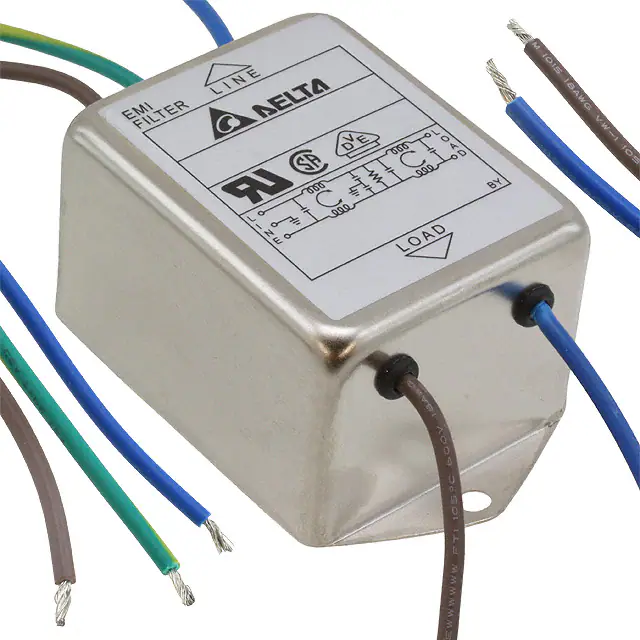

SPECIFICATIONS INTRODUCTIONS 1. Two-stage filters provide high performance in suppressing both line-to-line and line-to-ground noise. 2. All part numbers are UL recognized, CSA certified and VDE approved. 1. Maximum leakage current each line-to-ground @ 115VAC 60Hz: 0.25mA @ 250VAC 50Hz: 0.45mA 2. Hipot rating (one minute) line-to-ground: 2250VDC line-to-line: 1450VDC 3. Operating frequency: 50/60Hz 4. Rated voltage: 115/250VAC COMPONENTS GENERAL PURPOSE TWO-STAGE FILTERS PART NO. 02DRCG5 02DRCW5 03DRCG5 03DRCW5 C1,C2,C3(uF) L1,L2(mH) 0.1 2.4 SERIES DIMENSIONS PART NO. 1.7 03DRDG3S 03DRDW3S 05DRCG5 05DRCW5 05DRDG3S 02DRCG5 2.8 02DRCW5 1.6 0.22 05DRDW3S 10DRCG5 10DRCS5 10DRCW5 *15DRCG5 20DRGG5 20DRGS5 03DRCG5 1.3 1.3 03DRCW5 1.0 03DRDG3S 0.1 0.9 0.22 1.0 03DRDW3S 05DRCG5 R: 2.2M , Cy: 3300pF. No safety approval yet, R: 1.0M * VDE approved to 16A/250VAC, C2: 0.33 uF 05DRCW5 05DRDG3S 05DRDW3S ELECTRICAL SCHEMATIC 10DRCG5 L' L L I N E Cy C1 V D E HIGH PERFORMANCE FILTERS SERIES L1 R C2 C3 L2 Cy L O A D 10DRCS5 N N' G G' 10DRCW5 15DRCG5 20DRGG5 20DRGS5 6-7 A 3.25 82.5 2.08 52.8 3.75 95.2 2.58 65.5 3.14 79.8 2.55 64.8 3.75 95.2 2.58 65.5 DIMENSIONS IN INCHES/mm B C D 1.82 46.2 2.02 2.38 60.5 1.15 29.2 2.94 74.7 3.34 84.8 1.28 32.5 1.575 40.0 0.61 15.5 1.15 29.2 2.94 3.34 74.7 84.8 1.27 32.3 1.575 40.0 0.61 15.5 1.52 38.6 2.94 74.6 3.34 84.5 51.3 2.04 51.8 2.02 51.3 2.04 51.8 E 2.77 70.4 2.77 70.4 3.14 79.8 2.55 64.8 3.75 95.2 3.87 98.3 2.50 63.5 3.75 95.2 2.08 52.8 1.79 45.5 2.94 74.7 3.36 85.3 5.14 130.5 3.33 84.6 1.52 38.6 3.75 95.3 4.14 105.1 2.02 51.3 DIFF. MODE DIFF. MODE 10DRCG5 80 dB 80 dB 60 dB 60 dB 40 dB 40 dB 20 dB 20 dB 0 dB 1M 100K 10K 0 dB 10M DIFF. MODE COMMON MODE 1M 100K 10K 10M GENERAL PURPOSE TWO-STAGE FILTERS INSERTION LOSS (TYPICAL) COMMON MODE 02DRCG5 COMMON MODE 05DRCG5 MINIMUM INSERTION LOSS IN dB COMMON MODE (L-G) IN 50 OHM SYSTEM 2A CURRENT RATING .15 2A 40 FREQUENCY-MHz .50 1.0 5.0 60 65 55 10 50 30 40 3, 5A 3, 5A(S) 10A 15A 20A 60 60 60 45 35 60 45 45 40 55 45 40 40 30 40 40 38 30 23 20 65 65 65 50 40 65 55 50 45 50 DIFFERENTIAL MODE (L-L) IN 50 OHM SYSTEM 5 50 65 60 54 46 3, 5A 3, 5A(S) 10A 15A 20A 12 10 7 8 7 60 65 53 30 55 65 70 60 40 50 60 70 55 45 50 54 60 45 40 55 46 50 40 40 40 MECHANICAL CONSTRUCTION E MAX. D 0.188(2X) 4.8(2X) BLUE BLUE BROWN BROWN C MAX. B MAX. A MAX. G/Y CW5 WIRE LENGTH : 4.0" MIN. D 0.255X0.157(4X) 6.5X4.0(4X) B MAX. E MAX. 2.0 50.8 C MAX. A MAX. GG5 6-8 UNIT: INCH mm 2.0 0.255X0.157(4X) 6.5X4.0(4X) 50.8 MECHANICAL CONSTRUCTION D B MAX. E MAX. #8-32 C MAX. A MAX. GS5 A MAX. E C MAX. B MAX. 0.188(2X) 4.8(2X) CG5 E D B MAX. #8-32 0.188(2X) 4.8(2X) C MAX. A MAX. CS5 E B 1 5 D 2 A +0.005 0.91- 0 +0.13 23.1-0 0.157(2X) 4.0(2X) DG3S R0.24MAX.(4X) R6.0MAX.(4X) C #6-32X1/4 TAPPED INSERT 1.575 + -0.005 40.0+ -0.13 1.22 + -0.005 31.0+ -0.13 SUGGESTED MOUNTING CUTOUT E A B G/Y 1 5 D 2 BLUE DW3S R0.24MAX.(4X) R6.0MAX.(4X) 6-9 BROWN #6-32X1/4 TAPPED INSERT 0.157(2X) 4.0(2X) 1.22 + -0.005 31.0+ -0.13 SUGGESTED MOUNTING CUTOUT C 1.575 + -0.005 40.0+ -0.13 +0.005 0.91- 0 +0.13 23.1-0 GENERAL PURPOSE TWO-STAGE FILTERS D WIRE LENGTH : 4.0" MIN. UNIT: INCH mm
