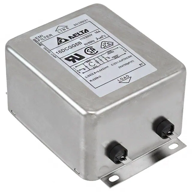

16DCGG5B 数据手册
DCSERIES INTRODUCTIONS SWITCHING TRANSIENT FILTERS SPECIFICATIONS 1. Maximum leakage current each line-to-ground @ 115VAC 60Hz: 0.40mA @ 250VAC 50Hz: 0.80mA 2. Hipot rating (one minute) line-to-ground: 2250VDC line-to-ine: 1450VDC 3. Operating frequency: 50/60Hz 4. Rated voltage: 115/250VAC V DE 1.Two-stage filters provide high insertion loss for both line-to-line and line-to-ground emissions throughout the frequency range. COMPONENTS PART NO. C1 (uF) C2 (pF) L1 (mH) L2 (uH) R (K ) 03DCCG5B/W5B 0.47 9.8 160 470 06DCCG5B/W5B 7.8 110 4700 12DCCG5B/W5B 1.0 3.25 50 220 16DCGG5B/W5B/S5B 2.8 43 ELECTRICAL SCHEMATIC L L I N E C1 R L1 C1 C2 L2 C2 L O A D L' SERIES DIMENSIONS PART NO. 03DCCG5B/W5B 06DCCG5B/W5B 12DCCG5B/W5B 16DCCG5B/W5B/S5B A DIMENSIONS IN INCHES/mm B C D E F 3.34 84.8 4.49 114.0 5.63 143.0 4.31 109.5 2.05 52.0 2.22 56.5 2.05 52.0 4.72 120.0 2.58 65.6 3.76 95.5 1.54 39.2 1.83 46.4 N N' G G 75.0 4.06 103.0 6.02 152.9 3.90 99.0 2.95 INSERTION LOSS (TYPICAL) 03DCCG5B 06DCCG5B 0 dB COMMON MODE COMMON MODE DIFF. MODE DIFF. MODE 5.30 1.78 134.7 45.3 2.01 51.0 2.62 66.5 3.39 86.0 2.28 58.0 20 dB 40 dB 60 dB MINIMUM INSERTION LOSS IN dB COMMON MODE (L-G) IN 50 OHM SYSTEM CURRENT FREQUENCY-MHz RATING .15 .50 1.0 5.0 10 30 3A 25 45 55 55 55 35 6A 25 45 50 60 60 40 12A 20 30 40 55 60 25 16A 15 20 30 60 50 30 DIFFERENTIAL MODE (L-L) IN 50 OHM SYSTEM 3A 45 60 60 70 70 50 6A 50 60 60 60 60 50 12A 35 55 60 60 60 45 16A 40 55 55 60 60 50 80 dB 10K 100K 1M 10M DIFF. MODE DIFF. MODE 12DCCG5B 16DCCG5B 0 dB COMMON MODE COMMON MODE 20 dB 40 dB 60 dB 80 dB 100 dB 10K A 100K 1M 10M MECHANICAL CONSTRUCTION B 0.25 6.30 D CG5B 6-6 E 0.21 5.30 C 0.24 6.0 MECHANICAL CONSTRUCTION 0.17 4.4 C A B CG5B D 0.24 6.0 E 0.17 4.4 A B CW5B D ALL WIRE LEADS 4.0" LONG MIN. 0.173 4.4 D E 0.29 7.4 A B C GG5B 0.173 4.4 D E G 0.29 7.4 A B C GS5B 0.173 4.4 D G E 0.29 7.4 A B C F F F E C UNIT: INCH mm GW5B 6-7 ALL WIRE LEADS 4.0" LONG MIN. G
