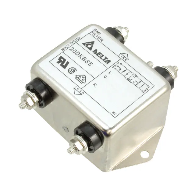

20DKBS5 数据手册
1. Maximum leakage current each line-to-ground @ 115VAC 60Hz: 0.25mA 1.0mA (10000pF) @ 250VAC 50Hz: 0.45mA 2.0mA (10000pF) 2. Hipot rating (one minute) line-to-ground: 2250VDC line-to-line: 1450VDC 3. Operating frequency: 50/60Hz 4. Rated voltage: 115/250VAC 1. Effectively control EMI suppression of both line-to-line and line-to-ground noise. 2. All part numbers are UL recognized, CSA certified and VDE approved. COMPONENTS C1 (uF) GENERAL PURPOSE ONE-STAGE FILTERS SPECIFICATIONS INTRODUCTIONS PART NO. 02DKAG5 02DKAW5 03DKAG5 03DKAW5 03DKDG3S 03DKDW3S 05DKAG5 05DKAS5 05DKAW5 05DKDG3S 05DKDW3S 10DKAG5 10DKAS5 10DKAW5 10DKDG3S 10DKDW3S 20DKBG5 20DKBS5 30DKCS5 V D E GENERAL PURPOSE FILTERS SERIES C2 (uF) L (mH) Cy (pF) R( ) 2.1 MINIMUM INSERTION LOSS IN dB 3.2 COMMON MODE (L-G) IN 50 OHM SYSTEM FREQUENCY-MHz STYLE RATING .15 .50 1.0 5.0 10 AG5, AWG 22 30 38 47 50 2,3,5A AS5 22 30 38 47 50 DG3S 22 30 38 50 55 3A(S) 22 30 38 50 55 5A(S) DW3S AG5, AS5 15 20 28 45 45 10A 4.5 0.22 CURRENT 2.7 0.22 3300 2.2M 2.5 1.7 PART NO. 0.22 0.22 1.4 3300 2.2M 0.22 0.47 0.59 10000 470K Cx (uF) L (mH) 03DKBG5B 06DKBG5B Cy (pF) 2.5 R( AW5 15 20 28 45 45 10A(S) DG3S, DW3S 15 20 28 45 45 20A BG5, BS5 14 19 28 40 42 30A CS5 10 20 30 40 45 DIFFERENTIAL MODE (L-L) IN 50 OHM SYSTEM AG5, AWG 22 30 38 47 50 2,3,5A AS5 22 30 38 47 50 3A(S) DG3S 22 30 38 50 55 5A(S) DW3S 22 30 38 50 55 AG5, AS5 15 20 28 45 45 10A AW5 15 20 28 45 45 10A(S) DG3S, DW3S 15 20 28 45 45 20A BG5, BS5 14 19 28 40 42 30A CS5 10 20 30 40 45 ) 1.0M 1.0 12DKBG5B 0.7 16DKCG5B 0.15 470K 4700 0.65 16DKCW5B 30 40 40 45 45 45 45 45 35 30 40 40 45 45 45 45 45 35 30 1.0M 20DKCG5B 20DKCS5B 0.60 30DKCS5B 0.47 0.67 10000 470K COMMON MODE (L-G) IN 50 OHM SYSTEM FREQUENCY-MHz STYLE RATING .15 .50 1.0 5.0 10 3A BG5B 20 30 35 45 50 6A BG5B, BW5B 15 20 25 40 45 12A BG5B 10 20 22 35 45 16A CG5B, CW5B 10 18 20 35 45 20A CG5B, CS5B 10 18 20 30 35 30A CS5B 10 25 30 45 50 DIFFERENTIAL MODE (L-L) IN 50 OHM SYSTEM 3A BG5B 7 35 50 45 45 6A BG5B, BW5B 10 20 45 45 50 12A BG5B 10 20 40 45 45 16A CG5B, CW5B 10 18 40 40 40 20A CG5B, CS5B 10 12 35 35 40 30A CS5B 12 40 50 50 50 CURRENT ELECTRICAL SCHEMATIC L L I N E Cy R C1 C2 L Cy N L' L O A D N' G L L I N E Cy R Cx Cx L Cy N L' L O A D N' G XXDKXX5B 5-6 30 45 45 40 30 35 35 45 45 45 35 40 45 GENERAL PURPOSE ONE-STAGE FILTERS INSERTION LOSS (TYPICAL) SERIES DIMENSIONS CURRENT RATING STYLE AG5 2A AW5 AG5 AW5 3A DG3S DW3S AG5 AW5 5A AS5 DG3S DW3S AG5 AW5 10A AS5 DG3S DW3S BG5 20A BS5 30A CS5 A 2.99 75.9 1.83 46.5 2.99 75.9 1.83 46.5 3.14 79.8 2.55 64.8 2.99 75.9 1.83 46.5 3.37 85.6 3.14 79.8 2.55 64.8 3.25 82.5 2.08 52.8 3.37 85.6 3.22 81.5 2.63 66.8 3.25 82.5 3.37 85.6 3.87 98.3 DIMENSIONS IN INCHES/mm B C D E 02DKAG5 05DKAG5 COMMON MODE COMMON MODE DIFF. MODE DIFF. MODE 80 dB 0.90 22.9 60 dB 2.38 60.5 2.79 70.9 20 dB 1.16 29.5 1.29 32.8 40 dB 0 dB 10K 1.575 40.0 0.61 15.5 03DKAG5 20DKBS5 100K 1M COMMON MODE COMMON MODE 10M DIFF. MODE DIFF. MODE 80 dB 60 dB 2.04 51.8 40 dB 1.16 29.5 2.38 60.5 2.79 70.9 20 dB 0 dB 10K 1.29 32.8 1.575 40.0 0.61 15.5 05DKDG3S 10DKAG5 100K 1M COMMON MODE COMMON MODE 10M DIFF. MODE DIFF. MODE 80 dB 60 dB 40 dB 1.16 29.5 2.38 60.5 2.79 70.9 20 dB 0 dB 10K 2.30 58.4 2.52 64.0 1.29 32.8 1.575 40.0 0.61 15.5 3.36 85.3 100K 1M 03DKBG5B COMMON MODE DIFF. MODE 06DKBG5B 06DKBW5B COMMON MODE DIFF. MODE 0 dB 20 dB 1.54 39.1 2.94 74.7 3.37 85.6 3.36 85.3 2.04 51.8 40 dB 60 dB 80 dB 100 dB 10K 100K 12DKBG5B 12DKBW5B 16DKCG5B 16DKCW5B 16DKCS5B 1M 10M COMMON MODE DIFF. MODE COMMON MODE DIFF. MODE 0 dB 20 dB 40 dB 60 dB 80 dB 100 dB 10K 5-7 100K 1M 10M GENERAL PURPOSE ONE-STAGE FILTERS SERIES DIMENSIONS CURRENT RATING STYLE 3A BG5B 6A BG5B 12A BG5B CG5B 16A CW5B CG5B 20A CS5B 30A CS5B A B DIMENSIONS IN INCHES/mm C D E F - 2.13 54.0 2.54 64.5 1.34 34.0 1.77 45.0 - 1.18 30.0 - 2.40 2.81 1.79 2.02 3.94 100.0 61.0 71.5 45.5 51.3 - 2.95 3.34 2.04 2.52 3.94 100.0 75.0 84.8 51.8 64.0 4.06 103.0 4.49 114.0 2.22 56.5 3.74 95.0 1.83 46.4 - 0.188(2X) 4.8(2X) E B D MECHANICAL CONSTRUCTION C A AG5 0.188(2X) 4.8(2X) BLUE BLUE E B D G/Y BROWN BROWN C A AW5 WIRE LENGTH : 4.0" MIN. 5-8 UNIT: INCH mm E D B C A #8-32 AS5 A E C B D 0.188(2X) 4.8(2X) BG5 A B D 0.188(2X) 4.8(2X) C #8-32 BS5 A MAX. E D B MAX. 0.188(2X) 4.8(2X) C MAX. CG5 A MAX. E D B MAX. 0.188(2X) 4.8(2X) C MAX. CS5 #8-32 E A #6-32X1/4 B 1 5 D 2 TAPPED INSERT +0.005 1.57540.0 + -0.13 0.157(2X) 4.0(2X) DG3S R0.24MAX. R6.0MAX. C +0.005 0.91- 0 +0.13 23.1-0 GENERAL PURPOSE ONE-STAGE FILTERS 0.188(2X) 4.8(2X) MECHANICAL CONSTRUCTION 1.22 + -0.005 31.0 + -0.13 SUGGESTED MOUNTING CUTOUT UNIT: INCH mm 5-9 E GENERAL PURPOSE ONE-STAGE FILTERS MECHANICAL CONSTRUCTION B 1 5 D 2 A #6-32X1/4 TAPPED INSERT +0.005 0.91-0 +0.13 23.1-0 0.157(2X) 4.0(2X) 1.22 + -0.005 31.0+ - 0.13 R0.24MAX.(4X) R6.0MAX.(4X) DG3 C 1.575 + -0.005 40.0 + -0.13 SUGGESTED MOUNTING CUTOUT A E B G/Y 1 5 D 2 BLUE BROWN #6-32X1/4 TAPPED INSERT C 1.575 + -0.005 40.0 + -0.13 +0.005 0.91-0 +0.13 23.1-0 0.157(2X) 4.0(2X) WIRE LENGTH : 4.0" MIN. 1.22 + -0.005 31.0+ - 0.13 R0.24MAX.(4X) R6.0MAX.(4X) SUGGESTED MOUNTING CUTOUT DW3S B A 0.248(2X) 5.3(2X) 0.209(2X) C 6.3(2X) E D BG5B (option wire style) B A 0.248(2X) 5.3(2X) 0.209(2X) C 6.3(2X) E D CG5B B A 0.248(2X) 6.3(2X) BLUE 5.3(2X) 0.209(2X) C BLUE BROWN E F BROWN D F G/Y CW5B WIRE LENGTH : 4.0" MIN. A #8-32 0.248(2X) 4.4(2X) 0.173(2X) C 6.3(2X) B D E CS5B 5-10 UNIT: INCH mm
