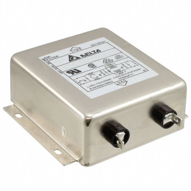

SERIES MULTI-PURPOSE POWER LINE FILTERS SPECIFICATIONS INTRODUCTION Two-stage filters providing excellent suppression at high frequency. 1. Maximum leakage current each line-to-ground: @ 115VAC 60Hz: 0.50mA @ 250VAC 50Hz: 1.00mA 2. Hipot rating (one minute) line-to-ground: 2250VDC line-to-line: 1450VDC 3. Operating frequency: 50/60Hz 4. Rated voltage: 115/250VAC COMPONENTS C1 (uF) C2 (uF) L1 (mH) L2 (uH) Cy (pF) 1.0 30 1.7 0.22 70 0.22 3300 1.2 40 0.47 1.73 30 R( ) SERIES DIMENSIONS 330K 03DWCG5 06DWCG5 MINIMUM INSERTION LOSS IN dB COMMON MODE (L-G) IN 50 OHM SYSTEM FREQUENCY-MHz CURRENT RATING 10 .15 .50 1.0 5.0 20 3A 60 30 12 60 30 6A 55 45 25 55 20 10A 60 30 15 55 25 55 30 20 55 * 20A DIFFERENTIAL MODE (L-L) IN 50 OHM SYSTEM 3A 60 50 45 50 25 6A 50 35 50 50 25 10A 50 50 45 45 25 * 20A 55 55 55 50 25 10DWCG5 20DWGG5 30 DIMENSIONS IN INCHES/mm A D B E C 3.25 2.38 1.90 2.77 1.15 82.5 60.5 48.3 70.4 29.2 3.75 95.2 2.06 52.3 5.25 130.5 3.40 86.4 1.54 39.1 2.94 74.7 3.34 84.8 3.75 95.3 4.14 105.1 45 45 45 45 50 45 45 45 VDE approved in 8A * VDE approved in 16A INSERTION LOSS (TYPICAL) 03DWCG5 06DWCG5 COMMON MODE DIFF. MODE COMMON MODE DIFF. MODE 10DWCG5 20DWGG5 100dB 100dB 80 dB 80 dB 60 dB 60 dB 40 dB 40 dB 20 dB 20 dB COMMON MODE DIFF. MODE COMMON MODE DIFF. MODE 0 dB 0 dB 10K 100K 1M 10K 10M 6-14 100K 1M 10M GENERAL PURPOSE TWO-STAGE FILTERS PART NO. 03DWCG5 06DWCG5 10DWCG5 20DWGG5 ELECTRICAL SCHEMATIC 3A. 6A. 10A. 20A. R1 L L L' L I N E C1 C1 Cy L1 R Cy L2 Cy N Cy C2 L' L I N E L O A D C1 C1 Cy R Cy L1 C2 L2 Cy Cy N N' L O A D N' G G R1 R1=330(Ohm) MECHANICAL CONSTRUCTION E D C MAX. B MAX. 0.188 4.8 CG5 D 0.255X0.157 6.5X4.0 B MAX. 2.0 50.8 E MAX. A MAX. C MAX. GENERAL PURPOSE TWO-STAGE FILTERS A MAX. GG5 UNIT: 6-15 INCH mm
