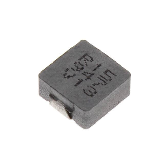

CYNTEC CO., LTD. 乾坤科技股份有限公司 DOCUMENT : CMLE063T-000 REVISION : B0 PAGE : 1 OF 5 Power Choke Coil CMLE063T type  Features High performance (Isat) realized by metal dust core. Low profile:Thickness max. 3.0mm Low loss realized with low DCR Capable of corresponding high frequency (3MHz) 100% lead (Pb) free meet RoHS standard  Application DC/DC converter for CPU in Notebook PC Thin type on-board power supply module for exchanger VRM for server  Outline Dimensions A' L A Code B L W B' H  T Dimensions (mm) L < 0.36H L ≥ 0.36H 7.25  0.35 6.95  0.35 W 6.6  0.2 T 2.8  0.2 A 1.6  0.3 A’ 2.0  0.1 B 3.0  0.3 B’ 3.6  0.2 H 0 ~ +0.15 Recommend Land Pattern Dimensions The customer shall determine the land dimensions shown below after confirming and safety. B A C A 3.5 B 3.7 C 8.4 Unit : mm Dec., 2018 CYNTEC CO., LTD. 乾坤科技股份有限公司  DOCUMENT : CMLE063T-000 REVISION : B0 PAGE : 2 OF 5 Specifications Part Number L0 Inductance ( H ) @ (0A) Typical 0.22 0.36 0.47 0.68 0.82 1.00 1.50 2.2 3.3 4.7 6.8 8.2 10.0 22.0 1.15 2.3 2.9 4.6 4.7 5.6 7.7 11.0 18.5 23.6 41.0 52.0 59.0 148.0 CMLE063T-R22MS CMLE063T-R36MS CMLE063T-R47MS CMLE063T-R68MS CMLE063T-R82MS CMLE063T-1R0MS CMLE063T-1R5MS CMLE063T-2R2MS CMLE063T-3R3MS CMLE063T-4R7MS CMLE063T-6R8MS CMLE063T-8R2MS CMLE063T-100MS CMLE063T-220MS Part Number CMLE063T-R12MS0R657 CMLE063T-R15MS0R905 CMLE063T-R15MS0R907 CMLE063T-R15MS0R987 CMLE063T-R24MS1R197 Heat Rating Current DC Amps. Idc ( A ) Saturation Current DC Amps. Isat ( A ) Maximum Typical Maximum Typical Maximum 1.3 2.55 3.3 5.2 5.4 6.5 8.9 12.8 21.0 26.0 48.0 60.0 66.0 170.0 37.0 25.0 23.0 16.5 16.0 16.0 12.0 10.0 8.0 6.7 5.5 5.1 4.2 2.8 32.0 23.0 20.0 15.5 14.5 14.4 11.0 9.0 7.0 6.0 5.0 4.6 3.8 2.3 38.0 31.0 25.0 18.5 18.0 17.0 15.0 14.0 11.0 8.0 7.0 6.6 6.2 3.2 32.0 28.0 23.0 17.0 15.6 15.0 14.0 12.0 10.0 7.0 6.1 5.7 5.5 2.7 Rdc ( m) L0 Inductance ( H ) @ (0A) 0.12 0.15 0.15 0.15 0.24 Rdc ( m) 0.65  7% 0.90  5% 0.90  7% 0.98  7% 1.19  7% Heat Rating Current DC Amps. Idc ( A ) Saturation Current DC Amps. Isat ( A ) Typical Maximum Typical Maximum 41.5 38 38 35 35 37.5 35 35 30 31 48 45 45 42 38 42.5 41 41 35 32 *: If you require another part number please contact with us. **:Inductance Tolerance  20% Note 1.: All test data is referenced to 25℃ ambient. Note 2.: Test Condition:100KHz, 1.0Vrms Note 3.: Idc : DC current (A) that will cause an approximate △T of 40℃ Note 4.: Isat : DC current (A) that will cause L0 to drop approximately 30% Note 5.: Operating Temperature Range -55℃ to + 125℃ Note 6.: The part temperature (ambient + temp rise) should not exceed 125℃ under the worst case operating conditions. Circuit design, component placement, PCB trace size and thickness, airflow and other cooling provision all affect the part temperature. Part temperature should be verified in the end application. Note 7.: The rated current as listed is either the saturation current or the heating current depending on which value is lower. Dec., 2018 CYNTEC CO., LTD. 乾坤科技股份有限公司  : CMLE063T-000 REVISION : B0 PAGE : 3 OF 5 Current Characteristic 0.20 60 40 20 0.05 0 0.00 0 5 10 15 20 25 30 35 40 45 50 TEMP. RISE(℃) 20 0.07 0 0.00 55 0 5 10 15 CMLE063T-R47MS TEMP. RISE(℃) 40 20 0.10 INDUCTANCE(μH) 0.20 TEMP. RISE(℃) 60 0 5 10 15 20 DC BIAS(Amps) 25 30 CMLE063T-R82MS 0.96 80 0.64 60 INDUCTANCE(μH) TEMP. RISE(℃) 40 0.32 0.00 4 6 8 10 12 14 16 18 20 22 80 TEMP. RISE(℃) 20 0.14 0 2 4 6 8 40 20 0.30 0.00 0 0 2 4 6 8 10 12 DC BIAS(Amps) 14 16 18 20 INDUCTANCE(μH) TEMP. RISE(℃) 0.60 20 22 24 26 100 80 0.80 60 INDUCTANCE(μH) 0.60 TEMP. RISE(℃) 40 0.40 20 0 2 4 6 8 10 12 14 DC BIAS(Amps) 16 18 20 22 24 CMLE063T-2R2MS 100 2.25 TEMP. RISE(℃) INDUCTANCE(μH) 60 INDUCTANCE(μH) 0.90 12 14 16 18 DC BIAS(Amps) 1.00 2.70 80 1.20 10 CMLE063T-1R0MS 0 100 1.50 40 0.28 0.00 24 CMLE063T-1R5MS 60 INDUCTANCE(μH) 0.42 DC BIAS(Amps) 1.80 100 0.20 0 2 40 0.56 1.20 20 0.16 0 35 CMLE063T-R68MS 0 100 0.80 0.48 30 0.00 35 INDUCTANCE(μH) 0 TEMP. RISE(℃) INDUCTANCE(μH) 0.40 INDUCTANCE(μH) 25 0.70 80 0.00 INDUCTANCE(μH) 0.84 100 0.50 0.30 20 DC BIAS(Amps) DC BIAS(Amps) 0.60 40 0.14 TEMP. RISE(℃) TEMP. RISE(℃) 60 INDUCTANCE(μH) 0.21 TEMP. RISE(℃) 0.10 80 0.28 80 1.80 60 INDUCTANCE(μH) 1.35 TEMP. RISE(℃) 40 0.90 TEMP. RISE(℃) INDUCTANCE(μH) 100 CMLE063T-R36MS 0.35 INDUCTANCE(μH) 80 TEMP. RISE(℃) 0.25 0.15 0.42 100 TEMP. RISE(℃) CMLE063T-R22MS 0.30 INDUCTANCE(μH) DOCUMENT 20 0.45 0.00 0 0 2 4 6 8 10 12 14 DC BIAS(Amps) 16 18 20 Dec., 2018 CYNTEC CO., LTD. 乾坤科技股份有限公司 40 20 0.70 0 1 2 3 4 5 6 7 8 9 CMLE063T-4R7MS TEMP. RISE(℃) 20 0.90 0.00 0 0 1 2 3 4 5 6 DC BIAS(Amps) 1.40 20 0.00 0 1 2 3 4 5 DC BIAS(Amps) 6 7 8 10.0 8.0 TEMP. RISE(℃) TEMP. RISE(℃) 0.0 1.0 2.0 3.0 4.0 5.0 6.0 7.0 20 1.6 0 27.0 80 22.5 1 2 3 4 5 6 DC BIAS(Amps) 60 13.5 100 0.18 80 0.15 0.06 40 TEMP. RISE(℃) 20 0.03 0 0.00 0 5 10 15 20 25 30 35 40 DC BIAS(Amps) 45 50 55 60 INDUCTANCE(μH) INDUCTANCE(μH) 100 80 INDUCTANCE(μH) 40 TEMP.RISE(℃) 9.0 20 4.5 0 0.0 60 0.09 9 0.0 TEMP. RISE(℃) INDUCTANCE(μH) 0.12 8 18.0 8.0 CMLE063T-R12MS0R657 7 CMLE063T-220MS 0.5 1.0 1.5 2.0 DC BIAS(Amps) 0.15 40 3.2 0 0.0 60 INDUCTANCE(μH) 4.8 100 20 2.0 100 80 0 40 4.0 10 0.0 60 INDUCTANCE(μH) 6.0 9 6.4 9 CMLE063T-100MS 12.0 INDUCTANCE(μH) 40 8 8.0 INDUCTANCE(μH) 2.80 TEMP. RISE(℃) 0 INDUCTANCE(μH) TEMP. RISE(℃) INDUCTANCE(μH) TEMP. RISE(℃) INDUCTANCE(μH) 60 4.20 7 CMLE063T-8R2MS 9.6 80 5.60 40 1.80 100 7.00 60 INDUCTANCE(μH) 2.70 10 11 12 13 14 CMLE063T-6R8MS 100 80 DC BIAS(Amps) 8.40 : 4 OF 5 3.60 0 0.00 PAGE TEMP. RISE(℃) TEMP. RISE(℃) 1.40 : B0 TEMP. RISE(℃) 4.50 REVISION TEMP. RISE(℃) 80 60 INDUCTANCE(μH) 2.10 5.40 : CMLE063T-000 2.5 3.0 3.5 4.0 DC BIAS(Amps) 4.5 5.0 5.5 CMLE063T-R15MS0R907 100 80 0.12 60 INDUCTANCE(μH) 0.09 TEMP.RISE(℃) 40 0.06 20 0.03 0.00 TEMP. RISE(℃) INDUCTANCE(μH) 2.80 100 INDUCTANCE(μH) CMLE063T-3R3MS 3.50 TEMP. RISE(℃) 4.20 DOCUMENT 0 0 5 10 15 20 25 30 35 40 DC BIAS(Amps) 45 50 55 60 Dec., 2018 CYNTEC CO., LTD. 乾坤科技股份有限公司 TEMP. RISE(℃) 40 0.06 20 0.03 0 5 10 15 0.27 20 25 30 35 40 DC BIAS(Amps) 45 50 55 : B0 PAGE : 5 OF 5 CMLE063T-R15MS0R987 100 80 0.12 60 INDUCTANCE(μH) 0.09 TEMP. RISE(℃) 40 0.06 20 0.03 0.00 0 0.00 0 0 60 5 10 15 20 25 30 35 DC BIAS(Amps) 40 45 50 100 CMLE063T-R24MS1R197 0.23 INDUCTANCE(μH) 0.15 60 INDUCTANCE(μH) 0.09 80 REVISION 80 0.18 60 INDUCTANCE(μH) 0.14 TEMP. RISE(℃) 40 0.09 20 0.05 0.00 0 0 5 10 15 20 25 30 35 DC BIAS(Amps) 40 45 50 55 Dec., 2018 TEMP. RISE(℃) 0.12 0.18 : CMLE063T-000 TEMP. RISE(℃) INDUCTANCE(μH) 0.15 100 INDUCTANCE(μH) CMLE063T-R15MS0R905 TEMP. RISE(℃) 0.18 DOCUMENT
