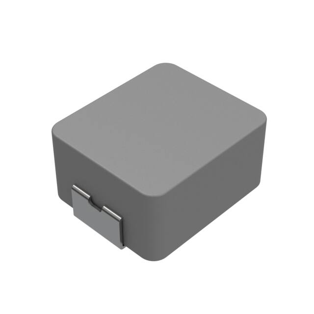

    固定电感器 Nonstandard 220nH ±20% 38A 0.98mΩ
CMLE064T-R22MS0R987 数据手册
CYNTEC CO., LTD. 乾坤科技股份有限公司 DOCUMENT : CMLE064T-000 REVISION : A6 PAGE : 1 OF 3 Power Choke Coil CMLE064T type  Features High performance (Isat) realized by metal dust core. Low profile:Thickness max. 4.0mm Low loss realized with low DCR Capable of corresponding high frequency (3MHz) 100% lead (Pb) free meet RoHS standard  Application DC/DC converter for CPU in Notebook PC Thin type on-board power supply module for exchanger VRM for server  Outline Dimensions A' L A B W B' H  T Code Dimensions (mm) L 7.25  0.35 W 6.6  0.2 T 3.8  0.2 A 1.6  0.3 A’ 2.0  0.1 B 3.0  0.3 B’ 3.6  0.2 H 0 ~ +0.15 Recommend Land Pattern Dimensions The customer shall determine the land dimensions shown below after confirming and safety. B A C A 3.5 B 3.7 C 8.4 Unit : mm Dec., 2018 CYNTEC CO., LTD. 乾坤科技股份有限公司  DOCUMENT : CMLE064T-000 REVISION : A6 PAGE : 2 OF 3 Specifications L0 Inductance ( H ) @ (0A) Rdc ( m) CMLE064T-R15MS0R667 0.15 CMLE064T-R15MS0R675 Part Number Heat Rating Current DC Amps. Idc ( A ) Saturation Current DC Amps. Isat ( A ) Typical Maximum Typical Maximum 0.66  7% 40.0 37.0 50.0 46.0 0.15 0.67  5% 40.0 37.0 50.0 46.0 CMLE064T-R15MS0R725 0.15 0.72  5% 39.0 36.0 54.0 47.0 CMLE064T-R22MS0R987 0.22 0.98  7% 38.0 34.0 35.5 28.5 CMLE064T-R24MS1R007 0.24 1.00  7% 36.0 32.0 35.5 28.5 CMLE064T-R36MS1R407 0.36 1.40  7% 30.0 25.0 26.0 23.0 CMLE064T-R42MS1R557 0.42 1.55  7% 24.0 21.0 23.0 19.0 *: If you require another part number please contact with us. **: Inductance Tolerance  20% Note 1.: All test data is referenced to 25℃ ambient. Note 2.: Test Condition:100KHz, 1.0Vrms Note 3.: Idc : DC current (A) that will cause an approximate △T of 40℃ Note 4.: Isat : DC current (A) that will cause L0 to drop approximately 30% Note 5.: Operating Temperature Range -55℃ to + 125℃ Note 6.: The part temperature (ambient + temp rise) should not exceed 125℃ under the worst case operating conditions. Circuit design, component placement, PCB trace size and thickness, airflow and other cooling provision all affect the part temperature. Part temperature should be verified in the end application. Note 7.: The rated current as listed is either the saturation current or the heating current depending on which value is lower. Dec., 2018 CYNTEC CO., LTD. 乾坤科技股份有限公司 0.12 80 0.15 60 INDUCTANCE(μH) 0.09 0.18 TEMP. RISE(℃) 40 0.06 20 0.03 0.00 0 0 5 : A6 PAGE : 3 OF 3 CMLE064T-R15MS0R675 80 0.12 60 INDUCTANCE(μH) 0.09 20 0.03 0 0 5 10 15 20 DC BIAS(Amps) CMLE064T-R15MS0R725 20 0.03 5 10 15 INDUCTANCE(μH) 0.30 20 25 30 35 40 DC BIAS(Amps) 45 50 55 0.25 60 0.15 INDUCTANCE(μH) 0.10 TEMP. RISE(℃) 40 20 0.05 0.00 5 10 15 20 25 30 35 40 45 CMLE064T-R42MS1R557 TEMP. RISE(℃) 40 20 0.05 0 5 10 15 20 25 30 35 40 DC BIAS(Amps) 45 50 55 60 CMLE064T-R36MS1R407 100 0.35 80 0.28 60 INDUCTANCE(μH) 0.21 TEMP. RISE(℃) 40 0.14 20 0 0 6 12 18 24 DC BIAS(Amps) 30 36 42 80 0.30 60 INDUCTANCE(μH) 40 TEMP. RISE(℃) 0.10 20 0.00 TEMP. RISE(℃) 100 0.40 0.20 0.10 0.00 50 DC BIAS(Amps) 0.50 INDUCTANCE(μH) 0.07 0 0 100 60 0.15 0.42 80 0.20 65 80 0 100 CMLE064T-R24MS1R007 60 0.20 60 INDUCTANCE(μH) 0 55 0.00 0 0.00 INDUCTANCE(μH) INDUCTANCE(μH) 40 TEMP. RISE(℃) TEMP. RISE(℃) 0.06 TEMP. RISE(℃) INDUCTANCE(μH) 60 INDUCTANCE(μH) 0.09 50 0.25 80 0.12 25 30 35 40 45 DC BIAS(Amps) CMLE064T-R22MS0R987 0.30 100 0.15 40 TEMP. RISE(℃) 0.06 0.00 10 15 20 25 30 35 40 45 50 55 60 65 0.18 100 0 0 5 10 15 20 25 30 35 TEMP. RISE(℃) INDUCTANCE(μH) 0.15 100 REVISION TEMP. RISE(℃) CMLE064T-R15MS0R667 : CMLE064T-000 40 DC BIAS(Amps) Dec., 2018 TEMP. RISE(℃) 0.18 INDUCTANCE(μH) Current Characteristic TEMP. RISE(℃)  DOCUMENT
