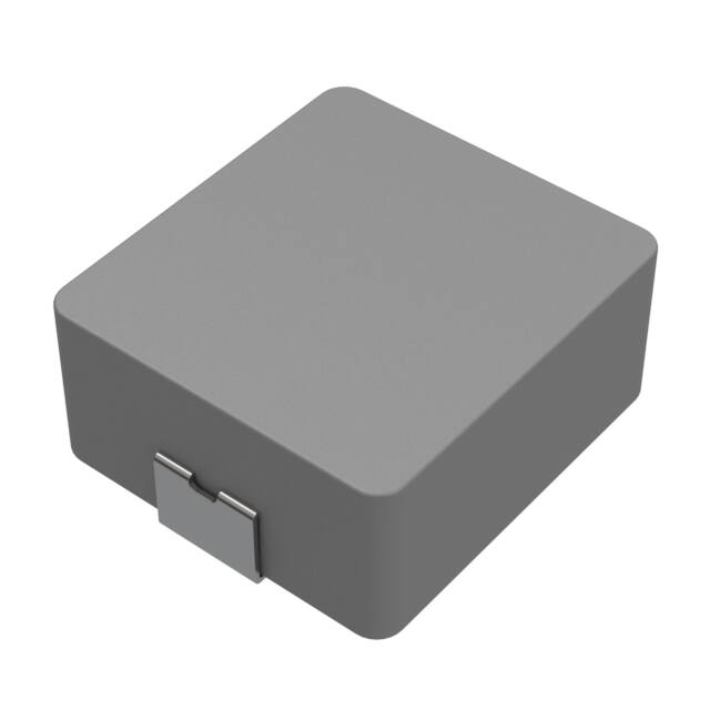

    固定电感器 Nonstandard 5.6µH ±20% 10A 15mΩ
CMLE105T-5R6MS 数据手册
CYNTEC CO., LTD. 乾坤科技股份有限公司 DOCUMENT : CMLE105TXXX-040 REVISION : A1 PAGE : 1 OF 8 CMLE105T-XXXMS Power Choke Coil 1. Features High performance (Isat) realized by metal dust core. Low profile: 10.3mm x 11.2/11.5mm x 5.0mm Low loss realized with low DCR Capable of corresponding high frequency (1MHz) 100% lead (Pb) free meet RoHS standard 2. Application DC/DC converter for CPU in Notebook PC Thin type on-board power supply module for exchanger VRM for server 3. Type Designation CMLE 105T (1) (2) Where – XXX (3) M (4) S (5) (1) Series No : (2) Size : 105T = 10.3mm x 11.2/11.5mm x 5.0mm (3) Inductance Value : 4R7 = 4.7H (4) Tolerance : M =  20% (5) Materials : S type 4. Outline Dimensions and Schematics A' L Dimensions (mm) A B Code L W H B' T 1R0/1R5/2R2 3R3/4R7/5R6 6R8/100 11.15  0.35 10.85 0.35 W 10.0  0.3 T 4.8  0.2 A 2.0  0.5 A’ 2.5  0.1 B 3.0  0.5 B’ 5.0  0.2 H 0 ~ +0.15 Jun, 2020 CYNTEC CO., LTD. 乾坤科技股份有限公司 DOCUMENT : CMLE105TXXX-040 5. Marking and Date Code 5-1 Marking The inductor is marked with a 3-digit code Example – – 4.7H  4R7 5-2 Date Code X XX (1) (2) Where REVISION : A1 PAGE : 2 OF 8 4R7 XXX XXX XXX (3) (1) Year Ex : 2020 = 0 (2) Weekly Serial number : 01 ~ 53 (3) Taping No. Serial number : 000 ~ ZZZ 6. Recommend Land Pattern Dimensions The customer shall determine the land dimensions shown below after confirming and safety. B A C A 4.1 B 5.4 C 13.6 Unit : mm Jun, 2020 CYNTEC CO., LTD. 乾坤科技股份有限公司 DOCUMENT : CMLE105TXXX-040 REVISION : A1 PAGE : 3 OF 8 7. Specifications L0 Inductance ( H ) @ (0A) Typical CMLE105T-1R0MS 1.0 CMLE105T-1R5MS Heat Rating Current DC Amps. Idc ( A ) Saturation Current DC Amps. Isat ( A ) Maximum Typical Maximum Typical Maximum 2.2 2.5 25.5 23.0 36.0 31.0 1.5 2.6 3.0 24.0 22.0 30.0 27.0 CMLE105T-2R2MS 2.2 3.8 4.5 19.5 17.0 26.0 22.0 CMLE105T-3R3MS 3.3 6.5 7.5 15.0 13.5 22.0 19.0 CMLE105T-4R7MS 4.7 10.0 11.5 10.5 9.5 19.0 16.0 CMLE105T-5R6MS 5.6 12.5 15.0 10.0 9.0 13.0 11.0 CMLE105T-6R8MS 6.8 14.5 16.3 9.0 8.0 12.0 10.5 CMLE105T-100MS 10.0 21.0 23.0 7.6 7.0 11.0 9.3 Part Number Rdc ( m ) *: If you require another part number please contact with us. **: Inductance Tolerance  20% Note 1.: All test data is referenced to 25℃ ambient. Note 2.: Idc : DC current (A) that will cause an approximate △T of 40℃ Note 3.: Isat : DC current (A) that will cause L0 to drop approximately 30% Note 4.: Operating Temperature Range -55℃ to +125℃ Note 5.: The part temperature (ambient + temp rise) should not exceed 125℃ under the worst case operating conditions. Circuit design, component placement, PCB trace size and thickness, airflow and other cooling provision all affect the part temperature. Part temperature should be verified in the end application. Note 6.: The rated current as listed is either the saturation current or the heating current depending on which value is lower. Jun, 2020 CYNTEC CO., LTD. 乾坤科技股份有限公司 DOCUMENT : CMLE105TXXX-040 REVISION : A1 PAGE : 4 OF 8 7-1 Current Characteristic 80 3.50 60 1.35 INDUCTANCE(μH) 0.90 TEMP. RISE(℃) 40 20 0.45 0.00 3 6 9 12 15 18 21 24 27 80 2.80 60 2.10 INDUCTANCE(μH) 1.40 TEMP. RISE(℃) 20 0.70 0 0 30 2 4 6 8 DC BIAS(Amps) 100 40 TEMP. RISE(℃) 2.00 20 0.00 2 4 6 12.0 8 10 12 14 16 DC BIAS(Amps) 18 20 22 60 INDUCTANCE(μH) 3.60 40 TEMP. RISE(℃) 2.40 20 1.20 0 0 24 CMLE105T-100MS 80 4.80 0.00 0 0 INDUCTANCE(μH) TEMP. RISE(℃) 60 INDUCTANCE(μH) 100 CMLE105T-5R6MS 6.00 80 4.00 1.00 INDUCTANCE(μH) 7.20 2 4 6 8 10 DC BIAS(Amps) 12 14 16 100 10.0 80 8.0 60 6.0 INDUCT ANCE(μH) 4.0 TEMP. RISE(℃) 40 TEMP. RISE(℃) INDUCTANCE(μH) 5.00 3.00 10 12 14 16 18 20 22 24 26 28 DC BIAS(Amps) CMLE105T-4R7MS 6.00 40 0.00 0 0 100 CMLE105T-3R3MS TEMP. RISE(℃) 1.80 4.20 TEMP. RISE(℃) INDUCTANCE(μH) 2.25 100 INDUCTANCE(μH) CMLE105T-2R2MS TEMP. RISE(℃) 2.70 20 2.0 0.0 0 0 1 2 3 4 5 6 7 8 9 DC BIAS(Amps) 10 11 12 13 14 Jun, 2020 CYNTEC CO., LTD. 乾坤科技股份有限公司 DOCUMENT : CMLE105TXXX-040 REVISION : A1 PAGE : 5 OF 8 Test Instruments Wayne kerr 3260B/G LCR Meter Wayne kerr 3265B Bias Current Source Test Condition Temperature : 26  3℃ , Humidity :  70% RH Frequency : 100KHz , 1.0V 8. Reliability 8-1 Mechanical Item Specification and Requirement Test Method Solderability The surface of terminal immersed shall be minimum of 95% covered with a new coating of solder Solder heat proof : (1) Preheating : 160  10℃ 90seconds (2) Retention time : 245  5℃ for 2  0.5 seconds Vibration Inductance change : Within  5% (1) Vibration frequency : Without mechanical damage such as ( 10Hz to 55Hz to10Hz ) in 60 seconds break as a period (2) Vibration time : period cycled for 2 hours in each of 3 mutual perpendicular directions (3) Amplitude : 1.5mm max. Shock Inductance change : Within  5% (1) Peak value : 100G Without mechanical damage such as break (2) Duration of pulse : 11ms (3) 3 times in each positive and negative direction of 3 mutual perpendicular directions Jun, 2020 CYNTEC CO., LTD. 乾坤科技股份有限公司 DOCUMENT : CMLE105TXXX-040 REVISION : A1 PAGE : 6 OF 8 8-2 Endurance Item Specification and Requirement Test Method Thermal Shock Inductance change : Within  5% Without distinct damage in appearance (1) Repeat 100 cycle as follow : (-55  2℃,30  3minutes) (Room temperature, 5 minutes) (+125  2℃,30  3minutes) (Room temperature, 5 minutes) (2) Recovery : 48 + 4 / - 0 hours of recovery under the standard condition after the test. ( See Note1 ) High Temperature resistance Inductance change : Within  10% Without distinct damage in appearance (1) Environment condition :85  2℃ Applied Current : Rated current (2) Duration : 1,000 + 4 / - 0 hours ( See Note1 ) Humidity resistance Inductance change : Within  5% Without distinct damage in appearance (1) Environment condition :60  2℃ Humidity :90~95% Applied Current : Rated current (2) Duration : 1,000 + 4 / - 0 hours ( See Note1 ) Low Temperature Inductance change : Within  5% Store Without distinct damage in appearance (1) Store temperature : -55  2℃ for total 1,000 + 4 / - 0 hours High Temperature Store Inductance change : Within  10% Without distinct damage in appearance (1) Store temperature : +125  2℃ for total 1,000 + 4 / - 0 hours Note1 : When there are questions concerning measurement result : measurement shall be made after 48  2 hours of recovery under the standard condition Jun, 2020 CYNTEC CO., LTD. 乾坤科技股份有限公司 DOCUMENT : CMLE105TXXX-040 REVISION : A1 PAGE : 7 OF 8 9. Care note 9-1 Care note for Use (1) Storage Condition : Temperature 25 to 35℃, Humidity 45 to 85% RH (2) Use Temperature : a. Minimum Temperature : -55℃ Ambient temperature of power choke coil. b. Maximum Temperature : +125℃ The value of temperature including ambient of the transformer and temperature rise of power choke coil. c. There is not a problem from -55℃ ~ +125℃ in a reliability test. d. However, this is not meant a temperature grade guarantee of UL. (3) Model : When this power choke coil was used in a similar or new product to the original one, sometimes it might be unable to satisfy the specifications due to difference of condition of usage. (4) Drop : If the power choke coil suffered mechanical stress such as drop, characteristics may become poor ( due to damage on coil bobbin, etc. ). Never use such stressed power choke coil. Jun, 2020 CYNTEC CO., LTD. 乾坤科技股份有限公司 DOCUMENT : CMLE105TXXX-040 REVISION : A1 PAGE : 8 OF 8 9-2 Care note for Safety (1) Provision to Abnormal Condition This power choke coil itself does not have any protective function in abnormal condition such as overload, short-circuit and open-circuit conditions, etc. Therefore, it shall be confirmed as the end product that there is no risk of smoking, fire, dielectric withstand voltage, insulation resistance, etc. in abnormal conditions to provide protective devices and/or protection circuit in the end product. (2) Temperature Rise Temperature rise of power choke coil depends on the installation condition on end products. It shall be confirmed on the actual end product that temperature rise of power choke coil is in the limit of specified temperature class. (3) Dielectric Strength Dielectric withstanding test with higher voltage than specific value will damage insulating material and shorten its life. (4) Water This power choke coil must not be used in wet condition by water, coffee or any liquid because insulation strength becomes very low on the condition. (5) Potting If this power choke coil is potted in some compound, coating material of magnet wire might be occasionally damaged. Please ask us if you intend to pot this power choke coil. (6) Detergent Please consult our company once in case of this because the confirmation of reliability etc. is needed when the washing medicine is used for the power choke coil. Jun, 2020
