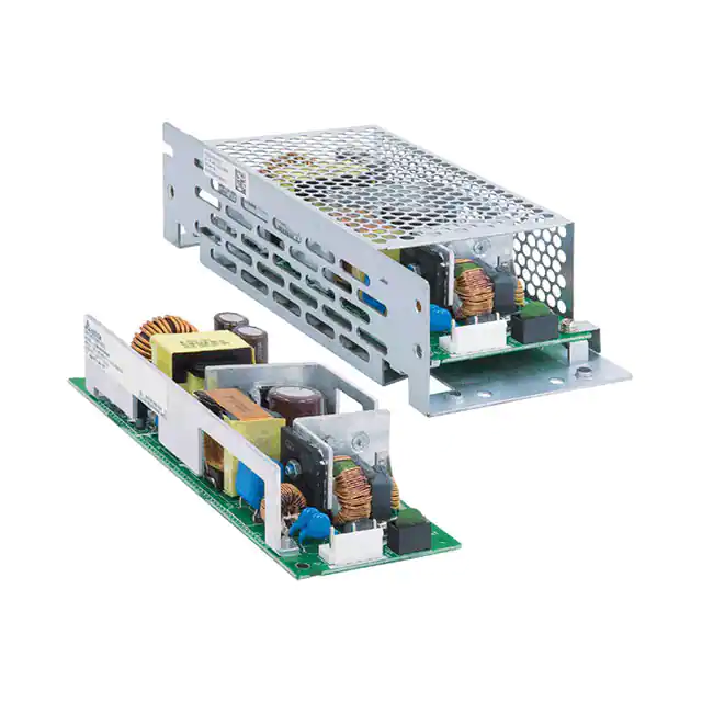

TECHNICAL DATASHEET PJB Open Frame Power Supply 24 V 100 W 1 Phase / PJB-24V100W□□A PJB Highlights & Features • • • • • • • • Universal AC Input (85 Vac – 264 Vac) Power Boost of 200% for 10 seconds Low Inrush Current / Low Leakage Current High efficiency and PF factor to conserve energy Conformal coating on PCBA to protect against chemical and dust pollutants Remote ON/OFF (Optional for 100 W) Versatile configuration options: Open Frame, L Frame, Enclosed Long life capacitors Safety Standards CB Certified for worldwide use Model Number: Unit Weight: PJB-24V100W☐☐A Open Frame: 0.26 kg (0.57 lb) Enclosed: 0.42 kg (0.93 lb) Dimensions (L x W x D): Open Frame: 155 x 62 x 33.5 mm (6.10 x 2.44 x 1.32 inch) Enclosed: 185 x 72 x 45 mm (7.28 x 2.83 x 1.77 inch) General Description The PJB series of Open Frame Power Supply comes with universal AC input at 85 Vac to 264 Vac. Other features include low leakage / Inrush current and conformal coating on the PCBAs to provide protection against dust and chemical pollutants. The built-in active PFC provides PF > 0.97 and fulfills Harmonic Current Emission according to IEC/EN/BS EN 61000-3-2. The feature built-in Power Boost of 200% for 10 seconds enables reserve power to be always available for reliable startup of loads with high inrush current, thus eliminating the need of a more expensive power supply unit at higher power rating. Metal chassis and case cover are available as options for different installation preferences. The PJB series is certified for EMI standards according to EN/BS EN 55032 and EMS according to EN/BS EN 55024. The products conform to major international safety standards according to EN/UL 62368-1 standards and are fully compliant with RoHS Directive for environmental protection. Model Information PJB Open Frame Power Supply Model Number Input Voltage Range Rated Output Voltage Rated Output Current PJB-24V100W☐☐A 85-264 Vac 24 Vdc 4.30 A Model Numbering CC Code PJB – 24V PJB Series Output Voltage Output Power 1 100W A □ □ Package Type B - Open Frame L - L Frame C - Enclosed Remote ON/OFF Function Delta Standard N - No Remote ON/OFF R - With Remote ON/OFF All parameters are specified at 25°C ambient and AC input unless otherwise indicated. www.DeltaPSU.com (April 2022, Rev. 06) TECHNICAL DATASHEET PJB Open Frame Power Supply 24 V 100 W 1 Phase / PJB-24V100W□□A Specifications Input Ratings / Characteristics Nominal Input Voltage 100-240 Vac Input Voltage Range 85-264 Vac Nominal Input Frequency 50-60 Hz Input Frequency Range 47-63 Hz Input Current 1.30 A max. @ 100 Vac, 0.65 A max. @ 200 Vac Efficiency at 100% Load 86.5% typ. @ 100 Vac, 89.0% typ. @ 200 Vac Max Inrush Current (Cold Start) 15 A typ. @ 100 Vac, 30 A typ. @ 200 Vac Power Factor Correction at 100% Load 0.98 typ. @ 100 Vac, 0.97 typ. @ 200 Vac Leakage Current 0.2 mA @ 100 Vac, 0.4 mA @ 230 Vac Output Ratings / Characteristics* Nominal Output Voltage 24 Vdc Factory Set Point Tolerance 24 Vdc ±1% (initial set point tolerance from factory) Output Voltage Adjustment Range 21.6-26.4 Vdc Output Current Line Regulation 4.30 A (continuously operating at 24 V) 8.60 A (Power Boost for 10 seconds at 24 V, refer to the details in the Functions section) 103.2 W (continuously operating at 24 V) 206.4 W (Power Boost for 10 seconds at 24 V, refer to the details in the Functions section) < 96 mV Load Regulation < 150 mV Ripple Noise (20 MHz) < 150 mVpp @ 0°C to 50°C, < 180 mVpp @ -10°C to 0°C Start-up Time 500 ms typ. @ 100 Vac (100% load) Hold-up Time 20 ms typ. @ 100 Vac (100% load) Dynamic Response (Overshoot & Undershoot O/P Voltage) ± 5% @ 0-50% load and 50-100% load (Slew Rate: 0.1 A/µS) Start-up with Capacitive Loads 8,000 µF Max Output Power *For power de-rating from 50°C to 70°C, see power de-rating on page 3. Mechanical Case Chassis SGCC Case Cover SGCC Dimensions Indicator 155 x 62 x 33.5 mm (6.10 x 2.44 x 1.32 inch) 185 x 72 x 45 mm (7.28 x 2.83 x 1.77 inch) 0.26 kg (0.57 lb) 0.42 kg (0.93 lb) NA Cooling System Convection Unit Weight Terminal Open Frame Enclosed Open Frame Enclosed Input JST B3P5-VH (LF)(SN) Output JST B8P5-VH (LF)(SN) Wire AWG 22-18 Noise (1 Meter from power supply) Sound Pressure Level (SPL) < 25 dBA Environment 2 All parameters are specified at 25°C ambient and AC input unless otherwise indicated. www.DeltaPSU.com (April 2022, Rev. 06) TECHNICAL DATASHEET PJB Open Frame Power Supply 24 V 100 W 1 Phase / PJB-24V100W□□A Surrounding Air Temperature Operating -10°C to +70°C Storage -25°C to +75°C Power De-rating Refer to Engineering Data Fig.1.1~Fig.1.5 on Page 8~10 Operating Humidity 5 to 90% RH (Non-Condensing) Operating Altitude 0 to 5,000 Meters (16,400 ft) Shock Test Vibration Non-Operating Operating IEC 60068-2-27, Half Sine Wave: 50 G for a duration of 11ms, 3 shocks for each 3 directions IEC 60068-2-6, Sine Wave: 10 Hz to 55 Hz @ 19.6 m/S² (2 G peak); 10 min per cycle, 60 min per axis for all X, Y, Z direction Over Voltage Category II Pollution Degree 2 Protections Overvoltage 27.6-33.6 V, Latch Mode Overload / Overcurrent > 220% of rated load current, Hiccup Mode, Non-Latching (Auto-Recovery) Over Temperature Latch Mode Short Circuit Hiccup Mode, Non-Latching (Auto-Recovery when the fault is removed) Internal Fuse at L pin T5AH Protection Against Shock Class I with PE* connection *PE: Primary Earth Reliability Data MTBF > 200,000 hrs. as per JEITA RCR-9102B Expected Cap Life Time 10 years (115Vac, 50% load @ 40°C) Safety Standards / Directives Safety Entry Low Voltage Electrical Safety SELV (EN 60950-1) TUV Bauart UL/cUL recognized CB scheme EN 60950-1, EN 62368-1 UL 60950-1 and CSA C22.2 No. 60950-1 (File No. E131881) UL 62368-1 and CSA C22.2 No. 62368-1 (File No. E131881) IEC 60950-1, IEC 62368-1 ITE IEC 60950-1 CE In conformance with EMC Directive 2014/30/EU and Low Voltage Directive 2014/35/EC UKCA In conformance with Electromagnetic Compatibility Regulations 2016 and Electrical Equipment (Safety) Regulations 2016 Galvanic Isolation 3 Input to Output 3.0 KVac Input to Ground 2.0 KVac Output to Ground 0.5 KVac All parameters are specified at 25°C ambient and AC input unless otherwise indicated. www.DeltaPSU.com (April 2022, Rev. 06) TECHNICAL DATASHEET PJB Open Frame Power Supply 24 V 100 W 1 Phase / PJB-24V100W□□A EMC Emissions (CE & RE) CISPR 32, EN/BS EN 55032, Comply with FCC Title 47: Class B EN/BS EN 55024 Immunity Electrostatic Discharge IEC 61000-4-2 Level 4 Criteria A1) Air Discharge: 15 kV Contact Discharge: 8 kV Level 3 Criteria A1) 80 MHz-1 GHz, 10 V/M with 1 kHz tone / 80% modulation Radiated Field IEC 61000-4-3 Electrical Fast Transient / Burst IEC 61000-4-4 Level 3 Criteria A1) 2 kV Surge IEC 61000-4-5 Conducted IEC 61000-4-6 Level 3 Criteria A1) Common Mode2): 2 kV Differential Mode3): 1 kV Level 3 Criteria A1) 150 kHz-80 MHz, 10 Vrms Power Frequency Magnetic Fields IEC 61000-4-8 Criteria A1) Magnetic field strength 30 A/Meter Voltage Dips and Interruptions IEC 61000-4-11 100% dip; 1 cycle (20 ms); Self Recoverable Low Energy Pulse Test (Ring Wave) IEC 61000-4-12 Level 3 Criteria A1) Common Mode2): 2 kV Differential Mode3): 1 kV Harmonic Current Emission IEC/EN/BS EN 61000-3-2, Class A Voltage Fluctuation and Flicker IEC/EN/BS EN 61000-3-3 1) Criteria A: Normal performance within the specification limits 2) Asymmetrical: Common mode (Line to earth) 3) Symmetrical: Differential mode (Line to line) Block Diagram 4 All parameters are specified at 25°C ambient and AC input unless otherwise indicated. www.DeltaPSU.com (April 2022, Rev. 06) TECHNICAL DATASHEET PJB Open Frame Power Supply 24 V 100 W 1 Phase / PJB-24V100W□□A Dimensions Open Frame L x W x D: 155 x 62 x 33.5 mm (6.10 x 2.44 x 1.32 inch) L Frame L x W x D: 185 x 72 x 45 mm (7.28 x 2.83 x 1.77 inch) Item Device Description 5 Notes • • 1 Input Connector 2 Output Connector 3 VR • 4 Remote ON/OFF (JST B2B-XH-A) 5 Chassis • Dimensions are in mm For information on Mounting Torque, and I/O Connector and Housing, please refer to the Instruction Manual. For L Frame type: There are 6 threaded mounting holes and 5 normal mounting holes. For Open Frame type: There are 4 normal mounting holes. All parameters are specified at 25°C ambient and AC input unless otherwise indicated. www.DeltaPSU.com (April 2022, Rev. 06) TECHNICAL DATASHEET PJB Open Frame Power Supply 24 V 100 W 1 Phase / PJB-24V100W□□A Enclosed L x W x D: 185 x 72 x 45 mm (7.28 x 2.83 x 1.77 inch) Item Device Description 6 Notes 1 Input Connector 2 Output Connector • • 3 VR 4 Remote ON/OFF (JST B2B-XH-A) • 5 Cover 6 Chassis Dimensions are in mm For information on Mounting Torque, and I/O Connector and Housing, please refer to the Instruction Manual. For Enclosed type: There are 6 threaded mounting holes and 5 normal mounting holes. All parameters are specified at 25°C ambient and AC input unless otherwise indicated. www.DeltaPSU.com (April 2022, Rev. 06) TECHNICAL DATASHEET PJB Open Frame Power Supply 24 V 100 W 1 Phase / PJB-24V100W□□A Assembly & Installation Assembly Reference ■ Open Frame ■ L Frame / Enclosed For safety reasons, please ensure the mounted device is kept safety distance as below at all sides from other components and equipments. a) For Open Frame Type ≥ 8 mm (0.315 inch) from primary side and ≥ 4 mm (0.16 inch) from secondary side. b) For with Case Type ≥ 4 mm (0.16 inch) Please insert an insulation sheet between the system and product, if the safety distance is less than 4 mm (0.16 inch). • • Use flexible cable (stranded or solid) of AWG No. 22-18. Please refer to Table 1 for the recommended Housing and Terminal. For the Remote ON/OFF function, use flexible cable (stranded or solid) of AWG No. 28-22. Connector (Board Mounting) Housing Input (JST) B3P5-VH(LF)(SN) VHR-5N Output (JST) B8P-VH(LF)(SN) VHR-8N B2B-XH-A(LF)(SN) XHP-2 Table 1 Remote ON/OFF Function (Option) 7 All parameters are specified at 25°C ambient and AC input unless otherwise indicated. www.DeltaPSU.com (April 2022, Rev. 06) Terminal SVH-21T-P1.1 SXH-001T-P0.6 TECHNICAL DATASHEET PJB Open Frame Power Supply 24 V 100 W 1 Phase / PJB-24V100W□□A Mounting Orientation • • • • Any excessive twisting or bending may damage the device’s PCB. Please handle the device with care. The device is not recommended to be placed on low thermal conductive surfaces. For example, plastics. Prevent any foreign metal, particles or conductors from entering the device through the openings during installation. It may cause: -Electric shock; Safety hazard; Product failure. The power supply must be mounted by metal screws onto a grounded metal surface. It is highly recommended that the Earth terminal on the connector be connected to the grounded metal surface. Engineering Data Convection Output Load De-rating VS Surrounding Air Temperature  Open Frame / L Frame Fig.1.1 De-rating for Mounting Orientation A, B > 50°C de-rate power by 2.5% / °C De-rating for Mounting Orientation C > 45°C de-rate power by 2% / °C De-rating for Mounting Orientation D > 35°C de-rate power by 2% / °C De-rating for Mounting Orientation E, F > 40°C de-rate power by 2% / °C 8  Enclosed Fig.1.2 De-rating for Mounting Orientation A, B > 40°C de-rate power by 2.5% / °C De-rating for Mounting Orientation C > 35°C de-rate power by 2% / °C De-rating for Mounting Orientation D, E > 30°C de-rate power by 2% / °C De-rating for Mounting Orientation F > 35°C de-rate power by 2.4% / °C All parameters are specified at 25°C ambient and AC input unless otherwise indicated. www.DeltaPSU.com (April 2022, Rev. 06) TECHNICAL DATASHEET PJB Open Frame Power Supply 24 V 100 W 1 Phase / PJB-24V100W□□A Forced Cooling (Air Velocity > 0.7m/s) Output Load De-rating VS Surrounding Air Temperature   Air Flow Direction Open Frame / L Frame Fig.1.3 De-rating for Mounting Orientation A to F > 60°C de-rate power by 2% / °C  Enclosed Fig.1.4 De-rating for Mounting Orientation A to F > 50°C de-rate power by 2% / °C Notes 1. 2. 3. 4. 9 Power supply components may degrade, or be damaged, when the power supply is continuously used outside the shaded region, refer to the graphs shown above. If the output capacity is not reduced when the surrounding air temperature is more than the upper limit temperature, the device will run into Over Temperature Protection. When activated, the output voltage will go into bouncing mode and will recover when the surrounding air temperature is lowered or the load is reduced as far as necessary to keep the device in working condition. Depending on the surrounding air temperature and output load delivered by the power supply, the device housing can be very hot! If the device has to be mounted in any other orientation, please contact info@deltapsu.com for more details. All parameters are specified at 25°C ambient and AC input unless otherwise indicated. www.DeltaPSU.com (April 2022, Rev. 06) TECHNICAL DATASHEET PJB Open Frame Power Supply 24 V 100 W 1 Phase / PJB-24V100W□□A Output Load De-rating VS. Input Voltage  No output power de-rating for the input voltage range from 90 Vac to 264 Vac Fig.1.5 De-rating for Mounting Orientation A to F < 90 Vac de-rate power by 2% / V Functional Manual Remote ON/OFF Function You can remotely control the power supply unit to turn ON/OFF by using an external DC source. Follow the DC power source voltage and current limiting defined in the table below. Built-in Resistor Ri (ohm) 1k Voltage Between RC+ and RC- (V) Output ON Output OFF 5-12.5 0-0.5 Input Current (mA) 20 Max Notes 1. Remote ON/OFF circuits are isolated from input, output and PE. 2. Please check if the polarity of the wire connector is the same as the external DC source. If not, the power would not turn on and the internal components may be damaged. 3. You do not need an external resistance RO for current limit while the output voltage of external DC source is within the range of 512.5V. If the output voltage exceeds 12.5V, please use the following equation for the value of current limit resistance RO. 𝑅𝑅𝑂𝑂 = 10 𝑉𝑉𝑉𝑉𝑉𝑉 − (3.5 + 0.006𝑅𝑅𝑖𝑖 ) 0.006 All parameters are specified at 25°C ambient and AC input unless otherwise indicated. www.DeltaPSU.com (April 2022, Rev. 06) TECHNICAL DATASHEET PJB Open Frame Power Supply 24 V 100 W 1 Phase / PJB-24V100W□□A Functions Start-up Time The time required for the output voltage to reach 90% of its final steady state set value, after the input voltage is applied. Rise Time The time required for the output voltage to change from 10% to 90% of its final steady state set value. Hold-up Time Time between the collapse of the AC input voltage, and the output falling to 95% of its steady state set value.  Graph illustrating the Start-up Time, Rise Time, and Hold-up Time Dynamic Response The power supply output voltage will remain within ±5% of its steady state value, when subjected to a dynamic load 0% to 100% of its rated current. 11 All parameters are specified at 25°C ambient and AC input unless otherwise indicated. www.DeltaPSU.com (April 2022, Rev. 06) TECHNICAL DATASHEET PJB Open Frame Power Supply 24 V 100 W 1 Phase / PJB-24V100W□□A Power Boost Power Boost is the reserve power available constantly that allows reliable startup to support sudden and short spike of loads with high inrush current typically during turn on to remove the need of more expensive higher rated power supply unit. After the output has reached its steady state set value, the power supply can support surge loads with a higher short-term power demand up to 200% of maximum rated load (IO Max), for a maximum duration of 10 seconds. The Power Boost is also available to repeatedly basis with according to the condition of an average (R.M.S) output power shall not exceed continuous operating condition or refer to duty cycle calculation below. Fig. 2 𝐷𝐷𝐷𝐷𝐷𝐷𝐷𝐷 𝑐𝑐𝑐𝑐𝑐𝑐𝑐𝑐𝑐𝑐 (%) = Duty Cycle Calculation 𝑇𝑇𝑃𝑃 ; (𝑇𝑇𝑃𝑃 ≤ 10 sec) 𝑇𝑇𝑇𝑇𝑇𝑇𝑇𝑇𝑇𝑇 𝑇𝑇𝑇𝑇𝑇𝑇𝑇𝑇 𝐴𝐴𝐴𝐴𝐴𝐴𝐴𝐴𝐴𝐴𝐴𝐴𝐴𝐴 𝑂𝑂𝑂𝑂𝑂𝑂𝑂𝑂𝑂𝑂𝑂𝑂 𝑃𝑃𝑃𝑃𝑃𝑃𝑃𝑃𝑃𝑃 (𝑃𝑃𝐴𝐴𝐴𝐴𝐴𝐴 ) = OR 𝑁𝑁𝑁𝑁𝑁𝑁-𝑃𝑃𝑃𝑃𝑃𝑃𝑃𝑃 𝑃𝑃𝑃𝑃𝑃𝑃𝑃𝑃𝑃𝑃 = (𝑃𝑃𝑃𝑃𝑃𝑃𝑃𝑃𝑃𝑃 𝐵𝐵𝐵𝐵𝐵𝐵𝐵𝐵𝐵𝐵 × 𝑇𝑇𝑃𝑃 ) + (𝑁𝑁𝑁𝑁𝑁𝑁-𝑃𝑃𝑃𝑃𝑃𝑃𝑃𝑃 𝑃𝑃𝑃𝑃𝑃𝑃𝑃𝑃𝑃𝑃 × 𝑇𝑇𝑁𝑁 ) 𝑇𝑇𝑇𝑇𝑇𝑇𝑇𝑇𝑇𝑇 𝑇𝑇𝑇𝑇𝑇𝑇𝑇𝑇 �𝑃𝑃𝐴𝐴𝐴𝐴𝐴𝐴 × 𝑇𝑇𝑇𝑇𝑇𝑇𝑇𝑇𝑇𝑇 𝑇𝑇𝑇𝑇𝑇𝑇𝑇𝑇� − (𝑃𝑃𝑃𝑃𝑃𝑃𝑃𝑃𝑃𝑃 𝐵𝐵𝐵𝐵𝐵𝐵𝐵𝐵𝐵𝐵 × 𝑇𝑇𝑃𝑃 ) 𝑇𝑇𝑁𝑁 An example of Power Boost and Average Output Power  Power Boost Peak Power (WP) Power Boost Duration (TP) Duty Cycle Non-Peak Power (WN) Non-Peak Power Duration (TN) Total Time (T) 200% 206 W 10 sec 15% 85 W 57 sec 67 sec 200% 206 W 5 sec 15% 85 W 28 sec 33 sec 160% 165 W 10 sec 40% 62 W 15 sec 25 sec 160% 165 W 5 sec 40% 62 W 7.5 sec 12.5 sec It is not recommended to prolong the duration of Power Boost to be longer than the specified duty cycle calculation, this may cause damage to the PSU. 12 All parameters are specified at 25°C ambient and AC input unless otherwise indicated. www.DeltaPSU.com (April 2022, Rev. 06) TECHNICAL DATASHEET PJB Open Frame Power Supply 24 V 100 W 1 Phase / PJB-24V100W□□A Inrush Current Short Circuit Protection (Auto-Recovery) Inrush current is the peak, instantaneous, input current measured and, occurs when the input voltage is first applied. For AC input voltages, the maximum peak value of inrush current will occur during the first half cycle of the applied AC voltage. This peak value decreases exponentially during subsequent cycles of AC voltage. The power supply’s output OLP/OCP function also provides protection against short circuits. When a short circuit is applied, the output current will operate in “Hiccup mode”, as shown in the illustration in the OLP/OCP section on this page. The power supply will return to normal operation after the short circuit is removed. Overload & Overcurrent Protections (Auto-Recovery) The power supply’s Overload (OLP) and Overcurrent (OCP) Protections will be activated when output current exceeds 220% of IO (Max load). In such occurrence, the VO will start to droop and once the power supply has reached its maximum power limit, the protection is activated and the power supply will go into “Hiccup mode” (Auto-Recovery). The power supply will recover once the fault condition of the OLP and OCP is removed and IO is back within the specifications. Overvoltage Protection (Latch Mode) The power supply’s overvoltage circuit will be activated when its internal feedback circuit fails. The output voltage shall not exceed its specifications as described in “Protections” section. Power supply will latch, and require removal/re-application of input AC voltage in order to restart. The power supply should be latch. It is not recommended to prolong the duration of IO when it is 100%, since it may cause damage to the PSU. Over Temperature Protection (Latch Mode) As described in load de-rating section, the power supply also has Over Temperature Protection (OTP). In the event of a higher operating temperature at 100% load; or, when the operating temperature is beyond what is recommended in the de-rating graph, the OTP circuit will be activated. When activated, power supply will latch off, until the surrounding air temperature drops to its normal operating temperature or the load is reduced as recommended in the de-rating graph. Removal/re-application of input AC voltage will then be required in order to restart. 13 All parameters are specified at 25°C ambient and AC input unless otherwise indicated. www.DeltaPSU.com (April 2022, Rev. 06) TECHNICAL DATASHEET PJB Open Frame Power Supply 24 V 100 W 1 Phase / PJB-24V100W□□A Others Conformal Coating The Protective Coating Technology Delta Electronics Group has designed the perfect dipping technique which penetrates everywhere including under device, and prevents leakage. The conformal coating dipping can be applied to PCBs or circuit board. The coating preserves the performance of precision electronic primarily by preventing ionizable contaminants such as salt from reaching circuit nodes, where the material slumps around sharp edges. This can be a problem especially in highly conversing atmosphere. PFC – Norm EN 61000-3-2 Line Current Harmonic content Typically, the input current waveform is not sinusodial due to the periodical peak charging of the input capacitor. In industrial environment, complying with EN 61000-3-2 is only necessary under special conditions. Complying to this standard can have some technical drawbacks, such as lower efficiency as well as some commercial aspects such as higher purchasing costs. Frequently, the user does not profit from fulfilling this standard, therefore, it is important to know whether it is mandatory to meet this standard for a specific application. Attention Delta provides all information in the datasheets on an “AS IS” basis and does not offer any kind of warranty through the information for using the product. In the event of any discrepancy between the information in the catalog and datasheets, the datasheets shall prevail (please refer to www.DeltaPSU.com for the latest datasheets information). Delta shall have no liability of indemnification for any claim or action arising from any error for the provided information in the datasheets. Customer shall take its responsibility for evaluation of using the product before placing an order with Delta. Delta reserves the right to make changes to the information described in the datasheets without notice. Manufacturer and Authorized Representatives Information Manufacturer Thailand Delta Electronics (Thailand) PCL. 909 Pattana 1 Rd., Muang, Samutprakarn, 10280 Thailand Taiwan Delta Electronics, Inc. 3 Tungyuan Road, Chungli Industrial Zone, Taoyuan County 32063, Taiwan Authorized Representatives The Netherlands Delta Greentech (Netherlands) B.V. Zandsteen 15, 2132 MZ Hoofddorp, The Netherlands 14 United Kingdom Delta Electronics Europe Limited 1 Redwood Court, Peel Park Campus, East Kilbride, Glasgow, G74 5PF, United Kingdom All parameters are specified at 25°C ambient and AC input unless otherwise indicated. www.DeltaPSU.com (April 2022, Rev. 06)
