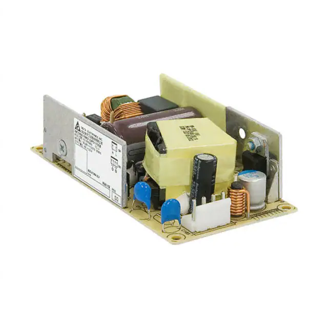

TECHNICAL DATASHEET PJT Open Frame Power Supply PJT-65 W Series / PJT-□□V65WBA□ PJT Highlights & Features • • • • • • Universal AC input voltage Standard industrial foot print of 2” x 4” Low leakage current < 0.1 mA Convection cooled operating temperature range from -10°C to +70°C High MTBF > 700,000 hrs as per Telcordia SR-332 Multiple connector source options Safety Standards CB Certified for worldwide use Model Number: PJT-☐☐V65WBA☐ Unit Weight: 0.13 kg (0.29 lb) Dimensions (L x W x H): 101.6 x 50.8 x 30 mm [2” x 4”] General Description The PJT open frame power supply series offers choices of 12 V, 15 V, 18 V and 24 V nominal output voltages. The single output products are designed with small standard industrial foot prints at 2” x 4”. The highly efficient convection cooling designs enable optimum thermal management for high power efficiency. The PJT series of products can operate from -10°C to +70°C across the entire input voltage range of 90 to 264 Vac and are certified for safety standard according to IEC/EN/UL 62368-1 and for EMI standard according to EN/BS EN 55032, Class B. Model Information PJT Open Frame Power Supply Model Number Input Voltage Range Rated Output Voltage Rated Output Current PJT-12V65WBA☐ 90-264 Vac 12 Vdc 5.00 A PJT-15V65WBA☐ 15 Vdc 4.20 A PJT-18V65WBA☐ 18 Vdc 3.61 A PJT-24V65WBA☐ 24 Vdc 2.71 A Model Numbering PJ T– XXV 65W Open Frame Output Voltage Output Power Product Type T – ITE Application 12 V (65W series Series 15 V model) 18 V 24 V B A □ Package Type B – Open Frame Family Code A Harness Connector A – JST connector B – Molex connector* C – JWT connector* *Options 1 All parameters are specified at 25°C ambient and AC unless otherwise indicated. www.DeltaPSU.com (July 2021, Rev. 05) TECHNICAL DATASHEET PJT Open Frame Power Supply PJT-65 W Series / PJT-□□V65WBA□ Specifications Model Number PJT-12V65WBA☐ PJT-15V65WBA☐ PJT-18V65WBA☐ PJT-24V65WBA☐ Input Ratings / Characteristics Nominal Input Voltage 100-240 Vac Input Voltage Range 90-264 Vac Nominal Input Frequency 50-60 Hz Input Frequency Range 47-63 Hz Input Current < 1.50 A typ. @ 115 Vac Efficiency at 100% Load 115 Vac 86.0% typ. 87.0% typ. 87.0% typ. 230 Vac 86.5% typ. 88.5% typ. 88.0% typ. Max Power Dissipation 0.3 W (0% load) Max Inrush Current (Cold Start) 30 A typ. @ 115 Vac, 60A typ. @ 230 Vac Leakage Current 0.1 mA @ 240 Vac 87.0% typ. Output Ratings / Characteristics Nominal Output Voltage 12 Vdc Factory Set Point Tolerance No potentiometer (± 5%) Output Current 5.00 A Output Power 60 W Line Regulation ± 0.5% @ 115 Vac & 230 Vac Load Regulation ± 1.0% @ 115 Vac & 230 Vac PARD* (20MHz) < 120 mVpp Start-up Time Hold-up Time 15 Vdc 18 Vdc 24 Vdc 4.20 A 3.61 A 2.71 A 63 W 65 W 65 W < 180 mVpp < 240 mVpp 3,000 uF Max 2,000 uF Max < 150 mVpp 115 Vac 3000 ms typ. (100% load) 230 Vac 1500 ms typ. (100% load) 115 Vac 16 ms typ. (100% load) 230 Vac 80 ms typ. (100% load) Dynamic Response (Overshoot & Undershoot O/P Voltage) ± 5% @ 50-100% load (Slew Rate: 0.1 A/µS) Start-up with Capacitive Loads 4,000 uF Max 3,500 uF Max *PARD is measured with an AC coupling mode, 5cm wires, and in parallel with 0.1μF ceramic capacitor & 47μF electrolytic capacitor. Mechanical Dimensions 101.6 x 50.8 x 30 mm [2” x 4”] Unit Weight 0.13 kg (0.29 lb) Cooling System Convection Terminal Wire 2 PJT-☐☐V65WBAA Input: JST B2P3-VH (LF)(SN) Output: JST B4P-VH (LF)(SN) PJT-☐☐V65WBAB Input: Molex 26-62-4030 Output: Molex 26-60-4040 PJT-☐☐V65WBAC Input: JWT A3963WV2-3P-D Output: JWT A3963WV2-4P AWG 22-18 All parameters are specified at 25°C ambient and AC unless otherwise indicated. www.DeltaPSU.com (July 2021, Rev. 05) TECHNICAL DATASHEET PJT Open Frame Power Supply PJT-65 W Series / PJT-□□V65WBA□ Environment Surrounding Air Temperature Operating -10°C to +70°C Storage -40°C to +85°C Power De-rating > 50°C de-rate power by 2.5% / °C Operating Humidity 10 to 95% RH (Non-Condensing) Operating Altitude 0 to 5,000 Meters (16,400 ft.) Shock Test (Non-Operating) IEC 60068-2-27, Half Sine Wave: 50 G for a duration of 11 ms, 3 shocks for each 3 directions Vibration (Operating) IEC 60068-2-6, Sine Wave: 10 Hz to 150 Hz @ 25 m/S² (2.5 G); 10 min per cycle, 90 min per axis for all X, Y, Z direction Protections Overvoltage 13.2-18.0 V, Latch Mode 16.5-22.5 V, Latch Mode 19.8-27.0 V, Latch Mode 26.4-36.0 V, Latch Mode Overload / Overcurrent > 125% of rated load current, Hiccup Mode, Non-Latching (Auto-Recovery) Over Temperature Non-Latching (Auto-Recovery) Short Circuit Hiccup Mode, Non-Latching (Auto-Recovery when the fault is removed) Protection Against Shock Class I with PE* connection *PE: Primary Earth Reliability Data MTBF > 700,000 hrs. as per Telcordia SR-332 Expected Cap Life Time 10 years (115 Vac & 230 Vac, 50% load @ 40°C) Safety Standards / Directives Electrical Safety TUV Bauart UL/cUL recognized CB scheme EN 60950-1, EN 62368-1 UL 60950-1 and CSA C22.2 No. 60950-1 (File No. E131881), UL 62368-1 and CSA C22.2 No. 62368-1 (File No. E131881) CCC, BSMI IEC 60950-1, IEC 62368-1 CE In conformance with EMC Directive 2014/30/EU and Low Voltage Directive 2014/35/EU UKCA In conformance with Electromagnetic Compatibility Regulations 2016 and Electrical Equipment (Safety) Regulations 2016 Galvanic Isolation 3 Input to Output 3.0 KVac Input to Ground 2.0 KVac Output to Ground 0.5 KVac All parameters are specified at 25°C ambient and AC unless otherwise indicated. www.DeltaPSU.com (July 2021, Rev. 05) TECHNICAL DATASHEET PJT Open Frame Power Supply PJT-65 W Series / PJT-□□V65WBA□ EMC Emissions (CE&RE) CISPR 32, EN/BS EN 55032, FCC Title 47: Class B Immunity to EN/BS EN 55024 Electrostatic Discharge IEC 61000-4-2 Criteria A1) Level 3 Air Discharge: 8 kV Level 3 Contact Discharge: 6 kV Radiated Field IEC 61000-4-3 Level 2 Criteria A1) 80 MHz-1 GHz, 3 V/M with 1 kHz tone / 80% modulation Electrical Fast Transient / Burst IEC 61000-4-4 Level 3 Criteria A1) 2 kV Surge IEC 61000-4-5 Conducted IEC 61000-4-6 Level 3 Criteria A1) Common Mode2): 2 kV Differential Mode3): 1 kV Level 2 Criteria A1) 3 V with 80% AM Power Frequency Magnetic Fields IEC 61000-4-8 Voltage Dips IEC 61000-4-11 Voltage Fluctuation and Flicker Criteria A1) Magnetic field strength 3A/Meter 30% dip; 10 ms Criterion A 60% dip; 100 ms Criterion B 95% dip; 5000 ms Criterion B IEC/EN/BS EN 61000-3-3 1) Criteria A: Normal performance within the specification limits 2) Asymmetrical: Common mode (Line to earth) 3) Symmetrical: Differential mode (Line to line) Block Diagram 4 All parameters are specified at 25°C ambient and AC unless otherwise indicated. www.DeltaPSU.com (July 2021, Rev. 05) TECHNICAL DATASHEET PJT Open Frame Power Supply PJT-65 W Series / PJT-□□V65WBA□ Dimensions L x W x H: 101.6 x 50.8 x 30 mm [2” x 4”] 1 3 4 1 Item Device Description 5 1 Input Connector (CN1) Pin 1: Line Pin 2: NC Pin 3: Neutral 2 Output Connector (CN2) Pin 1 to 2 : V(+) Pin 3 to 4 : V(-) All parameters are specified at 25°C ambient and AC unless otherwise indicated. www.DeltaPSU.com (July 2021, Rev. 05) TECHNICAL DATASHEET PJT Open Frame Power Supply PJT-65 W Series / PJT-□□V65WBA□ Engineering Data Output Load De-rating VS Surrounding Air Temperature Note 1. 2. 3. 4. Fig. 1 De-rating for Horizontal Mounting Orientation > 50°C de-rate power by 2.5% / °C Power supply components may degrade, or be damaged, when the power supply is continuously used outside the shaded region, refer to the graph shown in Fig. 1. If the output capacity is not reduced when the surrounding air temperature >50°C, the device will run into Over Temperature Protection. When activated, the output voltage will go into bouncing mode and will recover when the surrounding air temperature is lowered or the load is reduced as far as necessary to keep the device in working condition. Depending on the surrounding air temperature and output load delivered by the power supply, the device can be very hot! If the device has to be mounted in any other orientation, please contact info@deltapsu.com for more details. Output Load De-rating VS Input Voltage  No output power de-rating for the input voltage from 90 Vac to 264 Vac ■ L Frame / Enclosed 6 All parameters are specified at 25°C ambient and AC unless otherwise indicated. www.DeltaPSU.com (July 2021, Rev. 05) TECHNICAL DATASHEET PJT Open Frame Power Supply PJT-65 W Series / PJT-□□V65WBA□ Assembly & Installation Any excessive twisting or bending may damage the device’s PCB. Please handle the device with care. Base Mounting (Horizontal) Fig. 2 Recommended Mounting Orientation Use cable of AWG No. 22-18. Please refer to Table 1 for the recommended Mating Connector and Terminal. Table 1 A – JST connector B – Molex connector C – JWT connector Input / Output Power Supply Header Mating Connector Terminal Input B2P3-VH (LF)(SN) VHR-3N SVH-21T-P1.1 Output B4P-VH (LF)(SN) VHR-4N SVH-21T-P1.1 Input 26-62-4030 09-50-3031 08-52-0071 Output 26-60-4040 09-50-3041 08-52-0071 Input A3963WV2-3P-D A3963H02-3P A3963TOP-2 Output A3963WV2-4P A3963H02-4P A3963TOP-2 Safety Instructions • • • • • • • 7 If the device has to be mounted in any other orientation, please contact info@deltapsu.com for more details. The device is not recommended to be placed on surface with low thermal conductivity, such as plastics, for example. For safety reasons, please ensure the mounted device is kept at ≥ 4 mm (0.16 inch) safety distance at all sides from other components and equipments. Please insert an insulation sheet between the system and product, if the safety distance is less than 4mm. In addition, to ensure sufficient convection cooling, always maintain a distance of ≥ 20 mm (0.79 inch) from ventilated surfaces while the device is in operation. Note that the device can become very hot depending on the ambient temperature and load of the power supply. Do not touch the device while it is in operation or immediately after power is turned OFF. Risk of burning! Do not touch the terminals while power is being supplied. Risk of electric shock. Prevent any foreign metal, particles or conductors from entering the device through the openings during installation. It may cause: Electric shock; Safety Hazard; Fire; Product failure The power supply must be mounted by metal screws onto a grounded metal surface. It is highly recommended that the Earth terminal on the connector be connected to the grounded metal surface. All parameters are specified at 25°C ambient and AC unless otherwise indicated. www.DeltaPSU.com (July 2021, Rev. 05) TECHNICAL DATASHEET PJT Open Frame Power Supply PJT-65 W Series / PJT-□□V65WBA□ Functions Start-up Time The time required for the output voltage to reach 90% of its final steady state set value, after the input voltage is applied. Rise Time The time required for the output voltage to change from 10% to 90% of its final steady state set value. Hold-up Time Time between the collapse of the AC input voltage, and the output falling to 95% of its steady state set value. ■ Graph illustrating the Start-up Time, Rise Time, and Hold-up Time Inrush Current Dynamic Response Inrush current is the peak, instantaneous, input current measured and, occurs when the input voltage is first applied. For AC input voltages, the maximum peak value of inrush current will occur during the first half cycle of the applied AC voltage. This peak value decreases exponentially during subsequent cycles of AC voltage. The power supply output voltage will remain within ±5% of its steady state value, when subjected to a dynamic load from 50 to 100% of its rated current. 8 All parameters are specified at 25°C ambient and AC unless otherwise indicated. www.DeltaPSU.com (July 2021, Rev. 05) TECHNICAL DATASHEET PJT Open Frame Power Supply PJT-65 W Series / PJT-□□V65WBA□ Overload & Overcurrent Protections (Auto-Recovery) Overvoltage Protection (Latch Mode) The power supply’s Overload (OLP) and Overcurrent (OCP) Protections will be activated when output current exceeds 125% of IO (Max load). In such occurrence, the VO will start to droop and once the power supply has reached its maximum power limit, the protection is activated and the power supply will go into “Hiccup mode” (Auto-Recovery). The power supply will recover once the fault condition of the OLP and OCP is removed and IO is back within the specifications. The power supply’s overvoltage circuit will be activated when its internal feedback circuit fails. The output voltage shall not exceed its specifications defined on Page 3 under “Protections”. Power supply will latch off, and require removal/re-application of input AC voltage in order to restart. It is not recommended to prolong the duration of IO when it is 100%, since it may cause damage to the PSU. Short Circuit Protection (Auto-Recovery) The power supply’s output OLP/OCP function also provides protection against short circuits. When a short circuit is applied, the output current will operate in “Hiccup mode”, as shown in the illustration in the OLP/OCP section on this page. The power supply will return to normal operation after the short circuit is removed. The power supply should be latch. Over Temperature Protection (Auto-Recovery) As described in load de-rating section, the power supply also has Over Temperature Protection (OTP). In the event of a higher operating temperature at 100% load, the power supply will run into OTP when the operating temperature is beyond what is recommended in the de-rating graph. When activated, the output voltage will go into bouncing mode until the temperature drops to its normal operating temperature as recommended in the de-rating graph. Others Attention Delta provides all information in the datasheets on an “AS IS” basis and does not offer any kind of warranty through the information for using the product. In the event of any discrepancy between the information in the catalog and datasheets, the datasheets shall prevail (please refer to www.DeltaPSU.com for the latest datasheets information). Delta shall have no liability of indemnification for any claim or action arising from any error for the provided information in the datasheets. Customer shall take its responsibility for evaluation of using the product before placing an order with Delta. Delta reserves the right to make changes to the information described in the datasheets without notice. Manufacturer and Authorized Representatives Information Manufacturer Thailand Delta Electronics (Thailand) PCL. 909 Pattana 1 Rd., Muang, Samutprakarn, 10280 Thailand Taiwan Delta Electronics, Inc. 3 Tungyuan Road, Chungli Industrial Zone, Taoyuan County 32063, Taiwan Authorized Representatives The Netherlands Delta Greentech (Netherlands) B.V. Zandsteen 15, 2132 MZ Hoofddorp, The Netherlands 9 United Kingdom Delta Electronics Europe Limited 1 Redwood Court, Peel Park Campus, East Kilbride, Glasgow, G74 5PF, United Kingdom All parameters are specified at 25°C ambient and AC unless otherwise indicated. www.DeltaPSU.com (July 2021, Rev. 05)
