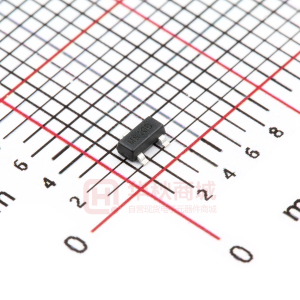

AH337 SINGLE PHASE HALL EFFECT SWITCH Description AH337 is an unipolar Hall-Effect sensor for contactless switching applications. The device includes an on-chip Hall voltage generator for magnetic sensing, an amplifier that amplifies the Hall voltage, a Schmitt trigger to provide switching hysteresis for noise rejection, and an open-collector output. The band-gap regulator allows a wide operating voltage range. When the magnetic flux density (B) is larger than operate point (Bop), output is switched on (OUT pin is pulled low). The output state is held on until a magnetic flux density falls below Brp. When B is less than Brp, the output is switched off. The AH337 is available in SIP-3L and SC59 packages. Pin Assignments (Top View) 3. OUT 2. GND 1. Vdd SIP-3L (Top View) 3. OUT GND 2. 1. Vdd SC59 Applications • • • • • VCD/DVD Loader, CD/DVD ROM Cover Detector Speed Measurement Home Appliances Home Safety Features • • • • • • • • Unipolar Hall-Effect sensor 4.2V to 28V DC operating voltage Temperature compensation Open drain pre-driver 25mA maximum output sink current Operating temperature: -40°C to +125°C SIP-3L and SC59 packages (SC59 is commonly known as SOT23 in Asia) Green Molding Compound (No Br, Sb) (Note 1) Notes: 1. EU Directive 2002/95/EC (RoHS). All applicable RoHS exemptions applied. Please visit our website at http://www.diodes.com/products/lead_free.html. Typical Application Circuit 4.2V ~ 28 V Vdd RL AH337 Output GND AH337 Document number: DS31050 Rev. 9 - 2 1 of 9 www.diodes.com July 2010 © Diodes Incorporated AH337 SINGLE PHASE HALL EFFECT SWITCH Pin Descriptions Pin Name Vdd GND OUT P/I/O P P O Pin # 1 2 3 Description Positive Power Supply Ground Output Pin Functional Block Diagram Vdd 1 Regulator Hall plate Amp 2 GND 3 2 OUT Absolute Maximum Ratings (TA = 25°C) Symbol Vdd B VDS Id TS TJ(MAX) PD Characteristics Supply Voltage Magnetic Flux Density Output OFF Voltage Output “ON” Current Storage Temperature Range Maximum Junction Temperature Package Power Dissipation Values 30 Unlimited 30 25 -65~+150 150 550 230 Unit V V mA °C °C mW mW Continuous SIP-3L SC59 Recommended Operating Conditions Symbol Vdd TA Notes: Parameter Supply Voltage (Note 2) Operating Ambient Temperature Conditions Operating Operating Min 4.2 -40 Max 28 125 Unit V °C 2. The output of IC will be switched after the supply voltage is over 4.2V, but the magnetic characteristics won't be normal until the supply is over 4.5V. 2 of 9 www.diodes.com July 2010 © Diodes Incorporated AH337 Document number: DS31050 Rev. 9 - 2 AH337 SINGLE PHASE HALL EFFECT SWITCH Electrical Characteristics (TA = 25°C, Vdd = 12V) Symbol VDS (SAT) Ioff Idd Characteristic Output Saturation Voltage Output Leakage Current Supply Current Test Conditions Iout = 10mA, B > Bop B < Brp Output Open Min Typ. 300 < 0.1 2 Max 400 10 4 Unit mV uA mA Magnetic Characteristics (TA = 25°C, Vdd = 4.5V to 28V, Note 3) (1mT = 10 Gauss) Max Unit 150 Gauss 90 Gauss Gauss Symbol Bops(south pole to brand side) Brps(south pole to brand side) Bhy(|Bopx|-|Brpx|) Notes: Parameter Operation Point Release Point Hysteresis Min 90 30 - Typ. 120 60 60 3. Magnetic characteristics may vary with supply voltage, operating temperature and after soldering. Operating Characteristics Output ( Output Voltage ) S S Marking side ( off -state ) Vdd B hy Turn off Turn on Marking side N (SC59) N V SAT (SIP-3L) 0 B rp B op ( on -state ) ( Magnetic flux density B ) AH337 Document number: DS31050 Rev. 9 - 2 3 of 9 www.diodes.com July 2010 © Diodes Incorporated AH337 SINGLE PHASE HALL EFFECT SWITCH Performance Characteristics (1) SIP-3L TA (°C) PD (mW) TA (°C) PD(mW) P D (m W ) 600 500 400 300 200 100 0 0 -4 0 25 50 75 100 125 150 T A ( °C ) 25 550 105 198 50 440 110 176 60 396 115 154 70 352 120 132 80 308 125 110 85 286 130 88 90 264 135 66 95 242 140 44 100 220 150 0 P o w e r D is s ip a tio n C u rve (2) SC59 (commonly known as SOT23 in Asia) TA (°C) PD (mW) 25 230 50 184 60 166 70 147 80 129 85 120 90 110 100 92 110 74 120 55 130 37 140 18 150 0 P D (m W ) 300 P o w e r D is s ip a tio n C u rv e 200 100 0 0 -4 0 25 50 75 100 125 150 T A ( °C ) AH337 Document number: DS31050 Rev. 9 - 2 4 of 9 www.diodes.com July 2010 © Diodes Incorporated AH337 SINGLE PHASE HALL EFFECT SWITCH Ordering Information AH337 - X X - X Package P : SIP-3L W : SC59 Lead Free L : Lead Free G : Green (Note 4) Packing A : Ammo Box (Note 7) B : Bulk (Note 8) 7 : Tape & Reel Device AH337-PL-A AH337-PL-B AH337-PG-A AH337-PG-B AH337-WL-7 AH337-WG-7 Notes: Bulk Package Packaging Part Code (Note 5, 6) Quantity Number Suffix P SIP-3L NA NA P SIP-3L 1000 -B P SIP-3L NA NA P SIP-3L 1000 -B W SC59 NA NA W SC59 NA NA 7” Tape and Reel Ammo Box Part Part Quantity Number Quantity Number Suffix Suffix NA NA 4000/Box -A NA NA NA NA NA NA 4000/Box -A NA NA NA NA 3000/Tape & Reel -7 NA NA 3000/Tape & Reel -7 NA NA 4. EU Directive 2002/95/EC (RoHS). All applicable RoHS exemptions applied. Please visit our website at http://www.diodes.com/products/lead_free.html. 5. Pad layout as shown on Diodes Inc. suggested pad layout document AP02001, which can be found on our website at http://www.diodes.com/datasheets/ap02001.pdf. 6. Reverse taping as shown on Diodes Inc. Surface Mount (SMD) Packaging document AP02007, which can be found on our website http://www.diodes.com/datasheets/ap02007.pdf. 7. Ammo Box is for SIP-3L Spread Lead. 8. Bulk is for SIP-3L Straight Lead. AH337 Document number: DS31050 Rev. 9 - 2 5 of 9 www.diodes.com July 2010 © Diodes Incorporated AH337 SINGLE PHASE HALL EFFECT SWITCH Marking Information (1) SIP-3L (Top View) Part Number 337 Y WW X Y : Year : 0~9 WW : Week : 01~52, "52" represents 52 and 53 week X : Internal Code : A~Z : Green a~z : Lead Free (2) SC59 (Commonly known as SOT23 in Asia) (Top View) XX Y W X XX : Identification code Y : Year 0~9 W : Week : A~Z : 1~26 week; a~z : 27~52 week; z represents 52 and 53 week X : A~Z : Green a~z : Lead Free Package SC59 Identification Code P1 Part Number AH337 AH337 Document number: DS31050 Rev. 9 - 2 6 of 9 www.diodes.com July 2010 © Diodes Incorporated AH337 SINGLE PHASE HALL EFFECT SWITCH Package Outline Dimensions (All Dimensions in mm) (1) Package Type: SIP-3L for Bulk pack 0.51mm NOM 2.00 +/0.10mm 1.15 +/0.10mm BRANDED SURFACE 1 2 3 Active Area Depth Package Dimension Sensor Location AH337 Document number: DS31050 Rev. 9 - 2 7 of 9 www.diodes.com July 2010 © Diodes Incorporated AH337 SINGLE PHASE HALL EFFECT SWITCH Package Outline Dimensions (Continued) (2) Package Type: SIP-3L for Ammo pack (3) SC59 (Commonly known as SOT23 in Asia) 0.35/0.50 TOP VIEW 1.50/ 1.70 2.70/ 3.00 1.90 2.90/3.10 1.00/ 1.30 0.10/0.20 0.013/0.10 0.95 0.35/0.55 0 O /8 O AH337 Document number: DS31050 Rev. 9 - 2 8 of 9 www.diodes.com July 2010 © Diodes Incorporated AH337 SINGLE PHASE HALL EFFECT SWITCH IMPORTANT NOTICE DIODES INCORPORATED MAKES NO WARRANTY OF ANY KIND, EXPRESS OR IMPLIED, WITH REGARDS TO THIS DOCUMENT, INCLUDING, BUT NOT LIMITED TO, THE IMPLIED WARRANTIES OF MERCHANTABILITY AND FITNESS FOR A PARTICULAR PURPOSE (AND THEIR EQUIVALENTS UNDER THE LAWS OF ANY JURISDICTION). Diodes Incorporated and its subsidiaries reserve the right to make modifications, enhancements, improvements, corrections or other changes without further notice to this document and any product described herein. Diodes Incorporated does not assume any liability arising out of the application or use of this document or any product described herein; neither does Diodes Incorporated convey any license under its patent or trademark rights, nor the rights of others. Any Customer or user of this document or products described herein in such applications shall assume all risks of such use and will agree to hold Diodes Incorporated and all the companies whose products are represented on Diodes Incorporated website, harmless against all damages. Diodes Incorporated does not warrant or accept any liability whatsoever in respect of any products purchased through unauthorized sales channel. Should Customers purchase or use Diodes Incorporated products for any unintended or unauthorized application, Customers shall indemnify and hold Diodes Incorporated and its representatives harmless against all claims, damages, expenses, and attorney fees arising out of, directly or indirectly, any claim of personal injury or death associated with such unintended or unauthorized application. Products described herein may be covered by one or more United States, international or foreign patents pending. Product names and markings noted herein may also be covered by one or more United States, international or foreign trademarks. LIFE SUPPORT Diodes Incorporated products are specifically not authorized for use as critical components in life support devices or systems without the express written approval of the Chief Executive Officer of Diodes Incorporated. As used herein: A. Life support devices or systems are devices or systems which: 1. are intended to implant into the body, or 2. support or sustain life and whose failure to perform when properly used in accordance with instructions for use provided in the labeling can be reasonably expected to result in significant injury to the user. B. A critical component is any component in a life support device or system whose failure to perform can be reasonably expected to cause the failure of the life support device or to affect its safety or effectiveness. Customers represent that they have all necessary expertise in the safety and regulatory ramifications of their life support devices or systems, and acknowledge and agree that they are solely responsible for all legal, regulatory and safety-related requirements concerning their products and any use of Diodes Incorporated products in such safety-critical, life support devices or systems, notwithstanding any devices- or systems-related information or support that may be provided by Diodes Incorporated. Further, Customers must fully indemnify Diodes Incorporated and its representatives against any damages arising out of the use of Diodes Incorporated products in such safety-critical, life support devices or systems. Copyright © 2010, Diodes Incorporated www.diodes.com AH337 Document number: DS31050 Rev. 9 - 2 9 of 9 www.diodes.com July 2010 © Diodes Incorporated
