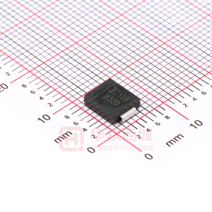

SPICE MODELS: B320 B330 B340 B350 B360 B320 - B360 3.0A SURFACE MOUNT SCHOTTKY BARRIER RECTIFIER Features • • • • • • Guard Ring Die Construction for Transient Protection Ideally Suited for Automatic Assembly Low Power Loss, High Efficiency Surge Overload Rating to 125A Peak For Use in Low Voltage, High Frequency Inverters, Free Wheeling, and Polarity Protection Application Lead Free Finish/RoHS Compliant (Note 4) SMC Dim A B C D E G H J Min 5.59 6.60 2.75 0.15 7.75 0.10 0.76 2.00 Max 6.22 7.11 3.18 0.31 8.13 0.20 1.52 2.62 Mechanical Data • • • • • • • • Case: SMC Case Material: Molded Plastic. UL Flammability Classification Rating 94V-0 Moisture Sensitivity: Level 1 per J-STD-020C Terminals: Lead Free Plating (Matte Tin Finish). Solderable per MIL-STD-202, Method 208 Polarity: Cathode Band Marking Information: See Page 3 Ordering Information: See Page 3 Weight: 0.21 grams (approximate) All Dimensions in mm * Note: Device may have a semicircular indentation/notch on one side of the device (as shown). Maximum Ratings and Electrical Characteristics Single phase, half wave, 60Hz, resistive or inductive load. For capacitive load, derate current by 20%. Characteristic Peak Repetitive Reverse Voltage Working Peak Reverse Voltage DC Blocking Voltage RMS Reverse Voltage Average Rectified Output Current Non-Repetitive Peak Forward Surge Current 8.3ms single half sine-wave superimposed on rated load Forward Voltage (Note 3) Peak Reverse Current at Rated DC Blocking Voltage (Note 3) Typical Capacitance (Note 2) Typical Thermal Resistance, Junction to Terminal Typical Thermal Resistance, Junction to Ambient (Note 1) Operating Temperature Range Storage Temperature Range Notes: 1. 2. 3. 4. @TA = 25°C unless otherwise specified Symbol VRRM VRWM VR VR(RMS) @ TT =100C° IO IFSM @ IF = 3.0A @ TA = 25°C @ TA = 100°C VFM IRM CT RθJT RθJA Tj TSTG B320 20 14 B330 30 21 B340 40 28 3.0 125 B350 50 35 B360 60 42 Unit V V A A 0.50 0.5 20 200 20 90 -55 to +125 -55 to +150 0.70 V mA pF °C/W °C/W °C °C Thermal Resistance: Junction to terminal, unit mounted on glass epoxy substrate with 2x3mm copper pad Measured at 1.0MHz and applied reverse voltage of 4.0V DC. Short duration test pulse used to minimize self-heating effect. RoHS revision 13.2.2003. Glass and high temperature solder exemptions applied, see EU Directive Annex Notes 5 and 7. DS30923 Rev. 2 - 2 1 of 3 www.diodes.com B320-B360 © Diodes Incorporated IFSM, PEAK FORWARD SURGE CURRENT (A) 100 Single Half-Sine-Wave 80 TT = 100°C 60 40 20 0 1 10 100 NUMBER OF CYCLES AT 60 Hz Fig. 4 Max Non-Repetitive Peak Forward Surge Current DS30923 Rev. 2 - 2 2 of 3 www.diodes.com B320-B360 © Diodes Incorporated Ordering Information Device* B3x0-13-F * (Note 5) Packaging SMC Shipping 3000/Tape & Reel x = Device type, e.g. B320-13-F (SMC package). Notes: 5. For Packaging Details, go to our website at http://www.diodes.com/datasheets/ap02007.pdf. Marking Information (Note 6) Notes: 6. Device has a cathode band (as shown above) and may also have a cathode notch (as shown on Page 1). IMPORTANT NOTICE Diodes Incorporated and its subsidiaries reserve the right to make modifications, enhancements, improvements, corrections or other changes without further notice to any product herein. Diodes Incorporated does not assume any liability arising out of the application or use of any product described herein; neither does it convey any license under its patent rights, nor the rights of others. The user of products in such applications shall assume all risks of such use and will agree to hold Diodes Incorporated and all the companies whose products are represented on our website, harmless against all damages. LIFE SUPPORT Diodes Incorporated products are not authorized for use as critical components in life support devices or systems without the expressed written approval of the President of Diodes Incorporated. DS30923 Rev. 2 - 2 3 of 3 www.diodes.com B320-B360 © Diodes Incorporated
