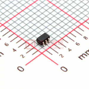

SPICE MODELS: BAS40T BAS40-04T BAS40-05T BAS40-06T BAS40T/-04T/-05T/-06T Lead-free SURFACE MOUNT SCHOTTKY BARRIER DIODE Features · · · · · Low Forward Voltage Drop Fast Switching Ultra-Small Surface Mount Package PN Junction Guard Ring for Transient and ESD Protection Lead Free/RoHS Compliant (Note 3) BC A SOT-523 Dim A B C D G H K M Min 0.15 0.75 1.45 ¾ 0.90 1.50 0.00 0.60 0.10 0.10 0.45 0° Max 0.30 0.85 1.75 ¾ 1.10 1.70 0.10 0.80 0.30 0.20 0.65 8° Typ 0.22 0.80 1.60 0.50 1.00 1.60 0.05 0.75 0.22 0.12 0.50 ¾ Mechanical Data · · · · · · · · · Case: SOT-523 Case Material: Molded Plastic. UL Flammability Classification Rating 94V-0 Moisture Sensitivity: Level 1 per J-STD-020C Terminals: Solderable per MIL-STD-202, Method 208 Lead Free Plating (Matte Tin Finish annealed over Alloy 42 leadframe). Polarity: See Diagrams Below Marking: See Diagrams Below & Page 2 Weight: 0.002 grams (approximate) Ordering Information, see Page 2 J D G H J K L N L M N a All Dimensions in mm TOP VIEW BAS40T Marking: 43 BAS40-04T Marking: 44 BAS40-05T Marking: 45 BAS40-06T Marking: 46 Maximum Ratings @ TA = 25°C unless otherwise specified Characteristic Peak Repetitive Reverse Voltage Working Peak Reverse Voltage DC Blocking Voltage RMS Reverse Voltage Forward Continuous Current (Note 1) Non-Repetitive Peak Forward Surge Current Power Dissipation (Note 1) Thermal Resistance Junction to Ambient (Note 1) Operating Temperature Range Storage Temperature Range @ t = 1.0s Symbol VRRM VRWM VR VR(RMS) IFM IFSM Pd RqJA Tj TSTG @ TA = 25°C unless otherwise specified Symbol V(BR)R VF IR CT trr Min 40 ¾ ¾ ¾ ¾ Max ¾ 380 1000 200 5.0 5.0 Unit V mV mV nA pF ns Test Condition IR = 10mA IF = 1.0mA, tp < 300ms IF = 40mA, tp < 300ms VR = 30V VR = 0, f = 1.0MHz IF = IR = 10mA, Irr = 0.1 x IR, RL = 100W Value 40 28 200 600 150 833 -55 to +125 -65 to +150 Unit V V mA mA mW °C/W °C °C Electrical Characteristics Characteristic Reverse Breakdown Voltage (Note 2) Forward Voltage Leakage Current (Note 2) Total Capacitance Reverse Recovery Time Notes: 1. Device mounted on FR-4 PC board with recommended pad layout, which can be found on our website at http://www.diodes.com/datasheets/ap02001.pdf. 2. Short duration test pulse used to minimize self-heating effect. 3. No purposefully added lead. DS30265 Rev. 10 - 2 1 of 3 www.diodes.com BAS40T/-04T/-05T/-06T ã Diodes Incorporated IF, INSTANTANEOUS FORWARD CURRENT (A) 1 IR, INSTANTANEOUS REVERSE CURRENT (nA) 10000 TA = 125ºC 0.1 1000 TA = 75ºC 100 0.01 TA = -40ºC TA = 0ºC TA = 25ºC TA = 25ºC 10 TA = 0ºC 0.001 1 TA = -40ºC TA = 75ºC TA = 125ºC 0.0001 0 0.2 0.4 0.6 0.8 1.0 VF, INSTANTANEOUS FORWARD VOLTAGE (V) Fig. 1 Typical Forward Voltage 0.1 0 10 20 30 40 VR, INSTANTANEOUS REVERSE VOLTAGE (V) Fig. 2 Typical Reverse Characteristics 200 3 f = 1MHz CT, TOTAL CAPACITANCE (pF) Pd, POWER DISSIPATION (mW) 150 2 100 1 50 0 0 10 20 30 40 0 0 40 80 120 160 200 TA, AMBIENT TEMPERATURE (ºC) Fig. 4 Power Derating Curve, Total Package VR, REVERSE VOLTAGE (V) Fig. 3 Typical Capacitance Ordering Information Device BAS40T-7-F (Note 4) Packaging SOT-523 SOT-523 SOT-523 SOT-523 Shipping 3000/Tape & Reel 3000/Tape & Reel 3000/Tape & Reel 3000/Tape & Reel BAS40-04T-7-F BAS40-05T-7-F BAS40-06T-7-F Notes: 4. For Packaging Details, go to our website at http://www.diodes.com/datasheets/ap02007.pdf. Marking Information XX = Product Type Marking Code (See Page 1, e.g. 43 = BAS40T) YM = Date Code Marking Y = Year (ex: N = 2002) M = Month (ex: 9 = September) XXYM Date Code Key Year Code Month Code 2001 M Jan 1 2002 N Feb 2 2003 P March 3 2004 R Apr 4 2005 S May 5 2006 T Jun 6 2007 U Jul 7 2008 V Aug 8 2009 W Sep 9 2010 X Oct O 2011 Y Nov N 2012 Z Dec D DS30265 Rev. 10 - 2 2 of 3 www.diodes.com BAS40T/-04T/-05T/-06T IMPORTANT NOTICE Diodes Incorporated and its subsidiaries reserve the right to make modifications, enhancements, improvements, corrections or other changes without further notice to any product herein. Diodes Incorporated does not assume any liability arising out of the application or use of any product described herein; neither does it convey any license under its patent rights, nor the rights of others. The user of products in such applications shall assume all risks of such use and will agree to hold Diodes Incorporated and all the companies whose products are represented on our website, harmless against all damages. LIFE SUPPORT Diodes Incorporated products are not authorized for use as critical components in life support devices or systems without the expressed written approval of the President of Diodes Incorporated. DS30265 Rev. 10 - 2 3 of 3 www.diodes.com BAS40T/-04T/-05T/-06T
