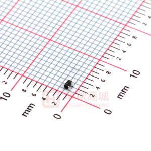

BAT54 /A /C /S SURFACE MOUNT SCHOTTKY BARRIER DIODE Features • • • • • • Low Turn-on Voltage Fast Switching PN Junction Guard Ring for Transient and ESD Protection Lead Free/RoHS Compliant (Note 3) “Green” Molding Compound (No Br, Sb) (Note 4) Qualified to AEC-Q101 Standards for High Reliability Mechanical Data • • • • • • • • Case: SOT-23 Case Material: Molded Plastic, “Green” Molding Compound. UL Flammability Classification Rating 94V-0 Moisture Sensitivity: Level 1 per J-STD-020 Terminals: Matte Tin Finish annealed over Alloy 42 leadframe (Lead Free Plating). Solderable per MIL-STD-202, Method 208 Polarity: See Diagrams Below Marking Information: See Page 3 Ordering Information: See Page 2 Weight: 0.008 grams (approximate) Top View BAT54 BAT54A BAT54C BAT54S Maximum Ratings @TA = 25°C unless otherwise specified Symbol VRRM VRWM VR IF IFRM IFSM Value 30 200 300 600 Unit V mA mA mA Characteristic Peak Repetitive Reverse Voltage Working Peak Reverse Voltage DC Blocking Voltage Forward Continuous Current (Note 2) Repetitive Peak Forward Current Forward Surge Current @ t < 1.0s Thermal Characteristics Characteristic Power Dissipation (Note 2) Thermal Resistance, Junction to Ambient Air (Note 2) Operating and Storage Temperature Range (Note 5) Symbol PD RθJA TJ, TSTG Value 200 500 -65 to +150 Unit mW °C/W °C Electrical Characteristics Characteristic Reverse Breakdown Voltage (Note 1) @TA = 25°C unless otherwise specified Symbol V(BR)R Min 30 Typ ⎯ Max ⎯ 240 320 400 500 800 2.0 10 5.0 Unit V Test Condition IRS = 100μA IF = 0.1mA IF = 1mA IF = 10mA IF = 30mA IF = 100mA VR = 25V VR = 1.0V, f = 1.0MHz IF = 10mA through IR = 10mA to IR = 1.0mA, RL = 100Ω Forward Voltage VF IR CT trr ⎯ ⎯ mV Reverse Leakage Current (Note 1) Total Capacitance Reverse Recovery Time Notes: 1. 2. 3. 4. ⎯ ⎯ ⎯ ⎯ ⎯ ⎯ μA pF ns Short duration test pulse used to minimize self-heating effect. Part mounted on FR-4 board with recommended pad layout, which can be found on our website at http://www.diodes.com/datasheets/ap02001.pdf. No purposefully added lead. Products manufactured with date code VD (Week 50, 2008) and newer are built with Green Molding Compound. Products manufactured with date code prior to VD are built with Non-Green Molding Compound and may contain Halogens or Sb2O3 Fire Retardants. 5. The heat generated must be less than the thermal conductivity from Junction-to-Ambient: dPD/dTJ < 1/RθJA BAT54 /A /C /S Document number: DS11005 Rev. 25 - 2 1 of 4 www.diodes.com June 2010 © Diodes Incorporated BAT54 /A /C /S IF, INSTANTANEOUS FORWARD CURRENT (A) 1 100 TA = 125ºC 10 0.1 TA = 75ºC 1 TA = 125ºC 0.01 T A = 75ºC T A = 25ºC TA = 0ºC T A = 25ºC 0.1 TA = 0ºC 0.001 T A = -40ºC 0.01 0.0001 0 0.4 1.0 0.2 0.8 0.6 VF, INSTANTANEOUS FORWARD VOLTAGE (V) Fig. 1 Typical Forward Characteristics 0.001 0 5 10 15 20 30 25 VR, INSTANTANEOUS REVERSE VOLTAGE (V) Fig. 2 Typical Reverse Characteristics 12 PD, POWER DISSIPATION (mW) 10 CT, TOTAL CAPACITANCE (pF) 200 8 6 100 4 2 0 0 10 15 20 25 30 VR, DC REVERSE VOLTAGE (V) Fig. 3 Total Capacitance vs. Reverse Voltage 5 0 25 50 75 100 125 TA, AMBIENT TEMPERATURE (° C) Fig. 4 Power Derating Curve 150 0 Ordering Information (Note 6) Part Number BAT54-7-F BAT54A-7-F BAT54C-7-F BAT54S-7-F Notes: Case SOT-23 SOT-23 SOT-23 SOT-23 Packaging 3000/Tape & Reel 3000/Tape & Reel 3000/Tape & Reel 3000/Tape & Reel 6. For packaging details, go to our website at http://www.diodes.com/datasheets/ap02007.pdf. BAT54 /A /C /S Document number: DS11005 Rev. 25 - 2 2 of 4 www.diodes.com June 2010 © Diodes Incorporated BAT54 /A /C /S Marking Information xxx = Product Type Marking Code KL1 = BAT54 KL2 = BAT54A KL3 = BAT54C KL4 = BAT54S YM = Date Code Marking Y = Year (ex: T = 2006) M = Month (ex: 9 = September) xxx Date Code Key Year 1998 Code J Month Code Jan 1 1999 K 2000 L Feb 2 2001 M Mar 3 2002 N 2003 P Apr 4 2004 R May 5 YW 2005 S 2006 T Jun 6 2007 U Jul 7 2008 V 2009 W Aug 8 2010 X Sep 9 2011 Y 2012 Z Oct O 2013 A Nov N 2014 B 2015 C Dec D Package Outline Dimensions A BC H K D J F G L M K1 SOT-23 Dim Min Max Typ A 0.37 0.51 0.40 B 1.20 1.40 1.30 C 2.30 2.50 2.40 D 0.89 1.03 0.915 F 0.45 0.60 0.535 G 1.78 2.05 1.83 H 2.80 3.00 2.90 J 0.013 0.10 0.05 K 0.903 1.10 1.00 K1 0.400 L 0.45 0.61 0.55 M 0.085 0.18 0.11 0° 8° α All Dimensions in mm Suggested Pad Layout Y Z C Dimensions Value (in mm) Z 2.9 X 0.8 Y 0.9 2.0 C 1.35 E X E BAT54 /A /C /S Document number: DS11005 Rev. 25 - 2 3 of 4 www.diodes.com June 2010 © Diodes Incorporated BAT54 /A /C /S IMPORTANT NOTICE DIODES INCORPORATED MAKES NO WARRANTY OF ANY KIND, EXPRESS OR IMPLIED, WITH REGARDS TO THIS DOCUMENT, INCLUDING, BUT NOT LIMITED TO, THE IMPLIED WARRANTIES OF MERCHANTABILITY AND FITNESS FOR A PARTICULAR PURPOSE (AND THEIR EQUIVALENTS UNDER THE LAWS OF ANY JURISDICTION). Diodes Incorporated and its subsidiaries reserve the right to make modifications, enhancements, improvements, corrections or other changes without further notice to this document and any product described herein. Diodes Incorporated does not assume any liability arising out of the application or use of this document or any product described herein; neither does Diodes Incorporated convey any license under its patent or trademark rights, nor the rights of others. Any Customer or user of this document or products described herein in such applications shall assume all risks of such use and will agree to hold Diodes Incorporated and all the companies whose products are represented on Diodes Incorporated website, harmless against all damages. Diodes Incorporated does not warrant or accept any liability whatsoever in respect of any products purchased through unauthorized sales channel. Should Customers purchase or use Diodes Incorporated products for any unintended or unauthorized application, Customers shall indemnify and hold Diodes Incorporated and its representatives harmless against all claims, damages, expenses, and attorney fees arising out of, directly or indirectly, any claim of personal injury or death associated with such unintended or unauthorized application. Products described herein may be covered by one or more United States, international or foreign patents pending. Product names and markings noted herein may also be covered by one or more United States, international or foreign trademarks. LIFE SUPPORT Diodes Incorporated products are specifically not authorized for use as critical components in life support devices or systems without the express written approval of the Chief Executive Officer of Diodes Incorporated. As used herein: A. Life support devices or systems are devices or systems which: 1. are intended to implant into the body, or 2. support or sustain life and whose failure to perform when properly used in accordance with instructions for use provided in the labeling can be reasonably expected to result in significant injury to the user. B. A critical component is any component in a life support device or system whose failure to perform can be reasonably expected to cause the failure of the life support device or to affect its safety or effectiveness. Customers represent that they have all necessary expertise in the safety and regulatory ramifications of their life support devices or systems, and acknowledge and agree that they are solely responsible for all legal, regulatory and safety-related requirements concerning their products and any use of Diodes Incorporated products in such safety-critical, life support devices or systems, notwithstanding any devices- or systems-related information or support that may be provided by Diodes Incorporated. Further, Customers must fully indemnify Diodes Incorporated and its representatives against any damages arising out of the use of Diodes Incorporated products in such safety-critical, life support devices or systems. Copyright © 2010, Diodes Incorporated www.diodes.com BAT54 /A /C /S Document number: DS11005 Rev. 25 - 2 4 of 4 www.diodes.com June 2010 © Diodes Incorporated
