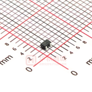

    BC807-25W - PNP SURFACE MOUNT TRANSISTOR - Diodes Incorporated
BC807-25W 数据手册
SPICE MODELS: BC807-16W BC807-25W BC807-40W BC807-16W / -25W / -40W Lead-free Green PNP SURFACE MOUNT TRANSISTOR Features · · · · · · · · · · · · Ideally Suited for Automatic Insertion Epitaxial Planar Die Construction For Switching, AF Driver and Amplifier Applications Complementary NPN Types Available (BC817-xxW) Lead Free By Design/RoHS Compliant (Note 1) "Green" Device (Note 2) Dim A C BC SOT-323 Min 0.25 1.15 2.00 0.30 1.20 1.80 0.0 0.90 0.25 0.10 0° Max 0.40 1.35 2.20 0.40 1.40 2.20 0.10 1.00 0.40 0.18 8° A B C D E G H M Mechanical Data Case: SOT-323 Case Material: Molded Plastic. "Green" Molding Compound. UL Flammability Classification Rating 94V-0 Moisture Sensitivity: Level 1 per J-STD-020C Terminals: Finish – Matte Tin annealed over Alloy 42 leadframe. Solderable per MIL-STD-202, Method 208 Pin Connections: See Diagram Marking: P/N BC807-16W BC807-25W BC807-40W Marking K5A K5B K5C K B G H E 0.65 Nominal J K L M a J D E L All Dimensions in mm · · Ordering & Date Code Information: See Page 3 Approximate Weight: 0.006 grams @TA = 25°C unless otherwise specified Symbol VCEO VEBO IC ICM IEM Pd RqJA Tj, TSTG Value -45 -5.0 -500 -1000 -1000 200 625 -65 to +150 Unit V V mA mA mA mW °C/W °C Maximum Ratings Collector-Emitter Voltage Emitter-Base Voltage Collector Current Peak Collector Current Peak Emitter Current Characteristic Power Dissipation at TSB = 50°C (Note 3) Thermal Resistance, Junction to Ambient Air (Note 3) Operating and Storage Temperature Range Electrical Characteristics DC Current Gain @TA = 25°C unless otherwise specified Symbol Min 100 160 250 60 100 170 — — — — 100 — Typ Max 250 400 600 — — — -0.7 -1.2 -100 -5.0 -100 — 12 Unit Test Condition VCE = -1.0V, IC = -100mA — VCE = -1.0V, IC = -300mA Characteristic (Note 4) Current Gain Group -16 -25 -40 Current Gain Group -16 -25 -40 hFE — Collector-Emitter Saturation Voltage Base-Emitter Voltage Collector-Emitter Cutoff Current Emitter-Base Cutoff Current Gain Bandwidth Product Collector-Base Capacitance Notes: VCE(SAT) VBE ICES IEBO fT CCBO — — — — — — V V nA µA nA MHz pF IC = -500mA, IB = -50mA VCE = -1.0V, IC = -300mA VCE = -45V VCE = -25V, Tj = 150°C VEB = -4.0V VCE = -5.0V, IC = -10mA, f = 50MHz VCB = -10V, f = 1.0MHz 1. No purposefully added lead. 2. Diodes Inc’s “Green” policy can be found on our website at http://www.diodes.com/products/lead_free/index.php. 3. Device mounted on FR-4 PCB, 1 inch x 0.85 inch x 0.062 inch; pad layout as shown on Diodes Inc. suggested pad layout document AP02001, which can be found on our website at http://www.diodes.com/datasheets/ap02001.pdf. 4. Short duration pulse test used to minimize self-heating effect. DS30577 Rev. 5 - 2 1 of 3 www.diodes.com BC807-16W / -25W / -40W ã Diodes Incorporated 400 See Note 1 1000 fT, GAIN BANDWIDTH PRODUCT (MHz) TA = 25° C f = 20MHz Pd, POWER DISSIPATION (mW) 300 -VCE = 5.0V 1.0V 200 100 100 0 0 100 TSB, SUBSTRATE TEMPERATURE (° C) Fig. 1, Power Derating Curve 200 10 1 10 100 1000 -IC, COLLECTOR CURRENT (mA) Fig. 2, Gain-Bandwidth Product vs Collector Current 1000 -VCE = 1V 150° C hFE, DC CURRENT GAIN 0.5 -VCESAT, COLLECTOR SATURATION VOLTAGE (V) typical limits at TA = 25° C 0.4 -IC / -IB = 10 25° C -50° C 100 0.3 0.2 25° C 0.1 150° C -50° C 0 0.1 1 10 100 1000 10 0.1 1 10 100 1000 -IC, COLLECTOR CURRENT (mA) Fig. 3, Collector Sat. Voltage vs Collector Current -IC, COLLECTOR CURRENT (mA) Fig. 4, DC Current Gain vs Collector Current 100 500 3.2 2.8 2.4 -IC, COLLECTOR CURRENT (mA) 400 -IC, COLLECTOR CURRENT (mA) 0.35 2 1.8 1.6 1.4 1.2 80 0.3 0.25 300 60 0.2 200 0.8 0.6 40 0.15 100 0.4 0.1 20 -IB = 0.05mA -IB = 0.2mA 0 0 1 -VCE, COLLECTOR-EMITTER VOLTAGE (V) Fig. 5, Typical Emitter-Collector Characteristics 2 0 0 10 -VCE, COLLECTOR-EMITTER VOLTAGE (V) Fig. 6, Typical Emitter-Collector Characteristics 20 DS30577 Rev. 5 - 2 2 of 3 www.diodes.com BC807-16W / -25W / -40W Ordering Information Device* BC807-xxW-7 Notes: (Note 5) Packaging SOT-323 Shipping 3000/Tape & Reel 5. For Packaging Details, go to our website at http://www.diodes.com/datasheets/ap02007.pdf. * xx = gain group, e.g. BC807-16W-7. Marking Information XXX = Product Type Marking Code (See Page 1), e.g. K5A = BC807-16 YM = Date Code Marking Y = Year ex: S = 2005 M = Month ex: 9 = September XXX Date Code Key Year Code Month Code 2004 R Jan 1 2005 S Feb 2 2006 T March 3 YM 2007 U Apr 4 May 5 2008 V Jun 6 2009 W Jul 7 Aug 8 2010 X Sep 9 2011 Y Oct O Nov N 2012 Z Dec D IMPORTANT NOTICE Diodes Incorporated and its subsidiaries reserve the right to make modifications, enhancements, improvements, corrections or other changes without further notice to any product herein. Diodes Incorporated does not assume any liability arising out of the application or use of any product described herein; neither does it convey any license under its patent rights, nor the rights of others. The user of products in such applications shall assume all risks of such use and will agree to hold Diodes Incorporated and all the companies whose products are represented on our website, harmless against all damages. LIFE SUPPORT Diodes Incorporated products are not authorized for use as critical components in life support devices or systems without the expressed written approval of the President of Diodes Incorporated. DS30577 Rev. 5 - 2 3 of 3 www.diodes.com BC807-16W / -25W / -40W
