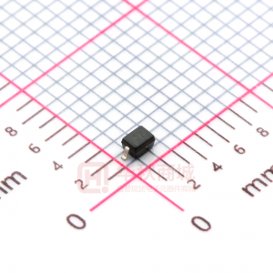

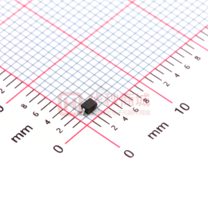

BZT52C2V0S - BZT52C39S Lead-free SURFACE MOUNT ZENER DIODE SPICE MODELS: BZT52C2V0S BZT52C2V4S BZT52C2V7S BZT52C3V0S BZT52C3V3S BZT52C3V6S BZT52C3V9S BZT52C4V3S BZT52C4V7S BZT52C5V1S BZT52C5V6S BZT52C6V2S BZT52C6V8S BZT52C7V5S BZT52C8V2S BZT52C9V1S BZT52C10S BZT52C11S BZT52C12S BZT52C13S BZT52C15S BZT52C16S BZT52C18S BZT52C20S BZT52C22S BZT52C24S BZT52C27S BZT52C30S BZT523C33S BZT52C36S BZT52C39S Features · · · · · · · · · · · · · Planar Die Construction Ultra-Small Surface Mount Package Ideally suited for Automated Assembly Processes Lead Free/RoHS Compliant (Note 3) Qualified to AEC-Q101 Standards for High Reliability Dim A H G A B D SOD-323 Min 2.30 1.60 1.20 0.25 0.20 0.10 0° Max 2.70 1.80 1.40 0.35 0.40 0.15 8° Mechanical Data Case: SOD-323 Case Material: Molded Plastic. UL Flammability Classification Rating 94V-0 Moisture Sensitivity: Level 1 per J-STD-020C Terminals: Solderable per MIL-STD-202, Method 208 Lead Free Plating (Matte Tin Finish annealed over Alloy 42 leadframe). Polarity: Cathode Band Marking: See Sheet 2 Weight: 0.004 grams (approximate) C E J B C D E G H J a 1.05 Typical 0.05 Typical All Dimensions in mm Maximum Ratings Forward Voltage (Note 2) Power Dissipation (Note 1) @ TA = 25°C unless otherwise specified Symbol @ IF = 10mA VF Pd RqJA Tj, TSTG Value 0.9 200 625 -65 to +150 Unit V mW °C/W °C Characteristic Thermal Resistance, Junction to Ambient Air (Note 1) Operating and Storage Temperature Range Notes: 1. Part mounted on FR-4 PC board with recommended pad layout, as per http://www.diodes.com/datasheets/ap02001.pdf. 2. Short duration test pulse used in minimize self-heating effect. 3. No purposefully added lead. DS30093 Rev. 13 - 2 1 of 3 www.diodes.com BZT52C2V0S - BZT52C39S ã Diodes Incorporated Electrical Characteristics @ TA = 25°C unless otherwise specified Maximum Reverse Current (Note 2) IR uA 150 50 20 10 5 5 3 3 3 2 1 3 2 1 0.7 0.5 0.2 0.1 0.1 0.1 0.1 0.1 0.1 0.1 0.1 0.1 0.1 0.1 0.1 0.1 0.1 VR V 1.0 1.0 1.0 1.0 1.0 1.0 1.0 1.0 2.0 2.0 2.0 4.0 4.0 5.0 5.0 6.0 7.0 8.0 8.0 8.0 10.5 11.2 12.6 14.0 15.4 16.8 18.9 21.0 23.1 25.2 27.3 Temperature Coefficient of Zener Voltage @ IZT = 5mA mV/°C Min -3.5 -3.5 -3.5 -3.5 -3.5 -3.5 -3.5 -3.5 -3.5 -2.7 -2.0 0.4 1.2 2.5 3.2 3.8 4.5 5.4 6.0 7.0 9.2 10.4 12.4 14.4 16.4 18.4 21.4 24.4 27.4 30.4 33.4 Max 0 0 0 0 0 0 0 0 0.2 1.2 2.5 3.7 4.5 5.3 6.2 7.0 8.0 9.0 10.0 11.0 13.0 14.0 16.0 18.0 20.0 22.0 25.3 29.4 33.4 37.4 41.2 Type Number Marking Code Zener Voltage Range (Note 2) VZ @ IZT Nom (V) Min (V) 1.91 2.20 2.5 2.8 3.1 3.4 3.7 4.0 4.4 4.8 5.2 5.8 6.4 7.0 7.7 8.5 9.4 10.4 11.4 12.4 13.8 15.3 16.8 18.8 20.8 22.8 25.1 28.0 31.0 34.0 37.0 Max (V) 2.09 2.60 2.9 3.2 3.5 3.8 4.1 4.6 5.0 5.4 6.0 6.6 7.2 7.9 8.7 9.6 10.6 11.6 12.7 14.1 15.6 17.1 19.1 21.2 23.3 25.6 28.9 32.0 35.0 38.0 41.0 2.0 2.4 2.7 3.0 3.3 3.6 3.9 4.3 4.7 5.1 5.6 6.2 6.8 7.5 8.2 9.1 10 11 12 13 15 16 18 20 22 24 27 30 33 36 39 IZT (mA) 5 5 5 5 5 5 5 5 5 5 5 5 5 5 5 5 5 5 5 5 5 5 5 5 5 5 2 2 2 2 2 Maximum Zener Impedance (Note 4) ZZT @ IZT W 100 100 100 95 95 90 90 90 80 60 40 10 15 15 15 15 20 20 25 30 30 40 45 55 55 70 80 80 80 90 130 600 600 600 600 600 600 600 600 500 480 400 150 80 80 80 100 150 150 150 170 200 200 225 225 250 250 300 300 325 350 350 ZZK @ IZK IZK mA 1.0 1.0 1.0 1.0 1.0 1.0 1.0 1.0 1.0 1.0 1.0 1.0 1.0 1.0 1.0 1.0 1.0 1.0 1.0 1.0 1.0 1.0 1.0 1.0 1.0 1.0 0.5 0.5 0.5 0.5 0.5 BZT52C2V0S BZT52C2V4S BZT52C2V7S BZT52C3V0S BZT52C3V3S BZT52C3V6S BZT52C3V9S BZT52C4V3S BZT52C4V7S BZT52C5V1S BZT52C5V6S BZT52C6V2S BZT52C6V8S BZT52C7V5S BZT52C8V2S BZT52C9V1S BZT52C10S BZT52C11S BZT52C12S BZT52C13S BZT52C15S BZT52C16S BZT52C18S BZT52C20S BZT52C22S BZT52C24S BZT52C27S BZT52C30S BZT52C33S BZT52C36S BZT52C39S Notes: WY, WY WX, WX W1, W1 W2, W2 W3, W3 W4, W4 W5, W5 W6, W6 W7, W7 W8, W8 W9, W9 WA, WA WB, WB WC, WC, BF WD, WD WE, WE WF, WF WG, WG WH, WH WI, WI WJ, WJ WK, WK WL, WL WM, WM WN, WN WO, WO WP, WP WQ, WQ WR, WR WS, WS WT, WT 2. Short duration test pulse used to minimize self-heating effect. 3. No purposefully added lead. 4. f = 1kHz. Ordering Information Device (Note 5) Packaging SOD-323 Shipping 3000/Tape & Reel (Type Number)-7-F Notes: 5. *Add “-7-F” to the appropriate type number in Table 1 above example: 6.2V Zener = BZT52C6V2S-7-F. 6. For Packaging Details, go to our website at: http://www.diodes.com/datasheets/ap02007.pdf. Marking Information XX DS30093 Rev. 13 - 2 XX = Product Type Marking Code (See Table Above) 2 of 3 www.diodes.com BZT52C2V0S - BZT52C39S 300 50 Tj = 25°C C2V7 C3V9 C5V6 C6V8 C3V3 C4V7 PD, POWER DISSIPATION (mW) 40 IZ, ZENER CURRENT (mA) C8V2 200 30 20 100 10 Test Current IZ 5.0mA 0 0 100 TA, AMBIENT TEMPERATURE, °C Fig. 1. Power Derating Curve 200 0 0 1 3 4 5 6 8 9 7 VZ, ZENER VOLTAGE (V) Fig. 2 Zener Breakdown Characteristics 2 10 30 Tj = 25°C 1000 C10 C12 Tj = 25 °C IZ, ZENER CURRENT (mA) CT, TOTAL CAPACITANCE (pF) VR = 1V VR = 2V 20 C15 100 VR = 1V C18 10 Test current IZ 5mA C22 C27 C33 C39 C36 VR = 2V 10 1 10 100 0 0 10 20 30 VZ, ZENER VOLTAGE (V) Fig. 3. Zener Breakdown Characteristics 40 VZ, NOMINAL ZENER VOLTAGE (V) Fig. 4 Total Capacitance vs Nominal Zener Voltage IMPORTANT NOTICE Diodes Incorporated and its subsidiaries reserve the right to make modifications, enhancements, improvements, corrections or other changes without further notice to any product herein. Diodes Incorporated does not assume any liability arising out of the application or use of any product described herein; neither does it convey any license under its patent rights, nor the rights of others. The user of products in such applications shall assume all risks of such use and will agree to hold Diodes Incorporated and all the companies whose products are represented on our website, harmless against all damages. LIFE SUPPORT Diodes Incorporated products are not authorized for use as critical components in life support devices or systems without the expressed written approval of the President of Diodes Incorporated. DS30093 Rev. 13 - 2 3 of 3 www.diodes.com BZT52C2V0S - BZT52C39S
