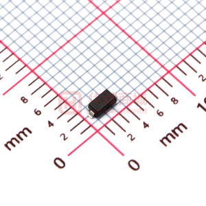

BZT52C2V0 - BZT52C39 SURFACE MOUNT ZENER DIODE Please click here to visit our online spice models database. Features • • • • • • Planar Die Construction 500mW Power Dissipation on Ceramic PCB General Purpose, Medium Current Ideally Suited for Automated Assembly Processes Lead, Halogen and Antimony Free, RoHS Compliant "Green" Device (Notes 2 and 3) Qualified to AEC-Q101 Standards for High Reliability Mechanical Data • • • • • • • • • Case: SOD-123 Case Material: Molded Plastic. UL Flammability Classification Rating 94V-0 Moisture Sensitivity: Level 1 per J-STD-020D Terminals: Solderable per MIL-STD-202, Method 208 Lead Free Plating (Matte Tin Finish annealed over Alloy 42 leadframe) Polarity: Cathode Band Marking Information: See Page 3 Ordering Information: See Page 3 Weight: 0.010 grams (approximate) Top View Maximum Ratings @TA = 25°C unless otherwise specified Single phase, half wave, 60Hz, resistive or inductive load. For capacitance load, derate current by 20%. Characteristic Forward Voltage @ IF = 10mA Symbol VF Value 0.9 Unit V Thermal Characteristics Characteristic Power Dissipation (Note 1) Thermal Resistance, Junction to Ambient Air (Note 1) Operating and Storage Temperature Range Notes: Symbol PD RθJA TJ, TSTG 2 Value 500 250 -65 to +150 Unit mW °C/W °C 1. Device mounted on ceramic PCB; 7.6mm x 9.4mm x 0.87mm with pad areas 25mm . 2. No purposefully added lead. Halogen and Antimony Free. 3. Product manufactured with Data Code V9 (week 33, 2008) and newer are built with Green Molding Compound. Product manufactured prior to Date Code V9 are built with Non-Green Molding Compound and may contain Halogens or Sb2O3 Fire Retardants. BZT52C2V0 - BZT52C39 Document number: DS18004 Rev. 32 - 2 1 of 4 www.diodes.com June 2008 © Diodes Incorporated BZT52C2V0 - BZT52C39 Electrical Characteristics Type Number (Note 4) @TA = 25°C unless otherwise specified Maximum Zener Impedance (Note 4) IZT mA 5 5 5 5 5 5 5 5 5 5 5 5 5 5 5 5 5 5 5 5 5 5 5 5 5 5 2 2 2 2 2 100 100 100 95 95 90 90 90 80 60 40 10 15 15 15 15 20 20 25 30 30 40 45 55 55 70 80 80 80 90 130 ZZT @ IZT Ω 600 600 600 600 600 600 600 600 500 480 400 150 80 80 80 100 150 150 150 170 200 200 225 225 250 250 300 300 325 350 350 ZZK @ IZK IZK mA 1.0 1.0 1.0 1.0 1.0 1.0 1.0 1.0 1.0 1.0 1.0 1.0 1.0 1.0 1.0 1.0 1.0 1.0 1.0 1.0 1.0 1.0 1.0 1.0 1.0 1.0 0.5 0.5 0.5 0.5 0.5 Maximum Reverse Current (Note 5) IR @ VR uA 150 50 20 10 5.0 5.0 3.0 3.0 3.0 2.0 1.0 3.0 2.0 1.0 0.7 0.5 0.2 0.1 0.1 0.1 0.1 0.1 0.1 0.1 0.1 0.1 0.1 0.1 0.1 0.1 0.1 V 1.0 1.0 1.0 1.0 1.0 1.0 1.0 1.0 2.0 2.0 2.0 4.0 4.0 5.0 5.0 6.0 7.0 8.0 8.0 8.0 10.5 11.2 12.6 14.0 15.4 16.8 18.9 21.0 23.1 25.2 27.3 Typical Temperature Coefficient @ IZTC mV/°C Min -3.5 -3.5 -3.5 -3.5 -3.5 -3.5 -3.5 -3.5 -3.5 -2.7 -2 0.4 1.2 2.5 3.2 3.8 4.5 5.4 6.0 7.0 9.2 10.4 12.4 14.4 16.4 18.4 21.4 24.4 27.4 30.4 33.4 Max 0 0 0 0 0 0 0 0 0.2 1.2 2.5 3.7 4.5 5.3 6.2 7.0 8.0 9.0 10.0 11.0 13.0 14.0 16.0 18.0 20.0 22.0 25.3 29.4 33.4 37.4 41.2 Test Current IZTC mA 5 5 5 5 5 5 5 5 5 5 5 5 5 5 5 5 5 5 5 5 5 5 5 5 5 5 2 2 2 2 2 Marking Codes Zener Voltage Range (Note 5) VZ @ IZT Nom (V) 2.0 2.4 2.7 3.0 3.3 3.6 3.9 4.3 4.7 5.1 5.6 6.2 6.8 7.5 8.2 9.1 10 11 12 13 15 16 18 20 22 24 27 30 33 36 39 Min (V) Max (V) 1.91 2.2 2.5 2.8 3.1 3.4 3.7 4.0 4.4 4.8 5.2 5.8 6.4 7.0 7.7 8.5 9.4 10.4 11.4 12.4 13.8 15.3 16.8 18.8 20.8 22.8 25.1 28.0 31.0 34.0 37.0 2.09 2.6 2.9 3.2 3.5 3.8 4.1 4.6 5.0 5.4 6.0 6.6 7.2 7.9 8.7 9.6 10.6 11.6 12.7 14.1 15.6 17.1 19.1 21.2 23.3 25.6 28.9 32.0 35.0 38.0 41.0 BZT52C2V0 BZT52C2V4 BZT52C2V7 BZT52C3V0 BZT52C3V3 BZT52C3V6 BZT52C3V9 BZT52C4V3 BZT52C4V7 BZT52C5V1 BZT52C5V6 BZT52C6V2 BZT52C6V8 BZT52C7V5 BZT52C8V2 BZT52C9V1 BZT52C10 BZT52C11 BZT52C12 BZT52C13 BZT52C15 BZT52C16 BZT52C18 BZT52C20 BZT52C22 BZT52C24 BZT52C27 BZT52C30 BZT52C33 BZT52C36 BZT52C39 Notes: WY WX W1 W2 W3 W4 W5 W6, UB W7 W8 W9 WA WB WC WD WE WF WG WH WI WJ WK WL WM WN WO WP WQ WR WS WT 4. f = 1kHz. 5. Short duration pulse test used to minimize self-heating effect. 0.6 Note 1 50 0.5 PD, POWER DISSIPATION (W) 40 IZ, ZENER CURRENT (mA) 0.4 30 0.3 20 0.2 0.1 10 0 0 75 25 50 100 125 TA, AMBIENT TEMPERATURE (°C) Fig. 1 Power Derating Curve 150 0 0 3 4 5 6 8 9 10 7 VZ, ZENER VOLTAGE (V) Fig. 2 Typical Zener Breakdown Characteristics 1 2 BZT52C2V0 - BZT52C39 Document number: DS18004 Rev. 32 - 2 2 of 4 www.diodes.com June 2008 © Diodes Incorporated BZT52C2V0 - BZT52C39 30 TJ = 25°C C10 C12 10 IZ, ZENER CURRENT (mA) 20 C15 IZ, ZENER CURRENT (mA) 8 6 C18 Test Current IZ 2mA 10 Test Current IZ 5mA C22 C27 C33 C36 4 2 0 0 10 20 30 40 VZ, ZENER VOLTAGE (V) Fig. 3 Typical Zener Breakdown Characteristics 0 0 30 40 50 60 70 80 90 100 VZ, ZENER VOLTAGE (V) Fig. 4 Typical Zener Breakdown Characteristics 10 20 1,000 TJ = 25 °C f = 1MHz CT, TOTAL CAPACITANCE (pF) VR = 1V VR = 2V 100 VR = 1V VR = 2V 10 100 10 VZ, NOMINAL ZENER VOLTAGE (V) Fig. 5 Typical Total Capacitance vs. Nominal Zener Voltage 1 Ordering Information (Note 6) Case SOD-123 SOD-123 Packaging 3000/Tape & Reel 10,000/Tape & Reel Part Number (Type Number)-7-F (Note 7) (Type Number)-13-F (Note 8) Notes: 6. For packaging details, go to our website at http://www.diodes.com/datasheets/ap02007.pdf. 7. Add “-7-F” to the appropriate type number in Electrical Characteristics Table, example: 6.2V Zener = BZT52C6V2-7-F. 8. Add “-13-F” to the appropriate type number in Electrical Characteristics Table, example: 20V Zener = BZT52C20-13-F. Marking Information xx Date Code Key Year 1998 Code Month Code J Jan 1 xx = Product Type Marking Code (See Electrical Characteristics Table) YM = Date Code Marking Y = Year (ex: N = 2002) M = Month (ex: 9 = September) 2004 R Jun 6 3 of 4 www.diodes.com 2005 S Jul 7 2006 T 2007 U Aug 8 2008 V Sep 9 2009 W Oct O 2010 X Nov N 2011 Y 2012 Z Dec D June 2008 © Diodes Incorporated 1999 K Feb 2 2000 L 2001 M Mar 3 2002 N Apr 4 2003 P May 5 BZT52C2V0 - BZT52C39 Document number: DS18004 Rev. 32 - 2 YM BZT52C2V0 - BZT52C39 Package Outline Dimensions C H B A M L K SOD-123 Dim Min Max A 0.55 Typ B 1.40 1.70 C 3.55 3.85 H 2.55 2.85 J 0.00 0.10 K 1.00 1.35 L 0.25 0.40 M 0.10 0.15 0 8° α All Dimensions in mm Suggested Pad Layout C X Dimensions Value (in mm) Z 4.9 G 2.5 X 0.7 Y 1.2 C 3.7 Y G Z IMPORTANT NOTICE Diodes Incorporated and its subsidiaries reserve the right to make modifications, enhancements, improvements, corrections or other changes without further notice to any product herein. Diodes Incorporated does not assume any liability arising out of the application or use of any product described herein; neither does it convey any license under its patent rights, nor the rights of others. The user of products in such applications shall assume all risks of such use and will agree to hold Diodes Incorporated and all the companies whose products are represented on our website, harmless against all damages. LIFE SUPPORT Diodes Incorporated products are not authorized for use as critical components in life support devices or systems without the expressed written approval of the President of Diodes Incorporated. BZT52C2V0 - BZT52C39 Document number: DS18004 Rev. 32 - 2 4 of 4 www.diodes.com June 2008 © Diodes Incorporated
