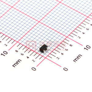

    BZX84C22 - 350mW SURFACE MOUNT ZENER DIODE - Diodes Incorporated
BZX84C22 数据手册
BZX84C2V4 - BZX84C39 350mW SURFACE MOUNT ZENER DIODE Please click here to visit our online spice models database. Features • • • • • • Planar Die Construction 350mW Power Dissipation Zener Voltages from 2.4V - 39V Ideally Suited for Automated Assembly Processes Lead, Halogen and Antimony Free, RoHS Compliant "Green" Device (Notes 3 and 4) Qualified to AEC-Q101 Standards for High Reliability Mechanical Data • • • • • • • • Case: SOT-23 Case Material: Molded Plastic. UL Flammability Classification Rating 94V-0 Moisture Sensitivity: Level 1 per J-STD-020 Terminals: Matte Tin Finish annealed over Alloy 42 leadframe (Lead Free Plating). Solderable per MIL-STD-202, Method 208 Polarity: See Diagram Marking Information: See Page 3 Ordering Information: See Page 3 Weight: 0.008 grams (approximate) Top View Device Schematic Maximum Ratings Forward Voltage @TA = 25°C unless otherwise specified @ IF = 10mA Symbol VF Value 0.9 Unit V Characteristic Thermal Characteristics Characteristic Power Dissipation (Note 1) Power Dissipation (Note 2) Thermal Resistance, Junction to Ambient Air Thermal Resistance, Junction to Ambient Air Operating and Storage Temperature Range Notes: (Note 1) (Note 2) Symbol PD PD RθJA RθJA TJ, TSTG Value 300 350 417 357 -65 to +150 Unit mW mW °C/W °C/W °C 1. Device mounted on FR-4 PC board with recommended pad layout, which can be found on our website at http://www.diodes.com/datasheets/ap02001.pdf. 2. Valid provided the terminals are kept at ambient temperature. 3. No purposefully added lead. Halogen and Antimony Free. 4. Product manufactured with Data Code OW (week 42, 2009) and newer are built with Green Molding Compound. Product manufactured prior to Date Code OW are built with Non-Green Molding Compound and may contain Halogens or Sb2O3 Fire Retardants. BZX84C2V4 - BZX84C39 Document number: DS18001 Rev. 28 - 2 1 of 4 www.diodes.com April 2010 © Diodes Incorporated BZX84C2V4 - BZX84C39 Electrical Characteristics @TA = 25°C unless otherwise specified Zener Voltage Range (Note 5) VZ @ IZT IZT Max (V) 2.6 2.9 3.2 3.5 3.8 4.1 4.6 5.0 5.4 6.0 6.6 7.2 7.9 8.7 9.6 10.6 11.6 12.7 14.1 15.6 17.1 19.1 21.2 23.3 25.6 28.9 32.0 35.0 38.0 41.0 (mA) 5.0 5.0 5.0 5.0 5.0 5.0 5.0 5.0 5.0 5.0 5.0 5.0 5.0 5.0 5.0 5.0 5.0 5.0 5.0 5.0 5.0 5.0 5.0 5.0 5.0 2.0 2.0 2.0 2.0 2.0 Maximum Zener Impedance (Note 6) ZZT @ IZT (Ω) 100 100 95 95 90 90 90 80 60 40 10 15 15 15 15 20 20 25 30 30 40 45 55 55 70 80 80 80 90 130 ZZK @ IZK (Ω) 600 600 600 600 600 600 600 500 480 400 150 80 80 80 100 150 150 150 170 200 200 225 225 250 250 300 300 325 350 350 (mA) 1.0 1.0 1.0 1.0 1.0 1.0 1.0 1.0 1.0 1.0 1.0 1.0 1.0 1.0 1.0 1.0 1.0 1.0 1.0 1.0 1.0 1.0 1.0 1.0 1.0 0.5 0.5 0.5 0.5 0.5 Maximum Reverse Current (Note 5) IR (μA) 50 20 10 5.0 5.0 3.0 3.0 3.0 2.0 1.0 3.0 2.0 1.0 0.7 0.5 0.2 0.1 0.1 0.1 0.1 0.1 0.1 0.1 0.1 0.1 0.1 0.1 0.1 0.1 0.1 VR (V) 1.0 1.0 1.0 1.0 1.0 1.0 1.0 2.0 2.0 2.0 4.0 4.0 5.0 5.0 6.0 7.0 8.0 8.0 8.0 10.5 11.2 12.6 14.0 15.4 16.8 18.9 21.0 23.1 25.2 27.3 Typical Temperature Coefficient @ IZT mV/°C Min -3.5 -3.5 -3.5 -3.5 -3.5 -3.5 -3.5 -3.5 -2.7 -2.0 0.4 1.2 2.5 3.2 3.8 4.5 5.4 6.0 7.0 9.2 10.4 12.4 14.4 16.4 18.4 21.4 24.4 27.4 30.4 33.4 Max 0 0 0 0 0 0 0 0.2 1.2 2.5 3.7 4.5 5.3 6.2 7.0 8.0 9.0 10.0 11.0 13.0 14.0 16.0 18.0 20.0 22.0 25.3 29.4 33.4 37.4 41.2 Type Number Marking Code BZX84C2V4 BZX84C2V7 BZX84C3V0 BZX84C3V3 BZX84C3V6 BZX84C3V9 BZX84C4V3 BZX84C4V7 BZX84C5V1 BZX84C5V6 BZX84C6V2 BZX84C6V8 BZX84C7V5 BZX84C8V2 BZX84C9V1 BZX84C10 BZX84C11 BZX84C12 BZX84C13 BZX84C15 BZX84C16 BZX84C18 BZX84C20 BZX84C22 BZX84C24 BZX84C27 BZX84C30 BZX84C33 BZX84C36 BZX84C39 Notes: KZB KZC KZD KZE KZF KZG KZH KZ1 KZ2 KZ3 KZ4 KZ5 KZ6 KZ7 KZ8 KZ9 KY1 KY2 KY3 KY4 KY5 KY6 KY7 KY8 KY9 KYA KYB KYC KYD KYE Nom (V) 2.4 2.7 3.0 3.3 3.6 3.9 4.3 4.7 5.1 5.6 6.2 6.8 7.5 8.2 9.1 10 11 12 13 15 16 18 20 22 24 27 30 33 36 39 Min (V) 2.2 2.5 2.8 3.1 3.4 3.7 4.0 4.4 4.8 5.2 5.8 6.4 7.0 7.7 8.5 9.4 10.4 11.4 12.4 13.8 15.3 16.8 18.8 20.8 22.8 25.1 28.0 31.0 34.0 37.0 5. Short duration pulse test used to minimize self-heating effect. 6. f = 1KHz. 500 50 PD, POWER DISSIPATION (mW) 400 IZ, ZENER CURRENT (mA) 40 300 Note 1 Note 3 30 200 20 100 10 0 0 100 TA, Ambient Temperature, (°C) Fig. 1 Power Derating Curve 200 0 0 3 4 5 6 8 9 10 7 VZ, ZENER VOLTAGE (V) Fig. 2 Typical Zener Breakdown Characteristics 1 2 BZX84C2V4 - BZX84C39 Document number: DS18001 Rev. 28 - 2 2 of 4 www.diodes.com April 2010 © Diodes Incorporated BZX84C2V4 - BZX84C39 30 T j = 25°C C10 C12 1,000 TJ = 25°C CT, TOTAL CAPACITANCE (pF) VR = 1V VR = 2V IZ, ZENER CURRENT (mA) 20 C15 C18 Test current IZ 2mA 100 V R = 1V 10 Test current IZ 5mA C22 C27 C33 C36 C39 VR = 2V 0 0 10 20 30 40 VZ, ZENER VOLTAGE (V) Fig. 3 Typical Zener Breakdown Characteristics 100 10 VZ, NOMINAL ZENER VOLTAGE (V) Fig. 4 Typical Total Capacitance vs. Nominal Zener Voltage 10 1 Ordering Information (Note 7) Part Number (Type Number)-7-F (Note 8) (Type Number)-13-F (Note 9) Notes: Case SOT-23 SOT-23 Packaging 3,000/Tape & Reel 10,000/Tape & Reel 7. For packaging details, go to our website at http://www.diodes.com/datasheets/ap02007.pdf. 8. Add “-7-F” to the appropriate type number in Electrical Characteristics Table on Page 2. Example: 6.2V Zener = BZX84C6V2-7-F. 9. Add “-13-F” to the appropriate type number in Electrical Characteristics Table on Page 2. Example: 2.7V Zener = BZX84C2V7-13-F. Please note: Not all voltages are available in 13” reel size. Please contact the Diodes Inc. Sales Department for assistance in ordering 13” reel size devices. Marking Information xxx = Product Type Marking Code (See Electrical Characteristics Table) YM = Date Code Marking Y = Year (ex: N = 2002) M = Month (ex: 9 = September) 2006 T Jun 6 2007 U Jul 7 2008 V 2009 W Aug 8 2010 X Sep 9 2011 Y 2012 Z Oct O 2013 A Nov N 2014 B 2015 C Dec D xxx Date Code Key Year 1998 Code J Month Code Jan 1 1999 K 2000 L Feb 2 2001 M Mar 3 2002 N 2003 P Apr 4 2004 2005 R S May 5 Package Outline Dimensions A YM BC H K D J F G L M K1 SOT-23 Dim Min Max Typ A 0.37 0.51 0.40 B 1.20 1.40 1.30 C 2.30 2.50 2.40 D 0.89 1.03 0.915 F 0.45 0.60 0.535 G 1.78 2.05 1.83 H 2.80 3.00 2.90 J 0.013 0.10 0.05 K 0.903 1.10 1.00 K1 0.400 L 0.45 0.61 0.55 M 0.085 0.18 0.11 0° 8° α All Dimensions in mm April 2010 © Diodes Incorporated BZX84C2V4 - BZX84C39 Document number: DS18001 Rev. 28 - 2 3 of 4 www.diodes.com BZX84C2V4 - BZX84C39 Suggested Pad Layout Y Z C Dimensions Value (in mm) Z 2.9 X 0.8 Y 0.9 C 2.0 E 1.35 X E IMPORTANT NOTICE DIODES INCORPORATED MAKES NO WARRANTY OF ANY KIND, EXPRESS OR IMPLIED, WITH REGARDS TO THIS DOCUMENT, INCLUDING, BUT NOT LIMITED TO, THE IMPLIED WARRANTIES OF MERCHANTABILITY AND FITNESS FOR A PARTICULAR PURPOSE (AND THEIR EQUIVALENTS UNDER THE LAWS OF ANY JURISDICTION). Diodes Incorporated and its subsidiaries reserve the right to make modifications, enhancements, improvements, corrections or other changes without further notice to this document and any product described herein. Diodes Incorporated does not assume any liability arising out of the application or use of this document or any product described herein; neither does Diodes Incorporated convey any license under its patent or trademark rights, nor the rights of others. Any Customer or user of this document or products described herein in such applications shall assume all risks of such use and will agree to hold Diodes Incorporated and all the companies whose products are represented on Diodes Incorporated website, harmless against all damages. Diodes Incorporated does not warrant or accept any liability whatsoever in respect of any products purchased through unauthorized sales channel. Should Customers purchase or use Diodes Incorporated products for any unintended or unauthorized application, Customers shall indemnify and hold Diodes Incorporated and its representatives harmless against all claims, damages, expenses, and attorney fees arising out of, directly or indirectly, any claim of personal injury or death associated with such unintended or unauthorized application. Products described herein may be covered by one or more United States, international or foreign patents pending. Product names and markings noted herein may also be covered by one or more United States, international or foreign trademarks. LIFE SUPPORT Diodes Incorporated products are specifically not authorized for use as critical components in life support devices or systems without the express written approval of the Chief Executive Officer of Diodes Incorporated. As used herein: A. Life support devices or systems are devices or systems which: 1. are intended to implant into the body, or 2. support or sustain life and whose failure to perform when properly used in accordance with instructions for use provided in the labeling can be reasonably expected to result in significant injury to the user. B. A critical component is any component in a life support device or system whose failure to perform can be reasonably expected to cause the failure of the life support device or to affect its safety or effectiveness. Customers represent that they have all necessary expertise in the safety and regulatory ramifications of their life support devices or systems, and acknowledge and agree that they are solely responsible for all legal, regulatory and safety-related requirements concerning their products and any use of Diodes Incorporated products in such safety-critical, life support devices or systems, notwithstanding any devices- or systems-related information or support that may be provided by Diodes Incorporated. Further, Customers must fully indemnify Diodes Incorporated and its representatives against any damages arising out of the use of Diodes Incorporated products in such safety-critical, life support devices or systems. Copyright © 2010, Diodes Incorporated www.diodes.com BZX84C2V4 - BZX84C39 Document number: DS18001 Rev. 28 - 2 4 of 4 www.diodes.com April 2010 © Diodes Incorporated
