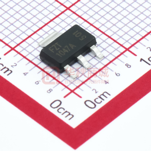

SOT223 NPN SILICON PLANAR MEDIUM POWER HIGH GAIN TRANSISTOR ISSUE 1 - AUGUST 1997 FEATURES * * * * * * VCEO = 10V 5 Amp Continuous Current 20 Amp Pulse Current Low Saturation Voltage High Gain Extremely Low Equivalent On-resistance; RCE(sat) = 44mΩ at 5A FZT1047A C E C B SOT223 ABSOLUTE MAXIMUM RATINGS. PARAMETER Collector-Base Voltage Collector-Emitter Voltage Emitter-Base Voltage Peak Pulse Current Continuous Collector Current Base Current Power Dissipation at T amb=25°C Operating and Storage Temperature Range SYMBOL V CBO V CEO V EBO I CM IC IB P tot T j:T stg VALUE 35 10 5 20 5 500 2.5 -55 to +150 UNIT V V V A A mA W °C FZT1047A ELECTRICAL CHARACTERISTICS (at Tamb = 25°C unless otherwise stated). VALUE PARAMETER Collector-Base Breakdown Voltage Collector-Emitter Breakdown Voltage Collector-Emitter Breakdown Voltage Collector-Emitter Breakdown Voltage SYMBOL MIN. V(BR)CBO VCES VCEO VCEV 35 35 10 35 5 TYP. 65 55 16 60 8.9 0.3 0.3 0.3 25 50 140 220 925 890 280 290 300 200 60 430 440 450 330 110 150 85 130 230 110 10 10 10 40 70 200 350 1000 975 MAX. UNIT V V V V V nA nA nA mV mV mV mV mV mV CONDITIONS. IC=100µA IC=100µA IC=10mA IC=100µA, VEB=1V IE=100µA VCB=20V VEB=4V VCES=20V IC=0.5A, IB=10mA* IC=1A, IB=10mA* IC=3A, IB=15mA* IC=5A, IB=25mA* IC=5A, IB=25mA* IC=5A, VCE=2V* IC=10mA, VCE=2V* IC=0.5A, VCE=2V* IC=1A, VCE=2V* IC=5A, VCE=2V* IC=20A, VCE=2V* Emitter-Base Breakdown V(BR)EBO Voltage Collector Cut-Off Current Emitter Cut-Off Current Collector Emitter Cut-Off Current Collector-Emitter Saturation Voltage ICBO IEBO ICES VCE(sat) Base-Emitter Saturation Voltage Base-Emitter Turn-On Voltage Static Forward Current Transfer Ratio VBE(sat) VBE(on) hFE 1200 Transition Frequency Output Capacitance Switching Times fT Cobo ton toff MHz pF ns ns IC=50mA, VCE=10V f=50MHz VCB=10V, f=1MHz IC=4A, IB=40mA, VCC=10V IC=4A, IB=±40mA, VCC=10V *Measured under pulsed conditions. Pulse width=300µs. Duty cycle ≤ 2% FZT1047A TYPICAL CHARACTERISTICS 1 +25°C IC/IB=100 0.6 0.8 VCE(sat) - (V) 0.6 0.4 0.2 0 1m 10m 100m 1 10 100 IC/IB=200 IC/IB=100 IC/IB=50 VCE(sat) - (V) 0.4 +150°C +50°C +25°C -55°C 0.2 0 1m IC - Collector Current (A) VCE(sat) v IC 10m IC - 100m 1 10 100 Collector Current (A) VCE(sat) v IC 600 VCE=2V +100°C +25°C -55°C 1.2 1 IC/IB=100 hFE - Typical Gain 500 400 300 200 100 0 1m 10m IC 100m 1 10 VBE(sat) - (V) 0.8 0.6 0.4 0.2 0 -55°C +25°C +100°C +150°C 100 1m 10m 100m 1 10 100 Collector Current (A) hFE v IC IC - Collector Current (A) VBE(sat) v IC 1.5 1.2 100 IC - Collector Current (A) VCE=2V VBE(on) - (V) 10 DC 1s 100ms 10ms 1ms 100us 0.9 0.6 0.3 0 -55°C +25°C +100°C +150°C 1 1m 10m 100m 1 10 100 100m 100m 1 10 100 IC - Collector Current (A) VBE(on) v IC VCE - Collector Emitter Voltage (V) Safe Operating Area FZT1047A SPICE PARAMETERS *ZETEX * .MODEL + + + + * FZT1047A Spice model Last revision 18/03/97 FZT1047A NPN IS=9.73E-13 NF=1.0 BF=550 IKF=8.0 VAF=120 ISE=2.6E-13 NE=1.38 NR=1.0 BR=400 IKR=5 VAR=15 ISC=8E-13 NC=1.4 RB=0.1 RE=0.017 RC=0.010 CJC=195.4E-12 CJE=540.4E-12 MJC=0.257 MJE=0.359 VJC=0.390 VJE=0.753 TF=450E-12 TR=1.2E-9 © 1997 ZETEX PLC The copyright in this model and the design embodied belong to Zetex PLC (“Zetex”). It is supplied free of charge by Zetex for the purpose of research and design and may be used or copied intact (including this notice) for that purpose only. All other rights are reserved. The model is believed accurate but no condition or warranty as to its merchantability or fitness for purpose is given and no liability in respect of any use is accepted by Zetex PLC, its distributors or agents. Zetex plc. Fields New Road, Chadderton, Oldham, OL9-8NP, United Kingdom. Telephone: (44)161-627 5105 (Sales), (44)161-627 4963 (General Enquiries) Fax: (44)161-627 5467 Zetex GmbH Streitfeldstraße 19 D-81673 München Germany Telefon: (49) 89 45 49 49 0 Fax: (49) 89 45 49 49 49 Zetex Inc. 47 Mall Drive, Unit 4 Commack NY 11725 USA Telephone: (516) 543-7100 Fax: (516) 864-7630 Zetex (Asia) Ltd. 3510 Metroplaza, Tower 2 Hing Fong Road, Kwai Fong, Hong Kong Telephone:(852) 26100 611 Fax: (852) 24250 494 These are supported by agents and distributors in major countries world-wide ©Zetex plc 1997 Internet: http://www.zetex.com This publication is issued to provide outline information only which (unless agreed by the Company in writing) may not be used, applied or reproduced for any purpose or form part of any order or contract or be regarded as a representation relating to the products or services concerned. The Company reserves the right to alter without notice the specification, design, price or conditions of supply of any product or service.
