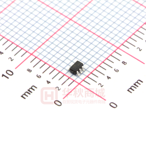

MMDT3904 DUAL NPN SMALL SIGNAL SURFACE MOUNT TRANSISTOR Features · · · · · · · · · · · Epitaxial Planar Die Construction Ideal for Low Power Amplification and Switching Ultra-Small Surface Mount Package A C2 B1 E1 SOT-363 Dim BC Min 0.10 1.15 2.00 0.30 1.80 ¾ 0.90 0.25 0.10 0° Max 0.30 1.35 2.20 0.40 2.20 0.10 1.00 0.40 0.25 8° A B C D M Mechanical Data Case: SOT-363, Molded Plastic Case Material - UL Flammability Rating Classification 94V-0 Moisture sensitivity: Level 1 per J-STD-020A Terminals: Solderable per MIL-STD-202, Method 208 Terminal Connections: See Diagram Marking (See Page 2): K6N Ordering & Date Code Information: See Page 2 Weight: 0.006 grams (approx.) K E2 B2 C1 G H 0.65 Nominal F H J K L M a J D F L C2 B1 E1 E2 B2 C1 All Dimensions in mm Maximum Ratings Collector-Base Voltage Collector-Emitter Voltage Emitter-Base Voltage @ TA = 25°C unless otherwise specified Symbol VCBO VCEO VEBO IC Pd RqJA Tj, TSTG MMDT3904 60 40 6.0 200 200 625 -55 to +150 Unit V V V mA mW °C/W °C Characteristic Collector Current - Continuous Power Dissipation (Note 1) Thermal Resistance, Junction to Ambient Operating and Storage Temperature Range Ordering Information (Note 2) Device MMDT3904-7 Notes: Packaging SOT-363 Shipping 3000/Tape & Reel 1. Device mounted on FR-4 PCB; pad layout as shown on Diodes Inc. suggested pad layout document AP02001, which can be found on our website at http://www.diodes.com/datasheets/ap02001.pdf. 2. For Packaging Details, go to our website at http://www.diodes.com/datasheets/ap02007.pdf. DS30088 Rev. 7 - 2 1 of 3 www.diodes.com MMDT3904 Electrical Characteristics Characteristic OFF CHARACTERISTICS (Note 3) Collector-Base Breakdown Voltage Collector-Emitter Breakdown Voltage Emitter-Base Breakdown Voltage Collector Cutoff Current Base Cutoff Current ON CHARACTERISTICS (Note 3) @ TA = 25°C unless otherwise specified Symbol V(BR)CBO V(BR)CEO V(BR)EBO ICEX IBL Min 60 40 5.0 ¾ ¾ 40 70 100 60 30 ¾ 0.65 ¾ ¾ ¾ 1.0 0.5 100 1.0 300 ¾ Max ¾ ¾ ¾ 50 50 ¾ ¾ 300 ¾ ¾ 0.20 0.30 0.85 0.95 4.0 8.0 10 8.0 400 40 ¾ 5.0 Unit V V V nA nA Test Condition IC = 10mA, IE = 0 IC = 1.0mA, IB = 0 IE = 10mA, IC = 0 VCE = 30V, VEB(OFF) = 3.0V VCE = 30V, VEB(OFF) = 3.0V IC = 100µA, VCE = IC = 1.0mA, VCE = IC = 10mA, VCE = IC = 50mA, VCE = IC = 100mA, VCE = 1.0V 1.0V 1.0V 1.0V 1.0V DC Current Gain hFE ¾ Collector-Emitter Saturation Voltage Base- Emitter Saturation Voltage SMALL SIGNAL CHARACTERISTICS Output Capacitance Input Capacitance Input Impedance Voltage Feedback Ratio Small Signal Current Gain Output Admittance Current Gain-Bandwidth Product Noise Figure SWITCHING CHARACTERISTICS Delay Time Rise Time Storage Time Fall Time Notes: VCE(SAT) VBE(SAT) V V IC = 10mA, IB = 1.0mA IC = 50mA, IB = 5.0mA IC = 10mA, IB = 1.0mA IC = 50mA, IB = 5.0mA VCB = 5.0V, f = 1.0MHz, IE = 0 VEB = 0.5V, f = 1.0MHz, IC = 0 Cobo Cibo hie hre hfe hoe fT NF pF pF kW x 10-4 ¾ mS MHz dB VCE = 10V, IC = 1.0mA, f = 1.0kHz VCE = 20V, IC = 10mA, f = 100MHz VCE = 5.0V, IC = 100mA, RS = 1.0kW, f = 1.0kHz VCC = 3.0V, IC = 10mA, VBE(off) = - 0.5V, IB1 = 1.0mA VCC = 3.0V, IC = 10mA, IB1 = IB2 = 1.0mA td tr ts tf ¾ ¾ ¾ ¾ 35 35 200 50 ns ns ns ns 3. Short duration test pulse used to minimize self-heating. Marking Information K6N YM K6N YM Date Code Key Year Code Month Code 1998 J Jan 1 1999 K Feb 2 2000 L March 3 2001 M Apr 4 2002 N May 5 K6N = Product Type Marking Code YM = Date Code Marking Y = Year ex: N = 2002 M = Month ex: 9 = September 2003 P Jun 6 2004 R Jul 7 2005 S Aug 8 2006 T Sep 9 2007 U Oct O 2008 V Nov N 2009 W Dec D DS30088 Rev. 7 - 2 2 of 3 www.diodes.com MMDT3904 200 15 f = 1MHz 150 CIBO, INPUT CAPACITANCE (pF) COBO, OUTPUT CAPACITANCE (pF) PD, POWER DISSIPATION (mW) 10 100 5 Cibo 50 Cobo 0 0 25 50 75 100 125 150 175 200 TA, AMBIENT TEMPERATURE (°C) Fig. 1, Max Power Dissipation vs Ambient Temperature 0 0.1 1 10 100 VCB, COLLECTOR-BASE VOLTAGE (V) Fig. 2, Input and Output Capacitance vs. Collector-Base Voltage 1000 VCE(SAT), COLLECTOR-EMITTER (V) SATURATION VOLTAGE 1 IC IB = 10 hFE, DC CURRENT GAIN TA = 125°C 100 TA = -25°C TA = +25°C 0.1 10 VCE = 1.0V 1 0.1 1 10 100 1000 IC, COLLECTOR CURRENT (mA) Fig. 3, Typical DC Current Gain vs Collector Current 10 IC IB = 10 0.01 0.1 1 10 100 1000 IC, COLLECTOR CURRENT (mA) Fig. 4, Typical Collector-Emitter Saturation Voltage vs. Collector Current VBE(SAT), BASE-EMITTER (V) SATURATION VOLTAGE 1 0.1 0.1 1 10 100 1000 IC, COLLECTOR CURRENT (mA) Fig. 5, Typical Base-Emitter Saturation Voltage vs. Collector Current DS30088 Rev. 7 - 2 3 of 3 www.diodes.com MMDT3904

1. 物料型号 - 型号:MMDT3904
2. 器件简介 - 该器件是一款双NPN小信号表面贴装晶体管,采用外延平面芯片结构,适合低功耗放大和开关应用。
3. 引脚分配 - 引脚连接图示详见文档中的图示(fig_92153)。
4. 参数特性 - 封装:SOT-363,超小型表面贴装封装。 - 材料:UL可燃性等级94V-0,湿度敏感性等级1级(依据J-STD-020A)。 - 终端:可焊性符合MIL-STD-202,方法208。
5. 功能详解 - 包括最大额定值、电气特性等,如集电极-基极电压(VCBO 60V)、集电极-发射极电压(VCEO 40V)、发射极-基极电压(VEBO 6.0V)、集电极电流(Ic 200mA)等。
6. 应用信息 - 该器件适用于低功耗放大和开关应用。
7. 封装信息 - 封装类型:SOT-363,3000/卷带包装。
