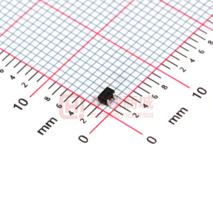

MMST2222A NPN SMALL SIGNAL SURFACE MOUNT TRANSISTOR Features · · · Epitaxial Planar Die Construction Complementary PNP Type Available (MMST2907A) Ultra-Small Surface Mount Package B A C BC E G H K M SOT-323 Dim A B C D E G H J D E L Min 0.25 1.15 2.00 0.30 1.20 1.80 0.0 0.90 0.25 0.10 0° Max 0.40 1.35 2.20 0.40 1.40 2.20 0.10 1.00 0.40 0.18 8° 0.65 Nominal Mechanical Data · · · · · · · · Case: SOT-323, Molded Plastic Case Material - UL Flammability Rating 94V-0 Moisture sensitivity: Level 1 per J-STD-020A Terminals: Solderable per MIL-STD-202, Method 208 Terminal Connections: See Diagram Marking (See Page 2): K3P Ordering & Date Code Information: See Page 2 Weight: 0.006 grams (approx.) J K L M a C All Dimensions in mm B E Maximum Ratings Collector-Base Voltage Collector-Emitter Voltage Emitter-Base Voltage @ TA = 25°C unless otherwise specified Symbol VCBO VCEO VEBO IC Pd RqJA Tj, TSTG MMST2222A 75 40 6.0 600 200 625 -55 to +150 Unit V V V mA mW °C/W °C Characteristic Collector Current - Continuous (Note 1) Power Dissipation (Note 1) Thermal Resistance, Junction to Ambient (Note 1) Operating and Storage and Temperature Range Note: 1. Device mounted on FR-4 PCB, 1 inch x 0.85 inch x 0.062 inch; pad layout as shown on Diodes Inc. suggested pad layout document AP02001, which can be found on our website at http://www.diodes.com/datasheets/ap02001.pdf. DS30080 Rev. 1 - 2 1 of 3 www.diodes.com MMST2222A Electrical Characteristics Characteristic OFF CHARACTERISTICS (Note 2) Collector-Base Breakdown Voltage Collector-Emitter Breakdown Voltage Emitter-Base Breakdown Voltage Collector Cutoff Current Collector Cutoff Current Emitter Cutoff Current Base Cutoff Current ON CHARACTERISTICS (Note 2) @ TA = 25°C unless otherwise specified Symbol V(BR)CBO V(BR)CEO V(BR)EBO ICBO ICEX IEBO IBL Min 75 40 6.0 ¾ ¾ ¾ ¾ 35 50 75 100 40 50 35 ¾ 0.6 ¾ ¾ — 300 ¾ Max ¾ ¾ ¾ 10 10 10 20 ¾ ¾ ¾ 300 ¾ ¾ ¾ 0.3 1.0 1.2 2.0 8 25 ¾ 4.0 Unit V V V nA mA nA nA nA Test Condition IC = 10mA, IE = 0 IC = 10mA, IB = 0 IE = 10mA, IC = 0 VCB = 60V, IE = 0 VCB = 60V, IE = 0, TA = 150°C VCE = 60V, VEB(OFF) = 3.0V VEB = 3.0V, IC = 0 VCE = 60V, VEB(OFF) = 3.0V IC = 100mA, VCE = 10V IC = 1.0mA, VCE = 10V IC = 10mA, VCE = 10V IC = 150mA, VCE = 10V IC = 500mA, VCE = 10V IC = 10mA, VCE = 10V, TA = -55°C IC = 150mA, VCE = 1.0V IC = 150mA, IB = 15mA IC = 500mA, IB = 50mA IC = 150mA, IB = 15mA IC = 500mA, IB = 50mA VCB = 10V, f = 1.0MHz, IE = 0 VEB = 0.5V, f = 1.0MHz, IC = 0 VCE = 20V, IC = 20mA, f = 100MHz VCE = 10V, IC = 100mA, RS = 1.0kW, f = 1.0kHz VCC = 30V, IC = 150mA, VBE(off) = - 0.5V, IB1 = 15mA VCC = 30V, IC = 150mA, IB1 = IB2 = 15mA DC Current Gain hFE ¾ Collector-Emitter Saturation Voltage Base- Emitter Saturation Voltage SMALL SIGNAL CHARACTERISTICS Output Capacitance Input Capacitance Current Gain-Bandwidth Product Noise Figure SWITCHING CHARACTERISTICS Delay Time Rise Time Storage Time Fall Time VCE(SAT) VBE(SAT) V V Cobo Cibo fT NF pF pF MHz dB td tr ts tf ¾ ¾ ¾ ¾ 10 25 225 60 ns ns ns ns Ordering Information (Note 3) Device MMST2222A-7 Notes: Packaging SOT-323 Shipping 3000/Tape & Reel 2. Short duration test pulse used to minimize self-heating effect. 3. For Packaging Details, go to our website at http://www.diodes.com/datasheets/ap02007.pdf. Marking Information K3P K3P = Product Type Marking Code YM = Date Code Marking Y = Year ex: N = 2002 M = Month ex: 9 = September Date Code Key Year Code Month Code 1998 J Jan 1 1999 K Feb 2 2000 L March 3 2001 M Apr 4 2002 N May 5 2003 P Jun 6 2004 R Jul 7 2005 S Aug 8 2006 T Sep 9 2007 U Oct O 2008 V Nov N 2009 W Dec D DS30080 Rev. 1 - 2 2 of 3 www.diodes.com YM MMST2222A 30 VCE, COLLECTOR-EMITTER VOLTAGE (V) 2.0 1.8 1.6 1.4 1.2 1.0 0.8 0.6 0.4 0.2 0 0.001 0.01 0.1 1 10 100 IC = 300mA IC = 30mA IC = 1mA IC = 10mA IC = 100mA 20 10 Cibo CAPACITANCE (pF) 5.0 Cobo 1.0 0.1 1.0 10 50 REVERSE VOLTS (V) Fig. 1 Typical Capacitance IB, BASE CURRENT (mA) Fig. 2 Typical Collector Saturation Region DS30080 Rev. 1 - 2 3 of 3 www.diodes.com MMST2222A
