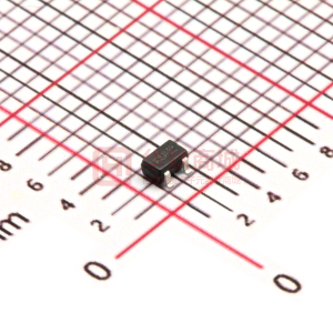

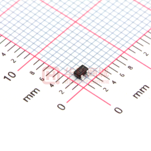

MMST2907A PNP SMALL SIGNAL SURFACE MOUNT TRANSISTOR Features · · · Epitaxial Planar Die Construction Complementary NPN Type Available (MMST2222A) Ultra-Small Surface Mount Package B G A C BC E SOT-323 Dim A B C D E M Min 0.25 1.15 2.00 0.30 1.20 1.80 0.0 0.90 0.25 0.10 0° Max 0.40 1.35 2.20 0.40 1.40 2.20 0.10 1.00 0.40 0.18 8° 0.65 Nominal Mechanical Data · · · · · · · · Case: SOT-323, Molded Plastic Case Material - UL Flammability Rating 94V-0 Moisture sensitivity: Level 1 per J-STD-020A Terminals: Solderable per MIL-STD-202, Method 208 Terminal Connections: See Diagram Marking (See Page 2): K3F Ordering & Date Code Information: See Page 2 Weight: 0.006 grams (approx.) K H G H J K L M a J D E L C B E All Dimensions in mm Maximum Ratings Collector-Base Voltage Collector-Emitter Voltage Emitter-Base Voltage @ TA = 25°C unless otherwise specified Symbol VCBO VCEO VEBO IC Pd RqJA Tj, TSTG MMST2907A -60 -60 -5.0 -600 200 625 -55 to +150 Unit V V V mA mW K/W °C Characteristic Collector Current - Continuous (Note 1) Power Dissipation (Note 1) Thermal Resistance, Junction to Ambient (Note 1) Operating and Storage and Temperature Range Note: 1. Device mounted on FR-4 PCB, 1 inch x 0.85 inch x 0.062 inch; pad layout as shown on Diodes Inc. suggested pad layout document AP02001, which can be found on our website at http://www.diodes.com/datasheets/ap02001.pdf. DS30081 Rev. 3 - 2 1 of 3 www.diodes.com MMST2907A Electrical Characteristics Characteristic OFF CHARACTERISTICS (Note 2) Collector-Base Breakdown Voltage Collector-Emitter Breakdown Voltage Emitter-Base Breakdown Voltage Collector Cutoff Current Collector Cutoff Current Base Cutoff Current ON CHARACTERISTICS (Note 2) @ TA = 25°C unless otherwise specified Symbol V(BR)CBO V(BR)CEO V(BR)EBO ICBO ICEX IBL Min -60 -60 -5.0 ¾ ¾ ¾ 75 100 100 100 50 ¾ ¾ Max ¾ ¾ ¾ -10 -50 -50 ¾ ¾ ¾ 300 ¾ -0.4 -1.6 -1.3 -2.6 8.0 30 ¾ Unit V V V nA mA nA nA Test Condition IC = -10mA, IE = 0 IC = -10mA, IB = 0 IE = -10mA, IC = 0 VCB = -50V, IE = 0 VCB = -50V, IE = 0, TA = 125°C VCE = -30V, VEB(OFF) = -0.5V VCE = -30V, VEB(OFF) = -0.5V IC = -100µA, VCE = IC = -1.0mA, VCE = IC = -10mA, VCE = IC = -150mA, VCE = IC = -500mA, VCE = -10V -10V -10V -10V -10V DC Current Gain hFE ¾ Collector-Emitter Saturation Voltage Base- Emitter Saturation Voltage SMALL SIGNAL CHARACTERISTICS Output Capacitance Input Capacitance Current Gain-Bandwidth Product SWITCHING CHARACTERISTICS Turn-On Time Delay Time Rise Time Turn-Off Time Storage Time Fall Time VCE(SAT) VBE(SAT) V V IC = -150mA, IB = -15mA IC = -500mA, IB = -50mA IC = 150mA, IB = 15mA IC = 500mA, IB = 50mA VCB = -10V, f = 1.0MHz, IE = 0 VEB = -2.0V, f = 1.0MHz, IC = 0 VCE = -20V, IC = -50mA, f = 100MHz Cobo Cibo fT ¾ — 200 pF pF MHz toff td tr toff ts tf ¾ ¾ ¾ ¾ ¾ ¾ 45 10 40 100 80 30 ns ns ns ns ns ns VCC = -6.0V, IC = -150mA, IB1 = IB2 = -15mA VCC = -30V, IC = -150mA, IB1 = -15mA Ordering Information Device MMST2907A-7 Notes: (Note 3) Packaging SOT-323 Shipping 3000/Tape & Reel 2. Short duration test pulse used to minimize self-heating effect. 3. For Packaging Details, go to our website at http://www.diodes.com/datasheets/ap02007.pdf. Marking Information K3F K3F = Product Type Marking Code YM = Date Code Marking Y = Year ex: N = 2002 M = Month ex: 9 = September Date Code Key Year Code Month Code 1998 J Jan 1 1999 K Feb 2 2000 L March 3 2001 M Apr 4 2002 N May 5 2003 P Jun 6 2004 R Jul 7 2005 S Aug 8 2006 T Sep 9 2007 U Oct O 2008 V Nov N 2009 W Dec D DS30081 Rev. 3 - 2 2 of 3 www.diodes.com YM MMST2907A 30 20 C, CAPACITANCE (pF) Cibo 10 5.0 Cobo 1.0 -0.1 -1.0 -10 -30 REVERSE VOLTS (V) Fig. 1 Typical Capacitance VCE, COLLECTOR-EMITTER VOLTAGE (V) 1.6 1.4 1.2 1.0 0.8 0.6 0.4 0.2 0 0.001 1 IC = 1mA IC = 10mA IC = 100mA IC = 30mA IC = 300mA 0.01 0.1 10 100 IB, BASE CURRENT (mA) Fig. 2 Typical Collector Saturation Region DS30081 Rev. 3 - 2 3 of 3 www.diodes.com MMST2907A
