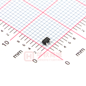

MMST2907A PNP SMALL SIGNAL SURFACE MOUNT TRANSISTOR Features • • • • Epitaxial Planar Die Construction Complementary NPN Type Available (MMST2222A) Ultra-Small Surface Mount Package Lead Free/RoHS Compliant (Note 2) "Green" Device (Note 3 and 4) A C SOT-323 Dim BC Min 0.25 1.15 2.00 0.30 1.20 1.80 0.0 0.90 0.25 0.10 0° Max 0.40 1.35 2.20 0.40 1.40 2.20 0.10 1.00 0.40 0.18 8° • A B C D M B G H E Mechanical Data • • • • • • • • Case: SOT-323 Case Material: Molded Plastic, "Green" Molding Compound. UL Flammability Classification Rating 94V-0 (Note 4) Moisture Sensitivity: Level 1 per J-STD-020C Terminals: Solderable per MIL-STD-202, Method 208 Terminal Connections: See Diagram Lead Free Plating (Matte Tin Finish annealed over Alloy 42 leadframe). Marking Information: K3F - See Page 4 Ordering & Date Code Information: See Page 4 Weight: 0.006 grams (approximate) K 0.65 Nominal E G H J K L M α J D E L C • B E All Dimensions in mm Maximum Ratings Collector-Base Voltage Collector-Emitter Voltage Emitter-Base Voltage @TA = 25°C unless otherwise specified Symbol VCBO VCEO VEBO IC Pd RθJA Tj, TSTG Value -60 -60 -5.0 -600 200 625 -55 to +150 Unit V V V mA mW °C/W °C Characteristic Collector Current - Continuous (Note 1) Power Dissipation (Note 1) Thermal Resistance, Junction to Ambient (Note 1) Operating and Storage and Temperature Range Note: 1. 2. 3. 4. Device mounted on FR-4 PCB, 1 inch x 0.85 inch x 0.062 inch; pad layout as shown on Diodes Inc. suggested pad layout document AP02001, which can be found on our website at http://www.diodes.com/datasheets/ap02001.pdf. No purposefully added lead. Diodes Inc.'s "Green" policy can be found on our website at http://www.diodes.com/products/lead_free/index.php. Product manufactured with Date Code 0627 (week 27, 2006) and newer are built with Green Molding Compound. Product manufactured prior to Date Code 0627 are built with Non-Green Molding Compound and may contain Halogens or Sb2O3 Fire Retardants. DS30081 Rev. 9 - 2 1 of 4 www.diodes.com MMST2907A © Diodes Incorporated Electrical Characteristics Characteristic OFF CHARACTERISTICS (Note 5) Collector-Base Breakdown Voltage Collector-Emitter Breakdown Voltage Emitter-Base Breakdown Voltage Collector Cutoff Current Collector Cutoff Current Base Cutoff Current ON CHARACTERISTICS (Note 5) @TA = 25°C unless otherwise specified Symbol Min Max ⎯ ⎯ ⎯ -10 -50 -50 ⎯ ⎯ ⎯ 300 ⎯ -0.4 -1.6 -1.3 -2.6 8.0 30 ⎯ Unit Test Condition IC = -10μA, IE = 0 IC = -10mA, IB = 0 IE = -10μA, IC = 0 VCB = -50V, IE = 0 VCB = -50V, IE = 0, TA = 125°C VCE = -30V, VEB(OFF) = -0.5V VCE = -30V, VEB(OFF) = -0.5V IC = -100µA, VCE = -10V IC = -1.0mA, VCE = -10V IC = -10mA, VCE = -10V IC = -150mA, VCE = -10V IC = -500mA, VCE = -10V IC = -150mA, IB = -15mA IC = -500mA, IB = -50mA IC = 150mA, IB = 15mA IC = 500mA, IB = 50mA VCB = -10V, f = 1.0MHz, IE = 0 VEB = -2.0V, f = 1.0MHz, IC = 0 VCE = -20V, IC = -50mA, f = 100MHz V(BR)CBO V(BR)CEO V(BR)EBO ICBO ICEX IBL -60 -60 -5.0 ⎯ ⎯ ⎯ V V V nA μA nA nA DC Current Gain hFE 75 100 100 100 50 ⎯ ⎯ ⎯ Collector-Emitter Saturation Voltage Base-Emitter Saturation Voltage SMALL SIGNAL CHARACTERISTICS Output Capacitance Input Capacitance Current Gain-Bandwidth Product SWITCHING CHARACTERISTICS Turn-On Time Delay Time Rise Time Turn-Off Time Storage Time Fall Time Notes: 5. Short duration pulse test used to minimize self-heating effect. VCE(SAT) VBE(SAT) V V Cobo Cibo fT ⎯ — 200 pF pF MHz ton td tr toff ts tf ⎯ ⎯ ⎯ ⎯ ⎯ ⎯ 45 10 40 100 80 30 ns ns ns ns ns ns VCC = -6.0V, IC = -150mA, IB1 = IB2 = -15mA VCC = -30V, IC = -150mA, IB1 = -15mA 200 Note 1 f = 1MHz PD, POWER DISSIPATION (mW) 150 100 CAPACITANCE (pF) Cibo 50 Cobo 25 50 75 100 125 150 175 200 TA, AMBIENT TEMPERATURE (°C) Fig. 1 Max Power Dissipation vs. Ambient Temperature 0 0 VR, REVERSE VOLTAGE (V) Fig. 2 Typical Capacitance Characteristics DS30081 Rev. 9 - 2 2 of 4 www.diodes.com MMST2907A © Diodes Incorporated -1.6 VCE, COLLECTOR-EMITTER VOLTAGE (V) -0.6 IC = -10mA IC = -1mA IC = -300mA VCE(SAT), COLLECTOR TO EMITTER SATURATION VOLTAGE (V) -1.4 -1.2 -1.0 -0.8 -0.6 -0.4 -0.2 0 -0.001 IC = 10 IB IC = -100mA IC = -30mA -0.5 -0.4 -0.3 TA = 150°C -0.2 T A = 25°C -0.1 TA = -50°C -0.01 -0.1 -10 -100 -1 IB, BASE CURRENT (mA) Fig. 3 Typical Collector Saturation Region 0 -1 -100 -10 -1000 IC, COLLECTOR CURRENT (mA) Fig. 4 Collector-Emitter Saturation Voltage vs. Collector Current 1,000 VCE = -5V -1.0 VCE = -5V hFE, DC CURRENT GAIN T A = 150°C VBE(ON), BASE EMITTER VOLTAGE (V) -0.9 -0.8 -0.7 -0.6 TA = 25°C TA = -50°C 100 TA = 25°C TA = -50°C -0.5 -0.4 -0.3 -0.2 -0.1 TA = 150°C 10 1 -1 -10 -100 -1,000 IC, COLLECTOR CURRENT (mA) Fig. 5 DC Current Gain vs. Collector Current -10 -1 -100 IC, COLLECTOR CURRENT (mA) Fig. 6 Base-Emitter Voltage vs. Collector Current 1,000 VCE = -5V fT, GAIN BANDWIDTH PRODUCT (MHz) 100 10 1 -1 -10 -100 IC, COLLECTOR CURRENT (mA) Fig. 7 Gain Bandwidth Product vs. Collector Current DS30081 Rev. 9 - 2 3 of 4 www.diodes.com MMST2907A © Diodes Incorporated Ordering Information (Note 4 and 6) Device MMST2907A-7-F Notes: 6. Packaging SOT-323 Shipping 3000/Tape & Reel For packaging details, go to our website at http://www.diodes.com/datasheets/ap02007.pdf. Marking Information K3F K3F = Product Type Marking Code YM = Date Code Marking Y = Year ex: N = 2002 M = Month ex: 9 = September Date Code Key Year Code Month Code YM 1998 J Jan 1 1999 K Feb 2 2000 L 2001 M Mar 3 2002 N Apr 4 2003 P May 5 2004 R Jun 6 2005 S 2006 T Jul 7 2007 U Aug 8 2008 V Sep 9 2009 W Oct O 2010 X 2011 Y Nov N 2012 Z Dec D IMPORTANT NOTICE Diodes Incorporated and its subsidiaries reserve the right to make modifications, enhancements, improvements, corrections or other changes without further notice to any product herein. Diodes Incorporated does not assume any liability arising out of the application or use of any product described herein; neither does it convey any license under its patent rights, nor the rights of others. The user of products in such applications shall assume all risks of such use and will agree to hold Diodes Incorporated and all the companies whose products are represented on our website, harmless against all damages. LIFE SUPPORT Diodes Incorporated products are not authorized for use as critical components in life support devices or systems without the expressed written approval of the President of Diodes Incorporated. DS30081 Rev. 9 - 2 4 of 4 www.diodes.com MMST2907A © Diodes Incorporated
