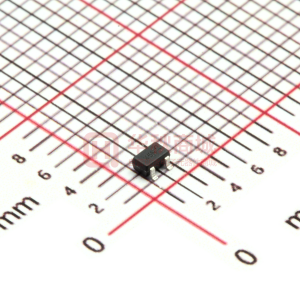

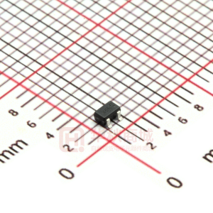

MMST3906 PNP SMALL SIGNAL SURFACE MOUNT TRANSISTOR Features NEW PRODUCT · · · Epitaxial Planar Die Construction Complementary NPN Type Available (MMST3904) Ultra-Small Surface Mount Package C SOT-323 Dim A Min 0.30 1.15 2.00 0.30 1.20 1.80 0.0 0.90 0.25 0.10 Max 0.40 1.35 2.20 0.40 1.40 2.20 0.10 1.00 0.40 0.25 A B C B E C Mechanical Data · · · · · Case: SOT-323, Molded Plastic Terminals: Solderable per MIL-STD-202, Method 208 Terminal Connections: See Diagram Marking: K5N Weight: 0.006 grams (approx.) B E TOP VIEW D E G H J M L 0.65 Nominal D G H K J K L M All Dimensions in mm Maximum Ratings Collector-Base Voltage Collector-Emitter Voltage Emitter-Base Voltage @ TA = 25°C unless otherwise specified Symbol VCBO VCEO VEBO IC Pd RqJA Tj, TSTG MMST3906 -40 -40 -5.0 -200 200 625 -55 to +150 Unit V V V mA mW K/W °C Characteristic Collector Current - Continuous (Note 1) Power Dissipation (Note 1) Thermal Resistance, Junction to Ambient (Note 1) Operating and Storage and Temperature Range Note: 1. Valid provided that terminals are kept at ambient temperature. 2. Pulse test: Pulse width £ 300ms, duty cycle £ 2%. DS30079 Rev. 2P-1 1 of 2 MMST3906 Electrical Characteristics @ TA = 25°C unless otherwise specified Symbol V(BR)CBO V(BR)CEO V(BR)EBO ICEX IBL Min -40 -40 -5.0 ¾ ¾ 60 80 100 60 30 ¾ -0.65 ¾ ¾ ¾ 2.0 0.1 100 3.0 300 ¾ Max ¾ ¾ ¾ -50 -50 ¾ ¾ 300 ¾ ¾ -0.20 -0.30 -0.85 -0.95 4.5 10 12 10 400 60 ¾ 4.0 Unit V V V nA nA Test Condition IC = -10mA, IE = 0 IC = -1.0mA, IB = 0 IE = -10mA, IC = 0 VCE = -30V, VEB(OFF) = -3.0V VCE = -30V, VEB(OFF) = -3.0V IC = -100µA, VCE = IC = -1.0mA, VCE = IC = -10mA, VCE = IC = -50mA, VCE = IC = -100mA, VCE = -1.0V -1.0V -1.0V -1.0V -1.0V NEW PRODUCT Characteristic OFF CHARACTERISTICS (Note 2) Collector-Base Breakdown Voltage Collector-Emitter Breakdown Voltage Emitter-Base Breakdown Voltage Collector Cutoff Current Base Cutoff Current ON CHARACTERISTICS (Note 2) DC Current Gain hFE ¾ Collector-Emitter Saturation Voltage Base- Emitter Saturation Voltage SMALL SIGNAL CHARACTERISTICS Output Capacitance Input Capacitance Input Impedance Voltage Feedback Ratio Small Signal Current Gain Output Admittance Current Gain-Bandwidth Product Noise Figure SWITCHING CHARACTERISTICS Delay Time Rise Time Storage Time Fall Time VCE(SAT) VBE(SAT) V V IC = -10mA, IB = -1.0mA IC = -50mA, IB = -5.0mA IC = -10mA, IB = -1.0mA IC = -50mA, IB = -5.0mA VCB = -5.0V, f = 1.0MHz, IE = 0 VEB = -0.5V, f = 1.0MHz, IC = 0 Cobo Cibo hie hre hfe hoe fT NF pF pF kW x 10-4 ¾ mS MHz dB VCE = 1.0V, IC = 10mA, f = 1.0kHz VCE = -20V, IC = -10mA, f = 100MHz VCE = -5.0V, IC = -100mA, RS = 1.0kW, f = 1.0kHz VCC = -3.0V, IC = -10mA, VBE(off) = 0.5V, IB1 = -1.0mA VCC = -3.0V, IC = -10mA, IB1 = IB2 = -1.0mA td tr ts tf ¾ ¾ ¾ ¾ 35 35 225 75 ns ns ns ns Note: 1. Valid provided that terminals are kept at ambient temperature. 2. Pulse test: Pulse width £ 300ms, duty cycle £ 2%. DS30079 Rev. 2P-1 2 of 2 MMST3906
