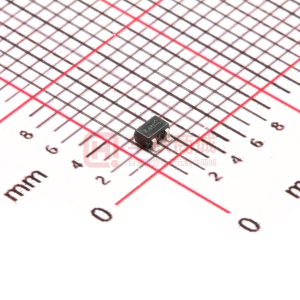

SPICE MODEL: MMST5551 Lead-free Green MMST5551 NPN SMALL SIGNAL SURFACE MOUNT TRANSISTOR Features • • • • • • Epitaxial Planar Die Construction Complementary PNP Type Available (MMST5401) Ideal for Low Power Amplification and Switching Ultra-Small Surface Mount Package Lead Free/RoHS Compliant (Note 2) "Green" Device (Note 3 and 4) B G H K M E BC SOT-323 A C Dim A B C D E G H J K L M α Min 0.25 1.15 2.00 0.30 1.20 1.80 0.0 0.90 0.25 0.10 0° Max 0.40 1.35 2.20 0.40 1.40 2.20 0.10 1.00 0.40 0.18 8° 0.65 Nominal Mechanical Data • • • • • • • • • Case: SOT-323 Case Material: Molded Plastic, "Green" Molding Compound, Note 4. UL Flammability Classification Rating 94V-0 Moisture Sensitivity: Level 1 per J-STD-020C Terminal Connections: See Diagram Terminals: Solderable per MIL-STD-202, Method 208 Lead Free Plating (Matte Tin Finish annealed over Alloy 42 leadframe). Marking (See Page 2) : K4N Ordering & Date Code Information: See Page 2 Weight: 0.006 grams (approximate) J D E L C All Dimensions in mm B E Maximum Ratings Collector-Base Voltage Collector-Emitter Voltage Emitter-Base Voltage @ TA = 25°C unless otherwise specified Symbol VCBO VCEO VEBO IC Pd RθJA Tj, TSTG Value 180 160 6.0 200 200 625 -55 to +150 Unit V V V mA mW °C/W °C Characteristic Collector Current - Continuous (Note 1) Power Dissipation (Note 1) Thermal Resistance, Junction to Ambient (Note 1) Operating and Storage and Temperature Range Note: 1. Device mounted on FR-4 PCB, 1 inch x 0.85 inch x 0.062 inch; pad layout as shown on Diodes Inc. suggested pad layout document AP02001, which can be found on our website at http://www.diodes.com/datasheets/ap02001.pdf. 2. No purposefully added lead. 3. Diodes Inc.'s "Green" policy can be found on our website at http://www.diodes.com/products/lead_free/index.php. 4. Product manufactured with Date Code 0609 (week 9, 2006) and newer are built with Green Molding Compound. Product manufactured prior to Date Code 0609 are built with Non-Green Molding Compound and may contain Halogens or Sb2O3 Fire Retardants. DS30173 Rev. 7 - 2 1 of 4 www.diodes.com MMST5551 © Diodes Incorporated Electrical Characteristics Characteristic OFF CHARACTERISTICS (Note 5) Collector-Base Breakdown Voltage Collector-Emitter Breakdown Voltage Emitter-Base Breakdown Voltage Collector Cutoff Current Emitter Cutoff Current ON CHARACTERISTICS (Note 5) DC Current Gain Collector-Emitter Saturation Voltage Base-Emitter Saturation Voltage SMALL SIGNAL CHARACTERISTICS Output Capacitance Small Signal Current Gain Current Gain-Bandwidth Product Noise Figure @ TA = 25°C unless otherwise specified Symbol V(BR)CBO V(BR)CEO V(BR)EBO ICBO IEBO Min 180 160 6.0   80 80 30    50 100  Max    50 50  250  0.15 0.20 1.0 Unit V V V nA µA nA Test Condition IC = 100µA, IE = 0 IC = 1.0mA, IB = 0 IE = 10µA, IC = 0 VCB = 120V, IE = 0 VCB = 120V, IE = 0, TA = 100°C VEB = 4.0V, IC = 0 IC = 1.0mA, VCE = 5.0V IC = 10mA, VCE = 5.0V IC = 50mA, VCE = 5.0V IC = 10mA, IB = 1.0mA IC = 50mA, IB = 5.0mA IC = 10mA, IB = 1.0mA IC = 50mA, IB = 5.0mA VCB = 10V, f = 1.0MHz, IE = 0 VCE = 10V, IC = 1.0mA, f = 1.0kHz VCE = 10V, IC = 10mA, f = 100MHz VCE = 5.0V, IC = 200µA, RS = 1.0kΩ, f = 1.0kHz hFE VCE(SAT) VBE(SAT)  V V Cobo hfe fT NF 6.0 250 300 8.0 pF  MHz dB Ordering Information Device (Note 4 & 6) Packaging SOT-323 Shipping 3000/Tape & Reel MMST5551-7-F Notes: 4. Product manufactured with Date Code 0609 (week 9, 2006) and newer are built with Green Molding Compound. Product manufactured prior to Date Code 0609 are built with Non-Green Molding Compound and may contain Halogens or Sb2O3 Fire Retardants. 5. Short duration test pulse used to minimize self-heating effect. 6. For Packaging Details, go to our website at http://www.diodes.com/datasheets/ap02007.pdf. Marking Information K4N K4N= Product Type Marking Code YM = Date Code Marking Y = Year ex: N = 2002 M = Month ex: 9 = September Date Code Key Year Code 1998 J Month Code 1999 K Jan 1 2000 L 2001 M Feb 2 2002 N March 3 2003 P Apr 4 2004 R May 5 2005 S Jun 6 2006 T Jul 7 2007 U Aug 8 2008 V Sep 9 2009 W Oct O 2010 X Nov N 2011 Y 2012 Z Dec D DS30173 Rev. 7 - 2 2 of 4 www.diodes.com YM MMST5551 200 Note 1 0.15 0.14 VCE(SAT), COLLECTOR TO EMITTER SATURATION VOLTAGE (V) 0.13 0.12 0.11 0.10 0.09 0.08 0.07 0.06 0.05 0.04 0 25 50 75 100 125 150 175 200 IC = 10 IB PD, POWER DISSIPATION (mW) 150 TA = 150°C 100 TA = 25°C 50 TA = -50°C 1 10 100 1000 0 TA, AMBIENT TEMPERATURE (°C) Fig. 1, Max Power Dissipation vs Ambient Temperature IC, COLLECTOR CURRENT (mA) Fig. 2, Collector Emitter Saturation Voltage vs. Collector Current 1000 1.0 VBE(ON), BASE EMITTER VOLTAGE (V) VCE = 5V TA = 150°C VCE = 5V 0.9 0.8 0.7 0.6 0.5 0.4 0.3 0.2 TA = 150°C TA = 25°C TA = -50°C hFE, DC CURRENT GAIN 100 TA = 25°C TA = -50°C 10 1 1 10 IC, COLLECTOR CURRENT (mA) Fig. 3, DC Current Gain vs Collector Current 100 0.1 1 10 100 IC, COLLECTOR CURRENT (mA) Fig. 4, Base Emitter Voltage vs. Collector Current 1000 fT, GAIN BANDWIDTH PRODUCT (MHz) VCE = 5V 100 10 1 1 10 IC, COLLECTOR CURRENT (mA) Fig. 5, Gain Bandwidth Product vs. Collector Current 100 DS30173 Rev. 7 - 2 3 of 4 www.diodes.com MMST5551 IMPORTANT NOTICE Diodes Incorporated and its subsidiaries reserve the right to make modifications, enhancements, improvements, corrections or other changes without further notice to any product herein. Diodes Incorporated does not assume any liability arising out of the application or use of any product described herein; neither does it convey any license under its patent rights, nor the rights of others. The user of products in such applications shall assume all risks of such use and will agree to hold Diodes Incorporated and all the companies whose products are represented on our website, harmless against all damages. LIFE SUPPORT Diodes Incorporated products are not authorized for use as critical components in life support devices or systems without the expressed written approval of the President of Diodes Incorporated. DS30173 Rev. 7 - 2 4 of 4 www.diodes.com MMST5551
