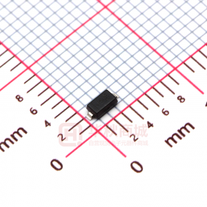

MMSZ5221B - MMSZ5259B Lead-free 500mW SURFACE MOUNT ZENER DIODE SPICE MODELS: MMSZ5221B MMSZ5223B MMSZ5225B MMSZ5226B MMSZ5227B MMSZ5228B MMSZ5229B MMSZ5230B MMSZ5231B MMSZ5232B MMSZ5233B MMSZ5234B MMSZ5235B MMSZ5236B MMSZ5237B MMSZ5238B MMSZ5239B MMSZ5240B MMSZ5241B MMSZ5242B MMSZ5243B MMSZ5245B MMSZ5246B MMSZ5248B MMSZ5250B MMSZ5251B MMSZ5252B MMSZ5254B MMSZ5255B MMSZ5256B MMSZ5257B MMSZ5258B MMSZ5259B Features · · · · · 500mW Power Dissipation General Purpose, Medium Current Ideally Suited for Automated Assembly Processes Lead Free/RoHS Compliant (Note 2) Qualified to AEC-Q101 Standards for High Reliability Dim A B J SOD-123 Min 3.55 2.55 1.40 — 0.45 0.25 — 0° Max 3.85 2.85 1.70 1.35 0.65 — 0.10 8° Mechanical Data · · · · · · · · · Case: SOD-123 Case Material: Molded Plastic. UL Flammability Classification Rating 94V-0 Moisture Sensitivity: Level 1 per J-STD-020C Terminals: Solderable per MIL-STD-202, Method 208 Lead Free Plating (Matte Tin Finish annealed over Alloy 42 leadframe) Polarity: Cathode Band Ordering Information: See Page 2 Marking: See Below Weight: 0.01 grams (approximate) H G D C D A B E E 0.55 Typical 0.11 Typical C G H J a All Dimensions in mm Maximum Ratings Forward Voltage Power Dissipation @ TA = 25°C unless otherwise specified Symbol @ IF = 10mA (Note 1) (Note 1) VF Pd RqJA Tj, TSTG Value 0.9 500 350 -65 to +150 Unit V mW °C/W °C Characteristic Thermal Resistance, Junction to Ambient Air Operating and Storage Temperature Range Notes: 2. No purposefully added lead. 1. Device mounted on ceramic PCB; 7.6 mm x 9.4 mm x 0.87 mm with pad areas 25 mm 2. Marking Information XX = Product Type Marking Code (See Page 2) YM = Date Code Marking Y = Year (ex: N = 2002) M = Month (ex: 9 = September) XX Date Code Key Year Code Month Code 1998 J Jan 1 1999 K Feb 2 2000 L March 3 YM 2001 M Apr 4 2002 N May 5 2003 P Jun 6 2004 R Jul 7 2005 S Aug 8 2006 T Sep 9 2007 U Oct O 2008 V Nov N 2009 W Dec D DS18010 Rev. 18 - 2 1 of 4 www.diodes.com MMSZ5221B - MMSZ5259B ã Diodes Incorporated Electrical Characteristics Type Number Type Code @ TA = 25°C unless otherwise specified Test Current IZT Max (V) 2.52 2.84 3.15 3.47 3.78 4.10 4.52 4.94 5.36 5.88 6.30 6.51 7.14 7.88 8.61 9.14 9.56 10.50 11.55 12.60 13.65 15.75 16.80 18.90 21.00 23.10 25.20 28.35 29.40 31.50 34.65 37.80 40.95 mA 20 20 20 20 20 20 20 20 20 20 20 20 20 20 20 20 20 20 20 20 9.5 8.5 7.8 7.0 6.2 5.6 5.2 5.0 4.5 4.2 3.8 3.4 3.2 30 30 30 28 24 23 22 19 17 11 7 7 5 6 8 8 10 17 22 30 13 16 17 21 25 29 33 41 44 49 58 70 80 Maximum Zener Impedance (Note 3) ZZT @ IZT ZZK @ IZK = 0.25mA W 1200 1300 1600 1600 1700 1900 2000 1900 1600 1600 1600 1000 750 500 500 600 600 600 600 600 600 600 600 600 600 600 600 600 600 600 700 700 800 Maximum Reverse Leakage Current (Note 4) IR mA 100 75 50 25 15 10 5.0 5.0 5.0 5.0 5.0 5.0 3.0 3.0 3.0 3.0 3.0 3.0 2.0 1.0 0.5 0.1 0.1 0.1 0.1 0.1 0.1 0.1 0.1 0.1 0.1 0.1 0.1 @ VR V 1.0 1.0 1.0 1.0 1.0 1.0 1.0 2.0 2.0 3.0 3.5 4.0 5.0 6.0 6.5 6.5 7.0 8.0 8.4 9.1 9.9 11 12 14 15 17 18 21 21 23 25 27 30 Zener Voltage Range (Note 4) VZ @ IZT Nom (V) MMSZ5221B MMSZ5223B MMSZ5225B MMSZ5226B MMSZ5227B MMSZ5228B MMSZ5229B MMSZ5230B MMSZ5231B MMSZ5232B MMSZ5233B MMSZ5234B MMSZ5235B MMSZ5236B MMSZ5237B MMSZ5238B MMSZ5239B MMSZ5240B MMSZ5241B MMSZ5242B MMSZ5243B MMSZ5245B MMSZ5246B MMSZ5248B MMSZ5250B MMSZ5251B MMSZ5252B MMSZ5254B MMSZ5255B MMSZ5256B MMSZ5257B MMSZ5258B MMSZ5259B Notes: Min (V) 2.28 2.57 2.85 3.14 3.42 3.71 4.09 4.47 4.85 5.32 5.70 5.89 6.46 7.13 7.79 8.27 8.65 9.50 10.45 11.40 12.35 14.25 15.20 17.10 19.00 20.90 22.80 25.65 26.60 28.50 31.35 34.20 37.05 C1, C1 C3, C3 C5, C5 G1, G1 G2, G2 G3, G3 G4, G4 G5, G5 E1, E1 E2, E2 E3, E3 E4, E4 E5, E5 F1, F1 F2, F2 F3, F3 F4, F4 F5, F5 H1, H1 H2, H2 H3, H3 H5, H5 J1, J1 J3, J3 J5, J5 K1, K1 K2, K2 K4, K4 K5, K5 M1, M1 M2, M2 M3, M3 M4, M4 2.4 2.7 3.0 3.3 3.6 3.9 4.3 4.7 5.1 5.6 6.0 6.2 6.8 7.5 8.2 8.7 9.1 10 11 12 13 15 16 18 20 22 24 27 28 30 33 36 39 3. f = 1KHz. 4. Short duration test pulse used to minimize self-heating effect. Ordering Information Device (Note 5) Packaging SOD-123 Shipping 3000/Tape & Reel (Type Number)-7-F* * Add “-7-F” to the appropriate type number in Table 1 above example: 6.2V Zener = MMSZ5234B-7-F. Notes: 5. For Packaging Details, go to our website at http://www.diodes.com/datasheets/ap02007.pdf. DS18010 Rev. 18 - 2 2 of 4 www.diodes.com MMSZ5221B - MMSZ5259B 0.6 1000 Tj = 25 °C 0.5 PD, POWER DISSIPATION (W) 0.4 CT, TOTAL CAPACITANCE (pF) 100 VR = 1V 0.3 0.2 VR = 2V 0.1 10 1 0 0 25 50 75 100 125 150 TA, AMBIENT TEMPERATURE (° C) Fig. 1 Power Dissipation vs Ambient Temperature 10 100 VZ, NOMINAL ZENER VOLTAGE (V) Fig. 2 Total Capacitance vs Nominal Zener Voltage 1000 50 Tj = 25°C 5V6 6V8 40 IZ = 1.0mA 100 IZ, ZENER CURRENT (mA) 8V2 30 20 10 10 Test Current IZ 20mA 1 1 10 VZ, NOMINAL ZENER VOLTAGE (V) Fig. 3 Zener Voltage vs. Zener Impedence 100 0 0 1 3 4 5 6 8 9 7 VZ, ZENER VOLTAGE (V) Fig. 4 Zener Breakdown Characteristics 2 10 30 Tj = 25°C 10 12 IZ, ZENER CURRENT (mA) 20 Test current IZ 15 Nominal Zener Voltage 18 10 22 27 33 36 39 0 0 10 20 30 VZ, ZENER VOLTAGE (V) Fig. 5 Zener Breakdown Characteristics 40 DS18010 Rev. 18 - 2 3 of 4 www.diodes.com MMSZ5221B - MMSZ5259B IMPORTANT NOTICE Diodes Incorporated and its subsidiaries reserve the right to make modifications, enhancements, improvements, corrections or other changes without further notice to any product herein. Diodes Incorporated does not assume any liability arising out of the application or use of any product described herein; neither does it convey any license under its patent rights, nor the rights of others. The user of products in such applications shall assume all risks of such use and will agree to hold Diodes Incorporated and all the companies whose products are represented on our website, harmless against all damages. LIFE SUPPORT Diodes Incorporated products are not authorized for use as critical components in life support devices or systems without the expressed written approval of the President of Diodes incorporated. DS18010 Rev. 18 - 2 4 of 4 www.diodes.com MMSZ5221B - MMSZ5259B

### 参数特性 - 最大额定值: - 正向电压@IF=10mA:0.9V - 功率耗散:500mW - 热阻,结到环境空气:350°C/W - 工作和存储温度范围:-65至+150°C - 电气特性(在25°C下,除非另有说明): - 包括不同型号的Zener电压范围、测试电流、最大Zener阻抗和最大反向漏电流等参数。
### 功能详解 - 这些Zener二极管用于稳定电压,保护电路免受过电压损害。
### 应用信息 - 适用于需要电压稳定和过压保护的各种电子电路。
### 封装信息 - 封装类型为SOD-123,封装材料为模塑塑料,UL可燃性等级94V-0,湿度敏感度等级1,符合J-STD-020C标准。
