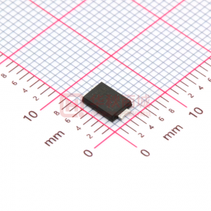

PDS5100 5A HIGH VOLTAGE SCHOTTKY BARRIER RECTIFIER PowerDI®5 Features • • • • • • • • Guard Ring Die Construction for Transient Protection High Surge Current Capability Low Leakage Current Low Forward Voltage Drop High Forward Surge Current Capability Lead Free Finish, RoHS Compliant (Note 1) "Green" Molding Compound (No Br, Sb) Qualified to AEC-Q101 Standards for High Reliability Mechanical Data • • • • • • Case: PowerDI 5 Case Material: Molded Plastic, “Green” Molding Compound. UL Flammability Classification Rating 94V-0 Moisture Sensitivity: Level 1 per J-STD-020 Terminals: Finish – Matte Tin annealed over Copper leadframe. Solderable per MIL-STD-202, Method 208 Polarity: See Diagram Weight: 0.093 grams (approximate) ® LEFT PIN RIGHT PIN BOTTOMSIDE HEAT SINK Top View Bottom View Note: Pins Left & Right must be electrically connected at the printed circuit board. Ordering Information (Note 2) Part Number PDS5100-13 Notes: Case ® PowerDI 5 Packaging 5000/Tape & Reel 1. EU Directive 2002/95/EC (RoHS). All applicable RoHS exemptions applied, see EU Directive 2002/95/EC Annex Notes. 2. For packaging details, go to our website at http://www.diodes.com. Marking Information S5100 YYWWK S5100 = Product type marking code = Manufacturers’ code marking YYWW = Date code marking YY = Last digit of year (ex: 04 for 2004) WW = Week code (01 - 53) K = Factory Designator PowerDI is a registered trademark of Diodes Incorporated. PDS5100 Document number: DS30483 Rev. 10 - 2 1 of 5 www.diodes.com December 2010 © Diodes Incorporated PDS5100 Maximum Ratings @TA = 25°C unless otherwise specified Single phase, half wave, 60Hz, resistive or inductive load. For capacitance load, derate current by 20%. Characteristic Peak Repetitive Reverse Voltage Working Peak Reverse Voltage DC Blocking Voltage RMS Reverse Voltage Average Rectified Output Current (See also figure 5) Non-Repetitive Peak Forward Surge Current 8.3ms Single half sine-wave Superimposed on Rated Load Symbol VRRM VRWM VR VR(RMS) IO IFSM Value 100 71 5 120 Unit V V A A Thermal Characteristics Characteristic Thermal Resistance Junction to Soldering Point Thermal Resistance Junction to Ambient Air (Note 3) TA = 25°C Thermal Resistance Junction to Ambient Air (Note 4) TA = 25°C Thermal Resistance Junction to Ambient Air (Note 5) TA = 25°C Operating Temperature Range Storage Temperature Range Symbol RθJS RθJA RθJA RθJA TJ TSTG Typ ⎯ 90 70 50 -65 to +150 -65 to +175 Max 2.6 ⎯ ⎯ ⎯ Unit °C/W °C/W °C/W °C/W °C °C Electrical Characteristics @TA = 25°C unless otherwise specified Characteristic Reverse Breakdown Voltage (Note 6) Symbol V(BR)R Min 100 ⎯ ⎯ ⎯ ⎯ ⎯ ⎯ ⎯ Typ ⎯ 0.74 0.64 0.60 0.81 0.68 0.002 0.5 2 Max ⎯ 0.79 0.68 0.64 0.89 0.73 0.2 5 20 Unit V Test Condition IR = 200μA IF = 5A, TS = 25°C IF = 5A, TS = 100°C IF = 5A, TS = 125°C IF = 10A, TS = 25°C IF = 10A, TS = 125°C TS = 25°C, VR = 100V TS = 100°C, VR = 100V TS = 125°C, VR = 100V Forward Voltage VF V Reverse Leakage Current (Note 6) Notes: IR mA 3. FR-4 PCB, 2 oz. Copper, minimum recommended pad layout per http://www.diodes.com 4. Polymide PCB, 2 oz. Copper, minimum recommended pad layout per http://www.diodes.com. 5. Polymide PCB, 2 oz. Copper. Cathode pad dimensions 9.4mm x 7.2mm. Anode pad dimensions 2.7mm x 1.6mm. 6. Short duration pulse test used to minimize self-heating effect. PowerDI is a registered trademark of Diodes Incorporated. PDS5100 Document number: DS30483 Rev. 10 - 2 2 of 5 www.diodes.com December 2010 © Diodes Incorporated PDS5100 IF, INSTANTANEOUS FORWARD CURRENT (A) 4 PD, POWER DISSIPATION (W) 3 TJ = 150°C T J = 125°C TJ = 100°C 2 1 TJ = 85°C TJ = 25°C T J = -65°C 0 0.00001 0 3 4 5 6 7 8 9 10 1 2 IF(AV), AVERAGE FORWARD CURRENT (A) Fig. 1 Forward Power Dissipation IR , INSTANTANEOUS REVERSE CURRENT (mA) 10 0 VF, INSTANTANEOUS FORWARD VOLTAGE (V) Fig. 2 Typical Forward Characteristics IR, INSTANTANEOUS REVERSE CURRENT (µA) 10 TJ = 25° C 1 1.0 0.1 0.01 0.1 0.001 T J = -65°C 0.0001 100 40 60 80 0 20 VR, INSTANTANEOUS REVERSE VOLTAGE (V) Fig. 3 Typical Reverse Characteristics 400 350 0.01 40 60 80 100 0 20 VR, INSTANTANEOUS REVERSE VOLTAGE (V) Fig. 4 Typical Reverse Characteristics 7.5 IF(AV), AVERAGE FORWARD CURRENT (A) CT, TOTAL CAPACITANCE (pF) 6.0 300 250 200 150 100 50 0 0 20 30 15 25 10 35 40 VR, DC REVERSE VOLTAGE (V) Fig. 5 Total Capacitance vs. Reverse Voltage 5 4.5 3.0 1.5 0 0 100 25 50 75 125 150 TA, AMBIENT TEMPERATURE (°C) Fig. 6 Forward Current Derating Curve PowerDI is a registered trademark of Diodes Incorporated. PDS5100 Document number: DS30483 Rev. 10 - 2 3 of 5 www.diodes.com December 2010 © Diodes Incorporated PDS5100 200 TA, DERATED AMBIENT TEMPERATURE (°C) 160 120 80 40 0 0 50 25 75 VR, DC REVERSE VOLTAGE (V) Fig. 7 Operating Temperature Derating 100 Package Outline Dimensions A D b2 A2 D2 L E E1 E2 W L1 e b1 b1 A2 PowerDI 5 Dim Min Max A 1.05 1.15 A2 0.33 0.43 b1 0.80 0.99 b2 1.70 1.88 D 3.90 4.05 D2 3.054 Typ E 6.40 6.60 e 1.84 Typ E1 5.30 5.45 E2 3.549 Typ L 0.75 0.95 L1 0.50 0.65 W 1.10 1.41 All Dimensions in mm ® Suggested Pad Layout X Y Dimensions C G X X1 Y Y1 X1 (2x) G Value (in mm) 1.840 0.852 3.360 1.390 4.860 1.400 Y1 (2x) C PowerDI is a registered trademark of Diodes Incorporated. PDS5100 Document number: DS30483 Rev. 10 - 2 4 of 5 www.diodes.com December 2010 © Diodes Incorporated PDS5100 IMPORTANT NOTICE DIODES INCORPORATED MAKES NO WARRANTY OF ANY KIND, EXPRESS OR IMPLIED, WITH REGARDS TO THIS DOCUMENT, INCLUDING, BUT NOT LIMITED TO, THE IMPLIED WARRANTIES OF MERCHANTABILITY AND FITNESS FOR A PARTICULAR PURPOSE (AND THEIR EQUIVALENTS UNDER THE LAWS OF ANY JURISDICTION). Diodes Incorporated and its subsidiaries reserve the right to make modifications, enhancements, improvements, corrections or other changes without further notice to this document and any product described herein. Diodes Incorporated does not assume any liability arising out of the application or use of this document or any product described herein; neither does Diodes Incorporated convey any license under its patent or trademark rights, nor the rights of others. Any Customer or user of this document or products described herein in such applications shall assume all risks of such use and will agree to hold Diodes Incorporated and all the companies whose products are represented on Diodes Incorporated website, harmless against all damages. Diodes Incorporated does not warrant or accept any liability whatsoever in respect of any products purchased through unauthorized sales channel. Should Customers purchase or use Diodes Incorporated products for any unintended or unauthorized application, Customers shall indemnify and hold Diodes Incorporated and its representatives harmless against all claims, damages, expenses, and attorney fees arising out of, directly or indirectly, any claim of personal injury or death associated with such unintended or unauthorized application. Products described herein may be covered by one or more United States, international or foreign patents pending. Product names and markings noted herein may also be covered by one or more United States, international or foreign trademarks. LIFE SUPPORT Diodes Incorporated products are specifically not authorized for use as critical components in life support devices or systems without the express written approval of the Chief Executive Officer of Diodes Incorporated. As used herein: A. Life support devices or systems are devices or systems which: 1. are intended to implant into the body, or 2. support or sustain life and whose failure to perform when properly used in accordance with instructions for use provided in the labeling can be reasonably expected to result in significant injury to the user. B. A critical component is any component in a life support device or system whose failure to perform can be reasonably expected to cause the failure of the life support device or to affect its safety or effectiveness. Customers represent that they have all necessary expertise in the safety and regulatory ramifications of their life support devices or systems, and acknowledge and agree that they are solely responsible for all legal, regulatory and safety-related requirements concerning their products and any use of Diodes Incorporated products in such safety-critical, life support devices or systems, notwithstanding any devices- or systems-related information or support that may be provided by Diodes Incorporated. Further, Customers must fully indemnify Diodes Incorporated and its representatives against any damages arising out of the use of Diodes Incorporated products in such safety-critical, life support devices or systems. Copyright © 2010, Diodes Incorporated www.diodes.com PowerDI is a registered trademark of Diodes Incorporated. PDS5100 Document number: DS30483 Rev. 10 - 2 5 of 5 www.diodes.com December 2010 © Diodes Incorporated
