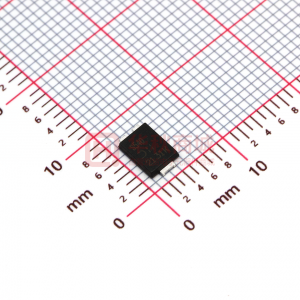

PDS540 5A SCHOTTKY BARRIER RECTIFIER PowerDI ä5 Features NEW PRODUCT · · · · · · · Guard Ring Die Construction for Transient Protection Low Power Loss, High Efficiency Low Forward Voltage Drop For Use in Low Voltage, High Frequency Inverters, Free Wheeling, and Polarity Protection Applications High Forward Surge Current Capability Lead Free Finish "Green" Molding Compound (No Br, Sb) LEFT PIN RIGHT PIN D b2 L1 A A2 PowerDIä5 Dim A A2 b1 b2 Min 1.05 0.33 0.80 1.70 3.90 6.40 5.30 0.75 0.50 1.20 Max 1.15 0.43 0.99 1.88 4.05 6.60 5.45 0.95 0.65 1.50 E E1 L1 e BOTTOMSIDE b1 HEAT SINK D b1 A2 Mechanical Data · · · · · · · Case: PowerDIä5 Case Material: Molded Plastic, “Green” Molding Compound. UL Flammability Classification Rating 94V-0 Moisture Sensitivity: Level 1 per J-STD-020C Terminals: Finish – Matte Tin annealed over Copper leadframe. Solderable per MIL-STD-202, Method 208 e3 Polarity: See Diagram Marking: See Page 3 Weight: 0.093 grams (approximate) D2 E e 3.05 NOM 1.84 NOM 3.55 NOM Note: Pins Left & Right must be electrically connected at the printed circuit board. D D2 b2 L E2 E E1 E2 L L1 W L1 e b1 b1 W All Dimensions in mm Maximum Ratings @ TA = 25°C unless otherwise specified Single phase, half wave, 60Hz, resistive or inductive load. For capacitive load, derate current by 20%. Characteristic Peak Repetitive Reverse Voltage Working Peak Reverse Voltage DC Blocking Voltage RMS Reverse Voltage Average Rectified Output Current (See also figure 5) Non-Repetitive Peak Forward Surge Current 8.3ms Single half sine-wave Superimposed on Rated Load Operating Temperature Range Storage Temperature Range Symbol VRRM VRWM VR VR(RMS) IO IFSM Tj TSTG Value 40 28 5 120 -55 to +150 -55 to +150 Unit V V A A °C °C Thermal Characteristics Characteristic @ TA = 25°C unless otherwise specified Symbol RqJS RqJA RqJA RqJA Typ ¾ 95 70 50 Max 4.0 ¾ ¾ ¾ Unit °C/W °C/W °C/W °C/W Thermal Resistance Junction to Soldering Point Thermal Resistance Junction to Ambient Air (Note 1) Thermal Resistance Junction to Ambient Air (Note 2) Thermal Resistance Junction to Ambient Air (Note 3) Notes: 1. FR-4 PCB, 2 oz. Copper, minimum recommended pad layout per http://www.diodes.com/datasheets/ap02001.pdf. 2. Polyimide PCB, 2 oz. Copper, minimum recommended pad layout per http://www.diodes.com/datasheets/ap02001.pdf. 3. Polyimide PCB, 2 oz. Copper. Cathode pad dimensions 9.4mm x 7.2mm. Anode pad dimensions 2.7mm x 1.6mm. DS30482 Rev. 6 - 2 PowerDI is a trademark of Diodes Incorporated. 1 of 3 www.diodes.com PDS540 ã Diodes Incorporated Electrical Characteristics @ TA = 25°C unless otherwise specified Symbol V(BR)R VF Min 40 ¾ ¾ ¾ ¾ ¾ ¾ ¾ Typ ¾ 0.48 0.43 0.57 0.55 0.015 3 10 Max ¾ 0.52 0.47 0.65 0.59 0.30 20 40 Unit V V Test Condition IR = 0.5mA IF = 5A, TS = 25°C IF = 5A, TS = 125°C IF = 10A, TS = 25°C IF = 10A, TS = 125°C TS = 25°C, VR = 40V TS = 100°C, VR = 40V TS = 125°C, VR = 40V NEW PRODUCT Characteristic Reverse Breakdown Voltage (Note 4) Forward Voltage Reverse Leakage Current (Note 4) IR mA Notes: 4. Short duration test pulse used to minimize self-heating effect. IF, INSTANTANEOUS FORWARD CURRENT (mA) 100000 10000 Tj = 150°C 100 10 Tj = +25°C 1000 100 10 Tj = 85°C Tj = 125°C Tj = 100°C 1 0.1 1 Tj = 25°C 0.01 Tj = -65°C 0.1 Tj = -65°C 0.01 0 100 200 300 400 500 600 700 800 900 1000 VF, INSTANTANEOUS FORWARD VOLTAGE (mV) Fig. 1 Typical Forward Characteristics 0.001 0 10 20 30 40 VR, INSTANTANEOUS REVERSE VOLTAGE (V) Fig. 2 Typical Reverse Characteristics 800 700 f = 1 MHz IR, INSTANTANEOUS REVERSE CURRENT (mA) 100 10 Tj = +125°C CT, TOTAL CAPACITANCE (pF) Tj = +150°C 600 500 400 300 200 100 0 Tj = +100°C 1 Tj = +85°C 0.1 0.01 0 10 20 30 40 VR, INSTANTANEOUS REVERSE VOLTAGE (V) Fig. 3 Typical Reverse Characteristics 0 5 10 15 20 25 30 35 40 VR, REVERSE VOLTAGE (V) Fig. 4 Typical Total Capacitance vs. Reverse Voltage DS30482 Rev. 6 - 2 PowerDI is a trademark of Diodes Incorporated. 2 of 3 www.diodes.com PDS540 7.5 PF, FORWARD POWER DISSIPATION (W) 4 IPK = 1 (DC) IAV NEW PRODUCT IF, DC FORWARD CURRENT (A) 6.0 3 4.5 2 Note 3 3.0 1 1.5 Note 1 0 0 25 50 75 100 125 150 TA, AMBIENT TEMPERATURE (°C) Fig. 5 DC Forward Current Derating 180 TA, DERATED AMBIENT TEMPERATURE (°C) Note 1 0 0 1 2 3 4 5 6 7 8 9 10 IF, FORWARD CURRENT (A) Fig. 6 Forward Power Dissipation 150 120 90 60 30 0 10 20 30 40 VR, DC REVERSE VOLTAGE (V) Fig. 7 Operating Temperature Derating Ordering Information Device PDS540-13 Notes: 1. 2. 3. 4. 5. (Note 5) Packaging PowerDIä5 Shipping 5000/Tape & Reel FR-4 PCB, 2 oz. Copper, minimum recommended pad layout per http://www.diodes.com/datasheets/ap02001.pdf. Polyimide PCB, 2 oz. Copper, minimum recommended pad layout per http://www.diodes.com/datasheets/ap02001.pdf. Polyimide PCB, 2 oz. Copper. Cathode pad dimensions 9.4mm x 7.2mm. Anode pad dimensions 2.7mm x 1.6mm. Short duration test pulse used to minimize self-heating effect. For Packaging Details, go to our website at http://www.diodes.com/datasheets/ap02007.pdf. Marking Information S540 YYWWK S540 = Product type marking code = Manufacturers’ code marking YYWW = Date code marking YY = Last digit of year ex: 04 for 2004 WW = Week code 01 to 52 K = Factory Designator DS30482 Rev. 6 - 2 PowerDI is a trademark of Diodes Incorporated. 3 of 3 www.diodes.com PDS540

### 物料型号 - 型号:PDS540
### 器件简介 - PDS540是一款5A SCHOTTKY BARRIER RECTIFIER,由DIODES公司生产。该器件具有Guard Ring Die Construction,用于瞬态保护,适用于低电压、高频逆变器、自由轮流通道和极性保护应用。
### 引脚分配 - 引脚:LEFT PIN, RIGHT PIN, BOTTOM SIDE HEAT SINK - 注意:引脚LEFT & RIGHT必须在印刷电路板上电气连接。
### 参数特性 - 最大额定值: - 峰值重复反向电压(VRWM):40V - 工作峰值反向电压(VRRM):40V - 有效值反向电压(VR(RMS)):28V - 平均整流输出电流(IO):5A - 非重复峰值正向浪涌电流(IFSM):120A(8.3ms单半正弦波叠加在额定负载上) - 工作温度范围:Tj -55至+150°C - 存储温度范围:TSTG -55至+150°C
### 功能详解 - PDS540具有低正向电压降、高效率、高正向浪涌电流能力,并且采用无铅表面处理。适用于单相、半波、60Hz的电阻性或感性负载。对于电容性负载,电流需降低20%。
### 应用信息 - 适用于低电压、高频逆变器、自由轮流通道和极性保护应用。
### 封装信息 - 封装:PowerDI5 - 重量:约0.093克 - 标记:见第3页 - 包装:5000/卷带
