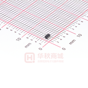

SD103ATW SURFACE MOUNT SCHOTTKY BARRIER DIODE ARRAY Features NEW PRODUCT · · · · · · · · · · · · · Low Forward Voltage Drop Guard Ring Construction for Transient Protection Fast Switching Low Leakage Current Three Fully Isolated Schottky Diodes SOT-363 A Dim A D3 BC Min 0.10 1.15 2.00 0.30 1.80 ¾ 0.90 0.25 0.10 0° Max 0.30 1.35 2.20 0.40 2.20 0.10 1.00 0.40 0.25 8° D1 D2 B C D F H M Mechanical Data Case: SOT-363, Plastic Case material - UL Flammability Rating 94V-0 Moisture sensitivity: Level 1 per J-STD-020A Polarity: See Diagram Leads: Solderable per MIL-STD-202, Method 208 Marking: KLL Weight: 0.006 grams (approx.) Ordering Information, See Below H K 0.65 Nominal J K L M a J D F L All Dimensions in mm Maximum Ratings @ TA = 25°C unless otherwise specified Symbol VRRM VRWM VR VR(RMS) IFM IO IFSM Pd RqJA Tj, TSTG SD103ATW 40 28 350 175 1.0 200 500 -55 to +125 Unit V V mA mA A mW °C/W °C Characteristic Peak Repetitive Reverse Voltage Working Peak Reverse Voltage DC Blocking Voltage RMS Reverse Voltage Forward Continuous Current (Note 1) Average Rectified Current (Note 1) Non-Repetitive Peak Forward Surge Current (Note 1) @ t £ 10ms Power Dissipation Thermal Resistance, Junction to Ambient Air Operating and Storage Temperature Range Electrical Characteristics Characteristic Reverse Breakdown Voltage (Note 2) Forward Voltage Drop (Note 2) @ TA = 25°C unless otherwise specified Symbol V(BR)R VF Min 40 ¾ ¾ ¾ ¾ ¾ ¾ ¾ ¾ Typ ¾ 0.27 0.32 0.36 0.44 0.2 0.4 50 10 Max ¾ ¾ ¾ 0.37 0.50 2.0 5.0 ¾ ¾ Unit V V V V V mA mA pF ns Test Condition IRS = 100mA (pulsed) IF = 1mA IF = 5mA IF = 20mA IF = 100mA VR = 10V VR = 30V VR = 0V, f = 1.0MHz IF = IR = 200mA, Irr = 0.1 x IR, RL = 100W Reverse Current (Note 2) Total Capacitance Reverse Recovery Time IR CT trr (Note 3) Ordering Information Device SD103ATW-7 Packaging SOT-363 Shipping 3000/Tape & Reel Notes: 1. This is the maximum rating of single Diode (D1 or D2 or D3). In the case of using two or three diodes, the maximum ratings per diode are 75% of the ratings for single diode operation. 2. Short duration test pulse used to minimize self-heating effect. 3. For Packaging Details, go to our website at http://www.diodes.com/datasheets/ap02007.pdf. DS30374 Rev. 1 - 2 1 of 2 www.diodes.com SD103ATW Marking Information NEW PRODUCT KLL Date Code Key Year Code Month Code Jan 1 2002 N Feb 2 2003 O March 3 Apr 4 2004 P May 5 YM KLL = Product Type Marking Code YM = Date Code Marking Y = Year ex: N = 2002 M = Month ex: 9 = September 2005 S Jun 6 2006 T Jul 7 Aug 8 2007 U Sep 9 2008 V Oct O Nov N 2009 W Dec D 1000 Pd, POWER DISSIPATION (mW) 200 IF, FORWARD CURRENT (mA) 100 10 100 1.0 0.10 0 0 25 50 75 100 125 TA, AMBIENT TEMPERATURE (° C) Fig. 1 Power Derating Curve 0.01 0 0.2 0.4 0.6 0.8 1.0 VF, FORWARD VOLTAGE (V) Fig. 2 Typical Forward Characteristics 100 f = 1MHz CT, TOTAL CAPACITANCE (pF) 10 1.0 0.1 0 10 20 30 40 VR, REVERSE VOLTAGE (V) Fig. 3 Typ. Total Capacitance vs Reverse Voltage DS30374 Rev. 1 - 2 2 of 2 www.diodes.com SD103ATW
