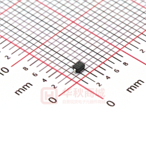

SD107WS SURFACE MOUNT SCHOTTKY BARRIER DIODE Features · · · · · · · · · · · Low Forward Voltage Drop Guard Ring Die Construction for Transient Protection Ideal for low logic level applications Low Capacitance H G A B C E D SOD-323 Dim A J Min 2.30 1.60 1.20 0.25 0.20 0.10 0° Max 2.70 1.80 1.40 0.35 0.40 0.15 8° Mechanical Data Case: SOD-323, Plastic Case Material - UL Flammability Rating Classification 94V-0 Moisture Sensitivity: Level 1 per J-STD-020A Polarity: Cathode Band Leads: Solderable per MIL-STD-202, Method 208 Marking: Marking Code and Date Code Marking Code: SG B C D 1.05 Typical a E G H J a 0.05 Typical All Dimensions in mm Maximum Ratings @ TA = 25°C unless otherwise specified Symbol VRRM VRWM VR VR(RMS) IFM IFSM Pd RqJA Tj, TSTG SD107WS 30 21 100 750 250 500 -65 to 150 Unit V V mA mA mW °C/W °C Characteristic Peak Repetitive Reverse Voltage Working Peak Reverse Voltage DC Blocking Voltage RMS Reverse Voltage Forward Continuous Current (Note 1) Non-Repetitive Peak Forward Surge Current @ t £ 10ms Power Dissipation (Note 1) Thermal Resistance, Junction to Ambient Air (Note 1) Operating and Storage Temperature Range Electrical Characteristics Characteristic Reverse Breakdown Voltage (Note 2) Forward Voltage Drop (Note 2) Peak Reverse Current (Note 2) Total Capacitance @ TA = 25°C unless otherwise specified Symbol V(BR)R VFM IRM CT Min 30 Typ 300 360 470 580 7 Max 550 800 1.0 Unit V mV mA pF Test Condition IR = 100mA @ IF = 2.0mA @ IF = 15mA @ IF = 50mA @ IF = 100mA VR = 25V VR = 10V f = 1.0 MHz Notes: 1. Part mounted on FR-4 PC board with recommended pad layout, which can be found on our website at http://www.diodes.com/datasheets/ap02001.pdf. 2. Short duration test pulse used in minimizing self-heating effect. DS30129 Rev. 4 - 2 1 of 2 SD107WS IF, INSTANTANEOUS FORWARD CURRENT (mA) IO, AVERAGE RECTIFIED CURRENT (mA) 100 100 TA = 125ºC TA = 75ºC 80 60 10 TA = 25ºC 40 1.0 TA = -25ºC 20 Tj = 125°C 0 0 25 50 75 100 125 150 TA, AMBIENT TEMPERATURE (°C) Fig. 1 Forward Current Derating Curve 0.1 0 200 400 600 800 1.0 VF, INSTANTANEOUS FORWARD VOLTAGE (V) Fig. 2 Typical Forward Characteristics IR, INSTANTANEOUS REVERSE CURRENT (µA) 1000 100 Tj = 25°C f = 1MHz 100 TA = 125ºC 10 CT, TOTAL CAPACITANCE (pF) 20 30 40 10 1.0 TA = 75ºC 0.1 TA = 25ºC 0.01 0 10 1.0 0 5.0 10 15 20 25 30 35 40 VR, REVERSE VOLTAGE (V) Fig. 4 Total Capacitance vs. Reverse Voltage VR, INSTANTANEOUS REVERSE VOLTAGE (V) Fig. 3 Typical Reverse Characteristics Ordering Information Device SD107WS-7 Notes: (Note 1) Packaging SOD-323 Shipping 3000/Tape & Reel 1. For Packaging Details, go to our website at http://www.diodes.com/datasheets/ap02007.pdf. Marking Information Type Code SG Cathode Band DS30129 Rev. 4 - 2 2 of 2 SD107WS
