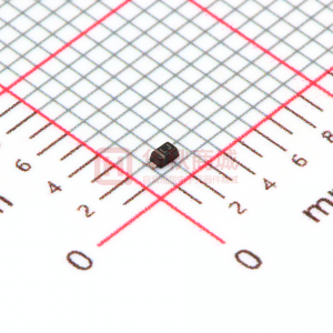

SPICE MODEL: SDM10U45 Lead-free Green SDM10U45 SURFACE MOUNT SCHOTTKY BARRIER DIODE Features · · · · · · · · · · · · · · · Low Forward Voltage Drop Guard Ring Die Construction for Transient Protection Ideal for low logic level applications Low Capacitance Lead Free By Design/RoHS Compliant (Note 1) Qualified to AEC-Q101 Standards for High Reliability "Green" Device, Note 4 and 5 Dim A A B CATHODE MARK SOD-523 Min 1.50 1.10 0.25 0.70 0.10 0.55 Max 1.70 1.30 0.35 0.90 0.20 0.65 Mechanical Data Case: SOD-523 Case Material: Molded Plastic, "Green" Molding Compound, Note 5. UL Flammability Classification Rating 94V-0 Moisture Sensitivity: Level 1 per J-STD-020C Terminal Connections: Cathode Band Terminals: Finish - Matte Tin annealed over Alloy 42 leadframe. Solderable per MIL-STD-202, Method 208 Marking Code: LJ Ordering Information: See Last Page Weight: 0.002 grams (approximate) @ TA = 25°C unless otherwise specified MARKING CODE B C D E E G LJ C D G All Dimensions in mm Maximum Ratings Characteristic Maximum Peak Reverse Voltage Reverse Voltage RMS Reverse Voltage Average Forward Current Maximum (Peak) Forward Current Non-Repetitive Peak Forward Surge Current @ t £ 10ms Symbol VRM VR VR(RMS) IO IFM IFSM Value 45 40 28 100 300 1 Unit V V V mA mA A Thermal Characteristics Characteristic Power Dissipation (Note 2) Thermal Resistance, Ambient Air (Note 2) Operating and Storage Temperature Range Symbol Pd RqJA Tj, TSTG Value 150 667 -40 to +125 Unit mW °C/W °C Electrical Characteristics Characteristic Reverse Breakdown Voltage (Note 3) Forward Voltage Drop Reverse Current (Note 3) Total Capacitance Note: @ TA = 25°C unless otherwise specified Symbol V(BR)R VF IR CT Min 30 ¾ ¾ ¾ Typ ¾ 280 360 470 580 ¾ 4 Max ¾ ¾ ¾ 550 800 1.0 15 Unit V mV mA pF Test Conditions IR = 100mA IF = 1.0mA IF = 15mA IF = 50mA IF = 100mA VR = 25V VR = 10V, f = 1.0 MHz 1. No purposefully added lead. 2. Part mounted on FR-4 board with recommended pad layout, which can be found on our website at http://www.diodes.com/datasheets/ap02001.pdf. @ TA = 25°C. 3. Short duration pulse test used so as to minimize self-heating effect. 4. Diodes Inc.'s "Green" Policy can be found on our website at http://www.diodes.com/products/lead_free/index.php. 5. Product manufactured with date code 0609 (week 9, 2006) and newer are built with Green Molding Compound. Product manufactured prior to date code 0609 are built with Non-Green Molding Compound and may contain Halogens or Sb2O3 Fire Retardants. DS30394 Rev. 9 - 2 1 of 3 www.diodes.com SDM10U45 ã Diodes Incorporated 150 IF, INSTANTANEOUS FORWARD CURRENT (mA) 100 TA = 125ºC Pd, POWER DISSIPATION (mW) 125 TA = 75ºC 100 10 TA = 25ºC 75 50 1.0 TA = -25ºC 25 Tj = 125° C 0 0 25 50 75 100 125 150 TA, AMBIENT TEMPERATURE (° C) Fig. 1 Derating Curve 1000 0.1 0 200 400 600 800 1000 VF, INSTANTANEOUS FORWARD VOLTAGE (mV) Fig. 2 Typical Forward Characteristics 100 Tj = 25° C f = 1MHz 100 TA = 125ºC 10 CT, TOTAL CAPACITANCE (pF) 20 30 40 10 1.0 TA = 75ºC 0.1 TA = 25ºC 0.01 0 10 1.0 0 5.0 10 15 20 25 30 VR, REVERSE VOLTAGE (V) Fig. 4 Total Capacitance vs. Reverse Voltage VR, INSTANTANEOUS REVERSE VOLTAGE (V) Fig. 3 Typical Reverse Characteristics Ordering Information Device SDM10U45-7 Note: (Note 5 & 6) Packaging SOD-523 Shipping 3000/Tape & Reel 5. Product manufactured with date code 0609 (week 9, 2006) and newer are built with Green Molding Compound. Product manufactured prior to date code 0609 are built with Non-Green Molding Compound and may contain Halogens or Sb2O3 Fire Retardants. 6. For Packaging Details, go to our website at http://www.diodes.com/datasheets/ap02007.pdf. DS30394 Rev. 9 - 2 2 of 3 www.diodes.com SDM10U45 IMPORTANT NOTICE Diodes Incorporated and its subsidiaries reserve the right to make modifications, enhancements, improvements, corrections or other changes without further notice to any product herein. Diodes Incorporated does not assume any liability arising out of the application or use of any product described herein; neither does it convey any license under its patent rights, nor the rights of others. The user of products in such applications shall assume all risks of such use and will agree to hold Diodes Incorporated and all the companies whose products are represented on our website, harmless against all damages. LIFE SUPPORT Diodes Incorporated products are not authorized for use as critical components in life support devices or systems without the expressed written approval of the President of Diodes Incorporated. DS30394 Rev. 9 - 2 3 of 3 www.diodes.com SDM10U45

1. 物料型号: - 型号:SDM10U45 - 封装:SOD-523
2. 器件简介: - 表面贴装肖特基势垒二极管,具有低正向电压降、保护瞬态的防护环结构、适用于低逻辑电平应用、低电容特性。
3. 引脚分配: - 阴极带标记。
4. 参数特性: - 低正向电压降 - 无铅设计/符合RoHS标准 - 符合AEC-Q101标准的高可靠性 - “绿色”设备,符合环保要求
5. 功能详解: - 该二极管适用于需要低正向电压降和低电容的应用场合,如低电平逻辑应用。
6. 应用信息: - 适用于低电平逻辑应用。
7. 封装信息: - 封装类型:SOD-523 - 封装材料:模塑料,“绿色”模塑化合物 - 尺寸数据:最大值A为1.70mm,B为1.30mm,C为0.35mm,D为0.90mm,E为0.20mm,G为0.65mm。 - 重量:约0.002克。
